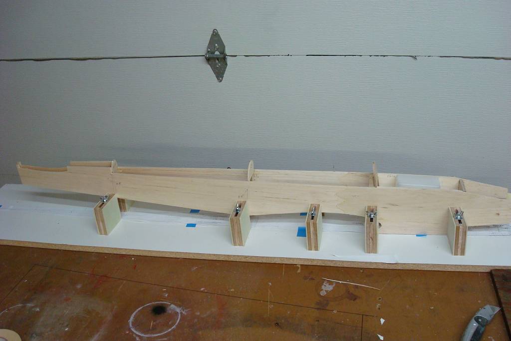

Started on the Curare 60 build from Eureka Aircraft. CNC cutting was very good. Don does a great job and has been helpful in guiding me through a couple modifications to the parts that differ a bit from the plans. This is my first short kit build, so I am finding out about the difference in a short kit and a regular kit. It does take some time and careful attention to the details of the plans. I decided to build the fuse and wing at the same time. No particular reason, it just sort of fell together. I have all the parts puched out and have glued together multiple pieces that produce 'blocks' that normally would be supplied as a large block. Took a bit of conversation with David to get the root and tip profiles to their accurate size. So, now the foam is cut for the wing. I will be gluing up the sheeting this week. I also took a shot at making up a fuse jig using material in my shop, it seems to be accurate and sure helps in holding the fuse in line. If anyone has the plans for a "gravity pull" foam cutter (like the one Chino used) I think that would work better than manually. Now, I am going to send this without pics....I had difficulty doing that twice. I will then try to send the pics separately.

O.K. Wow-a pic actually came through. I will now try to do a few more. Well, I tried with three pics...it said my files was too large. Hummmmmmm, do I have to do one at a time?

Tim,
nicely done fuse jig! I hope that with the PDF wing plan printed at Kinkos, things now make more sense.
I see that you've got your nose gear nicely installed in the FW. Before you frame up the fuse, I'd recommend that you also install your engine mount - it will be much easier to do it with a free FW. The mount bearers might just need to be a tad off centerline to allow for the right thrust of the engine. Like wise for the downthrust - a tad up from thrust line.
Please post some pics of the wing and plan when you've got it cut.
David.

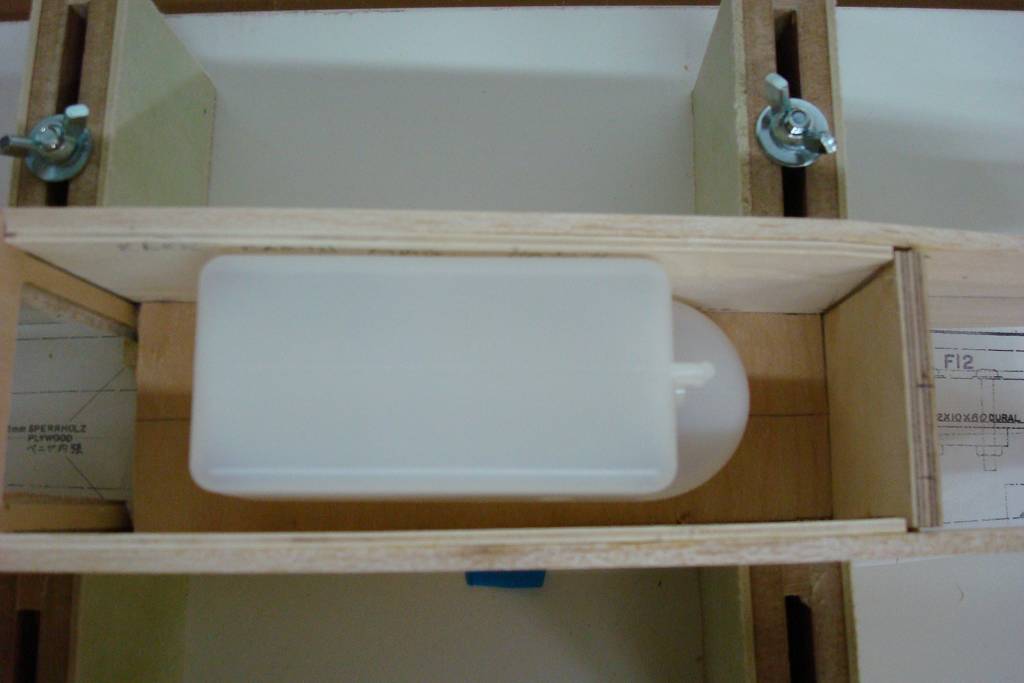

Good suggestion re: res. on camera. I will check that out next photo session. Always a good suggestion to mount gear (retracts, engiine mount) prior to encasing. Even with small hands it is trying. I was trying to find a one piece circular engine mount (i.e. Hayes) but they do not have a compatable size for the Magnum 61 that I am using for power.
Engine compartment is too narrow. I guess I will be using a beam mount...even then it will be tight. Right now I have the engine mounted on a Sig type mount (the kind that forms a T w/webbing) that is basically designed for a 40 size engine. My concern with that is one of standing up to vibration and torque. It is possible that a Dave Brown mount may work. Have to keep looking. If you guys with Curares can lend an idea, much appreciated. The original plans used elongated wooden beams. Have not seen those in many years.
Tim
