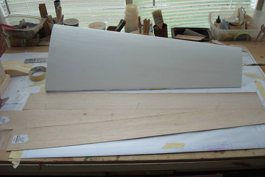

I checked out the DB glass filled mounts. From what I can tell on the spec. sheet, the round type mount will not work. Inside dimension from side to side in the engine cavity is about 2 1/8". At the moment I have the engine mounted to a Sig mount as I mentioned. The beams are 3/8" square and the length of each upright is 1 7/8" supported by the triangular web. Q: Do you guys think that will withstand vibration and torque of engine. I believe these are made for 40 size engines. Back to the drawing board!
I just glued together my first wing skin awhile ago. Also pictured is a view of the foam wing. Also a top mount of the Robart N.G. I am using a 2" on the nose and 2 1/4" for the mains. Hope to get to our private flying field this Thurs. We have a great friend who has 32 acres out in the country with his personal 600 x 50 grass strip. His wife mows it like it was a putting green. She really loves to mow! How cool is that? I will shoot some pics and send them along. Our club strip is asphalt......a real prop-buster if you don't grease the landings. Flying on grass is the only way to fly....from our point of view. I hope to maiden my Big Kaos. I also have an SR Batteries Eindecker I I put together last winter and is chomping on the bit to take to the grass.

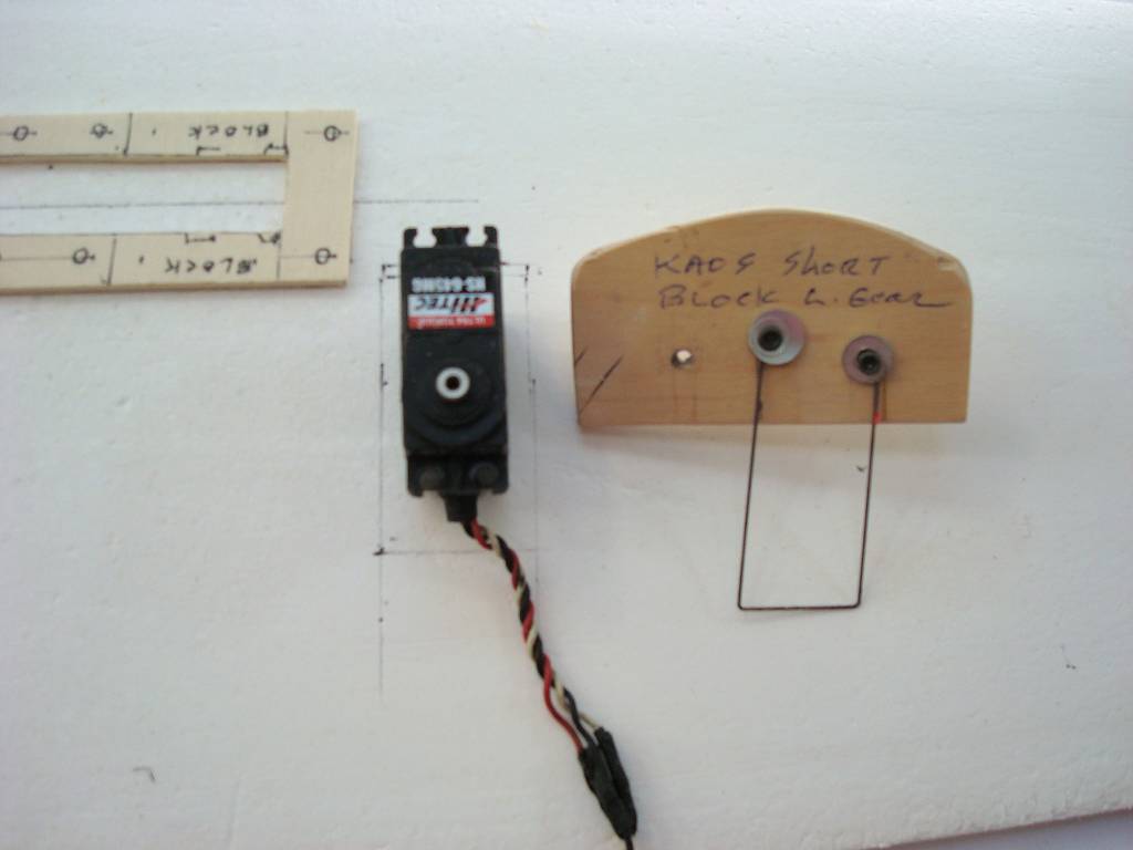

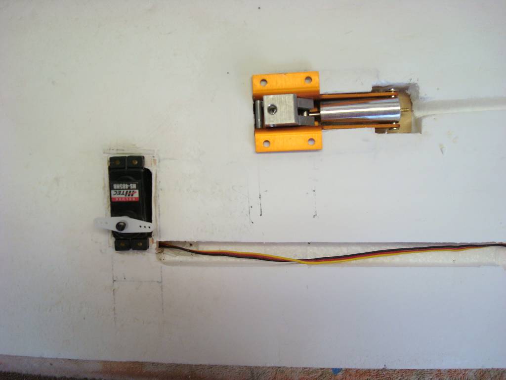

Got the sides of the fuse joined along with the nose block. Finally managed to get the alignment down for the engine supports. Worked on that for a couple hours. I am modifiying the nose ring rather than using the one that came with the short kit. I prefer to have a circle for the opening, this one is like a rect. race track. I think it will work fine.
I also have the aileron servo and retract installation complete for the right wing. I cut channels for servo lead and air line. I will cover the channels with a balsa stick but leave room on the bottom side to allow for installation or removal. I also had some dings in the foam and some ripples due to a somewhat shakey cut with the wire. I wanted to see if I could fill those voids with spackle (OneTime) prior to epoxying the skins and make sure the bond was positive. I took a scrap piece of foam, laid on a coat of spackle, sanded and spread a thin coat of 30 min. Z-Poxy and applied a piece of balsa sheet. I tried to pull the skin loose, you can see the results in the pic. Next chore, work on the other wing and add the chin block.
Tim
Tim
#40
Tim,
I wouldn't use spackle to fill the core. If it is plasticized, in time the sheeting will delaminate. If the spackle/sheeting doesn't delaminate, the spackle/foam will come loose. I can't see any reason why spackle would want to adhere to foam long term. You are better off sanding the cores until they are smooth. If you wind up with an airfoil which is 0.5% thinner so be it. Just make sure your two cores are sanded evenly.
Something I haven't tried yet but intend to is to use some milled fibers in my laminating epoxy on the next wing. This might increase the weight of the mixture slightly (perhaps not, don't know which is heavier; glass or epoxy - probably epoxy) but it should produce an even nicer and stronger bond to the foam. Epoxy becomes brittle in time and glass mixed into it should help to keep it bonded - just a theory though.
Don't forget to make a slightly wider/deeper channel for the retract strut, you don't want it to bind against the wing should it bend slightly on takeoff. I would also open up the retract body well so it can be sheeted with some 1/16" balsa. Makes for a nice & clean body well which is easier to finish (I dislike spraying paint directly on to foam).
David.
David.

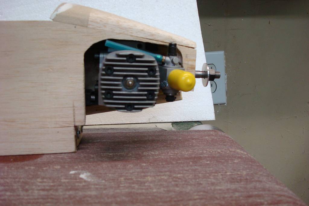

David: you probably spotted my oversight in positioning the trough for my air hose. Right, it is right in line with the wheel well. WELL, I guess I will have to 'snake'it around the well. Which basically means once I install it, it probably is not going to come out. Not a good idea, huh? Ideally, one would like a straight shot, cut how do you do that with the wheel well in the same line? Eeee gads! Can't this be simple?
#43
Hey Tim,
Maybe it's just the angle of the photo, but it looks like you have an awful lot of down thrust in your engine setup? Do you have a way to measure the angle? Even a simple protractor could be used.
Ralph
Ralph
#44
ORIGINAL: mmiller1
no worries with this. That channel you cut for the line will actually diseapper when you cut the trough for the strut. Given it is a 5-32 (or 3-16) wire strut, you don't need a super large well for it, but it pays to oversize it slightly than end up with something that is too tight - a little play helps.
The air hose can exit through the top of the wing right about where your 1/32 ply plate is shown just in front of the nipple on the cylinder. You can run the plumbing along the top of the wing so that it exits near the center top where you want it. You can make a rectangular duct in the top of the wing which will get a thin splice of 1/16" prior to sheeting the core. Alternatively, you can also run the line inside the retract well and just tape it down to the bottom of the well around the axle. You then can run a thin plastic tube from the base of the wheel well to the root of the core to duct the hose. It just depends whether you want your hose visible and easy to access or prefer a cleaner look.
Oh, yes, what Ralph said - looks pretty serious - 5 degrees maybe?
David.

R_G and David: I think I might agree with you re: thrust angle. 2 degrees is so slight. Not even sure I could detect it with the eye...so if it looks that obvious it is probably too much. When you mention : datum line are you referring to both a lateral view as well as a top view. This seems to make sense to me. So, if I am initiating a down thrust of 2 degrees, my thinking is I would copy the datum line from a lateral view of the plans onto the fuse and take a reading (protractor I guess) from that...? Is there another way?
Same would hold true for right thrust....?

#46
Tim,
the datum line is often the thrust line although in the case of the Curare I don't recall whether these coincide. In any case, the plans will have a datum (a common reference point) about which you can measure offsets. This might be the top of the fuse before the curved portion of the decks begins. The datum is meant to be a horizontal reference off which you can measure things like incidence and engine thrust angles.
As you say, transfer it to the fuse sides and use a spirit level to make sure the datum is horizontal. You then measure offset of the engine with respect to this level point.
The datum in usually of relevance in the side view since the datum in the top view is the fuse centerline. If you think of two sections (planes) going through these datums (one horizontal and the other vertical), they will intersect. I seem to recall that the Curare has this intersection at the thrust line (that is, the engine crankshaft at 0-0 sits on this line prior to introducing offsets to compensate for torque).
If you need to extend the datum along the fuse side because it curves in at the nose, use a light straight edge to extend it.
If your FW us at 90 degrees to the datums, then you probably only need a washer or two for the offset angles. If you have only one washer at the moment, your FW is likely not vertical - the downthrust looks too extreme.
David.
David.
#47

#48
Tim,
it doesn't help much to talk about offsets here and there without having a 0 degree reference. Either your FW was installed per plans with both the down and right thrust or it was installed square to the fuse sides - both vertically and horizontally. For a 0-0 (right-down) setup, the FW wants to be square to the thrust line and perpendicular to the work bench (assuming it is flat). There is nothing that one can "build in" to a firewall to introduce engine offset, it is in how you install the FW with respect to the fuse sides. The only thing that can be done to aid in introducing the FW offset is to bevel the edges to the correct angle so that when it is installed at the, say, 2-3 degree offsets, then, when you mount your engine, no spacers (washers) are needed.
You should remove your engine and check whether your FW is square with respect to the bench (this is for down thrust offset) as well as square to the thrust line. If it isn't, you might have accidentally introduced excessive angles already into the FW installation and using washers to further offset the engine is resulting in what the picture seems to depict. You may actually need to introduce washer on the opposite side to counteract excessive built-in offset.
I find that the only reliable way to build in offset angles when installing a FW is to actually measure and mark the fuse sides for down thrust angle as well as where it should be bonded with respect to each side. Of course this is much easier to do when the fuse has yet to be framed up. In the absence of this, it can be somewhat tricky to get those angles right. The FW side edge lines on the fuse sides will tell you where exactly the FW should be bonded. You then merely mount your engine flush against the FW by placing it in the appropiate corner in the upper right quadrant of the FW (when looked at from the front).
A protractor like Ralph suggested would help, you'll be able to measure it rather than eye balling it. It's pretty hard to gauge 2-3 degrees. 30, 45 or 90 are obviously a little easier.
David.
David.

Thanks for the newest information, David. I believe I have the offsets corrected however I realize that getting to the underside of the Sig mount with a nylock is going to be troublesome. J
Such tight spaces. So here is my solution: drill and tap the Sig mounts (which are the plastic type) for an 8-32 hex bolt. I may be able to put nylocks on the front two bolts but the rear may not work. Is this going to be a problem. I have used tapped threads on these kinds of mounts before, but I usually add a nylock. Crazy question: will thread lock adhere to these plastic mounts?
Next Q: I realize now I should have mounted my nose gear retract a bit deeper into the recess. I forgot about the steering arm! So, the steering arm is just a tad below the bottom of the fuse.(hope that makes sense). I have never installed a nose gear retract before.....do you use a pull-pull system going back to the rudder servo? I would think this is the only system that would work. How could you use a solid wire? When the unit retracts, what ever is attatched to it has to be flexible and bend with the nose gear.
So.....you tought you were getting off easy!
#50
Tim,
DO NOT use thread locking compound on plastic! It will make the plastic brittle and could cause a failure. Don't ask how I know this!
Instead use split lock washers under the heads of the bolts.
RG
