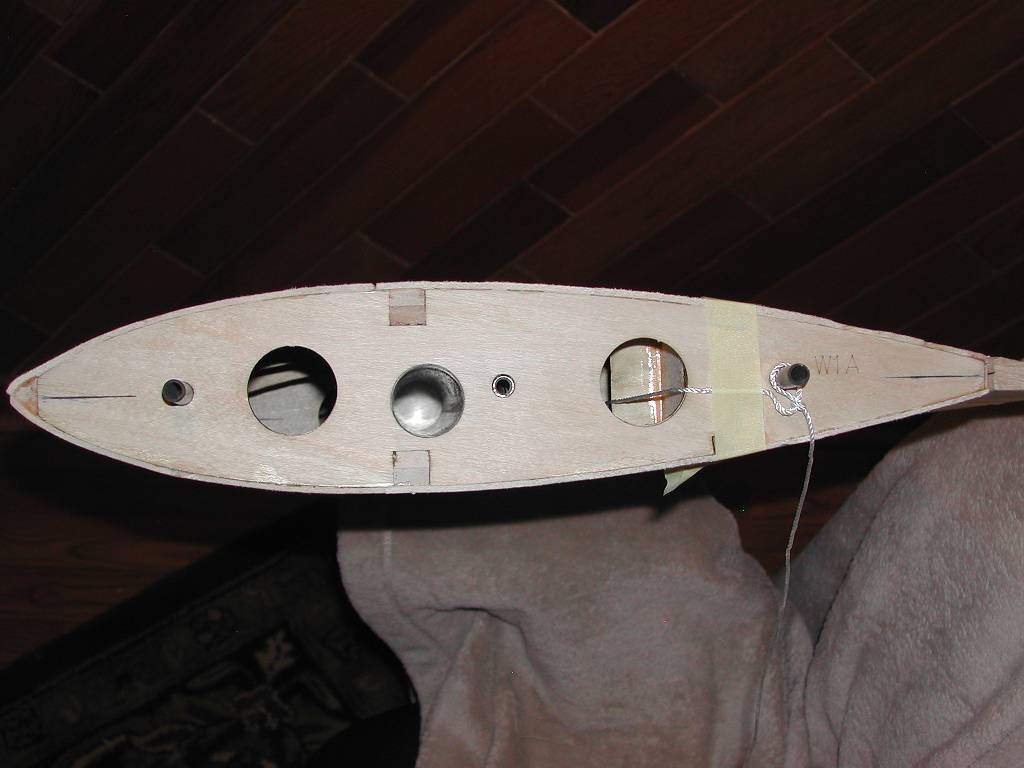

#384
Joined: Oct 2009
Posts: 338
From: ORLANDO,
FL
Duane,
I agree with you about the 5/16" CF tubes in the wing. As a matter of fact I plan on foregoing their use in my next Simla project. Once again, I'd like to do somethingin the 96" wing span with all contest balsa, a 60 size engine, and any other techniques to make it as light as possible without altering the overall Simla appearence. This second projectwill require a great deal more planning and research. I am looking forward to it .
Bill
PS- I was considering making use of the steel rods as stiffiners, but decided that I would need them for any futrue Simla builds.
PPS- I didn't run into the diminishing wing tip problem. Not sure why, but it just didn't rear it's ugly head.
PPPS- Yes, I did remove my wing panels from the build board, butonly after I installed the CF tubes. As it turned out, when I placed the wing sections back on the build board they were as flat as when I removed them. But then I already knew that they would be. Now that they have been covered they are really rigid and about 740gm. each with servo and landing gear.

#390
Joined: Oct 2009
Posts: 338
From: ORLANDO,
FL
Richard,
Perhaps because of the airfoil shape the sheeting does not need to be sanded paper thin when it is placed "over" the LE and TE. Only a slight amount of sanding of the leading edge gave a really nice contour and the trailing edge required no sanding at all. The best part of it,as Duane stated earlier, is that it is much stronger than the butt joint. Also, if you use the butt joint method, when you sand down the LE and TE you run the risk of sanding the sheeting at the joint very thin. IMHOthe overlap method is far superior in many critical ways.
Bill
PS- Take a look at photo #4 in post 380. It's not completely finished, but it will give you an idea of what I,m saying.
Bill
#391
I was looking at your post #380. Looks like you decided to use CF rods INSTEAD of the wooden dowels...nothing wrong, just different. Did you plug the ends with wood?
Even though we are building the same wing, it's amazing how many little "micro-differences" there are in building methods. It looks like you could sand the sheeting over the L.E. almost down to a point right at the L.E. if you chose to...did you leave the L.E. that way?I'll have to look at mine from the side to see what I did. Hopefully it is still visible even after painting. Chances are I sanded off more than you did. I'll post a picture.
The way Jeff finished your ribs makes your root rib appear different...again, interesting.
Duane
Duane
