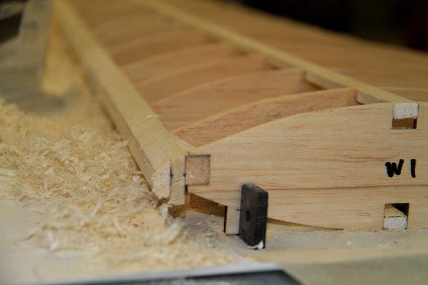

While you folks are building the Simla wings, I have on the board a King Altair wing. As I mentioned earlier, when I built this prototype of our King Altair kit in an earlier project with Jeff, I wanted to get the project in the air as soon as possible as we were well into fall at the time. At the time, I used the original foam wing from my RTF King I bought from a modeler getting out of the hobby, (it was my first King Altair). The wing however feels like a "brick" to me at 2lbs 2oz, and it's time to try to shave some extra ounces if possible. In an effort to improve performance, I'm building this wing with an eye toward lightness. My hope is to shave 8 to 12 ounces off the 8lb 5oz King. The performance right now is OK...but I'm going to try to improve that some.
I received my contest balsa from National today, (eight sheets of the bargain, and twelve of the "aero-light"). I haven't opened the box yet, but will tomorrow. In preparation for sheeting the wing, I shaped the L.E./false L.E. to shape so I can sheet right over it rather than up to it. To me that makes a stronger L.E.
I want to tell you about and recommend a tool from Great Planes, (if you don't already have one), that makes this job amazingly easy. Like the fuselage, you have to remove some balsa to get the L.E. to shape, and the "Power Plane" really helps, and makes it easy to get a nice, straight, smooth line. All that is required is some light final sanding with a sanding block with 80-grit paper. I did this work tonight...please forgive the slightly out of focus pictures...depth of field can be tricky sometimes.
Note the centerline drawn on the L.E....the object is to sand up to the line, but NOT to sand the line off until the finish sanding when it is very lightly rounded. This is a thick wing, (much like the Simla), but unlike the Simla, I'm going to deliberately try to get a sharper L.E. in the hopes of it cutting the wind a bit better. Right now, the King has a decided "whistle" to it as it flies by due to the "draggy" wing.
We still have to talk about the wing tips.
Duane

Would you recommend this same procedure for the Simla wing ie-sanding the LE down to shape and sheeting over it as opposed to up to it? And what about doing the same thing for the TE? It would seemthat this method would also solve the problem of the sheeting being slightly curved from end to end. It would alsobe much easier to apply the sheeting over the edges than to fit it between the edges.
Now, about those tips. I have already rough cut them to shape and was surprised to find that they will be less than half the weight of the blocks that I started out with. Once I have them finished shaped I plan on reaming the insides out as much as possible.
As an interesting side note, with all this contest balsa substitution, there is enough balsa left over from thekitto make considerable headway on another less weight conscious model. Hmmmmm.........

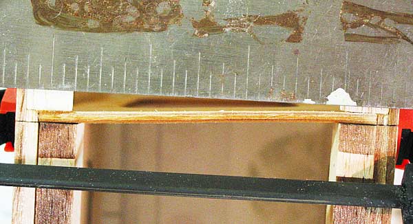

Got a question about the fuse.
The two images show how I've tacked the pieces together as a trial fit. I'm puzzled by F4 and F9. You can see in the first image how, on the left fuse side, F4 and F9 are about 1/16-inch short of the front of the fuse side; and how, on the right side, F4 and F9 extend past the front of the fuse side by about 1/16th inch.
I carefully doublechecked that the right-side pieces are on the right side, etc.
Everything else appears to align perfectly, so either I don't understand the instructions, or the parts are mislabeled. Which is it?
Cheers,
Richard
Cheers,
Richard

Here's another image of what may or may not be a problem. (I'm assuming it is, since the fit of Jeff's kit is normally so good that if something doesn't align properly, I've probably done something incorrectly.)
This image shows how, if I match the fuse sides at the nose, the formers (in this case, F2) are not perpendicular to both sides. At the same time, you can see that the former is exactly aligned with the alignment marks that are etched into the fuse sides. (The images in my previous post, number 341, about this had the fuse sides such that the formers were perpendicular to the sides.)
If I align the fuse sides so the formers are perpendicular to the sides, the right side is a bit less than an eighth inch behind the left side.
This puzzles me, and has put a sharp stop to my building. (I can switch to the wing, but the fuse will just be lying in wait.)
If something went wrong, I am at a complete loss as to what went wrong where. If everything is actually fine, then I didn't understand the instructions.
Cheers(?),
Richard
Cheers(?),
Richard

I am not sure what you have done, but something is definitely not correct with your fuselage. The kit has a right and a left fuselage side, and a left and right side plywood doubler. It almost looks like you may have transposed the doublers. In other words putthe right doubler with the left fuselage side and the left doubler with the right fuselage side. When all is as it should be formersF-2 and F-3 shouldbe perpendicular to the fuselage sides and former F-1 should be angledslightly formleft to right toward the rear of the fuselageas viewed from the top ofthe fuselage if you were sitting in the cockpit. Another way of putting it would be to say that if you were sitting inthe cockpit, theright side of F-1 would becloser to your right shoulder than the left side ofF-1 would to your left shoulder. I hope this doesn't confuse you more
When I started the fuselage build I jigged the sides parallel to one anotherover the plans and glued formers F-2 and F-3 in their proper positions and perpendicular to the fuselage sides. After they set up (thirty minute epoxy) I placed former F-1 in it's palce over the plans and between the fuselage sides while aligning it with the ends of the plywood doublers. I used scrap pieces between the jig and the front of the fuselageto "pinch" the front of the fuselage in toward former F-1.
Bill
PS- I must point out that the photo I am posting is viewed from the bottom of the fuselage so that everything mentioned above appearsin reverse order. If this isunclear to you, let me know and I will try to shed a brighter light on the situation.
Bill

During design, we discussed the need for webbing, (our comments at the time are on the Ed Kaz Taurus thread. I was in favor of using them as well, but in the end, Jeff didn't feel we needed them, and he is the engineer.
As for the L.E. and sheeting, that's how I do it, and I think it's stronger. As for leaving a line, I think it depends on what you use for adhesive, and I would use the Sig Ment to attach the sheeting the the L.E.
If the Power Plane isn't on the Great Planes or Tower Hobbies websites of catalog, then maybe they don't offer it anymore...too bad, because it sure helps, and it makes the job easy, (it works as advertised). I guess it's always a questions of offering what the people want...maybe they just didn't sell enough of them. BTW...I was talking to Kevin about it, and he has one too. Maybe somebody has one that you can borrow if they aren't available.
Duane

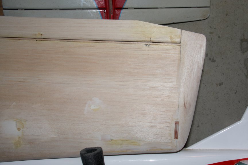

#349
ORIGINAL: billberry189
Bill
Bill
BTW...The small piece of ply is NOT for "lateral balancing" as the photo caption said in the Simla article...(Michael was assuming something that wasn't there). The simple truth is, in the course of final sanding, I sanded through the sheeting, and used 1/32 ply to cover the thin spot...the truth wins out.

I used your method to glue the sheeting to the wing frame with plain old Elmer's white glue and sanded itto a fine leading edge with no gapping or problems of any sort. It was in fact a much easier way to apply the sheeting than trying to fit it between the leading and trailing edges. If I had to do it again, I would do it exactly the same way. Thanks for that one!
I think you are probably correct about the power plane being discontinued. Perhaps if I contact Great Planes directly I might be able to beg one out of left over inventory. I think I'll try working on that tomorrow.
As far as the spar webbing, I am inclined to agree with you and Jeff. True that it would provide some crush resistance, but it appears that the closer I get to completing the wing that it would take a substantial amount of force to crush this wing. I do have to admit, however, that when I had the wings assembled to the fuselage without any covering their mere length alonemade them appear weak and spindley. Fortunately that is not the case as they approach completion.
Now about those wing tips.........................
Bill
PS- Apparently while I was composing this post you covered "those wing tips"
Bill
