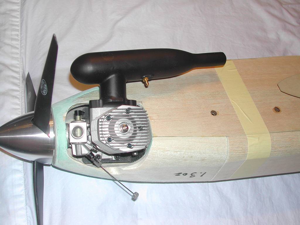

While playing with straightening the wing (it's probably straight enough to finish the job with sheeting the bottom), I roughed-in the front top piece over the engine compartment. (Images attached.)
Right now it still covers quite a bit of the engine. This may vanish once it's shaped. But if it is not sanded away, should I leave it as is, or should I open up the top piece more? (As it is now, I would attach an extension to the needle valve to get it into the open.)

Richard;
Write me at home ([email protected]) and I can send you better pictures that illustrate just how mine looked than I have here at work.
For right now, what I can tell you is that you need to add 1/2" to 3/4" triangular stock (whatever works best), in the two top corners, (all four if your going to completely cowl in the engine, which I didn't do, then place your spinner back plate on the engine, and trace it. You may need to put additional "fill balsa" in the corcers enough so that it doesn't sand through. There will be a couple places where it will become thin...hold the nose up to a strong light so you can see when it is getting thinner. You should be able to sand the nose section down to a "slinky" shape that fits the curve of the spinner. Look at the one picture on page 34 of the article itself that gives you a good idea of the final shape.
I actually preferred the open engine that Ed used on his original model, but do it whatever way you like best. With the open engine, you get a cowled look, but everything is open and easy to get at. It is also easier to build by leaving the right side open like that, and it is authentic to the original.

Bill/Duane,
Sorry; I should have been more precise. I was just wondering if I could cowl the engine real closely with the top block, or if I should open it up more like Bill did. Upon further reflection, I realized I will have to open it up or I'll never get the engine in or out unless I made the top block removable. And I don't think there's near enough wood available into which to anchor any screws except at the very back.
I've got the wing panel straightened out to the point that sheeting the bottom *should* get it straight. If not, I'll still finish and fly with the wing while I make another one.

Whatever you do, the top line should follow the line of the spinner, and the nose should have this slender appearance. Glad to see you're making progress.

Yes, I cowled in the engine while making sure I had plenty of room to install and remove the engine. The real key seems to be inhow large you make the nose plate hole. On mine I made the hole as large as possible thus allowing the engine a greater angle to slip into the engine bay.

Thanks! I hadn't thought of opening up the nose ring. BTW, before I start final shaping, how far is your engine backplate from the firewall? I set mine up to allow just enough room to route the fuel and muffler pressure lines.

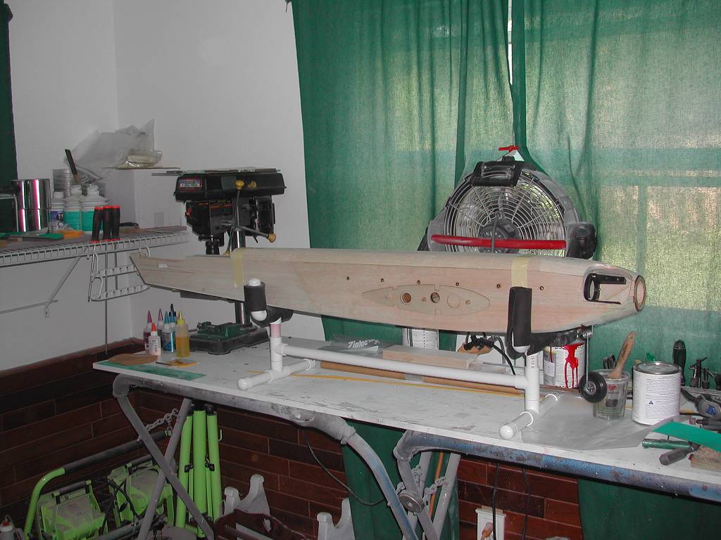

After a couple false starts with a couple methods that didn't work as well as I hoped, I *finally* have the servo covers made and the servos installed on them, and the paper tubes for the servo leads installed in the wings, and all the *#$*%#@ little tabs cut off and smoothed. Will be sheeting the bottom surfaces soon. Considering all the fun I had with wood glue for the top skins, I'm going to use slow epoxy for the bottom skins.
Still deciding if I want to cut the servo leads and solder in the extensions, or just go with long ready-made extensions and make darn sure they can't come apart.
Much of the wing work would have gone more smoothly if I had waited to install the anti-rotation pins and the hold-down bolts until all the sheeting was on. Then I could have continued to use the wing jig. I won't make that mistake when I get the new wing components from Jeff. (Who seems to be swamped at his day job.)
Have also determined and trial-fit the servos and links for the elevator and rudder. Since the rudder is going to be pull-pull, I'm still working out how to/where to cut holes in the fuse for the wires to get to the rudder horns. Still need to determine the layout of the nose gear and throttle servos.
The engine compartment is pretty much finished and the nose gear trial-fit. I want to apply a coat of neutral (grey) paint and fuel-proof paint to the interior.
Basically, figuring out how to position and mount the servos and control linkages has been taking most of my time, since I haven't done it before and have to ponder everything at great length.
