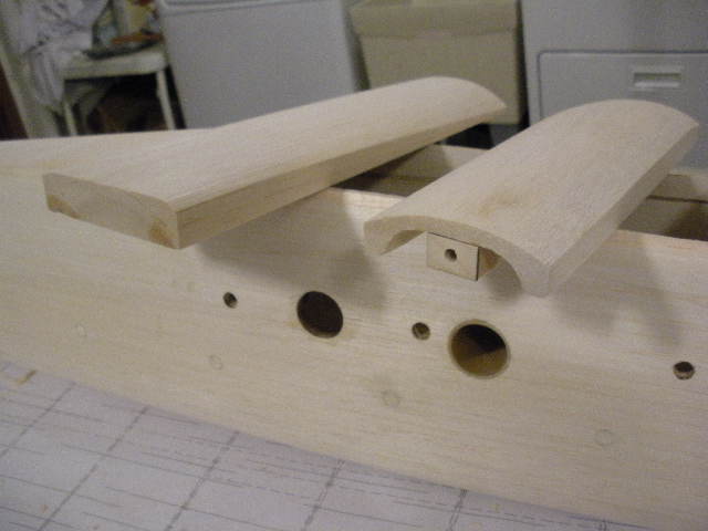

Before I get carried away with sanding the bottom blocks, this is what I understand from the plans and from several images in this thread. These images include:
- Side view in Post 108 by Duane
- Post 117 by Bill
- Last image (2 fuselages) in post 120
It seems that the bottom blocks are inserted so they are flush with the bottom curve of the firewall and the two formers. (See my images.)
However, as is seen in the last image I took, if the front bottom block is positioned as described, the entire bottom curve of the fuse, from the first former to the firewall, is going to be removed, as shown by the red box.
Is this correct? I want to make sure because I can't imagine Duane and Jeff getting this wrong when cutting the fuse sides.
The only way I can think of to retain the curve is to glue on some balsa to the bottom front block. But no-one has mentioned having to do this, so I'm stumped.
Any advice will be much appreciated.
Thank you,
Richard

Look at the first picture. You are correct that the shape of the bottom block must conform to the shape of the formers. To do that, you are going to have to turn that square box into a rounded fuselage. Remember in the article I said one of my favorite times when building the fuselage is the day the fuselage is transformed from box to slinky fuselage. You are going to see vast amounts of balsa disappear...the fuselage ISN'T boxy...as long as you have your balsa thick enough, you won't sand through to nothing.
Look at the bottom fuselage picture in the article itself...that box is turned into the picture below it in a matter of 1/2 hour or so with an electric sander...JUST BE SURE THE BLOCKS EXTEND TO THE SHAPE OF THE ROUNDED FORMERS. It looks like yours are not quite high enough in a couple places. Especially if you use an electric sander, be sure to stop frequently to make sure you're not sanding something you shouldn't
I assume you are going to make the hatches. Tack-glue them in place before sanding so the hatches assume the overall shape of the fuselage bottom. The formers and firewall have two different curvatures, so the hatches make take on a bit of a curved, strange shape, but the key is the side view shape of the fuselage should be maintained. The radio hatch is designed to be FLAT, so you can set the fuselage down on a table to charge the radio etc. The wing covers this, so you don't notice the flatness.
Hope this helps...other thoughts??
BTW-As for the area in the red box...I can't remember (without the plans) whether you lose all that fuselage, or if the block is RAISED toward the front so ONLY THE BOTTOM PORTION OF THE BLOCK, (as seen when inverted) remains as the hatch. Refer to the plans, or maybe Bill can help with that. The important thing is to remember to leave enough block so that the shape of the former is preserved all the way across...hope this makes sense
Duane

Truth to tell, I'm still feeling more than a bit clueless. To me, it all sounds as though the bottom blocks should be thicker to allow sanding without removing the upwards curve of the fuse while simultaneously allowing a curved surface to the underside. And because the forward bottom block has been hollowed out, it is particularly resistant to being raised above the level of the formers while retaining enough thickness to support the hold-down bolts.
I suppose the hollowed-out area can be partially filled with scrap balsa. Although laminating on another 1/4-inch of balsa to the bottom blocks seems like the way to go.
To me, this is an instance of the instructions saying "Magic happens here." It's a trifle frustrating to a first-time builder.
Oh, well. Onward.

Richard,
Unfortunately, I failed to take any photos before I rounded the fuslage. However, I am sure that I followed Jeff's instruction where installing the fuse blocks is concerned. And yes, I also used a power sander to "rough out" the general shape and then finished with the shoe shine sanding technique. The only place that became too thin was the top block right at the fire wall, so I used a little filling glaze to cover the thin areas and then took great care not to sand through it a second time. After I glassed the fuse, the thin areas were plenty strong. One other thing, I glued the nose ring in place before I sanded the blocks. Just mount your engine with the spinner attached and use it as a guide to position the nose ring. I used epoxy for this step because it gave me plenty of time to get the nose ring positioned properly.
As far as the bottom contours are concerned, just follow the bottom shape of the formers and nose ring and you will get the correct shapes. Remember, as Duane said sand to the shape of the formers not into the formers

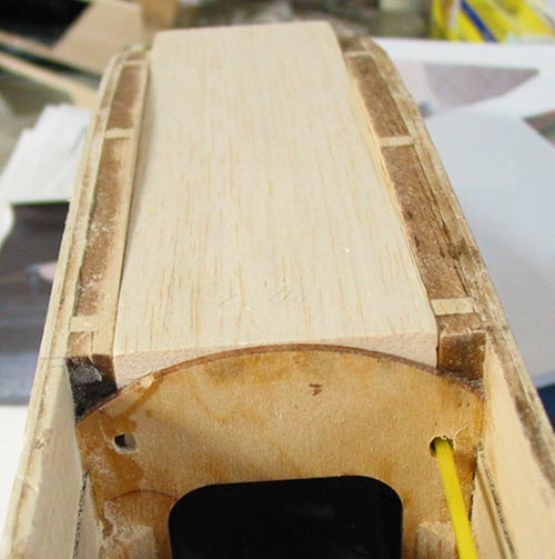

My fuse bottom looked much like yours before I went to work on it with a razor plane and sanding block. Yes the fuse sides were higher than the hatches. The key is to form them to follow the shapes defined by the fire wall, F2 and F3. Just sand them to make a smooth transition from one bulkhead to the next. After sanding to final shape, I used strips of 1/64 ply to line the inside edge of the fuse sides. This will support the soft balsa sides where they come to a point. You will of course need to sand the width of the hatches to allow for the '64th ply. I added two 1/8th dowels to the fuel tank compartment hatch with corresponding holes in the fire wall. Then I added a small ply faced block of balsa to rear of that hatch so a 3/16 dowel from the front of the back hatch going through F2 will lock it in place. The back hatch has two magnets at it's rear to hold it in place.

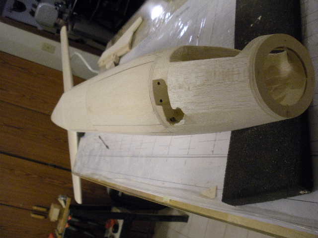

If you look at the two fuselages together in post #120, (in different stages of completion), you will see it pretty well illustrated. My fuselage is on the right and Kevin's on the left. When you look closely at mine, you will see ONE HALF of the fuse has been shaped, the other hasn't, (the side facing away from the camera). Notice how the fuselage sides stick up above the block just like yours. When you do the sanding, all that "melts" away, and you get a nicely shaped rounded fuselage.
As Bill said, get the nose ring set before sanding by mounting the engine and positioning the ring...then it's just a question of shaping away the excess balsa. That ONE PICTURE of the partially sanded fuselage bottom should be all you need, (along with the pictures of the nose ring position). Notice also how the hatches are rounded to conform to the fuselage shape.
Be careful...go for the obvious extra wood, shaving it off with the electric sander, (or razor plane, but the sander is more fun...ie quicker), until you start to get close to the bulkheads/firewall/spinner nose ring. At this point, slow down a little. DO NOT SAND INTO THE PLYWOOD RING OR BULKHEADS. Hold the fuselage up to a strong light periodically to see if you can see light through it anywhere (which shows thin areas), then carefully "go for it" until you can see how it's going to look. It really is quite gratifying to do this part of the fuselage...all of a sudden the plane starts to LOOK LIKE SOMETHING like a Simla.

Thom25,
Wow! I'm guessing that this is not your first model. Beautiful workmanship.
Thank you for the images and good description. I'm beginning to get a clue.
