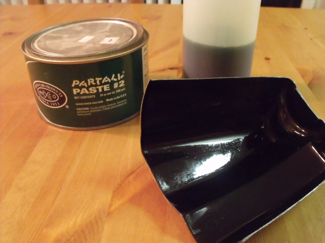

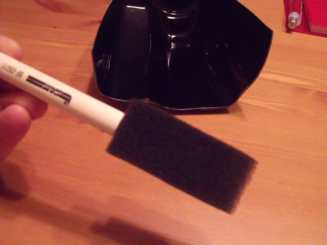

First step is to apply the mold release. There are many ways to do this but I stick with the tried and true method of waxing with Partall #2 and then applying PVA with a foam brush.
ID:	1827899   Click image for larger version

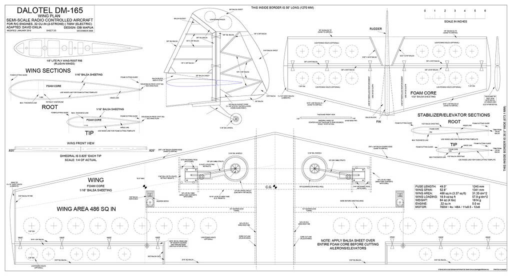

I managed to dig up the old Dalo plans I have been working over but haven't touched in a while. Originally they were 60 size and had some features which I found a little complex and perhaps unnecessary so I changed things a bit. I then scrapped the glow power idea and decided that I was interested in a TOC size (i.e., 90-120) electric version which led me to closing up the fuse bottom and going with plug-in wings as well as a removable canopy section. There were a lot of CAD details which I needed to clean up (probably due to different software interpretations of the drawings) and I didn't quite get finished on the fuse plans. The wing plan ought to be good to go. The airfoils used here are quite different from the airfoils you will be using.
Below are the scaled down plans for the "proof of concept" 30 size model. The TOC version would be the same in design with slight mods to wood sizing and whatever else I decided would be beneficial and learned from the 30 size model. The TOC version would be a 136% scale up from the 30 size or 6' in span.
I thought you might find them of interest.
David
