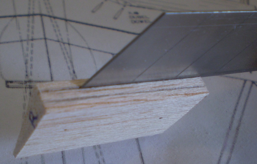

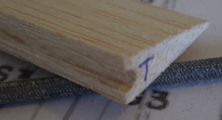

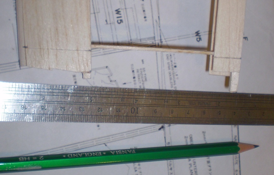

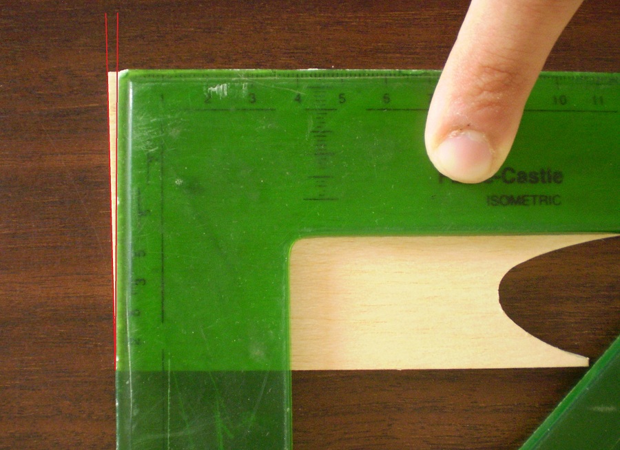

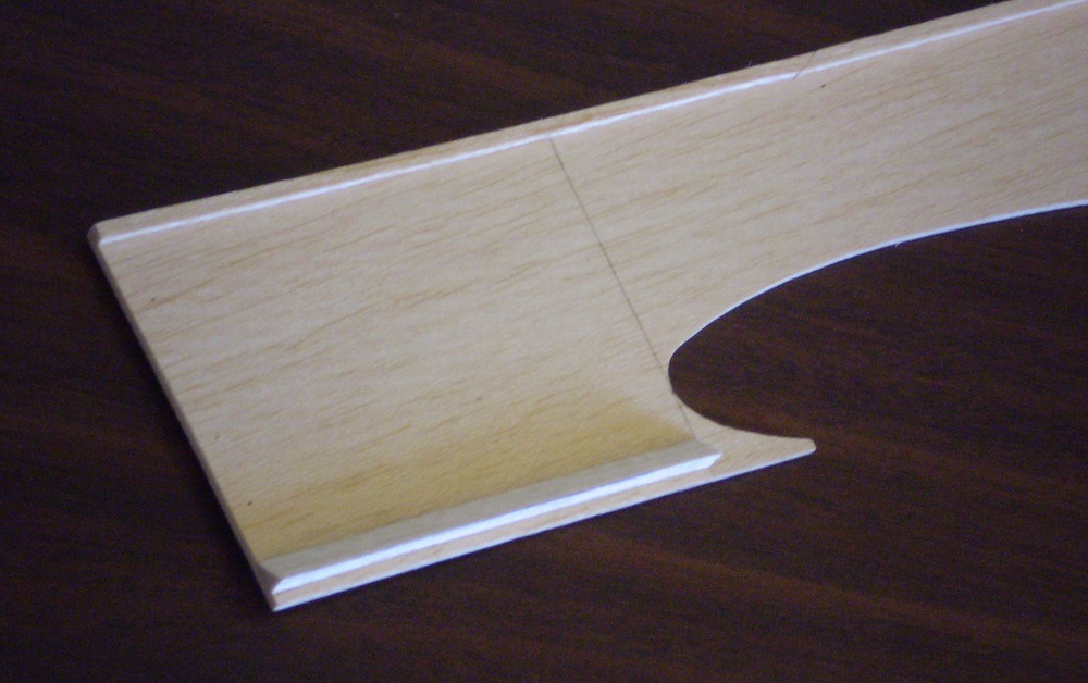

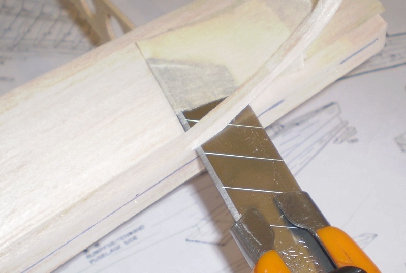

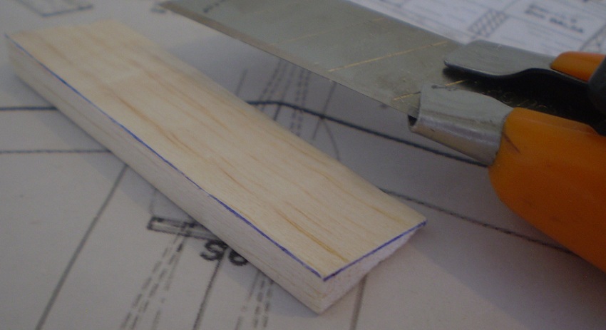

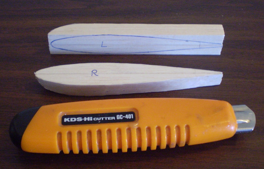

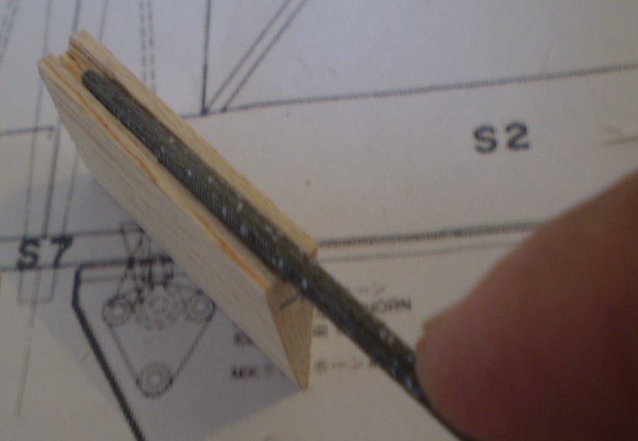

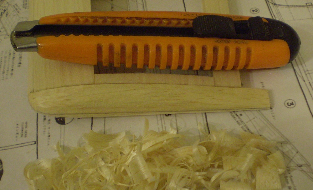

I use this step by step procedure to shape L.E.
1) a line must be drawn on the L.E which indicates the linear axis of the ribs,note this line is not necessarily the symetric line of the balsa spar used for L.E. but must join the symetric line of the wing's profile. this line guides you while carving the L.E. to know if you are carving toomuch or not.
2) to prevent any erosion on the skin caused by cutter I simply use a piece of tape at the tip of the blade to make a safe end blade.
3) L.E. is carved while the face of the blade is laid back on the skin. it's important to touch the skin with the face of the blade otherwise you will over carve the L.E.
4) a piece of tape is attached to the skinapproximately 1/8'' far from the L.E. this protects the skin from over sanding. thenL.E. must be sanded along with the the skin while sand paper touches the tape attached to the skin.
5) tapes are now removed and the rest of the L.E. is sanded equal from top and bottom of the wing regarding the center line drawn at the first step.
Ehsan

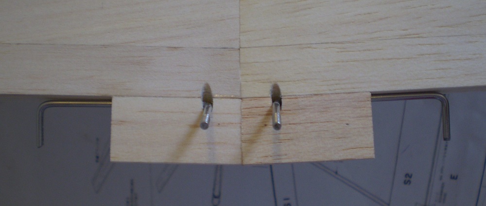

More progress but too slow.
Cap strips are now placed, and the excess balsa is removed from the tip of the wing.
I prefered to use bicyclespokesrather than original model linkage for aileron, costhey're made of harder metal, thus canwithstand more tortional stress. today I added more images instead of talking about what I did. I think these images can speak better than me.
Ehsan

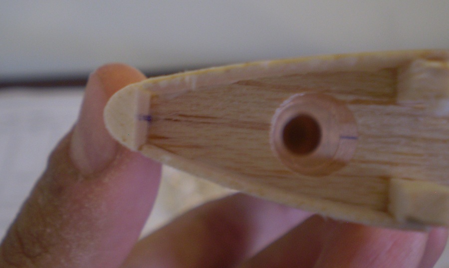

It is better to use bushing any bushing may add more weight to the plane. instead of bushushing - in this size of plane- I usually bend a pin to " U " shape and attach it with some C.A. to prevent any unfavorable movement of the torque rod. in the images below you can see this method I used in my New Era 3 .
Ehsan

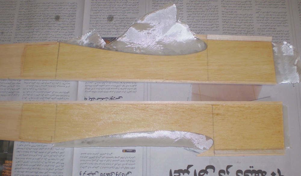

Hi every body,

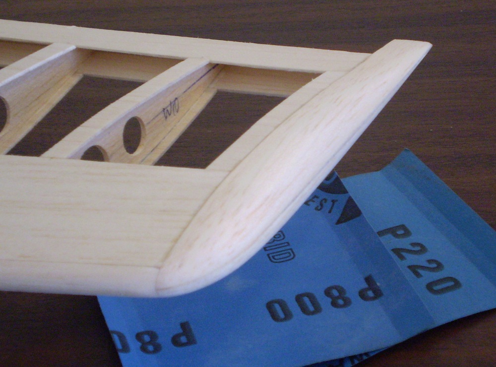

wing tips are now completed, they are made out of 1mm thick hard wood sandwiched between 2 layers of 10mm(3/8") balsa. then shaped to the airfoil.in this stage it's alittle bit bigger than the wing's profile at the tipof the wing. the blocks were hollowed by the means of a low speedhandpiece and a carbide bur. then wereattached to the wing with some epoxy. carved to exactly fit the wing. and finaly sanded gradually from large to fine grit sandpaper to shape its proper shape.
Ehsan

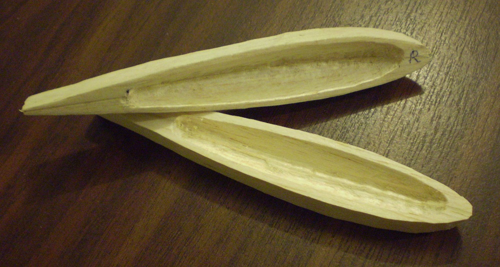

Hi again guys,
I was really busy in the past 10 days and was not home to work on the wing but last night I got enough time to finish the wing by making ailerons.
asitcould beseen in the images I do this by using 2 strips of 1mm balsa to make a hollowed aileron and save some grams. some triangular ribs were used in the structure, strengthening the aileron and bringing a higher tortional resistance. unfortunately I forgot to take photos of theses ribs glued in place.a small triangular balsa block wasusedto support the aileron torque rod as well.finally the wing tip and the tip of each aileron was beveled based on the plan.
Ehsan

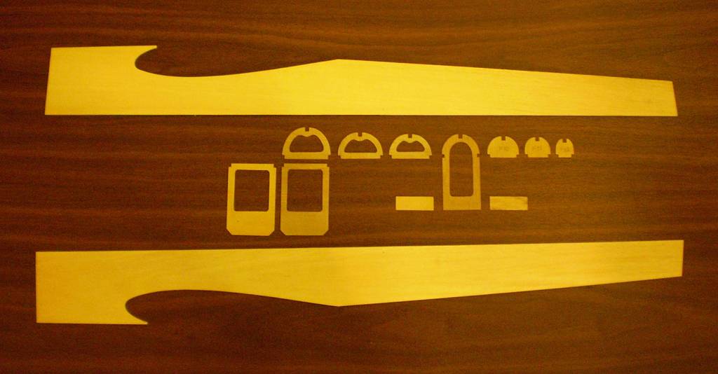

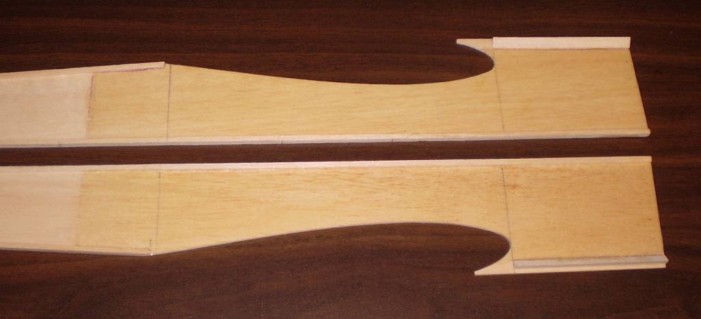

Starting the fuse by preparingthe sides from 2mm balsa.before cutting the sides I decided to angle the firewall. this way it would be very easy to mount the TT GP 07 whichis able to be mounted from the back plate. any corrections in thrust anglescould be done bysome washers addedbetween backplate &amp; firewall after the firs flight.
as it is clear in the images the down thrust was reproduced by drawing thrust line on the planand another line vertical to it where the firewall is located. Right thrust angle was reproduced in the same way , and this cause a shortened right side in comparison to the left side of the fuse.
Ehsan

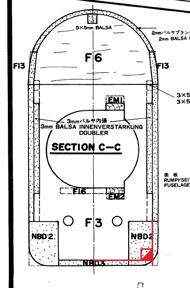

I'm working on the formers, for saving more weight I decided toreplacethe balsa blocks ( NBD2)used in the lower border of the nose with trianglar or square longerons. on the other hand the nosegear will be attached to the firewall with control horn instead ofthe fixed gear screwed to the 1/8'' PLY at the bottom of the nose as described in the plan.
Ehsan
