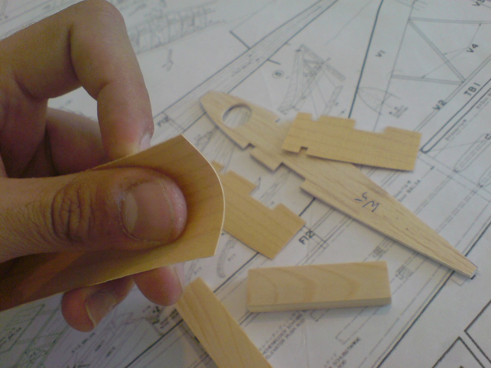

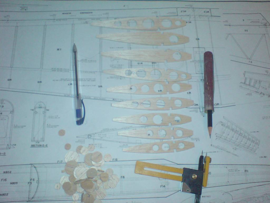

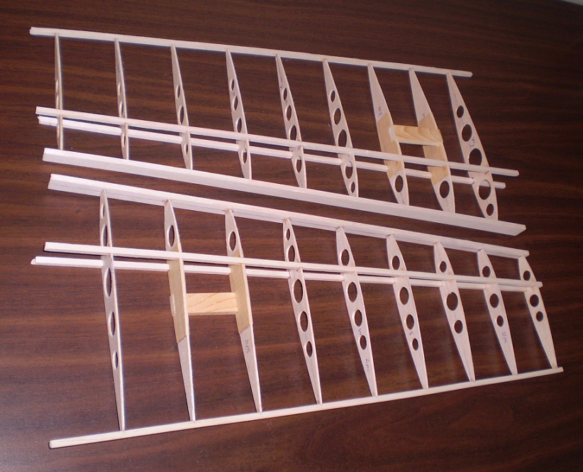

Hi RCU members.
I have flown many modern patternships but I believe you agree with me that nothing could be compared with flying a classic one specially when built in a smaller size.
I have read and followed many of RCU's perfect detailed threads and they motivated me to start mine. this will shows all procedures during building a small curare powered with a TT GP-07. I was very concerned with the proper wingspan and finally after consultation with some expert guys a 33 inches wingspan seemed to suit. I'm not a skilled builder so all opinions are helpful. stating with the wing andthesee images shows my last night efoort,

Hi,
Nice work so far. Will the wing be fully sheeted?
Jamesf

Hi Jamesf
I'm working on the wing pannel.No the wing won't be compeletly sheeted. I'm gonna use the "D" structure with shear webbings. Hope be strong enough. I guess I will upload some more pics of the wing progress tonight.
Ehsan</p>

Let me suggest the following:
Wings- use 1/32" sheeting maybe 5-6 lb density. Taper sand the tips to thinner than 1/32". Shoot for a weight of5-6 ounces for a 300 square inch wing
Ribs look awide to me which will result in a thicker section than the original wings in 60 size. Shoot for about 12-14% section
Thin walled 1/8" carbon tubing as spars and 1/4" LE should shed more weight; albeit more costly.
Fuselage- . I'd use 3/32" medium balsa (8-10 lb density) as sides and double the front.. I'd use 1/32" for top and bottom. Some 1/8" thin walled carbon tubes possibly as longerons. Fuse plusfinweight should not be more than about8-10.. ounces
75 square inch stab shouldn't weigh more than 1-1 1/2ounces
Empty weight should come in at about 1 1/2 lbs +/-. Flying weight should be around 2 1/2# for better flying with a 300 square inch wing

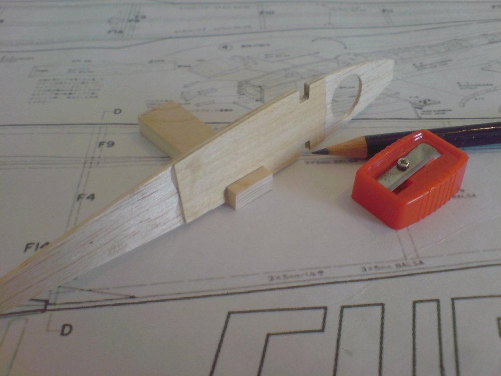

Now I'm back home from work .unfortunately I glued the main spars and L.E.&amp; T.E.last night, But as you care I'll Try to keep weight light.
I agree with you.3/32" (2.5 mm) balsafor sides or even thinner sheets like 2mm balsa may be allright. I will use a layer of epoxy and light cloth like 75gr or lighter from inside instead of balsa doubler. I use this method for lager planes up to 50 size engine - a hard 1/8" balsa with 120 gr cloth and epoxy doubler- 2 of the following pictures show my .46 curare built this way. you can see the cloth texture in the photo.unfortunately I didn't complete thecurare .46airframe and construction has been stoped almost from 2 years ago. just 1 week working makes it a flying bird.
Ehsan

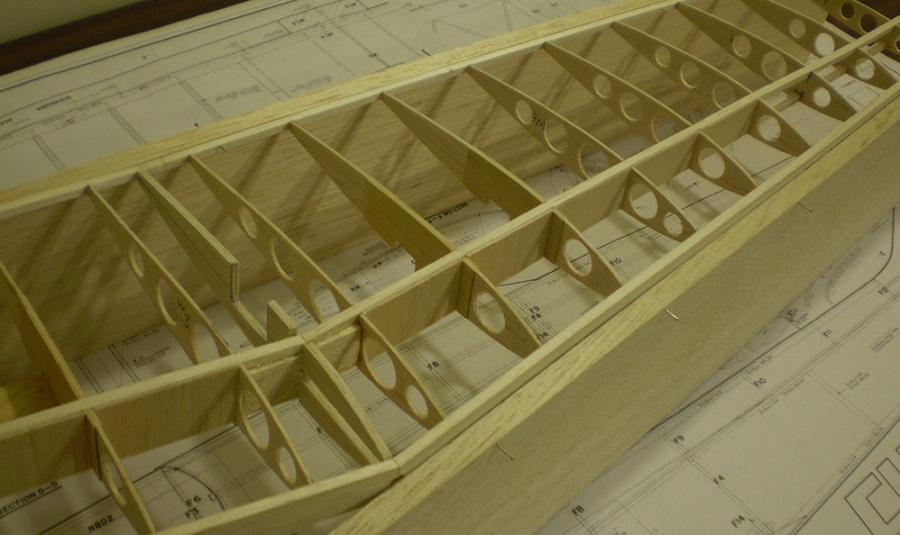

2 wing pannels are now glued to each other and the shear webs are placed. Note the dowel is not cemented. It'll be glued after carvingthe L.E.
Ehsan</p>

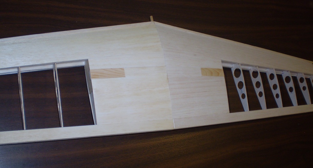

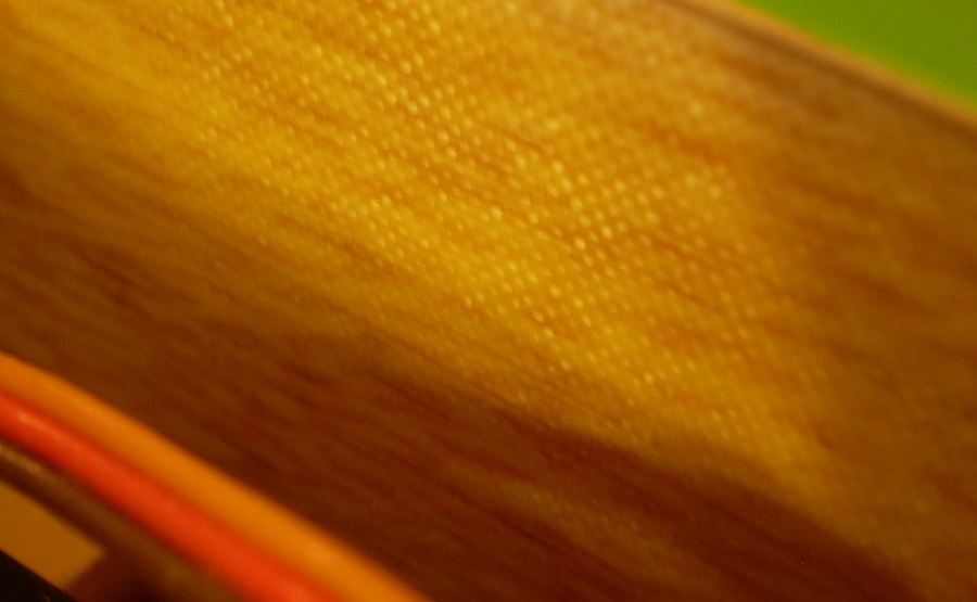

unfotunatelly there is not much progress on the wing pannel skin today. only one half has been completed. I continued procedur using the old wood glue and the result was really good. When using wood glue I'm not worried about the short setting&amp; working time butam always concerned with the time when I use epoxy. the only point which must be considered during using wood glue is not to use it on a big surface specially a big surface of thin balsa. If so ,balsa sheet will be deformated.
Note the the butt joint edges of the skin parts attached to each other with no step shown in the image.
Ehsan
