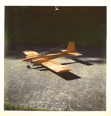

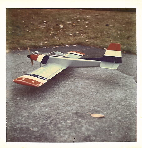

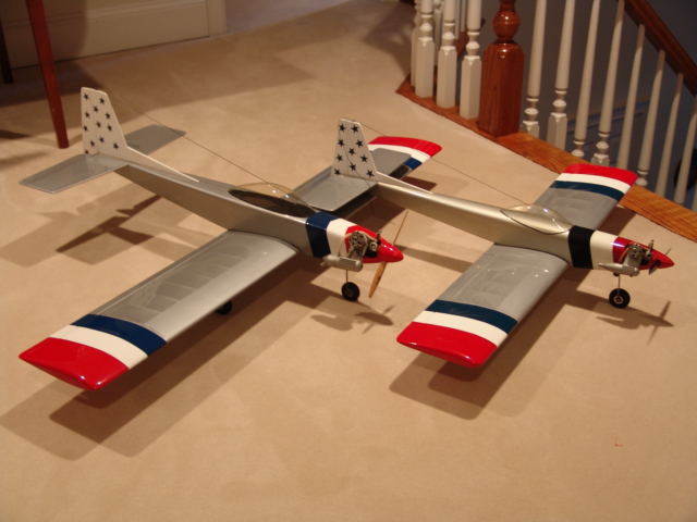

rainedav’s build thread http://www.rcuniverse.com/forum/m_3691626/tm.htm on his Kaos 42 reminded me how much fun miniature pattern aircraft are. Midwest upsized Phil Kraft’s Flea Fli to the Flea Fli + 10 and I have one of the kits that is in the pipeline for building along with a Tower Kaos 40 kit. The miniatures can be flown in small airspace and short runways. Because they are so small you tend to fly them close in and place your pattern right over the runway in front of you.
I have a 10 and 25 size pattern aircraft that I designed and built in the mid 70s and still enjoy flying them very much. The 25 has a 15% laminar flow airfoil and the 10 has a semi-symmetrical airfoil. The laminar flow airfoil has the thickest part of the airfoil back around 40% and has a fairly sharp leading edge. Both of the old original OS FP engines were replaced about 10 years ago when OS came out with the Schnuerle ported FPs. The new engines gave them a lot more zing! The 25 is all wood and the original 10 was all wood. The 10 shown is the second in the series and has a fiberglass fuselage and a built up wing and tail. The fiberglass work was done by a friend to my original design shape but with much rounder shapes. They were both built when I was in my silver, red, white and blue days! The 25 weighs 2 lbs 13 oz and the 10 is 2 lbs 5 oz.
Views of the 25 and the 10.

8178, those are great looking models. The 45° engine mounting is a nice touch. I like how it puts the mufflers along the side.
What are the control throws on those planes? I'm getting ready to program my radio for my Kaos 42 and I'm not sure what range to start with (although I'll definitely have dual rates).

The 25 has ½” up and ½” down movement measured at the trailing edge of widest part of the elevator and 5/16 up and 5/16 down on the ailerons. I usually have the rudder movement as much as possible without causing leverage problems on the linkage. The Kraft 7C only provides low rate settings from those listed above. I like to keep the standard rate control throw movement conservative for smooth flying at speed so what I use might not be enough for others. Enough throw that it will drop into a spin easily but still flies smoothly.
