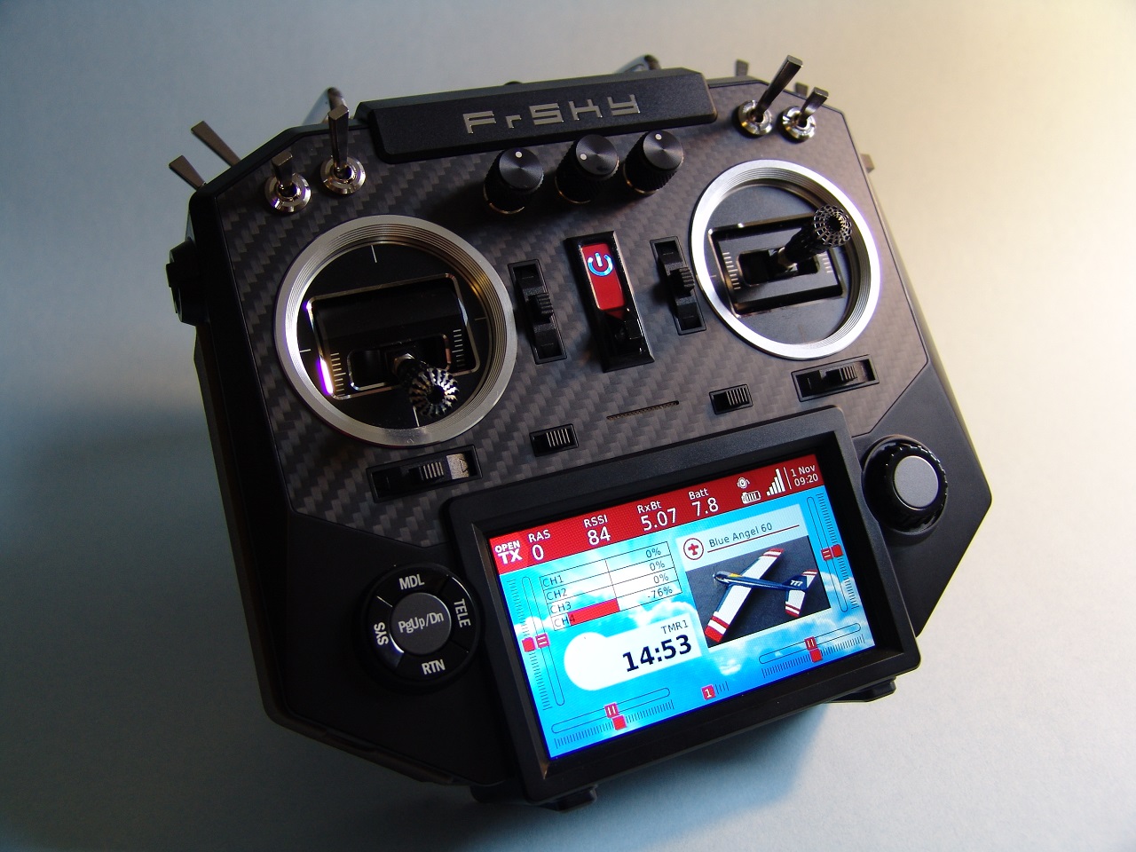

The new FrSky Horus X10S telemetry system. 16/32 channels, CNC metal gimbals with ten ball bearings and digital Hall Effect sensors, runs FrOS menu driven system or OpenTX. Shown programmed for the Blue Angel and running OpenTX.
Mike
