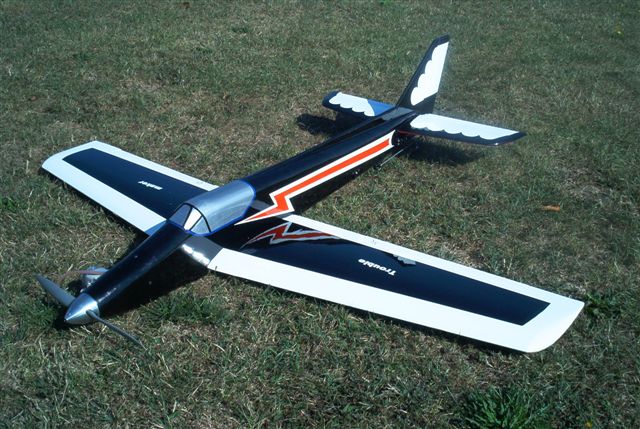

Here's my take on the Troublemaker from the Eureka kit. The picture was before the first flight in fact I hadn't put the wheels on yet.

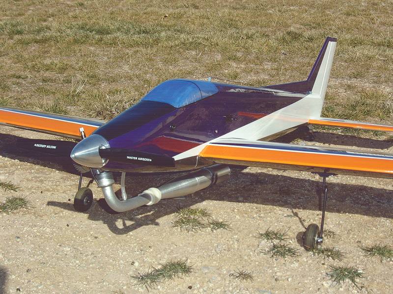

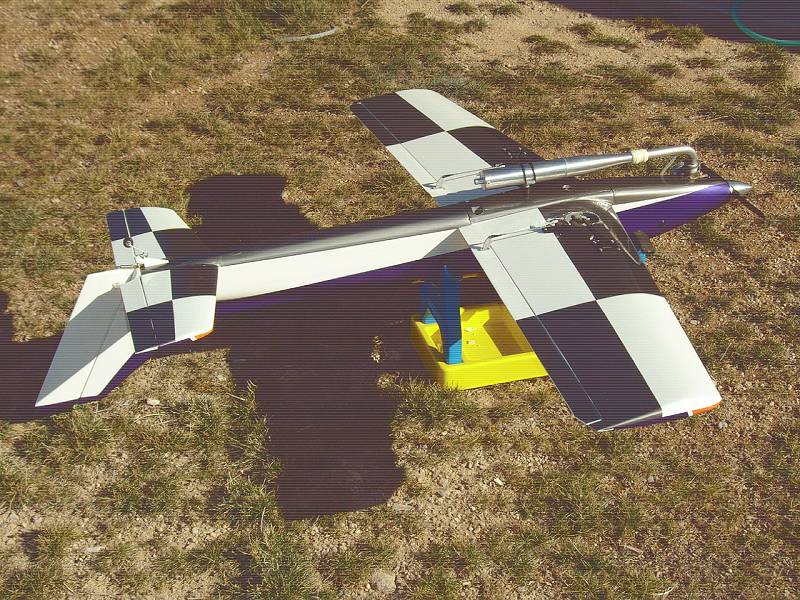

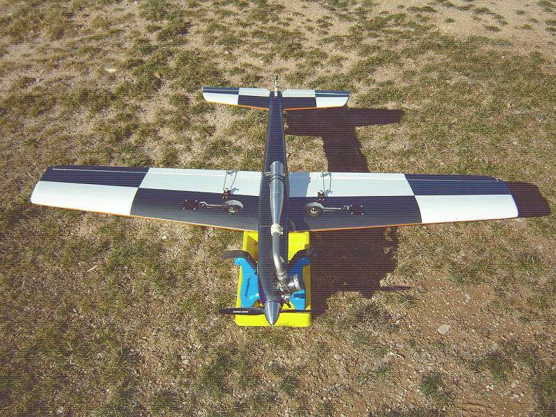

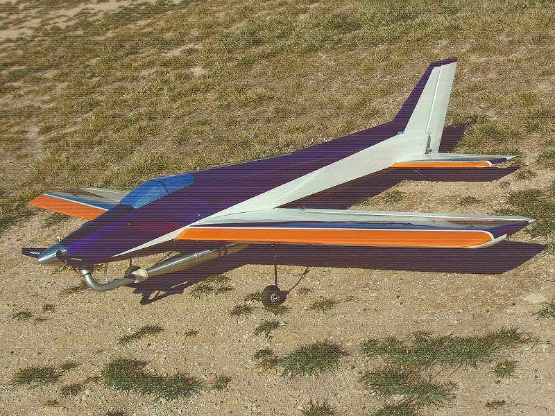

Well fellas, she's done as far as the build goes. Got her done today and balanced... came out more nose heavy than I though she would. Had to move the battery and rx rearward in the radio compartment. After that she was right on the CG from the plans.
I don't have a high-tech scale in my shop, so what I do is step on my digital scale without the plane, step off, then get back on holding the plane. It showed 6.5 pounds, but we'll just round that up to seven. When I have more time I'll sit her on the digital baby scale we bought to weigh the kid. That will get it down to the ounces.
I set the ailerons and elevator throws to 10 degrees low-rate and 12 high rate.. probably WAY too much, but I like them to have as much authority as possible for maidens. You never know when you might need it. After the maidens I start bringing everything down.
Next step is to go out back of the house here and run the engine. I probably wont get to that today, but it will be done soon. Most likely maiden this thing by next weekend. If she flys good I've got some cool ideas for graphics.
Sorry for the fuzzy pictures, my camera screws up now and again.

Well, she has officially flown. I took her out today and flew her three times. A few clicks of right trim and one or two down and she was tracking like an arrow. I initially had the Master Airscrew 11X7 on it and we tach'ed it at 13000 rpm. We then put an APC 11X7 hand got 13600 out of her and more speed. Can't wait to try the 11X8 or maybe a 10X10.
First flight I mainly made trim passes. Second flight I tried several half-reverse cubans. Third flight I did all these plus the 3 loop sequence. I have to say, having never flown one of these type planes, I can see why you guys like them so much! I got a rush every time I poured the coals to it coming out of that 1/2 reverse cuban. WOW... In fact, one of the guys at the field who flew this type of pattern years ago asked me why I was throttling back at all!!! So, I did several with full throttle and the Rossi, nor the plane even flinched.
The landings were surprisingly easy. That is until I touched down with a slight crab and turned one of my retracts 90 degrees. Whoops! Forgot to file that flat spot on the strut. It nosed over hard and dented the header, but it didn't break. It cracked one of my retract mount blocks, but that can all be fixed. I'M OFFICIALLY HOOKED!!!
