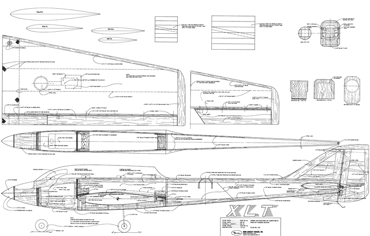

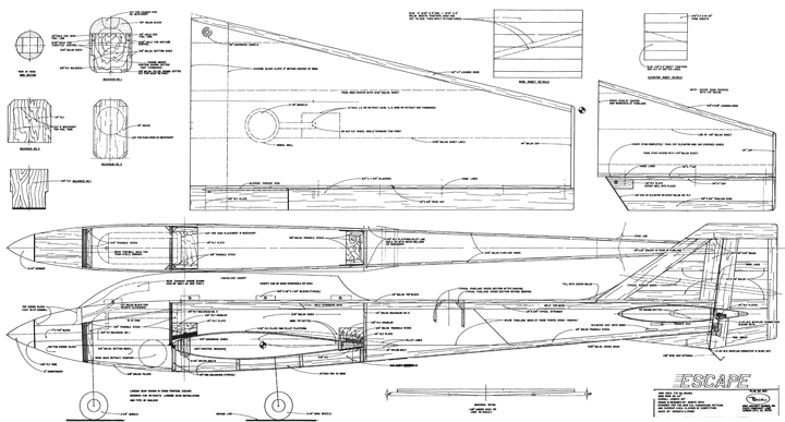

David, Dynamic Balsa does have the Escape cores. Measuring off the plans, the root chord and span of the Escape and XLT cores are the same. The Escape has a little more sweep and the cores have a 6" tip chord whereas the XLT cores have a 7 1/2" tip chord. The Escape cores can therefore be used on the XLT fuselage, you'd just have a little bit more LE sweep and bit less overall wing area. You can tell I'm not a hardcore purist.

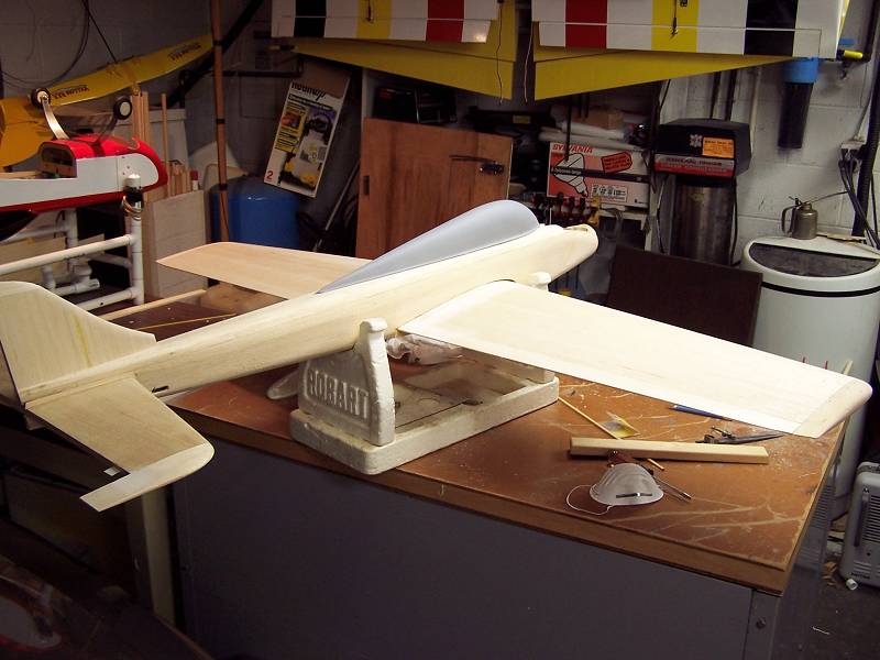

After looking at all the DB's here on RCU I thought I'd post a pic of the DB Version I'm building. I say version because I've added a small belly pan to the wing to fair it to the fuse better and I've whipped out my own canopy made of Fiberglass. I'm going to be putting in a Rossi 61 rear exhaust, so I want to run the pipe thru the canopy. I know , I know I won't have much canopy left in the end but I just had to try. Oh yeah, taildragger with retracts. (Yes I've read the thread about nosing over after I made the decision to make it a taildragger. I'm hoping that my superior flying skills and the fact that the Lord protects fools will let me get away with it;-)
Now the pic is of the rough sanded plane and the canopy just sitting on top of the fuse. When I get it finished in a year or two I'll send a pic of it finished. (I hate covering!)
Mark

Looks great Mark. That rear 3/4 view of the DB/UFO is one of my favorite shots of any pattern plane. They just look so cool from that angle.

Nice job on your canopy Mark, can't WAIT to see a pipe going thru it! Sure enjoyed my old Dirty Birdy, makes me want to build another. Keep up the good work- don't keep us waiting for 2 years!

Rainedave, You may want to have your eyes checked before you fly again, mine can't compare to your efforts. And yes I also love the 3/4 view of pattern planes. I don't want to live in a world without good lookin planes! Thanks for the compliment.
Jeff, Thanks for the compliment. Got some bad news, I've decided I can't cut my canopy and I'm going to use a side exhaust engine. (I can be such a wimp at times.) This is my first DB, although I've built many Super Kaos'. I hope I can enjoy it also.
