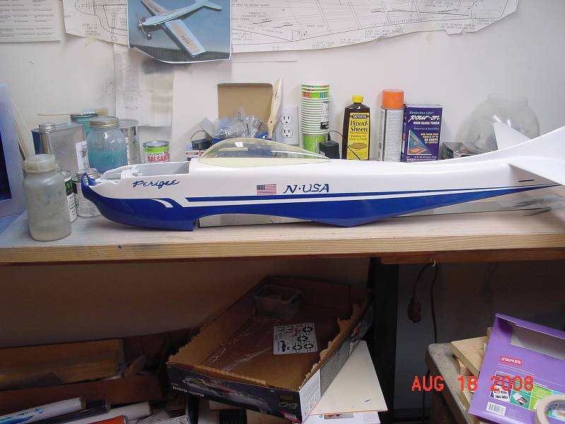

OK, OK, I couldn't wait..................
Yes, I carefully applied the dry transfer flags while the epoxy was still wet. And wait, there's more.....
I put the yellow canopy on top, just for the effect.
OOOOOh, I'm psyched to finish it. The final push is upon me.

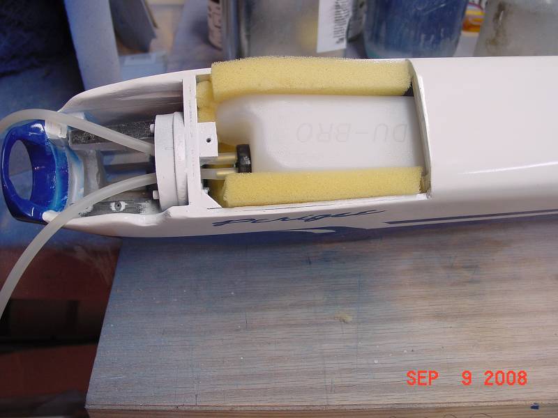

So now we can actually start to populate this shell. Let's start with the 8-oz tank, shall we? I have used this method since the 70's and it always works well. First, the empty compartment and the tank orientation. I needed to put the tank on edge to clear the body sides.

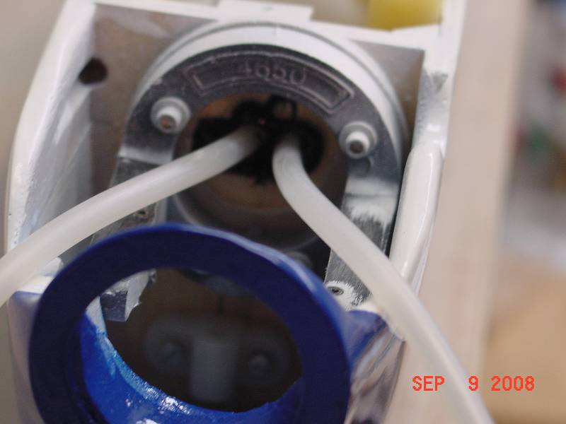

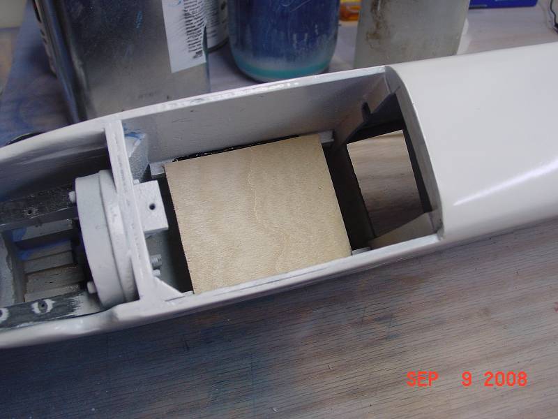

Next step is to install the 1/8" ply base onto the rails which were put in when the fuse sides were being laid up. It is stuck in with RTV (I had black on the bench). I don't worry about fuel proofing it, since it can be pulled out and scrapped if there's a problem. The fuse sides did get a coat of epoxy on them, plus paint spray.
Second photo shows the tank, nicely nestled in a bed of wrap-around foam, with the fuel lines going through the firewall cutout.

Next step is to seal the fuel lines where they go through the firewall. I had cut an adequately large hole in the firewall when I made it. Next I thread the fuel lines through and seal the opening with more RTV. It makes the perfect seal. Fuelproof, flexible, and if I have to take the tank out, I can cut the entire opening back out with an Xacto knife.

FInal step, put a piece of foam to isolate the tank from the hatch, then put the hatch on and screw it down. Next step, do I do the engine or the servos?

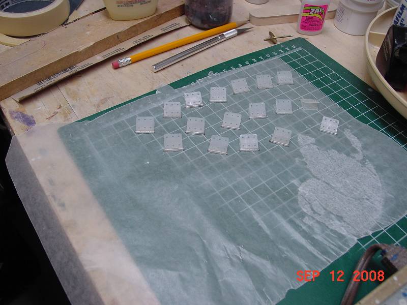

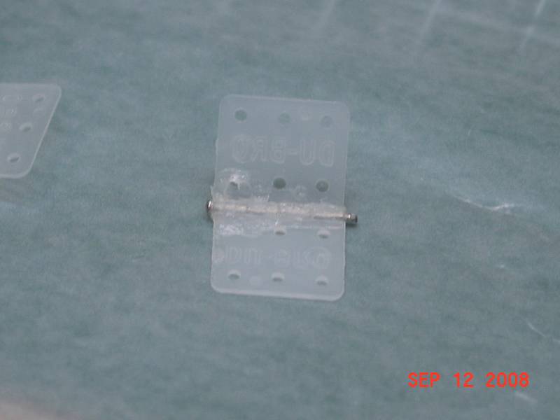

Tonight, small progress:
What I did is to coat the hinges centers with vaseline. Here's how I did it:
get a little cup (plastic) and melt vaseline. Take each hinge, bent double, dip the center into the liquid, reverse the bend, put it on wax paper.
This will grease the hinge line and prevent the (future) installation of epoxy hinge attachment from binding up.

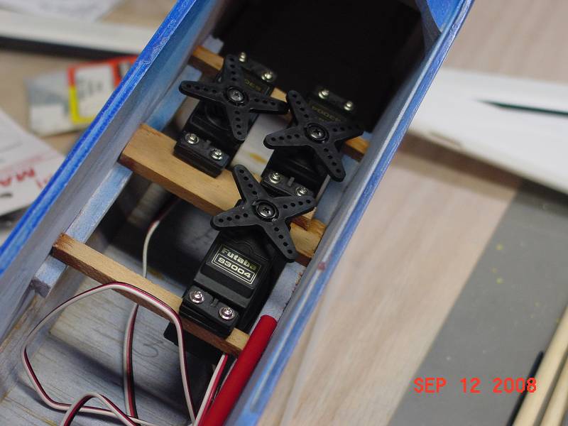

Old 09-12-2008 | 09:06 PM
  #325
WEDJ's Avatar
Joined: Feb 2007
Posts: 1,739
From: Stockton Springs, ME
Default RE: PassTime Perigee Build thread
Tonight I decided to put the servos in. Nothing special, just spruce cross members CA'd in, pre-drill holes for screws. I raised the rudder servo so the steering nyrod would clear the throttle servo. Always something........
