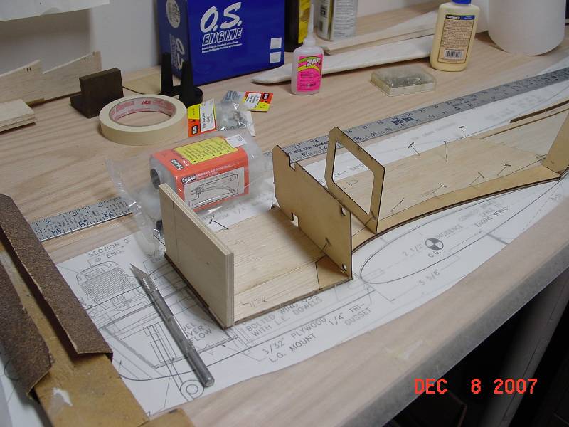

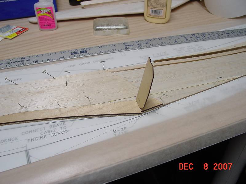

So now I'm starting the fuselage. We have several problems here. First, as I mentioned before, I need to make a 1/4 ply firewall to use a standard mount and nosegear bracket. You can see that in the first photo. None of these are glued in, they are just placed there for now.
Also in that photo is the second former, which is at the wing LE. This is a big problem. 1/16 ply just isn't going to be strong enough for the wing dowels. Plus, the fuel tank will extend through that bulkhead. My solution will be to face it in 1/8 ply at the bottom and sides, then cut out the middle for the tank. That should work OK.
The former behind that is OK as is. (middle of wing saddle)
The stub former at the TE of the wing is again not adequate for the plate that will have the rear screws of the wing. Plus, it does not go up all the way on the fuse. Again, I will add material. This time I think 1/8 behind, and some 1/16 ply up to the top, with a cross member.

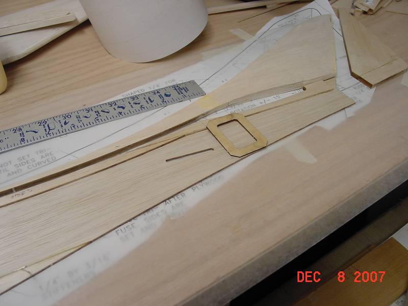

Which brings us to the rear of the fuse. This bulkhead is totally wrong. Look at the photo, the left edge is where it should go. Notice that it does not go far enough up, it is about 1/2" short of where it should be. Also, it is not notched out for the stab doubler that is already glued in place.

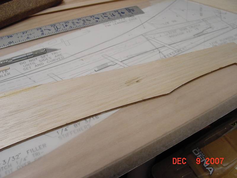

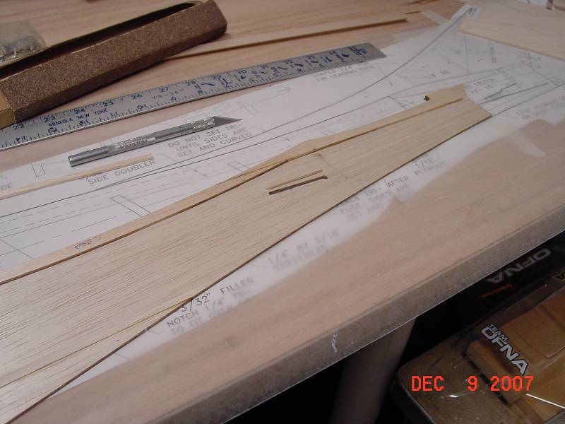

Next order of business is to plug the pre-made pushrod exits. I think mine will be different, and now is the time to do it. Very easy, carve to shape and plug in with CA. Flip over, and sand lightly on the outside.

Lastly, the time-honored tradition of building one side over the other to assure they are symmetrical. In this case, the right side is put upside-down, then wax paper laid down, and I will start to make the left side to match. Maybe more tonight, or tomorrow.
As far as tools go, I have just been using an Xacto knife, french curves, straight edges, T-pins, sandpaper (60 grit and 220), nothing exotic.

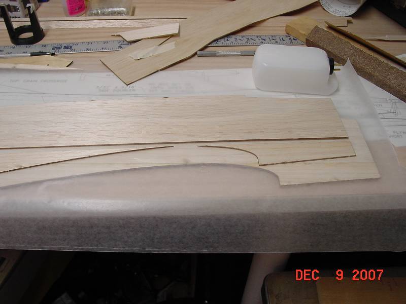

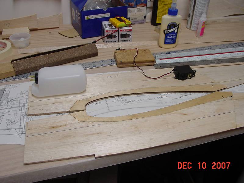

That's right. Tonight I put the fuel tank and the servos on the body sides, figured out where I want the triangle support stock, and marked it on both sides. Will make installation much easier later.
Oh, and I have a plastic cup with about 1/2 ounce of epoxy curing at an angle. 3/32" across the width of the bottom. Thanks, Dave
