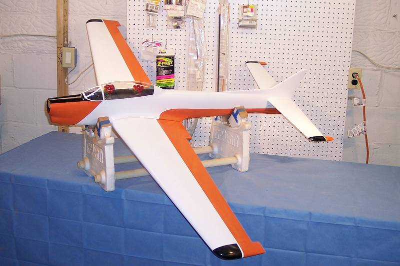

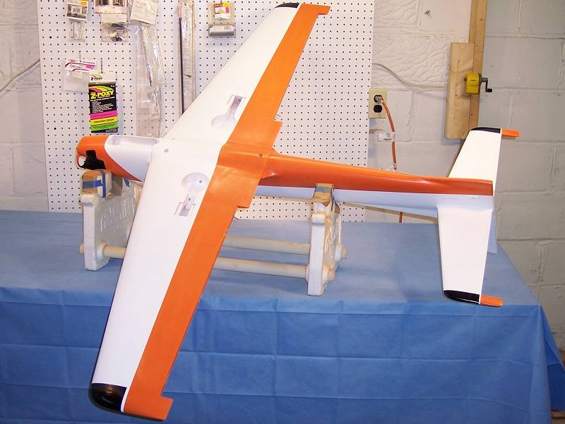

Finally I was able to get back to my bird. I now have all the color coats in place. I know the orange line on the fillet and wing don't line up, but they don't on the full scale either. I hope to get markings on the wing by the weekend to keep my inspired....

Nice looking. When you shoot, do you use a booth?

I just shoot in my room. Everything is water based. I just cover w/ plastic on the walls and drape my door closed. I keep the finished birds in a different room.

Great Looking Plane EDP..... I'm sure it's going to look fabulous rigged up and flying..... nice paint too!!

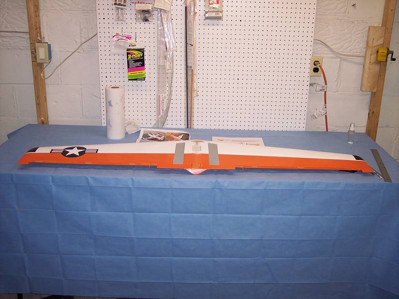

Well, I knocked out the wing last night and is now ready for clearcoat. We are schedualed to have a blizzard today in NE Ohio so I will hit the fuse. hard. You can go to www.nelsonhobby.com to read about his paint sytem, or better yet, just call Jerry.
