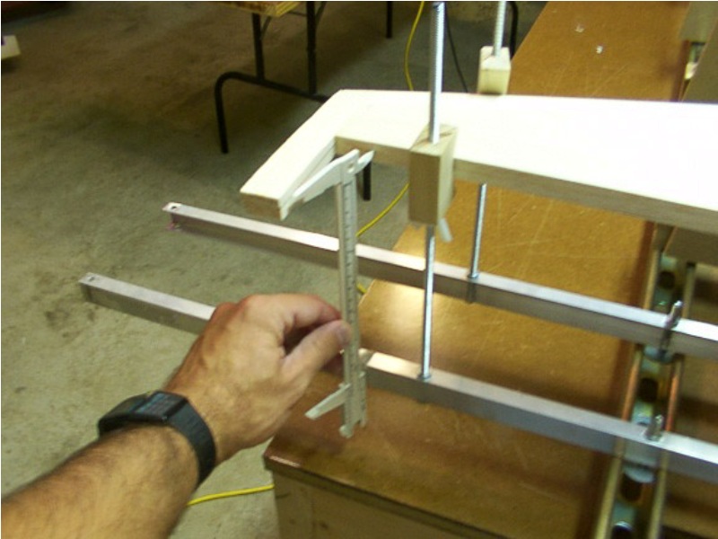

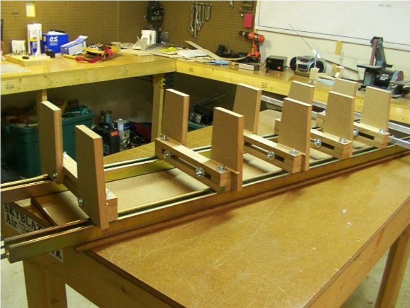

Old 03-04-2010 | 07:48 PM
  #69
klhoard's Avatar
My Feedback: (10)
Posts: 1,289
From: Collierville, TN
Default RE: LA1
That was 1.5 wives ago. . . I still have the jig and can take new pictures of it for you. Any part of it you are interested in?
ORIGINAL: tph1
Keith, A few yrs ago you had a fuse jig on here, I built one and it worked well, do you have the pics of that thing?
Tom
Old 03-04-2010 | 08:08 PM
  #70
PatternPilot's Avatar
My Feedback: (58)
Posts: 1,807
From: Knoxville, TN
Default RE: LA1
hmmm 1.5 wives ???? how about the one with the Titan is she still around ?
scott
Old 03-04-2010 | 10:39 PM
  #71
klhoard's Avatar
My Feedback: (10)
Posts: 1,289
Default RE: LA1
Wood Titan wife - gone.
Glass Titan wife - Still here, definately a keeper!!
I built the fuse jig half way thru the Wood Titan wife's tenure. . .
The rails can be found at Home Depot, the rest is 3/4" MDF and 1/4-20 bolts / wing nuts / washers. The little sliders on the vertical supports is 1/8" lite ply. The critical part is having a good table saw to make sure all of your cuts are perfectly square. Luckily, Wood Titan Wife's father had a good table saw in his shop.
ORIGINAL: PatternPilot
scott

the pics of the base of the jig stations is what I couldn't remember

I found all the nuts bolts and fender washers, now all I need is to know the width of the unistrut, is it one foot?
