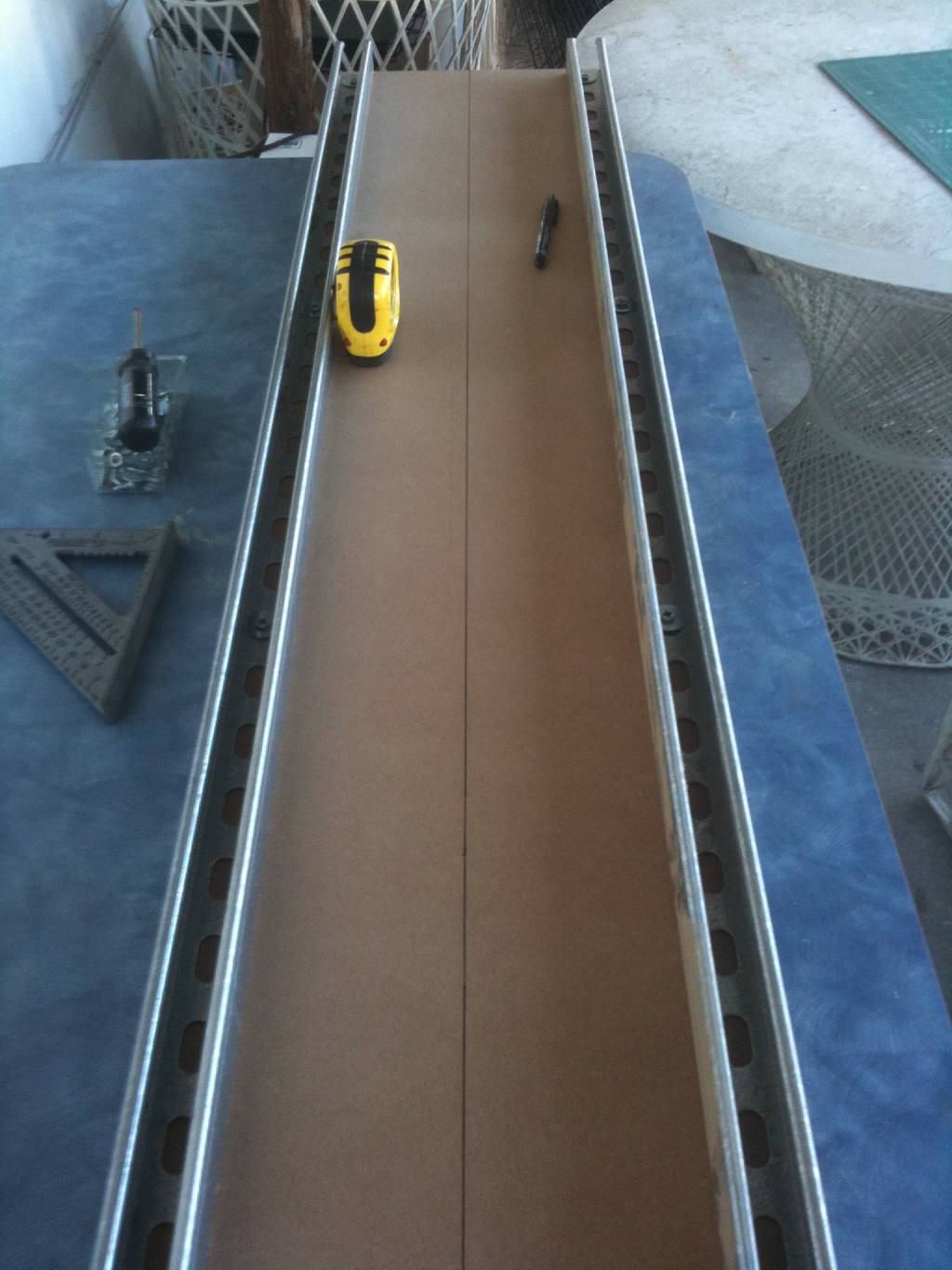

The metal rails are permanently secured to the MDF base, which is (I think) either 12 or 18 inches wide by 6 feet long. If you look at the end of the pink arrows, you can barely see the fender washers that hold the fuselage stations to the rails by gripping under the little lips on the rails. By loosening the wing nuts you can slide the stations along the rails, then secure them by tightening the wing nuts.
One modification I would suggest is to add pieces of wood to the bottom of the station that are perpendicular and flush with the rails. One of the big pains with this jig is having to make sure that the staitons are square and centered each time you move them.

I still have my 6' pcs of unistut and I'm going today to more MDF, I am going to cut the vertical pieces at 90* angles and make the holes in them that the bolts go through the right height to take care of that little problem you mentioned
thanks
Old 03-06-2010 | 04:37 PM
  #80
My Feedback: (12)
Joined: Dec 2003
Posts: 1,025
From: Rockledge, FL
Default RE: LA1
ok, off to a good start, now I need to know the width of the hor. stab pieces

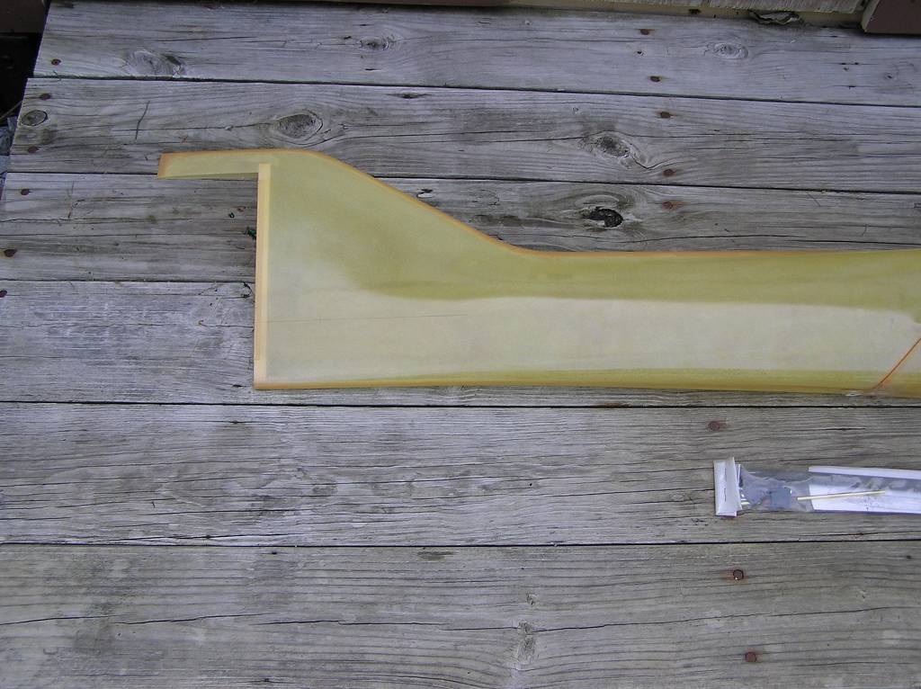

Can you still get plans for the LA-1.. Look at these photos and see if you think this is a LA-1 fuse.

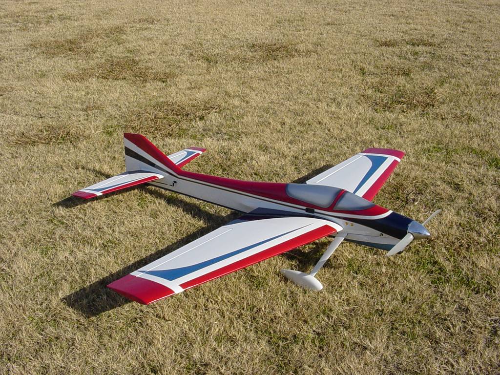

Here's my LA-1. 18 years old now and....don't shoot me....never flown. It is still in perfect condition. Even have the YS .61 NIB ready for it. I'm so not a builder. I drooled over a LA-1 for 2 years when I was in college and finally got one. We almost had it done before I moved away to the land of dust and cactus aka Arizona (so good to be back in Texas). I wish I had the time and desire (sorry Mike) to finish it. Actually, maybe it's just the know-how I need

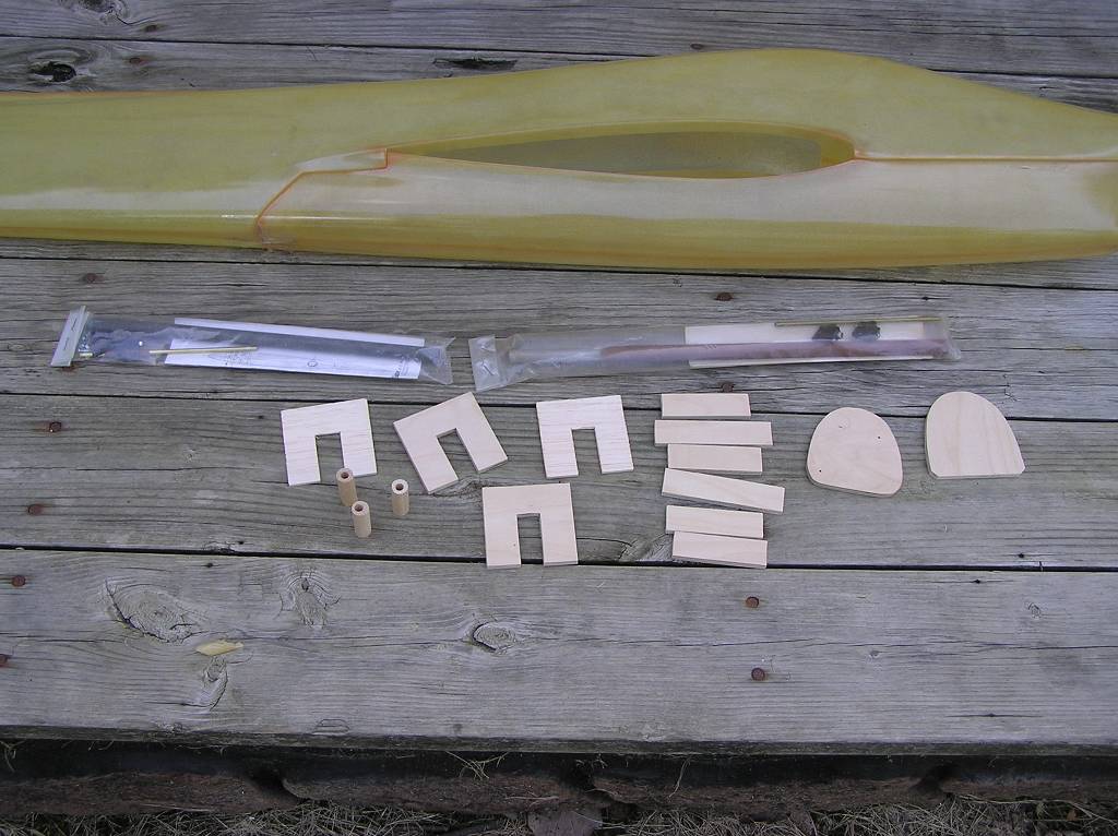

I know we are talking about the LA-1 but I saw some info from Geoff about plans for the SL-1. I built and flew an SL-1 about 7 years ago and I have to say it was one of the sweetest flying planes I ever owned. Had a YS 120 in it and I loved the plane. Attached are a couple of photos. One other thing. In looking thru my "inventory" of older pattern planes I have the following kits: Summit 120, Elan, Finesse and Conquest or Challenge VI (the reason for the confusion is that the box with the foam cores has both names on it so I am not sure what it is). I will post a photo of the fuse and see if you guys can identify it. The reason for mentioning these planes is that if someone needs to make molds of the glass, I have the parts available and will provide them as long as we are not violating any infringement laws or we have the permission of the owner of the rights.
