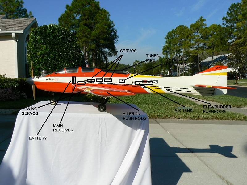

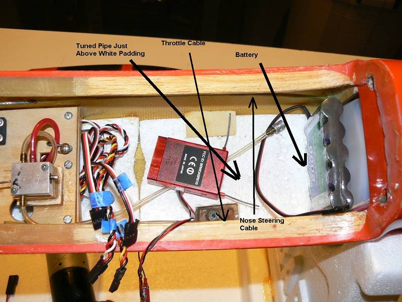

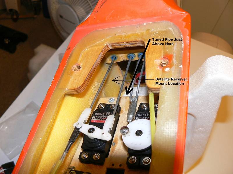

I was considering putting a JR R921(2.4Ghz) receiver in my T2A MKII to replace the Futaba 127DF(72Mhz) receiver. The tuned pipe runs just above the receivers. The most open area I can find to mount the satellite receiver is just aft of the servos. This will place it between the tuned pipe on top of the fuse and and the metal pushrods going to the elev/rud. Has anyone installed the 2.4Ghz Spektrum/JR receivers in an installation like this and flown it? I would like to change this plane over to the 2.4Ghz JR system, but the antennas will be awfully close to a lot of metal. Also, not shown in the photos, there is a metal cable going to the nose wheel steering on one side of the fuse and a metal control cable to the throttle on the opposite side of the fuse.

I find it interesting that so far no one has replied that they have made the transition to the 2.4Ghz system with these old birds. One thought I had in placing the satellite receiver was to use a quick disconnect receiver extension like this, http://www.horizonhobby.com/Products...rodID=SPMAJST6 . That way I might find a suitable location in the wing to mount the satellite receiver.

Horizon offers different length extension wiring for the satellite receivers. There should
be one long enough to put the receiver almost anywhere.
tommy s

I'm using the Spektrum 6 channel RX which comes with 1 remote RX. I put the RX's so they're imbedded in a soft foam rubber cube with the antennas orthogonal to each other (one points horizontal, the other vertical). This sits above the wing wedged in the fuselage cavity behind the throttle servo. The tuned pipe runs along the top of the fuse so it's directly above this setup.
I've gotten over 40 paces in a range check and I've flown the plane to the limit of my eyesight. It's totally bulletproof and I'm very happy with the results. It's as fast and furious as ever.

This is a complete no-brainer. The Spektrum receiver placement is not critical at all. Its only a little bit of an issue if there is a lot of CF in the model, but that also easy to get around by moving the remotes till the reception is best.
We've flow it it many different types of models in different configurations and it just works. Personally, I will never fly anything but Spektrum 2.4 again in anything.

Well I'm proceeding with the installation. Thank goodness I'm using the JR R921 receiver which is compatible with the Data Logger. That way I can do the advanced range check and see how all the antennae are receiving and check for holds and fades. This airplane has so much STUFF in such a small volume, it reminds me of what Dolly Parton said her dad had commented. Referring to Dolly's attributes, he stated, "It is surely hard to put ten pounds of flour in a five pound sack." I mentioned above I was thinking of placing the satellite receiver in the wing. Won't work. So it all is going in the fuse.

The fuse is done with all but the throttle servo to be travel adjusted. I have one clevis to attach before I can adjust the throttle. Then the wing will be attached and I will rebind the whole system for neutral and gear down fail safe positions. Then I'm going to do the advanced range check procedure and check the data with the Data Logger. Will report when done with that.
