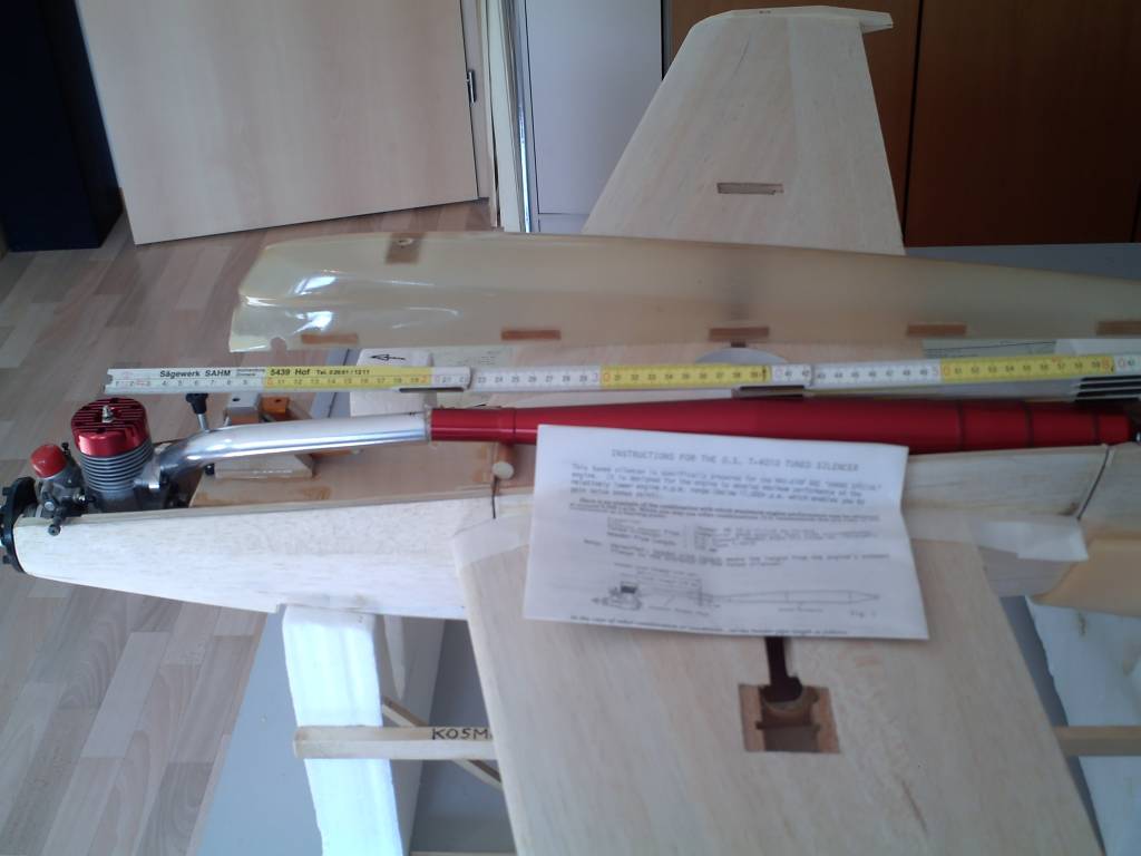

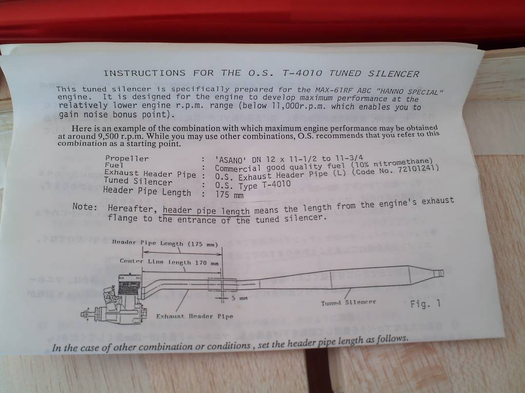

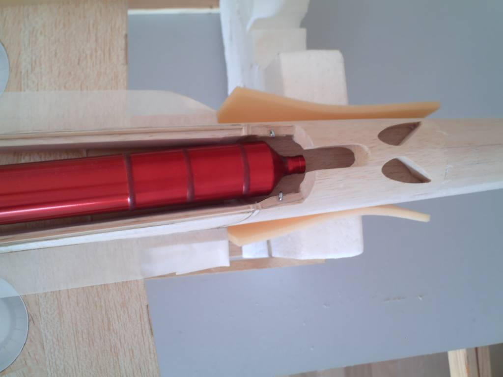

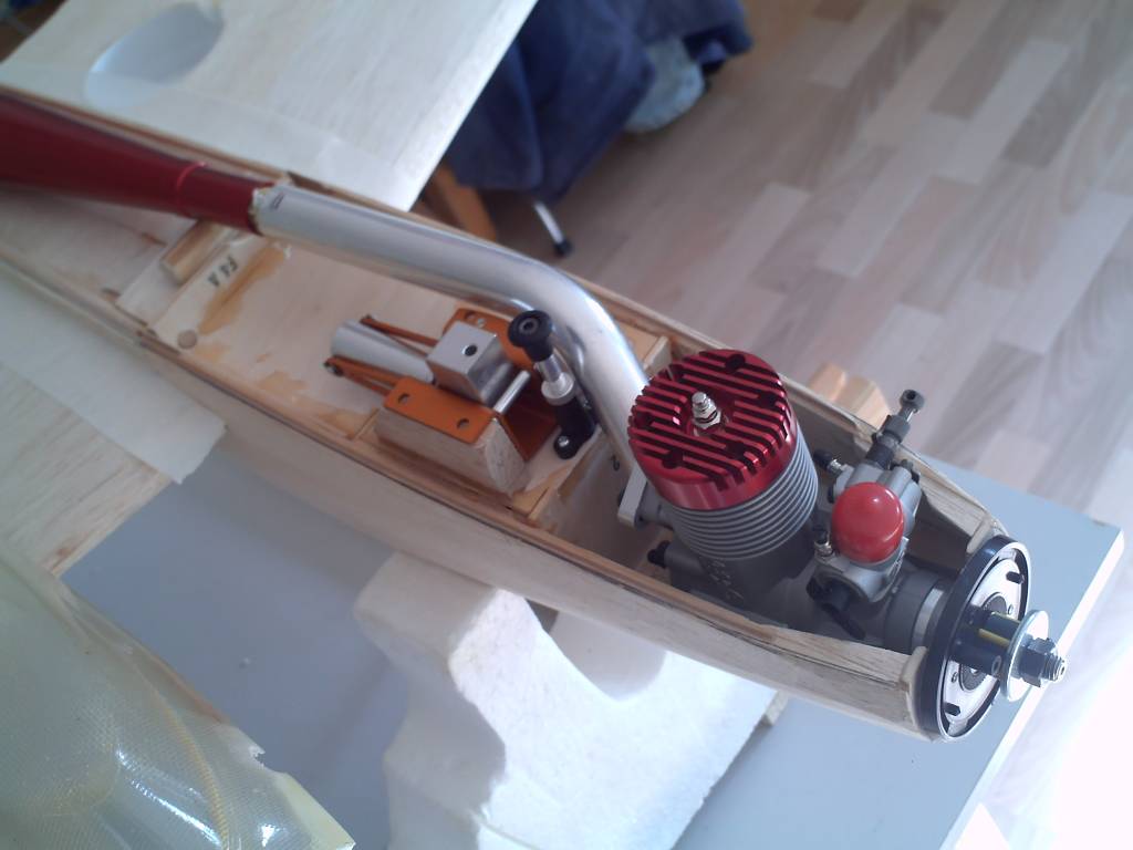

The tuned pipe just fits into the Aurora with uncut header. Distance from glow plug to first weld seam of the T-4010 pipe (I think Hatori´s #650 has shorter distance to baffle?) is a full 20" (510mm). Distance from pipe intake to first baffle is 12".
As per OS´s recommendation, this out-of-the-box setup would be starting point for 9.500rpm goal and a 12x11,5 prop.
So, I would expect to shorten the header pipe some 1-2" to result in approx 10.500rpm on ground.
Next questions for your advice:
- Pre-heat the engine before first fire-up by a powerful hairdryer? Is this a myth or worth doing it?
- Castor oil for first break-in period or same fuel as later for flight (synthetic oil)? This may be even more a question of beleive.
I made good experience by burning first half hour pure castor/methanol mix and then immediatly change for another 15min to my std. fuel (15% synthetic oil, 8% nitro) to get all castor residue out of the engine.
Some pics attached, thank you for your input.
Dominik

I'm running mine 19.7" from the glow plug to the first baffle..That's turning 10.3k static with a Bolly EQ-62 CF pipe, Powermaster YS 20/20 fuel and an APC 12x12 prop...
Chuck
P.S. Where did you get that belly pan mount thingy?? I like that allot!!

This belly pan fixing device was included in my Aurora kit. It was in its own small plastic bag and it also did have a small piece of the plans, where it was shown instead of the original thing made from bent sheet metal. The down part of it is adjustable, very cool. Like those MK details.
