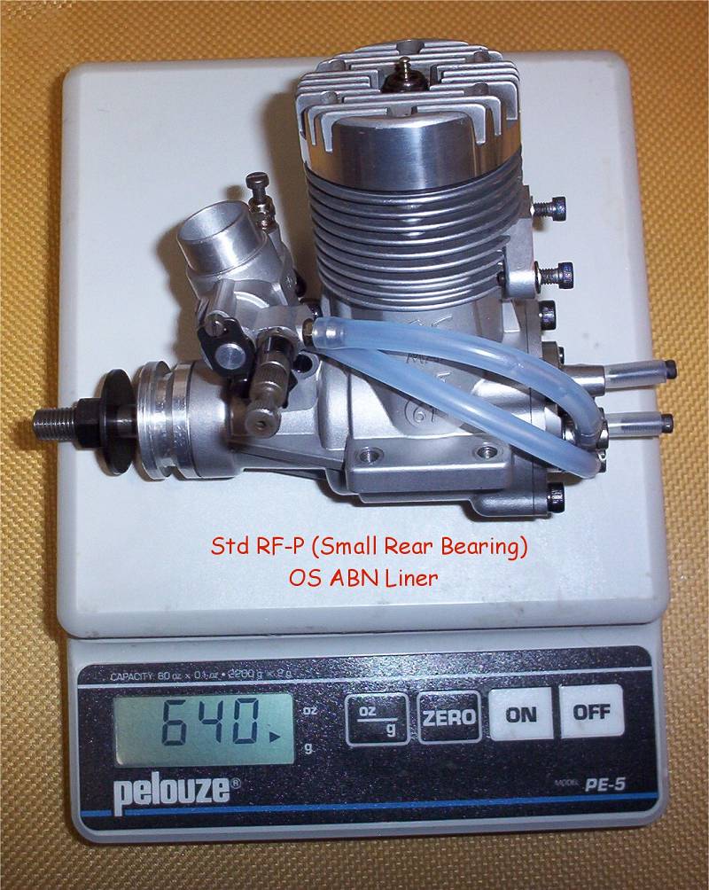

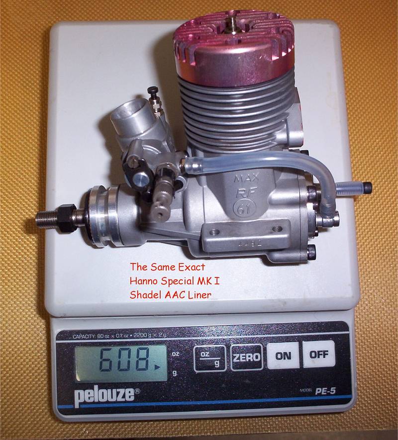

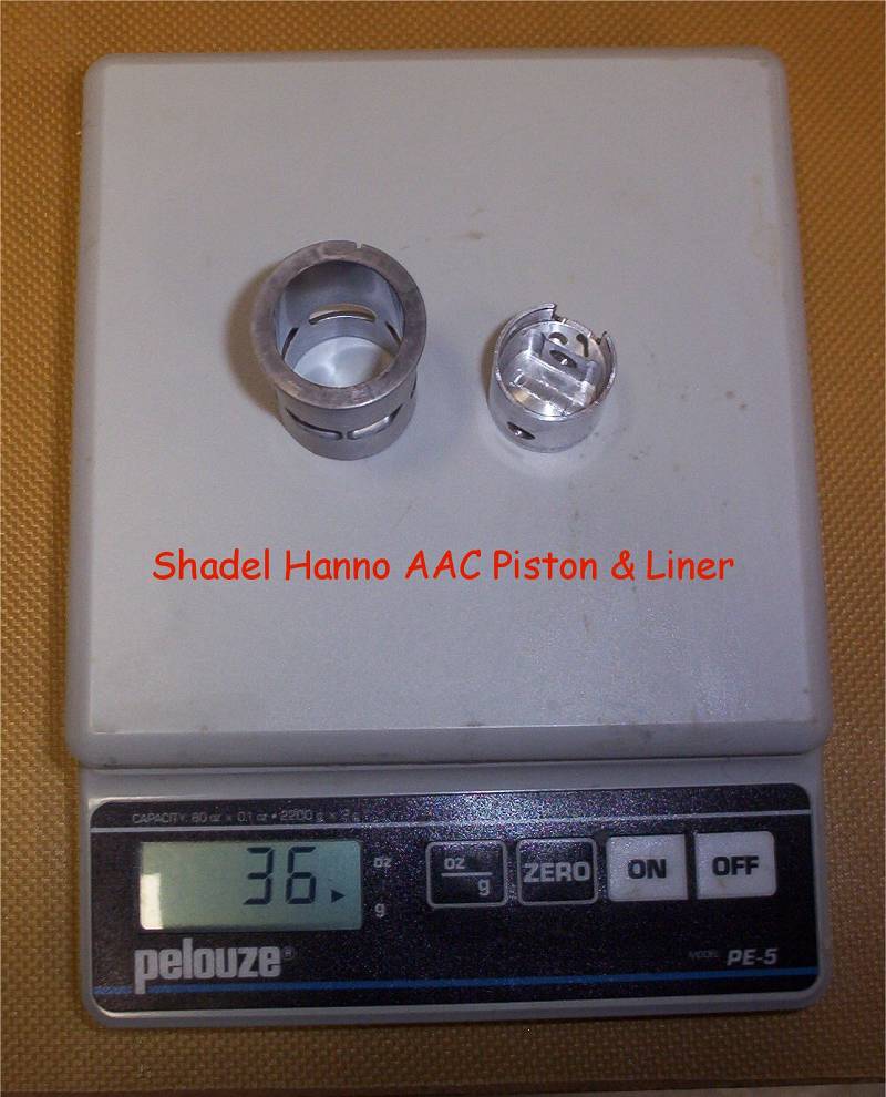

Ohh What the heck...Since I have a never ending urge for useless information...I thought I'd check out the OS's too...
I know...I'm a Goof

Thanks for the kewel pics/specs.

Awsome useless info navav2002. As Spock would say "Fascinating!"

chuck? are those engines on your scale new or have you cleaned and polished them?

I have been checking my crank pin's as I've had each engine apart and they all seem very consistent...I have seen a couple of oblong'ed (sp?) connecting rod bushings...But no significant wear either the wrist or crank pins...I just like to replace stuff like wrist pins during a re-build "Just to do it"...I really feel the originals are fine...
David:
The YS's are New...
The Large Bearing RF-P is New..
The Hanno and Small Bearing RF-P are both used fixer-uppers..I refer to that particular Hanno as "My Pink Head Hanno" ...She's got allot of time on her from the previous owner...Now she's all spruced up and hopefully there are several more hours left...She's going in my Desire...
Chuck...

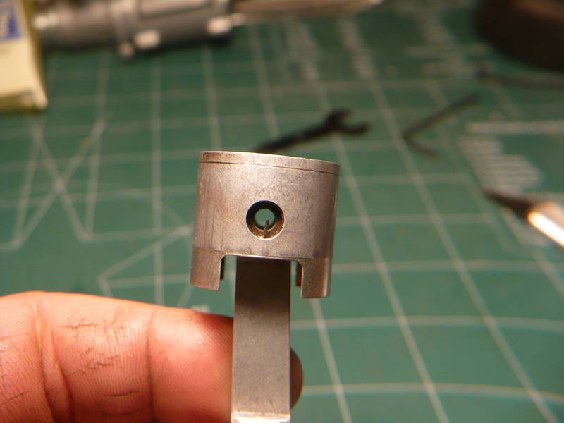

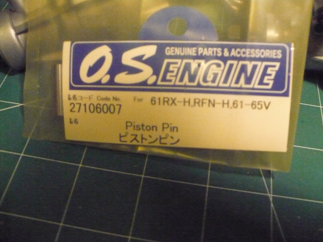

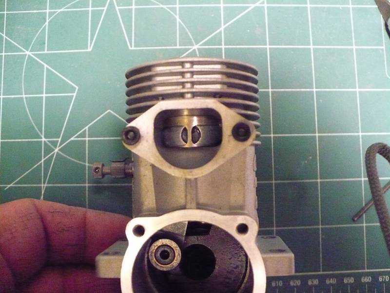

Hey all. The piston pins between the SF and RF are definitly different. As far as piston pins are concerned the difference occurs becauce the piston pin on Rear Exhausts is exposed at he exhaust port, during the intake stroke of the engine. Because of this all REAR exhaust (VF, RF and RX) piston pins are Not hollow, see pics. If you use a side exhaust piston pin it's likely you will be losing a significant portion of intake charge as the hollow type will vent straight though the pin to the exhaust port as the piston comes down.
Here's some useless info I compiled of current and past OS piston pins with OS part numbers.
Os Max 61 piston pins and OS PN's
Side Exhaust (Hollow)
61 FSR 26606008
61 SF 27706000 (not as long as FSR or SX)
61 SX 26606008
Rear Exhaust (Not Hollow)
61 VF 27106007
61 RF 27806000 (not as long as VF or RF)
61 RX 27106007
Buy the RX piston pin if you don't want drive your self crazy wondering why your brand new rebuilt 61 RF, with its new AAC piston and sleeve, doesn't run right.
First pic from left is a 61 FSR (can see right thru it). Second is from a 61 RF. Third pic is why the Rear Exhausts' need to have a plugged piston pin. The forth pic, just got one from Omni Models .
Almost forgot, you will still need to grind down the RX pin to fit he smaller bore of the Hanno's and RF's.
Bryan

Excellent Bryan!!! You Da Man!!
I knew they couldn't be hollow...I had no idea which ones were and weren't...Nor a line on some part numbers...Excellent!!
Here is a link to them on Towers Website - note: Out of Stock till Late April... (I have 5 on B/O)
http://www3.towerhobbies.com/cgi-bin...6007&search=Go
Thanks Allot...
Chuck
