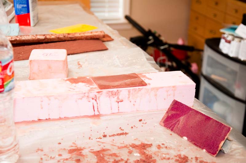

Its been a couple weeks, so I'm going to try to catch up with where I'm at with this build. A couple reasons for the delay, first is that my employer made me an offer I couldn't refuse. . . the second is that I discovered that I had figued out a way NOT to apply the West System and microballoons and didn't want to post until I had either 1) recovered successfully, or 2) started a new fuselage. . . Luckily I was able to recover to #1. . .
I started by applying the 0.7 oz. cloth from CST with the 3M 77 spray. I know this is initially a pain in the rear, getting the cloth to lay down smooth, but once you get it down it stays put thru all further handling. The only downside is that if you get any little wrinkles in the cloth, it is nearly impossible to get out. Then I used the original firewall and a piece of PVC pipe to make a fuselage holder while I work on the fuse. Another little trick I picked up elsewhere was to cut little hinges out of mylar to keep the slots open thru the finishing process. . .
OK, here is where I went "off the reservation". . . I mixed the West Systems and microballoons before applying to the glass cloth. I didn't realize that the microballoons would thicken up the epoxy, but I was able to get the mixture down with the help of a hair dryer heating the mixture to a thinner consistency. With hindsight, I should have added some acetone to the mixture to thin it out and help it flow.
Anyway, after the whole mess cured for a couple days, I started wet sanding and was able to get it down to a nice smooth surface that I believe is ready for the primer coat. . .

Like they say in the simulator. . . "New jet, new day". . . On to the wings!! This time I applied the epoxy with a roller to a nice even consistency and then used Handglider's technique of rubbing in the microballoons after it set up a little. I ended up using much more of the microballoons than before, but the end result is a much easier job sanding the surface down. I'll post some more pictures when I get the wings done and ready for primer. . .

Those are phenolic microballoons. The white ones are made of glass. You don't want to breathe the dust of either type, but especially the glass ones.

Yeah, they are hard to blow up. I keep inhaling them...
The white ones are stronger and hold a set of threads better if you need to drill and tap the material, although I've used both the phenolic and the glass to hold nylon wing bolts and both types held up just fine.
Allegedly, the phenolic balloons are a tad lighter than the glass balloons, although I suspect that varies from one manufacturer to another. Both are great products.
Oh, to me, the phenolic balloons are easier to sand, although both work just fine for contouring, etc.

OK, the following images are not suitable for viewing by women of good repute, small children, or exclusive ARF builders. . .
After rolling on the West Systems and rubbing in the microballoons, I allowed the wing to cure for a day. Then I did the other side and allowed another day for curing. Once I was sure everything was nice and solid, I broke out the 120 grit paper and began wet sanding. Even though it makes as big of a mess as you are imagining, it seemed to be a faster way to get down to a smooth surface and keep the paper from clogging up. Since the weather was nice outside, I just took the wing outside in the grass every once in a while and hosed it off. Does anyone know if microballoons have any fertilization properties?
And yes, I was tempted on more than one occasion to break out the pressure washer you see in the background. . .
