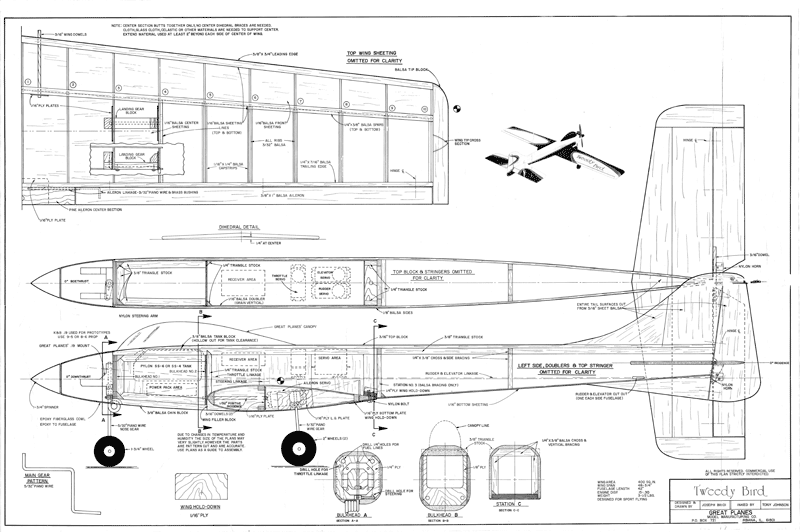

I have the Tweedy Bird, if that's what you're referring to. PM me your email address and I'll send you a full-size copy.

The Tweedy Bird seems to be exact downscaled copy of DB, isn´t it?

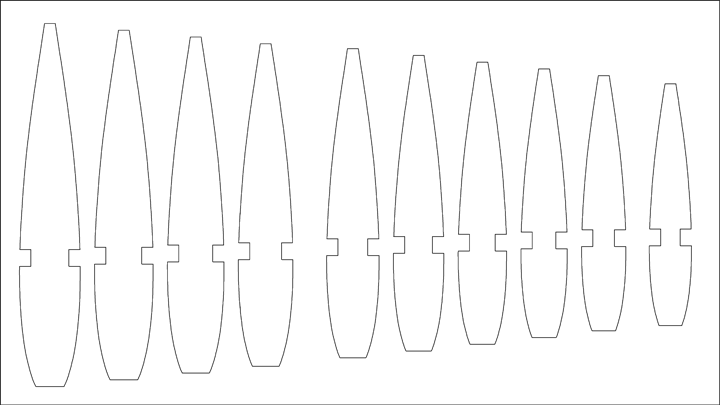

Roguedog, I bounce back and forth between Autocad R14 and Deltacad. Both let you import raster images like jpg's.
I trace the imported raster images on a new layer and I almost always make changes to the internal structures to simplify and lighten the models. Some of the older designs - especially from the '60s - are ridiculously over-complicated inside.
You'll notice that the Tweedy Bird - being a set of kit plans - doesn't include the ribs. I traced the root in cad, exported the dwg into a dat file, and imported that into Profili. It sounds complicated, but only took about fifteen minutes. I now have a set of rib templates for the plans.
David

Yep, not having the tip rib is tough. So many designs used thinner airfoils at the tip.
Like Aurora_60 said, that is definitely the traditional way done digitally. I don't miss lofting airfoils by hand on drafting paper.
The biggest problem with Profili are the dxf files it generates. They always have several hundred points (it seems) along the ribs' surfaces. This is way to expensive to send to my laser cutter, not to mention the wood gets burned a lot more. So, I use a three-point-arc tool to re-trace Profili ribs to make cut files. I can get them down to around twenty or so points per surface using that tool.
Here's a screenshot showing a rib I traced with the 3-point arc tool on top and a Profili rib under it. Since laser cutters typically charge for the time the laser is turned on, you can see how much more expensive the bottom rib would be to cut.
David
