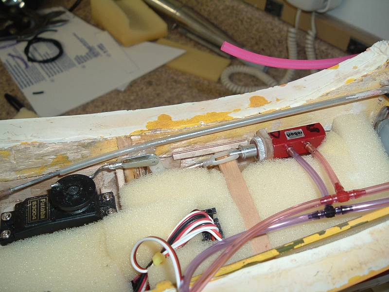

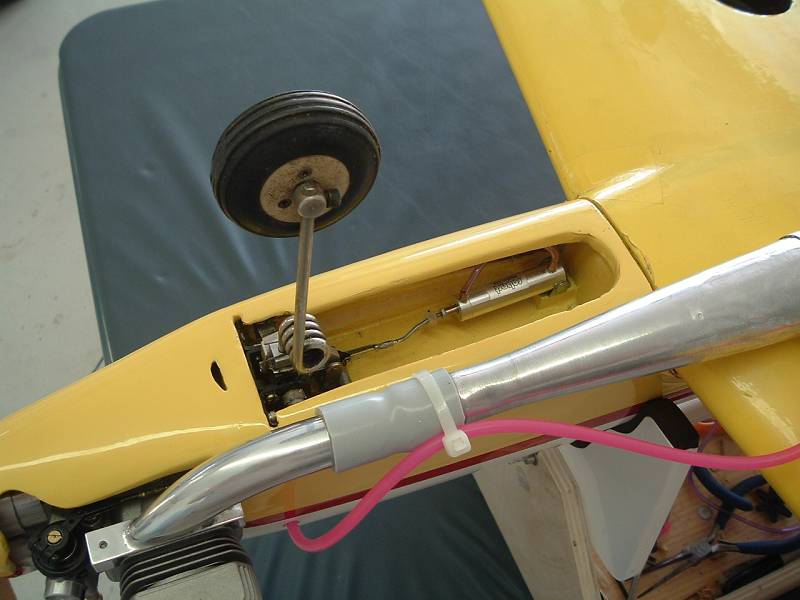

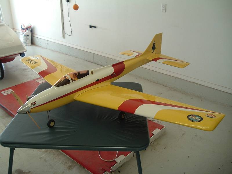

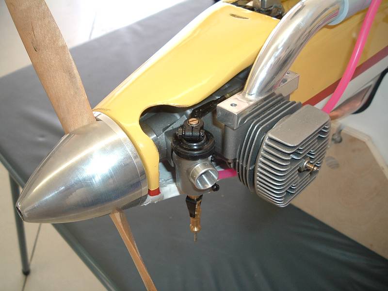

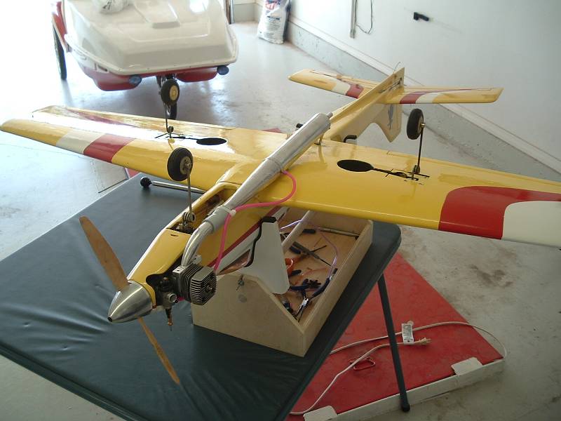

I finished the refurbishing of the Revenger and hope to take it out to fly today after being in storage for 30 years. The CG (thanks to jeff for providing the range off of his plans) with the new Futaba equipment and retracts fell right in between the CG range. Had to add a couple of reducing bellcranks for the nose steering and the retract air valve. Futaba didn't set their system to adjust the throws on the retract servo.
I am posting a few pictures. I hope you enjoy them.

The Revenger is a very pretty airplane, Dick. It is great to see an original get ready to fly again. Someone needs to do a build log on one of these!

That is a very sleek and beautiful design. I never got the true sense of the fuselage shape from glancing at the plans. Enjoy the "reinstatement" flights.

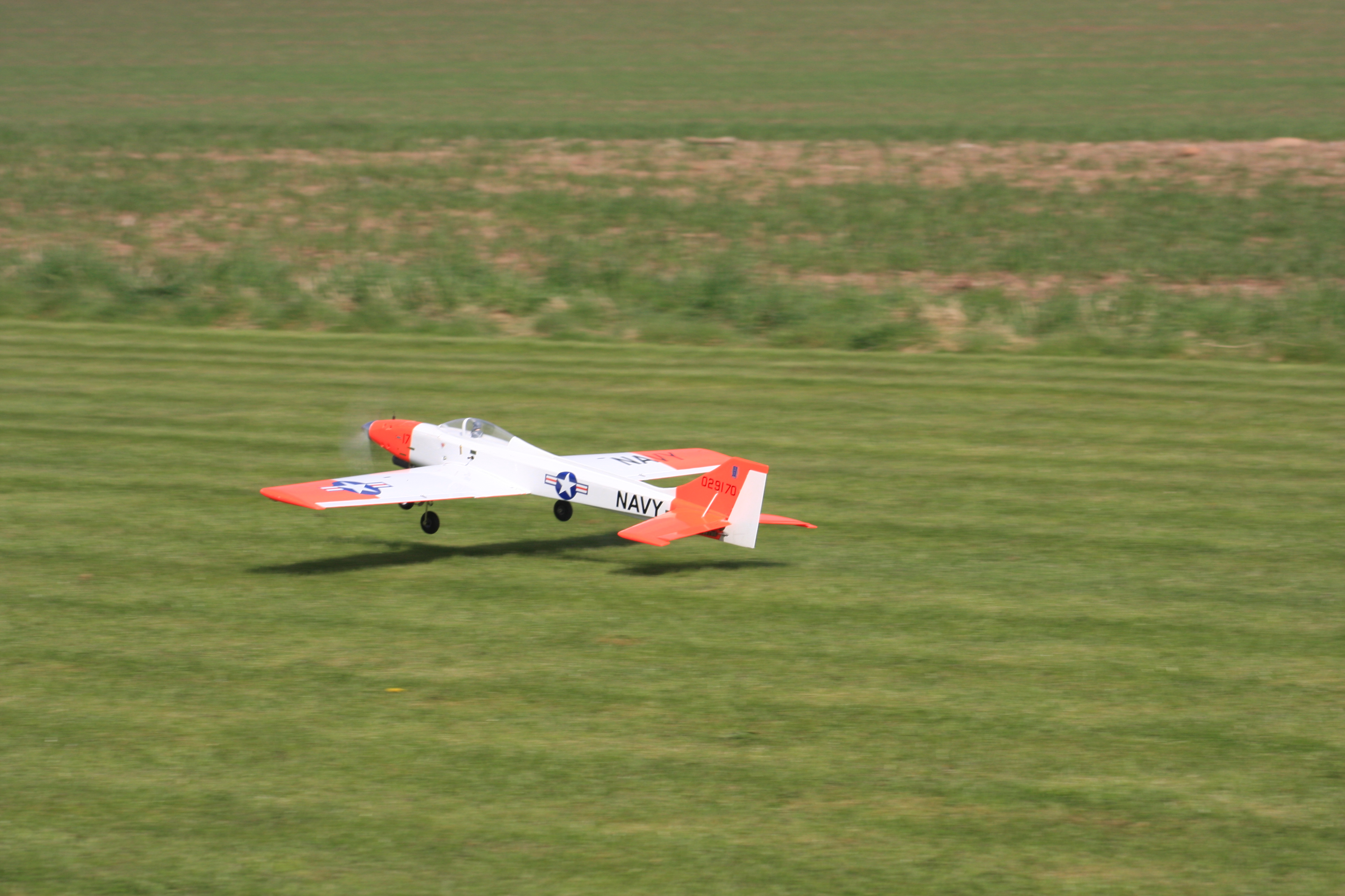

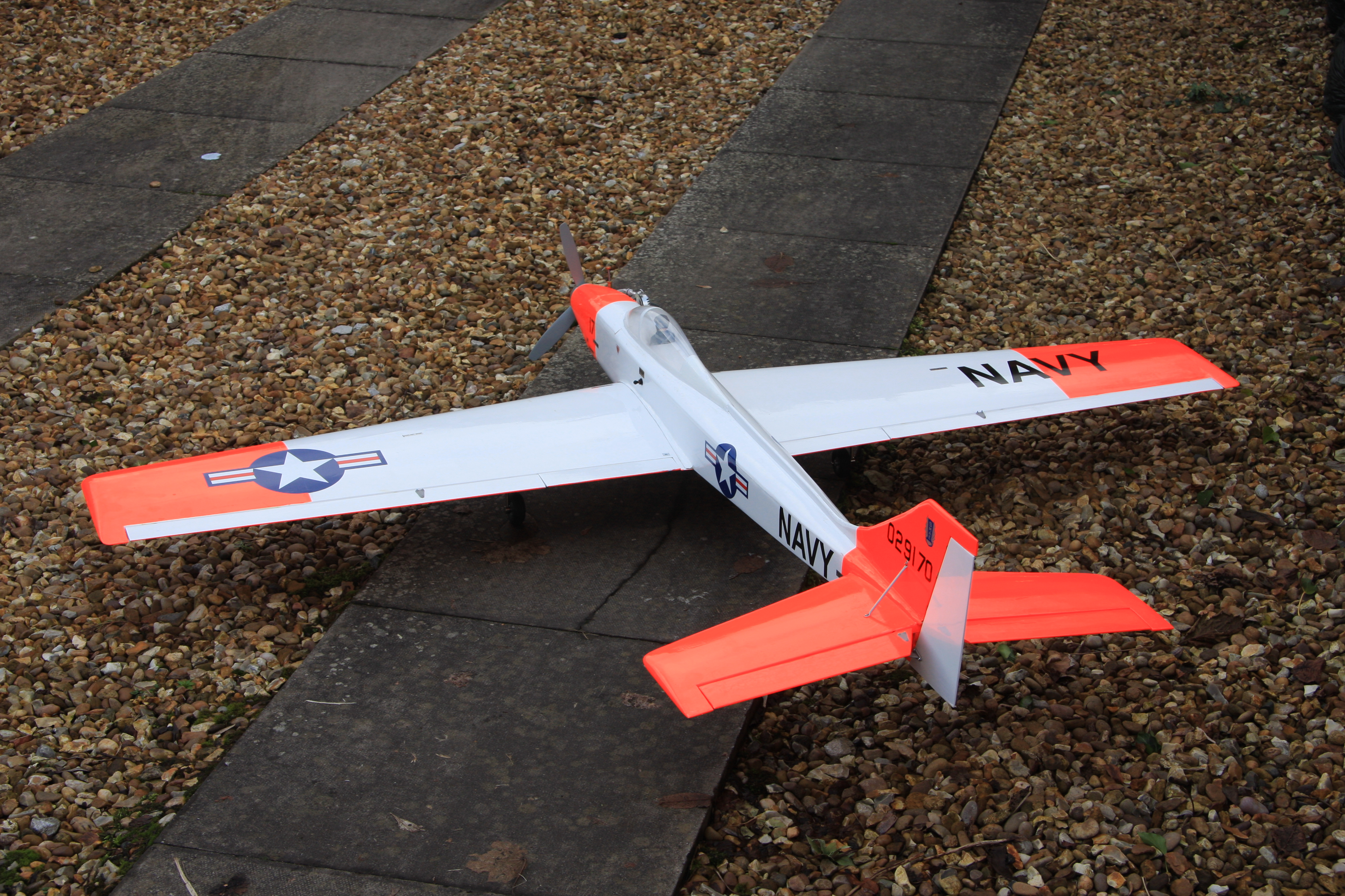

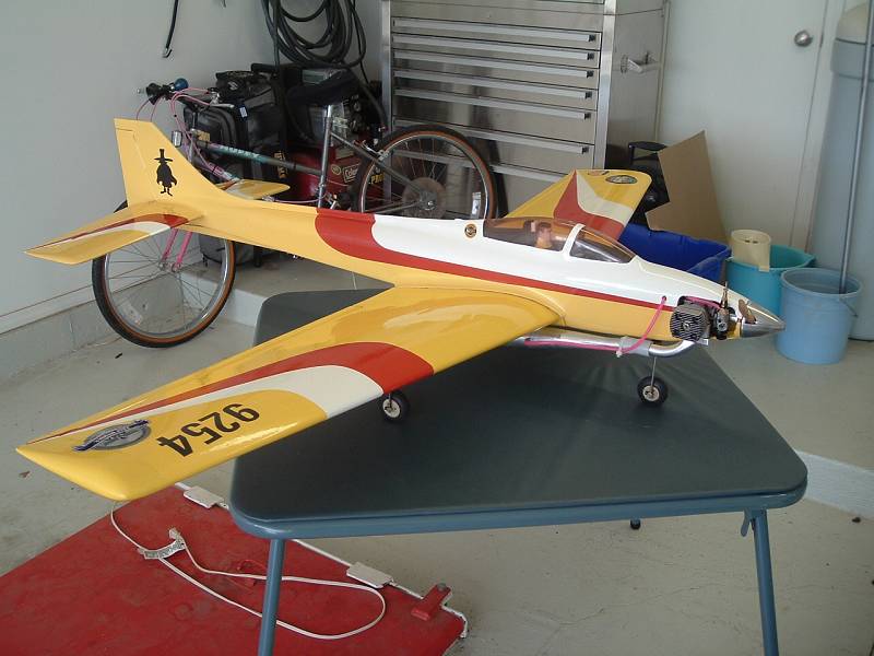

Attached my completed Revenger, powered by ASP 61 with Eflite electric retracts, and 25% inboard flaps to slow down approach into our relatively small club strip.
Very nice machine, enjoy it. I noticed that you installed brace struts on the tail. Any reason for doing so?

My prefernce, but it seemed the glue area/slot depth for the fin was a little shallow, I also recollect Dick Russ having a tail integrity with his model.
Attached (hopefully) more pictures.
The model flies very smoothly, mine came out nose heavy, but is rock steady. Uses up a lot of sky, even with a stock 61 2 stroke such as the ASP.
