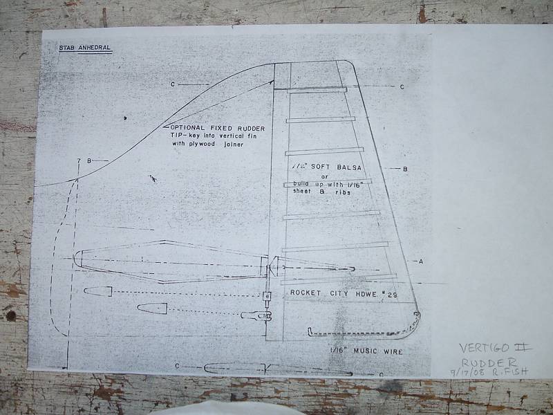

Today is Rudder Day. First, I drew in the structure on a photocopy of the tail section of the plan. Then, you know the rest. Cut parts, glue together, make balsa dust. Light and strong. Weight= 7.7 grams. That's just over 1/4 oz.

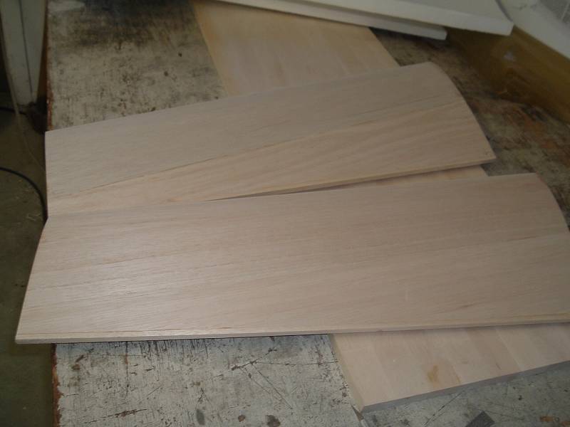

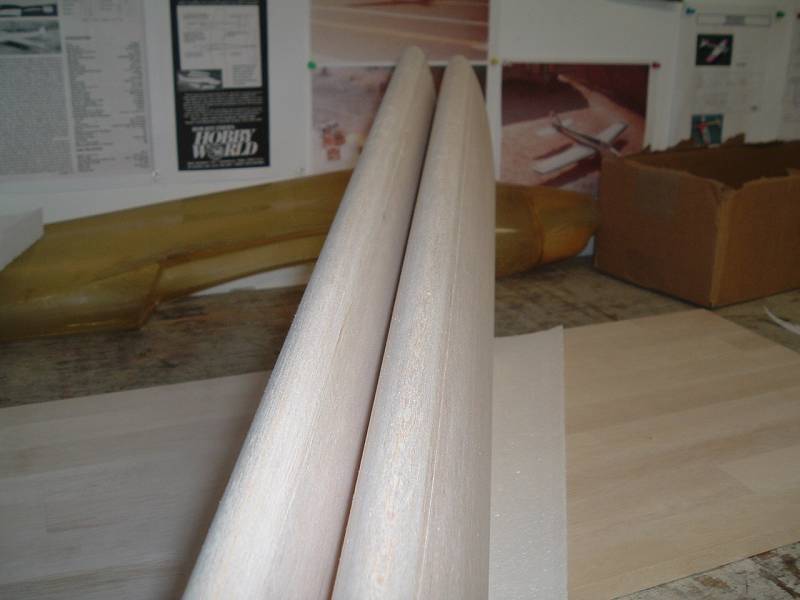

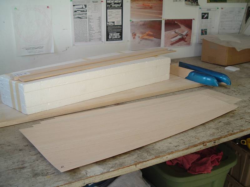

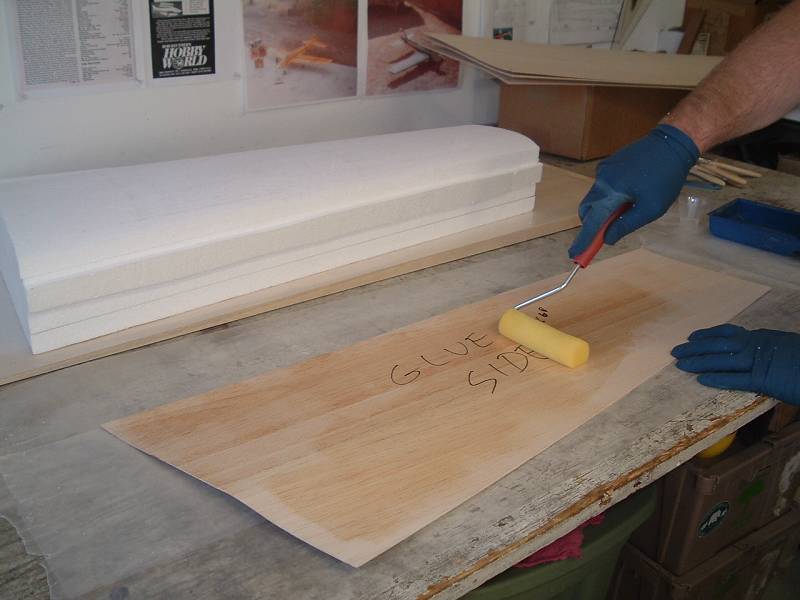

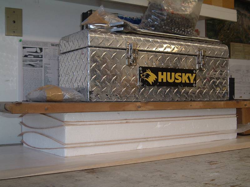

Time to sheet the wing cores. The first photo shows all the junk to make the wing. The cores are cut with a full radius around the leading edge. I am going to use a balsa stick leading edge, it is more impervious to dings, and I'm not sold on wrapping the skins around the L.E. when using epoxy instead of contact cement. Since my foam cutter is still not working, trimming the front of the cores flat is a job for the trusty table saw. The skins are prepared and sanded, as are the cores.
I will show my method of skinning, using epoxy to hold on the skins for anyone who may not be familiar with this process. I use Bob Smith 20 minute epoxy as it is thin and easy to squeegee off the excess, although most any kind of slow cure epoxy can be used. I use an inexpensive foam trim roller to apply an even coat of epoxy. Go ahead and put a lot onto the skins. Use a squeegee, and squeegee the excess epoxy off of the skin. When you have a dull sheen left on the skin, that is the right amount. Remember, you are only gluing balsa to foam, and any excess amount of epoxy used here is just dead weight. It only requires a thin film of epoxy. Heavy wings make for sluggish aileron response. Place the skin in the foam bed, then place the core in place onto the skin. Align the excess overhanging balsa evenly around all sides of the core. Repeat three more times, building your wing sandwich. When the top piece of foam is in place, check the alignment of the cores and skins one more time, then place something flat on top, then evenly pile on whatever you have for weight. Allow to cure overnight, preferably for 24 hours. The epoxy cures slowly in thin films.

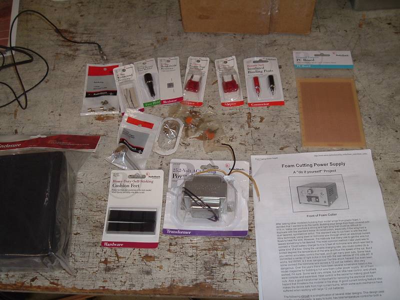

Regarding your foam cutting power supply, it seems that the triac used in the circuit can possibly be supplied with different pinouts than shown in the circuit diagram.
I built mine about 5 years ago and it works very well.
Edit - Here' the caveat from the original article.
Regards and good luck!
N.B. The main problem that people are having is the placement of the TRIAC. On the board drawing, there is a letter "G" next to one TRIAC pin. That G stands for the Gate. Once they understand this, it becomes easier to insert the TRIAC into the board. They need to read the paper that came with the TRIAC so they know which pin is the Gate pin. I had made a comment that it is possible to substitute a different TRIAC if they could not get the specified one. Well, I was wrong. It seems that some of the fellows are inserting TRIACs that are very different than that specified, and of course, it won't work. As it turns out, Radio Shack is no longer a good source for electronic components. Ahhh, for the good old days when you could find electronic shops and Ham radio stores all over town. It's all history now

Derfly,
I am glad to hear that you made one, and that it works. Most likely I made a dumb mistake. I downloaded the data sheet for the part, but I need to sit down and go over everything again. I am only getting 10 volts at the output terminals. Electronics is not my strong skill area, mostly high school level training and learn-by-osomosis. This is kind of funny, considering that I work in the electronics field (as a mechanical designer). Thanks for the tip, I will perservere and get it going here soon.

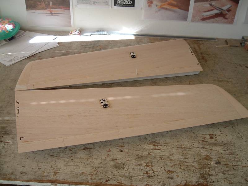

After almost two months of inactivity, I have some shop time. The wing tips are installed and shaped. the right side is hollow to help compensate for the weight of the side mounted engine. The less it weighs, the less weight will have to be added to the other side to achieve correct lateral balance. I will post some pics when I get my camera cord home.
Next on the list is mounting the aileron servos. I am using one servo per wing IAW modern practice. Time to fire up the AutoCad, and design some servo mountings. Rather than just hack into my vintage wings, I designed the mounting box(es), servo cutout, and the servo layout for the correct linkage geometry. Everything will turn out correctly the first time, and the pieces will fit properly. The results can be seen in the accompanying pic.

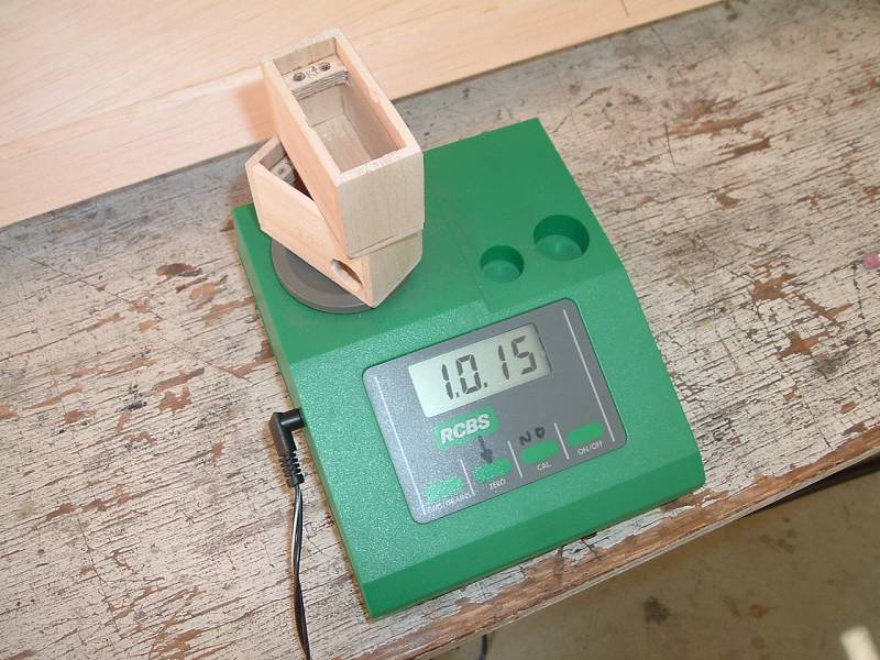

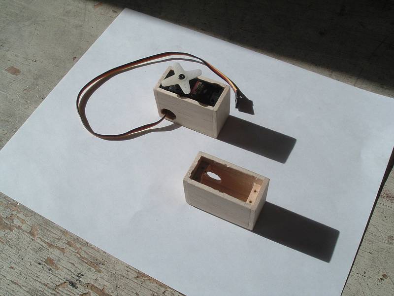

Next the servo box pieces are cut, and the boxes are assembled. They weigh in at 5 grams each. The boxes are check fit into the wing, then glues in place with 5 minute epoxy. A couple of strips of duct tape protects the wing while the boxes are sanded flush with the wing surface. Last pic- the finished installation.
I ordered some Rocket City hardware from Nelson Model Products, I will get to that when it arrives. The original plans specify Rocket City #29, and it is still available from Nelson. It swivels, and eliminates the binding caused by the swept back hinge line. Stay tuned.

I couldn't find the specified Triac when I built this so substituted a BT137 rated at 500V/8A. This device is way overated for the transformer I'm using which is 11.8V 50VA. As this transformer was quite a bit smaller than the original specification, I left out the Hi/Lo switch in the circuit as it really isn't needed and just complicates things.
That said, my version of the foam cutting power supply is adequate for a clean cut with a 30" bow. I wouldn't want to try anything larger than that.
Here's a quick pic of the innards.

Yes, the power supply is working now. The solution was to increase the value of the switching capacitor from .22uF to two .68uF cap in parallel. That's what it took to get the triac to switch on early in the phase. Now it heats up my 36" bow quite convincingly. Now to cut some cores....
Derfly, your supply is very nicely built.

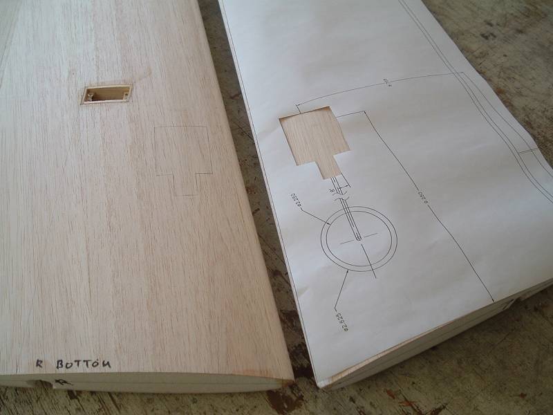

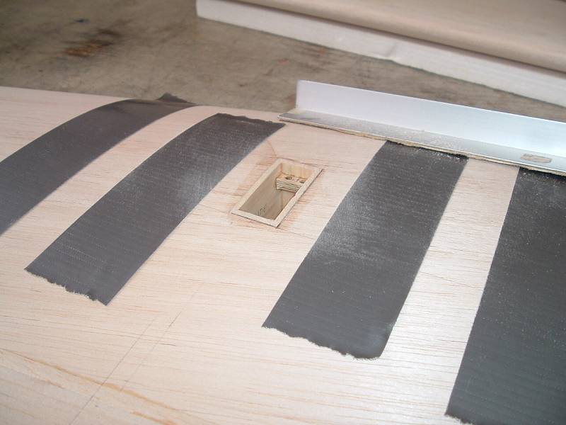

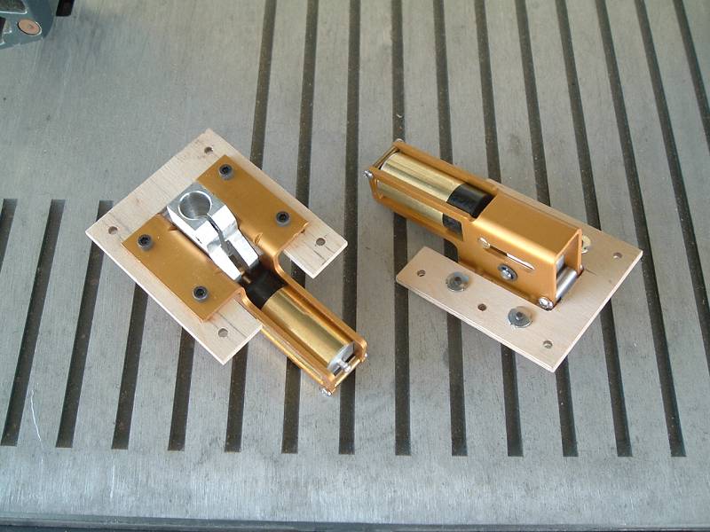

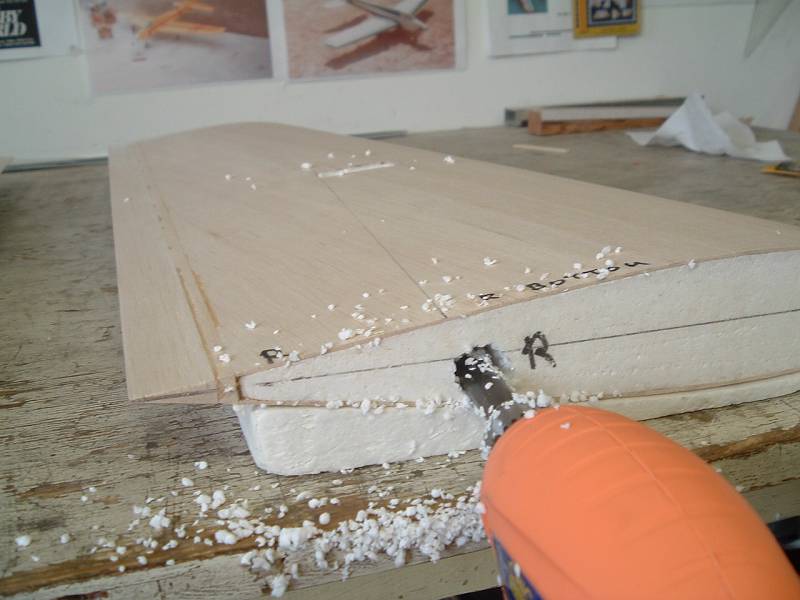

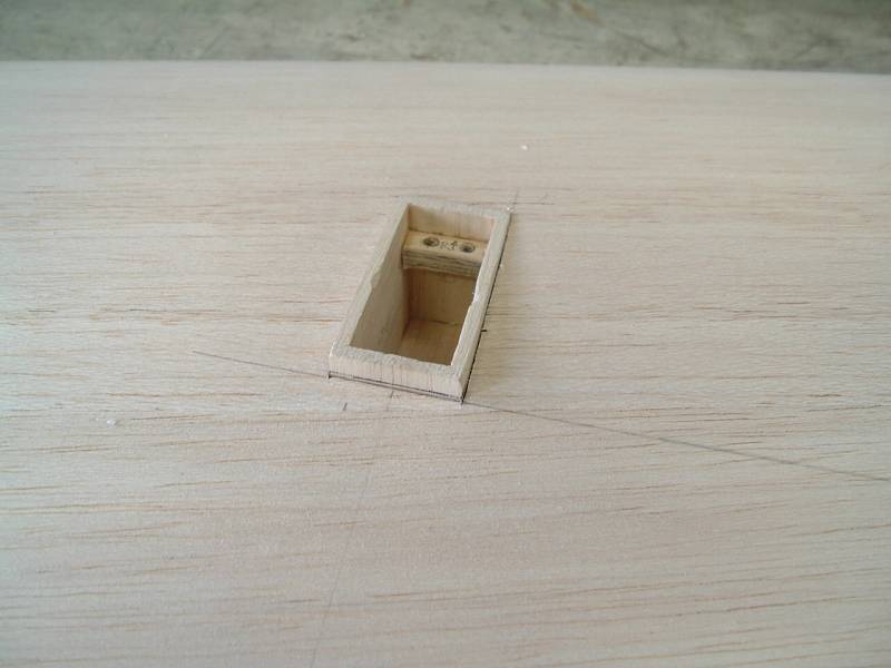

Landing gear mounting:
Photo 1: Landing gear mounts: Outline and hole centers laid out. (holes drilled)
Photo 2: Parts cut to size. Material is 1/8 ply. Small holes are for 1/8" dowel to anchor into foam. Larger holes are for 4-40 blind nuts.
Photo 3: Check fit of the Spring -Air mains.
Photo 4: Lay-out of the LG mount recess. Wing plan drawn in AutoCad, plotted 1/1 scale for template.
Photo 5: Skins cut and removed.
Photo 7: Cutting LG mount recess using handy cutting tool. (Coat hanger wire in soldering gun).
To be continued.

Old 03-25-2009 | 04:32 AM
  #72
ChiefK's Avatar
Joined: May 2008
Posts: 759
From: Foxfire Village, NC
Default RE: Vertigo II Build Thread
Regarding the drilling of the servo wire holes, what kind of drill bit gives you such a nice clean hole in foam?
Greg
Old 03-26-2009 | 12:12 AM
  #73
KLXMASTER14's Avatar
Joined: Jun 2007
Posts: 973
From: Simi Valley, CA
Greg,
I used a masonry bit, for no other reason other than it was long enough, and it was in my box. It did do a surprisingly clean job, though.
-Robert

Photo 1: Gear mounts are ready for assembly. 1" sections of 1/8" dia. dowel will be epoxied through the small holes in the plate, helping to anchor the plate to the core, and distribute the gear loads deep into the core. The back sides of the blind nuts are covered with masking tape to prevent the threads from filling with epoxy.
Photo 2: The gear mounts are glued in place with 30 minute epoxy and some microballons, not thick like you would use to make a fillet, but just enough to fill any irregularities and not run out of the joint. The dowel holes are filled with 30 minute epoxy using a plastic glue syringe, then the dowels are coated with epoxy and pushed into place, the ends flush with the surface of the gear plate. After the epoxy cured, the foam was cut out using the method described in my last post.
Photo 3: The Spring-Air main gear in position.
