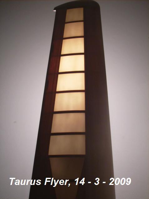

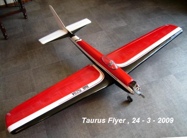

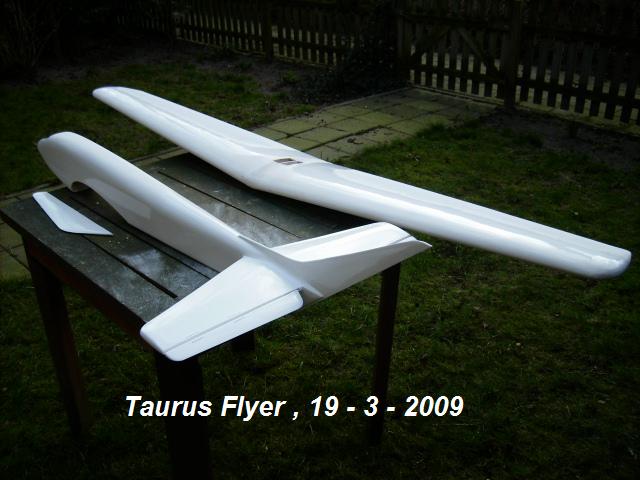

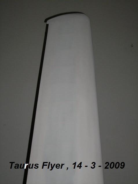

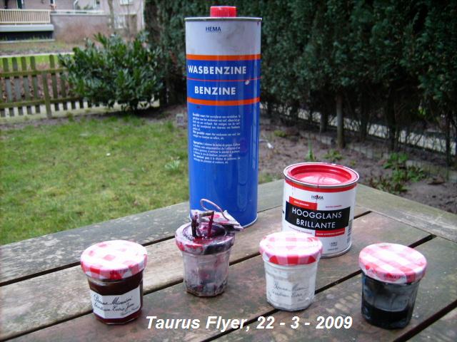

To paint the silk covered wings and stab I spray a very thin first layer of primer on the surfaces, see picture 1.
I check the quality of the layer with a lamp, backlight, see picture 2.
Second color will be the white color. Then red and black.
Picture 3 of my (MAN, Top Flite copy) AMA15204 Taurus wing as example after painting with one layer primer and one layer color (red).
More to come about the painting.

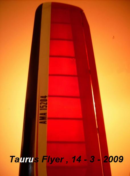

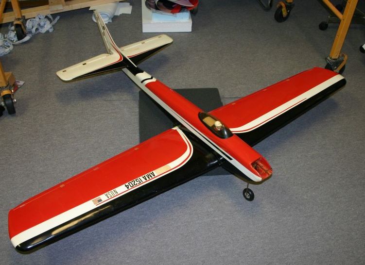

Picture 4 shows us a part of the crate picture, the hinges.
The ailerons of the Oldest Taurus on Earth wing were mounted with two threaded hinges on the wings W7/8 W11/12. The third hinge is near W2 the root (or pivot?). Characteristic for the Oldest Taurus wing.
On the Wester Taurus I will use the same mounting positions.
The later 1962 standard Taurus did get a first modification for the aileron hinges and did have 4 hinges divided over the TE of the wing, so the first isn’t near the root but near W3. See the picture 5 Michaelj2k did make.
We can read that Ed did fly a long time with the old way of mounting the ailerons. He still did fly in Rhodesia with the three hinges each wing.
I will experience what happens after a period of flying. Maybe when some play appears there will be flutter on the ailerons and I also have to add the hinges, the TE of the wing is prepared for that.

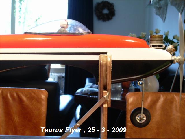

When you are buzy build a Taurus and forget which color on bottom of the fuselage, you also listen to the Rolling Stones, 1966 “Paint It, Black”
I see my red door, I must have it painted black
Our military pilot in our Taurus looks to his feet and sings:
I see a red floor, I must have it painted black
To let the Taurus win the Detroit Invitational’s we give him now some Detroit Red Wings just Norm Ullman has in that period.

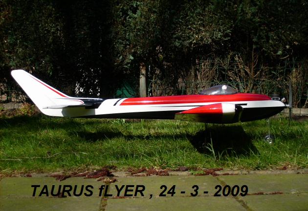

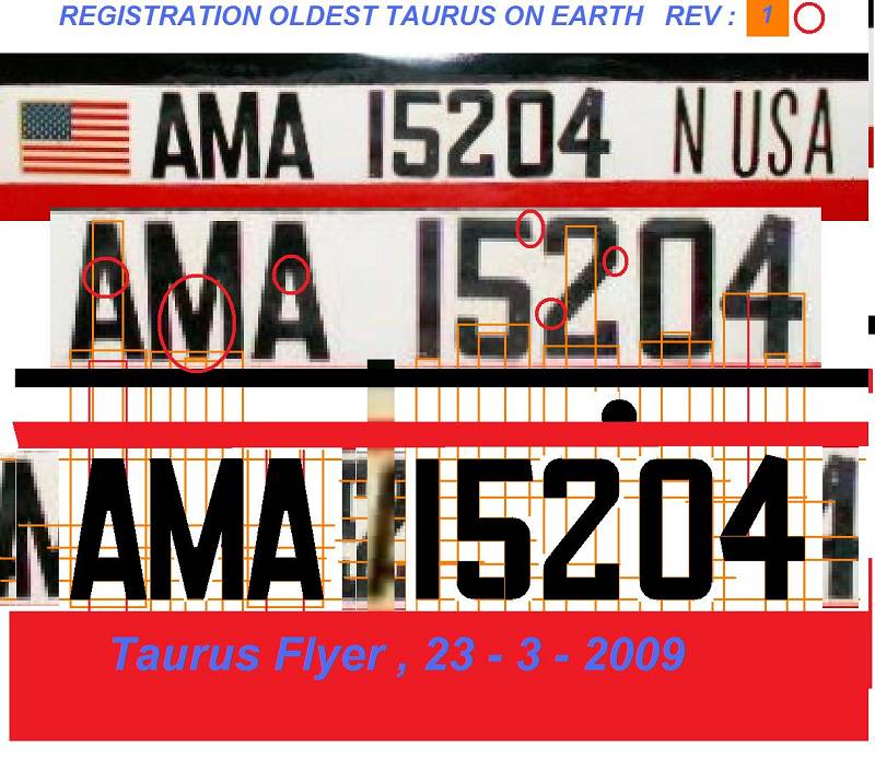

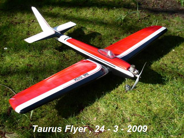

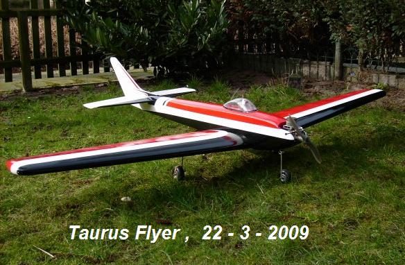

After some red paint it already looks like a real Taurus,
some dashes on the wings and fuselage and the AMA characters on the wing.
After that mouning activities like canopy, radio gears, engine ets, etc.

The paint,
I use 2 components,
First component is the jam for your sandwich. See picture 1, throw away the jam and keep the little jar for the pistol, (with the refrigerator compressor and of course Evangelista Torricelli)
Second component is the cheap paint you can buy in your 'Do it yourself' shop for garden and kitchen doors (and about 25 - 30 % benzine).
Only take care of the fuel you use in your glow plug engine. The fuel I can buy in the Netherlands doesn't give any troubles, also not on my TF Taurus and Orion.
I did check a foreign fuel and that did give troubles, so you are warned!
Using the wrong fuel on the wrong paint is the [size=3]"Biggest Mistake"[/size] (Rolling Stones) you can make!
Cees

#389
Gents
First attempt to reconstruct the registration of the AMA number.
Of course without the American flag they were only used for the trip to Europe.
These characters are traditional for the registration of Ed Kazmirski!!
Edit rev 1, rev 2
Edit rev 1, rev 2

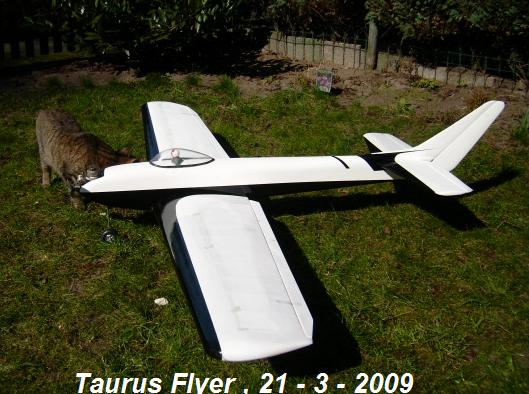

The painter is ready, so again some pictures.
First picture is the VR/CS Taurus in the AMA museum.
Second the Wester Taurus, copy of the Contest Taurus.
What do you think? Did they see the Taurus of Ed was different when he did use this?
Next job the canopy, black hole in one, but not in the Wester Taurus.
Cees
Cees

#395
ORIGINAL: Taurus Flyer
Gents,
Cees
Gents,
Cees
How did you arrive at the extreme "rake" of the vertical fin compared to the kit or Myers plan?
Duane

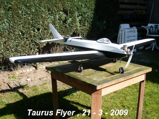

#400
Gents,
for who is interested,
Preparing the mounting of the canopy.
The position is important, to see the canopy on the same place as on the crate picture.
No problem all the drawings are still there, also the original from the laser beaming activities.
Only outside dimensions of this drawing are still important, not (study) construction details, these are on new drawings.
I use several distances to locate the right position of the canopy.
Then make the black “inside”, or is it “upside”?, of the fuselage surface.
Some work on the label and then gluing it all together.
More to come.
Cees
More to come.
Cees
