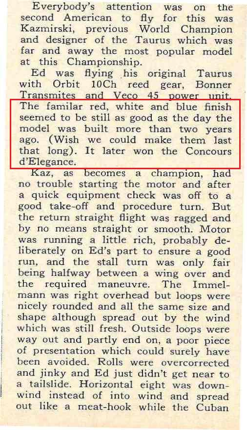

Gents,
There arrive new data, thanks Ray! I will give it some attention.
(Hope you don't mind I use a page from post 963 page 39!)
The reporter of American Modeler does write in the article about the Internationals, August 1963, Genk, Belgium the Oldest Taurus on Earth should have been more than two years old and winner of the Lufthansa awarded trophy for Concours d'Elegance.
I think the reporter notes in his article Ed also did fly with the Oldest Contest Taurus, but we know he only did use the wings of the original oldest one.
He did write:“The familiar red white and blue finish seemed >>>>>>>>>”
Is this again a incorrect notation “The familiar red white and blue finish” and does have finish has to be “finished” to be the substantive for the old contest plane?
“Blue” is an indication that the reporter didn’t could take a close look to the plane (I THINK) because the bottom is black.
The color scheme of Ed’s both planes was exactly the same and I think that had a reason!(Who knows this reason?)
Most important for us is of course the “was built more than two years ago ”!!
Now a second date we can calculate and note in the “Taurus construction and flying schedule” (TCFS) and makes with the other dates the “possible first flight period” .
The new first flight date still fits with the Invitational of Detroit of course.
I did take a look for the weather conditions in the weekend of 8 and 9 July, just for fun because somewhere between the weekends of 8 - 9 April and 8 - 9 July probably the first flight take place.
Saturday 8 April 1961, 21 degrees C, 70 degrees F, Wind speed 13 mph, 21 km/h, Wind direction N.
Sunday 9 April 1961, 21 – 27 degrees C, 70 – 80 degrees F, Wind speed 5 mph and after 4 o’clock pm 10 mph, Wind direction NW.
So temperature higher than Saturday but less wind speed. Sunday much better test weather.
Covering of the wings takes a week more time because of some “ventilation organization restrictions” because we all try to keep the atmosphere in a good condition! LOL!!

Under certain lighting and sky conditions, (such as a clear blue sky) the Aerogloss Black Ed uses has a decided bluish look as the blue in the sky is reflected in the black paint. I had a black sports car once that was the same way...it's a weird characteristic of shiny black paint. However there is no way the bluish tint could be considered a dark blue, so the reporter obviously got it wrong.
There is a danger in taking some comments too literally, however since the reporter says it's blue...it must be.
The pictures below show both of Ed's planes under a blue sky.

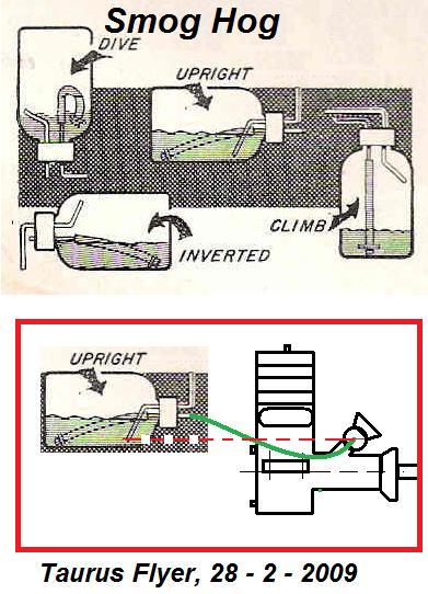

We did write about the fuel tank before and here they are!
Howard Bonner and the Smog Hog and Daniel Bernoulli the Dutchman the
“Golden Team”.
See picture 1 and 2:
The air inlet tube on the same level as the spray bar gives you a constant fuel pressure in normal horizontal flight as long as the level is above the air inlet in the tank!
On the Smog Hog you even could rotate the tank to adjust!!
The lower air pressure above the fuel level is the same as the hydrostatic (fuelstatic?) pressure of the fuel, so compensation!!
Look to the control liners but the RC-pilots also knew in the past.

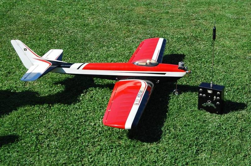

Beats me Andy [
] I'll use it as an excuse to post a nice shot of Eric Bell's Belaire, presumably taken in Zimbabwe (Rhodesia)
Rather derivative of Rich Brands' designs, and now you know why.

The right one is your plane, they left one is only looking the same Duane.

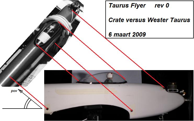

Gents,
In post 17 and 19, page 1, I already did show a fast goniometric check to see if the fuselage in the crate can be the plane we see on the Top Flite/MAN drawing.
The picture is of the fuselage of Oldest Taurus on Earth, on the right side in the crate.
All the lines must be (nearly) parallel and cross each other in the “Point of view”, the position of the photo camera on the moment the photo was made.
The picture is rotated because the position has to be square on/related to, the lines to "Point of view".
It is not possible to find an angle of view, or positions, in which this is possible to draw all the lines nearly parallel.
The max is 3 lines (nearly) parallel, look to the blue lines, they are not “in line”.
The first picture is the same as of post 19 on page 1.
Second picture shows us that I can use the same lines for the Frank Myers plans, I did use for the Top Flite/MAN Taurus
The positions of the remarkable points of the Frank Myers plans are all exactly the same.
So the fuselage on the right side in the crate cannot be made with the MAN/Top Flite plans neither the Frank Myers plans.
For the wings I do use other methods and proves.
Cees

Cees,
One of the beauties of photography is lenses. You also NEED to know the lens geometry and the position of the lens relative to the subject in order to do what you're trying.
For instance, if I use a lot of light, I get a very large depth of field (area in which my subject is in focus). I get a very sharp image. Unfortunately, that can distort the subject, especially as the subject and camera are closer. You can easily end up with a tapered wing where the tip close to you measures the same (or even WIDER) than the root, while the other wing panel looks like it has extreme taper.
I do close-up photography all the time, and it's something you ALWAYS need to consider when composing a photograph. The photo of the fuse in the box was not well-composed, especially not for what you're trying to do.
You can get decent measurements if your subject is far away and only a small portion of the FOV.
Again, you CANNOT do what you attempted without knowing ALL the geometry: lens diameter, focal length, distance to subject, and angles of lens to subject. I wish you could.
Andy

Andy, I read:
Andy,
I understand you are worried.
But be not afraid not only Daniel Bernoulli and Anthony Fokker are helping me.
Also Gemma Fricius the Dutchman, I will show you in this post, see picture 1
Explanation
About the picture 1.
In the past I did get the very important high resolution picture of the “Box of Pandora” the crate of Africa.
The picture is made by Ed Kazmirski.
I cannot find any distortion of the straight lines of the crate and they are all over the picture! So there is no measurable pincushion distortion or barrel distortion. It is just like the picture is made with a Camera Obscura. No wide angle or telephoto lense is used.
Camera Obscura1
Gemma Fricius, Dutchman 1508 – 1555 did make the first drawings of the Camera Obscura.
The result of a picture with the camera obscura is an exact copy of the example.
Characteristic of these pictures is there is no distorsion, bended lines are bended lines, straight lines are straight lines. No lenses are used in this camera (like the pinhole camera).
About the picture 2
The picture of the crate is taken on a very sunny moment of the day so with a little diaphragm hole, the result is, the picture is sharp in any detail. Also the distances all are within a ratio of about 1:2 so little difference in depth. I did show the hinges of the ailerons in the past!
Because I do not see any corner shading or flare, we see the camera and lens must have been of very high quality and we all know that from Ed Kazmirski.
Inverted Camera Obscure 2
To reconstruct the drawing I did use the inverted method of the Camera Obscura.
When I use the inverted method the result will be the same, no distorsion.
I do not use one hole between the example and the copy but a mask with a lot of holes between the laser and the copy drawing. I can do this because a laser beam is never bended.
The laser is on the place of the pinhole of the camera obscura and the mask between the laser and the copy drawing.
The mask does not have to be a mirror image for this reason! See the beaming on first posts of the thread.
Rest the accuracy?
As accurate I can make the mask with an industrial high resolution plotter and the position of all the parts!
Check?
If I want I make a high quality picture of a second crate with my planes I can check with the master picture by photo shopping.
If I invert my method again I have again the Camera Obscura and I can make from the crate a new mask, just change the laser in a hole and make a mask behind the hole!!
If I want a second plane, after making a crate picture and corrections (in mm’s!), it is possible!
Conclusion!
I do not have to and will not stop until I have my Wester Taurus, even if you say:
“Again, you CANNOT do what you attempted without knowing ALL the geometry: lens diameter, focal length, distance to subject, and angles of lens to subject. I wish you could”
Because I know I can and because all I do is the best for YOU.
The picture 2 I show, is the result of the test I did for you, a fast check to find the right positions and angle so I have 5 parallel lines.
More to follow. Cees,

Cees, maybe you could persuade Andy by explaining why you show lines that are parallel and not focused to the point-of-view. After all he pointed out that distances nearer to the pov look bigger than those farther away. So in the crate picture the fuselage nose appears to be short and the tail long, and it seems you didn't take that into account.

You are right UStik,
I did use this method for a "fast check" not to copy the Frank Myers plans.
" parallel and not focused to the point-of-view."
When parallel this is theoretical with the point of few "between the stars".
When there is a difference in plan and reality at least one of the lines crosses somewere another on a other place than in the point of few, where ever that point of few is.
You allways find positions and an angle so there are three lines parallel.
You must do this check with at least 4 lines!
So where ever you make the point of view you can do the check.
To copy the reality the distance to the point of view is most important.
The picture of the crate is realy a "Box of Pandora" because the crate is on the picture there are references all around the fuselages to calculate everything because all the lines are straight.
Even when you know the POV there is a lot to calculate.
Example: we do not look exactly on the top of the fuselage! there are a few degrees so I can reconstruct the fin.
The picture of the crate the most important Snap Shot? No Ed could not have made this picture better!!!!
To give some extra information
A picture shows us more than hundred words!
Picture 1, Camera Obscura also inverted
Picture 2 point of few the fuselage in the crate.
Picture 3 Old as the way to Rome, without lenses
Cees

).My thread is only to show you how I duplicate the Taurus in the Crate, not to impres (impress?).

Isn't geometry amazing (as well as photography)?
