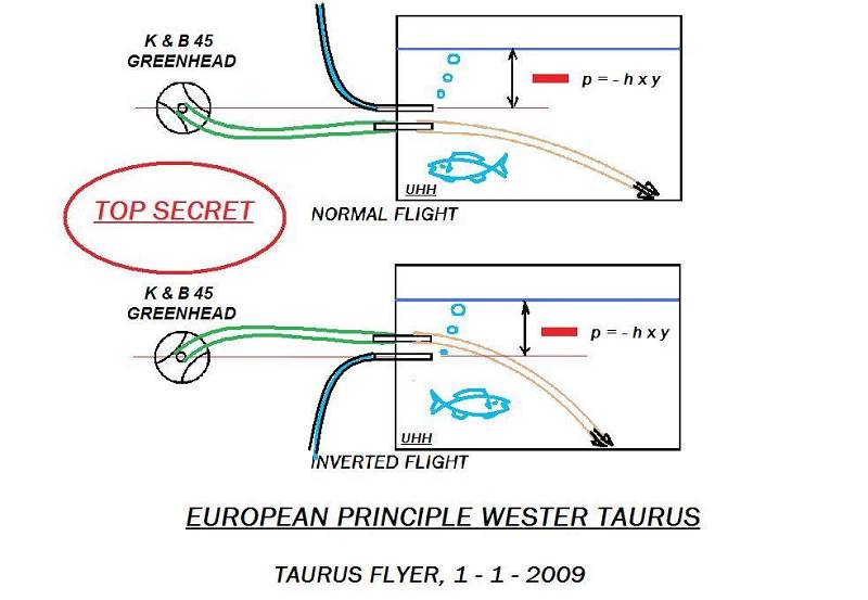

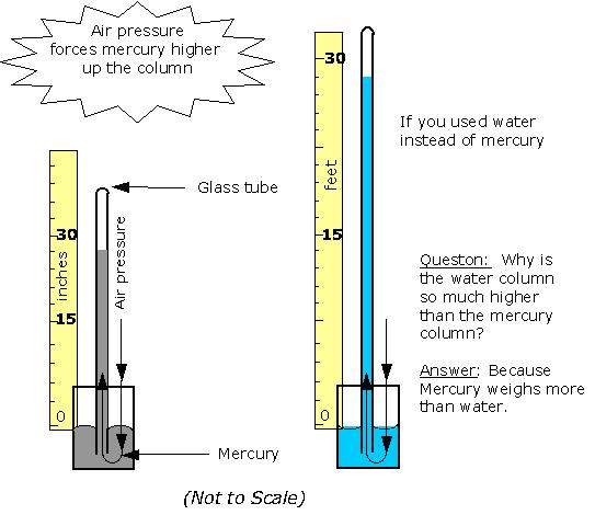

About pressure ,accessoires and obstructing our view.
Daniel Bernoulli , h multiplicated with rho, for fuel
When we have a pressure of 7 psi(g) how much is h when rho is 700 gram / dm3?
Cees
#352
Easy, about 7 m, but there's a sqeezed tank and the regulator.
And that's static and not Bernoulli, and that Bernoulli is considered a Swiss.

Static pressure is also Bernoulli (static + dynamic pressure is constant), but I did read your post in the thread of Ed Kazmirski's Taurus, about the pusher and I did get the impression you did not understand you will find the fuel in your POV without a pressure regulator.

No, and 7 psi is not even 0.5 bar. But I wonder how Ed put the nipple into the underside of the shaft housing and how he got the left-hand crankshaft. On the Veco 45, there is no such swelling in the cast part like on my OS 19. I think Ed did it himself in his machine shop, and for him it was easier to make a new crankshaft than a left-hand propeller. Did you read the paragraph about Ed making Nylon parts in the interview I posted the link to?
BTW, I wonder if the ribs in the baby bottle were really able to stand the pressure. Why not simply a round bottle, or even a bubble tank?

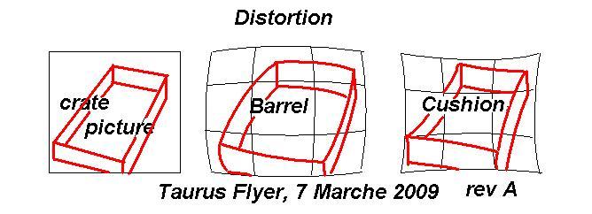

Andy ,
I did not find any measurable pincushion distortion or barrel distortion.
Result is, Gemme Fricius is my man and I can forget all your lenses, because: What have I to do when there is no distorsion? Nothing !.
Even when I did find distorsion I would have build my plane by recalculating the picture first, no problem for me.
Maybe UStik would have helped me, he probably has contact with Johann Wiesel in Augsburg and I can ask Antony van Leeuwenhoek or Christiaan Huygens.
What I understand from you is you did read a lot but cannot help me. You are more the pilot and I am the engineer.
Cees

Cees,
I'm an engineer, too. Tested out of the electronics classes and most of my freshman year + some others along the way, double-majored in computer science (systems development, and scientific applications - mostly math), with a math minor (5 hours would have given a triple major - CS/Sys, CS/Sci, and Math). You are totally missing the point. There absolutely MUST be some distortion - geometrically impossible NOT to have some. Plus I graduated early.
To demonstrate it very easily, get yourself a tapered-wing airplane. Get yourself a camera with a 50-70mm lens. Get lots of light. Now, position yourself just outside one wingtip and 0.5m above it. Put the center of your focus on the wing where the fuselage would be (works great with the fuse there, too). CLICK.
Print it. Now measure the root, and both tips. Tell me there's no distortion. All the lines are straight, but your close tip will probably measure LARGER than its root.
Because you know your location, the lens, and the subject you can figure out exactly the distortion. Take another picture from above and behind the tail, centering on the canopy. Voila!
Then please post your pictures and measurements here.

Andy,
Here is my picture (rev A), what you explain is depth!
And that's no problem for the Camera Obscura!
When there is no distortion you have an optimal presentation of depth and distances (dimensions) on any place of the picture!
It is what I did tell you, you did read a lot but cannot help me.
Your post 365:
If you could do what you are trying, you could be a surveyor and never have to leave your office. But there must be a reason that surveyors actually exist and make a (good) living...
So now I know what you are thinking and better than your wife!!!
Answer? We do not "trying", that is a waste of time, we start with "do".
That was the reason I did start building the Wester Taurus.

Andy,
Cees
Andy,
Cees
When using a Camera Obscura (or pinhole camera) WITHOUT A LENSE, you get infinite depth-of-field.
My first method with the threads did have visible distortion I did have to count with, that was the reason to did use the second method with the laser.
For the second method I did use two independed masks and is of course much more accurate!
Cees

ORIGINAL: Taurus Flyer
Gents,
(Duane read first before answer, of course I know what finish means!)
We did write about the fuel tank before and here they are!
Howard Bonner and the Smog Hog and Daniel Bernoulli the Dutchman the
“Golden Team”.
See picture 1 and 2:
The air inlet tube on the same level as the spray bar gives you a constant fuel pressure in normal horizontal flight as long as the level is above the air inlet in the tank!
On the Smog Hog you even could rotate the tank to adjust!!
The lower air pressure above the fuel level is the same as the hydrostatic (fuelstatic?) pressure of the fuel, so compensation!!
Look to the control liners but the RC-pilots also knew in the past.
Cees

When speaking about the fuel tanks for the Taurus I did show some fuel tank lay-outs and the result on the pressure for the spray-bar in the carb.
When we only speaking about unpressurized fuel tanks, so no connection with the crankcase or exhaust on any place we can go back further in time, Italia.
Evangelista Torricelli, 1608 – 1647 see the picture.1
Evangelista did show us, you could have a vacuum above liquid, just as we see in the fuel tank of the Smog Hog.
This is the most important physical law of all the unpressurized fuel tank systems.
When pressurized (but also unpressurized in acrobat flying and control line), Bernoulli but also Pascal becomes again important
Picture 2 shows us there is fuel flow without “sucking” of the carb (rich) when we do not have the vacuum and the fuel level is too high!
Picture 3 shows us the max vacuum that’s possible on our globe but that’s not interesting.
