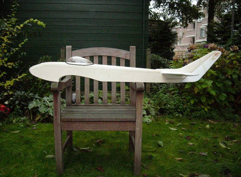

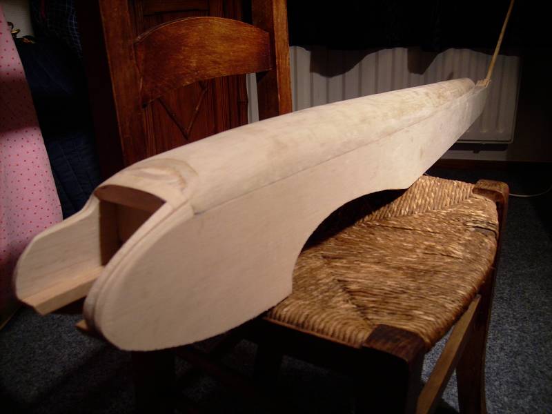

Next pictures of the building

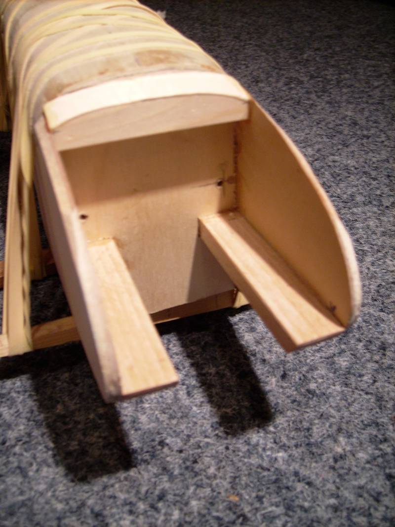

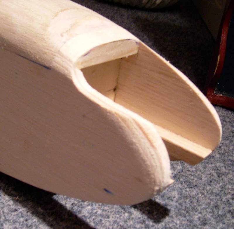

Top of the fuse mounted and engineroom looks already like that of a Taurus.
The sides of this compartment are not finished yet. There still has to be added 5 mm balsa on both sides.
Cees

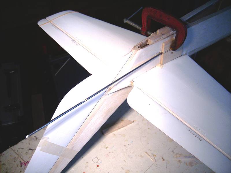

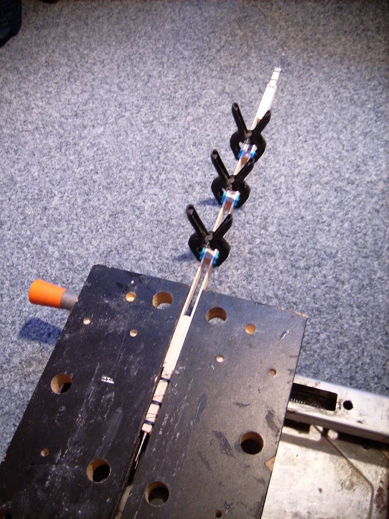

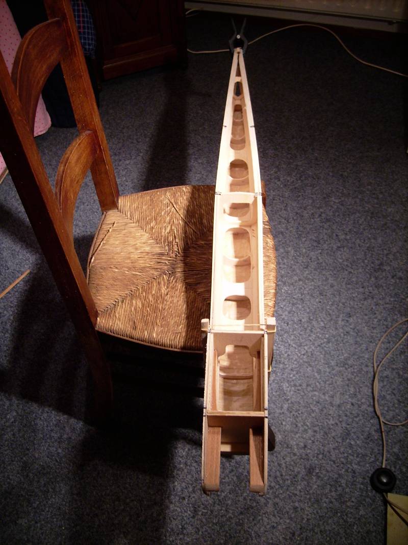

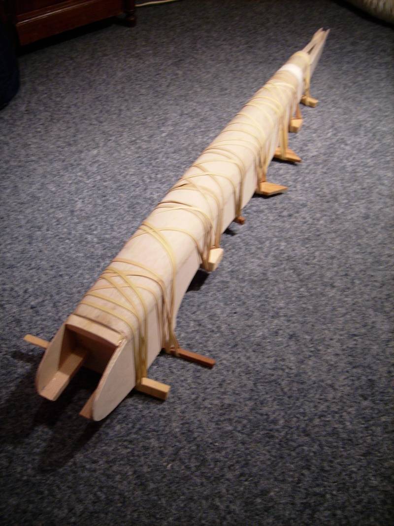

Gents, some progress.
TE of the fin.

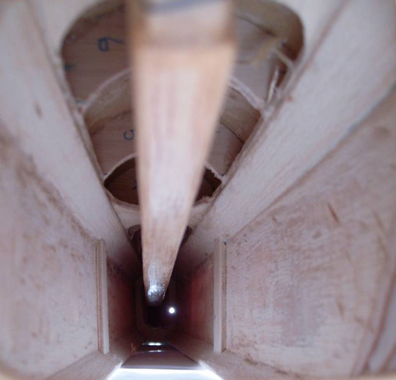

To get the straight fuselage I always mount the fin, so there isn’t an angle between the front and the tail.
First the holes for the threated hangings. The angle I use to get the tread straight between fin and rudder, see picture 1
Gluing the TE in the fuse parallel with the outside of the fuselage sides near the wing.
Later the stab is mounted square on the fin and at last the wing parallel with the stab.
To get the fins parallel, the bottom of the fuselage is still open (like a D tube in the wing)
Last picture as it is this moment.
Cees

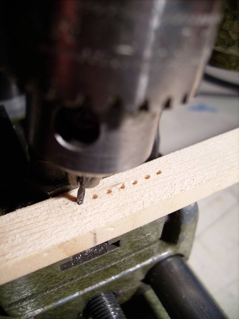

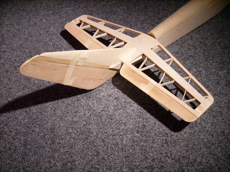

Tail feathers woodwork.
Yes, that looks like a Taurus tail, also the old one.
Fairings of the fin will be made after mounting the planes on the fuselage..
First thing to do is covering the stab, then mounting elevators on the stab with the threated hangings.
Then stab on the fuse with maybe also the pushrod for the elevators and latest the fin and the rudder.
It looks like the "Revive of the Phoenix"
Cees

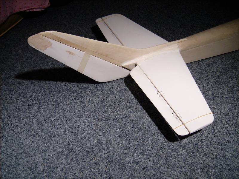

Some work on the stab.
After covering the stab with silk and dope I did paint is with primer.
In the stab the holes are drilled for the threated hangings. Not yet in the elevators.
The elevators are mounted on the lever already.
Next step is mounting the hangings of the elevators on the stab and then stab on the fuselage.

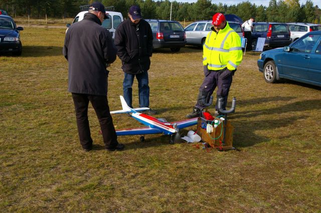

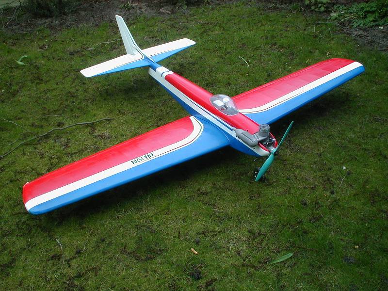

Cees, I found this pictures on a Swedish old timer flying site.
Hope you like them, the engine is an OS 48 4 stroke
I like your building thread, keep up the good work.

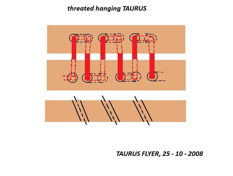

The threaded hangings of the elevators.
The detail picture is the left elevator half of the crate picture. The holes in the stab, 8 holes in the elevator 7 location is also unique.
Below my stab, with paint I also colored the black (grey) and red.

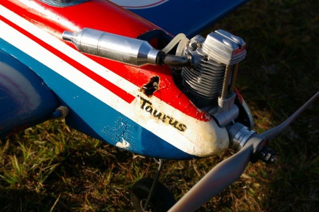

Martenson, nice pictures, does this Taurus still exist? so Yes it is one of the two .
My Taurus in the past also was a period red white and blue (Dutch flag!). See picture.
They did rebuild the engine room to fit the four stroke, but it is an oldy one I think, looking the way the wings are mounted original.

Yes, Martenson's photo looks like an original one, also because the "Taurus" looks like TF decal supplied in the kits. maybe the paint was not "hot fuel proof" because it is blistered in places.

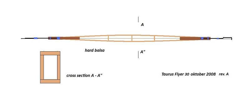

In RCM & E we could read the red squared passage from Ed about the pushrods. In this case the rudder but I think the same about the elevator because it pushes the elevator to give any “up” action.
In an emergency situation a bending pushrod is end of the planes live!

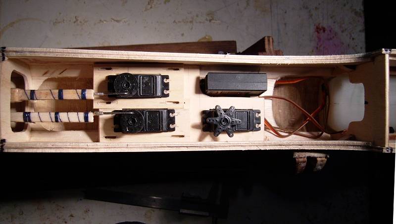

For the elevator I have already make the pushrod and did show a drawing in the past.
It is easy to mount the pushrod connected with the elevator before mounting the stab on the fuselage.
Material the same as the fuse, balsa and already “doped” two times.

Gents a little update.
This is a very old Taurus tail lookes like,
Also a snapshot in the same direction the crate picture is taken in the past, not yet the right distance.
I am sanding the parts so they look the same the best I can. That's you can see on the primer of the rudder.
The elevator pushrod is already mounted. I am working on the rudder pushrod now.
The bottomside of the fuselage is still open, it makes mounting of the pushrods easy.
The threated hangings I probably will mount after painting is finished.
Soon I can start with the wings.
Cees

#94
Gents,
Drilling the hole in the side of the fuselage for a pushrod feed through, I use my “own method” .
Maybe interesting for you,
I clamp the fuselage between two pieces of wood and fill the space between the sides if necessary.
Do not use too much pressure, it is only to guide the bore.
Now drill the hole in the piece of wood outside the fuse but in the right direction to the servo.
My fuse is 1/8 is 3 mm thick on this place.
To drill the hole I use piano wire, the point of the bore I make myself (picture 2). Diameter 3 mm (1/8).
Pictures, the outside 1, inside 2 and result 3!
May this helps you in the dark evenings of the winter to bring an little light in the fuse, picture 4.
Ed did not use this method see picture 5, an example of Ed's fuselage now owned by Kingaltair.
Making the feedthrough this way you do not have to bend the wire of the pushrod . A point Ed did tell us to take care of that.(RCM & E, picture 6), a second advantage is, this feedthrough guides the pushrod.
Cees

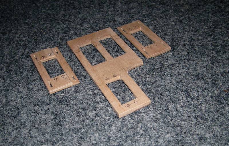

#96
Gents, new pictures.
In the past you did see the engine room, the tailfeathers.
This time some construction pictures of the control room.
As I did show you in the last post the position of the elevator servo is adjustable, so we can make inside and outside loops with full throw and without transmitter adjustments.
Why?
This is Classic Pattern Flying and I want to experience what Ed did have to do to trim his plane. Maybe not on this may, the servo’s he did use were linear, but then he has to do it another way.
When I do have the right adjustment I can recalculate the right angle of the elevator lever to draw it on the plans. Than the servo can have a fixed position in next planes.
Two pictures of the mouting plates of the elevator and rudder servo and the tray. Also the rudder I can adjust.
Last picture the mounting position in the Wester Taurus. Plenty of control room, even for the receiver. The battery gets a place beneath the tank.
After the adjustments are made it is possible to glue the adjustable plates and tray together if I want.
Cees

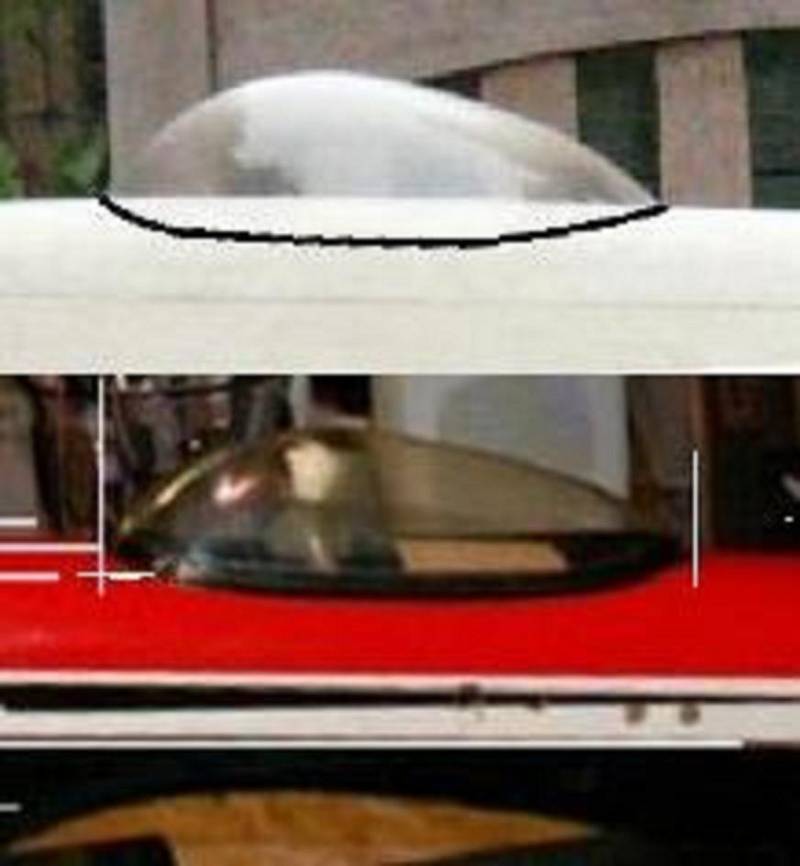

To duplicate the canopy I use a picture of the fuselage of Duane, in the past this picture is made by Noblechuck.
An old Top Flite canopy probably also used on the fuselage in the crate. (Maybe the same canopy?)
The result we will see in the future when comparing the pictures.
With our modern computer systems it is easy to compare the shape of the plug and the canopy on the picture, using the program "Paint".
Simple laying the plug picture on the original of Noblechuck.
I can stretch the plug picture vertical and horizontal to see what to do to get the right dimensions.
The red line in the plug picture is the top of the fuselage.
I show you both pictures separate in one display.
Cees
