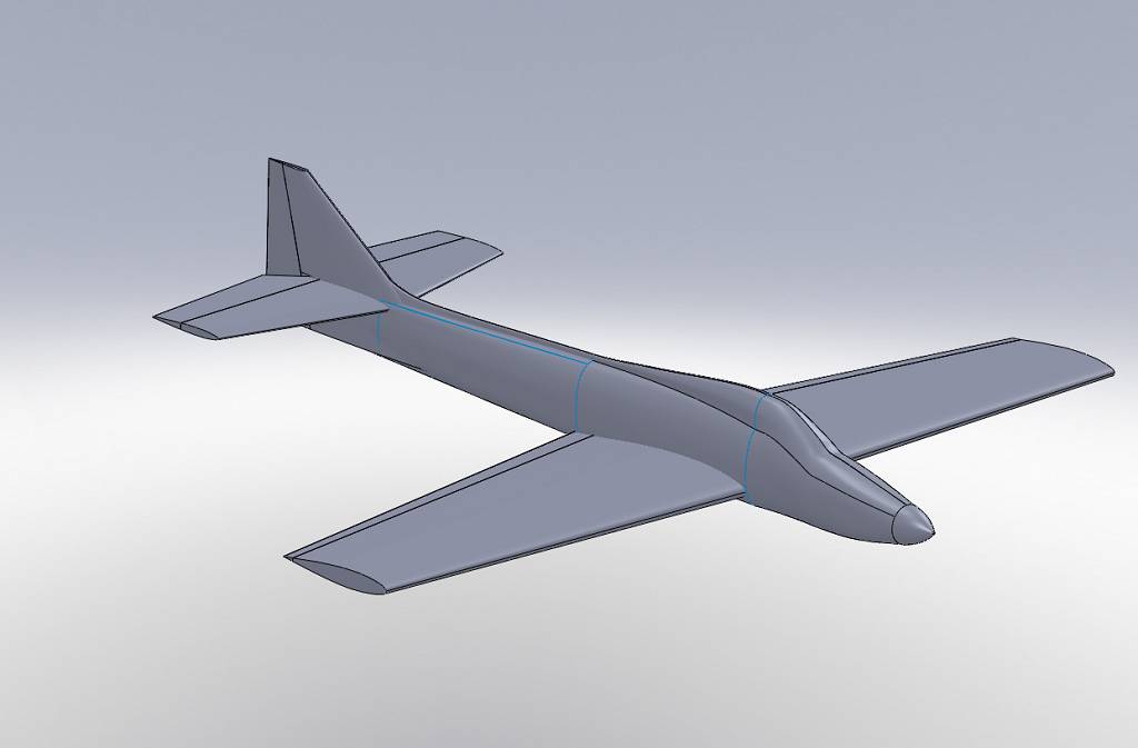

I will take the appropriate action.
Mach-1 anyone, this one I flew in the 80's
bob

Bob,
in my view, the M1 could stand a major internal re-design if it is being "modernized". No change to the lines or moments of course but the use of 3/8" or thicker balsa "slabs" is in my opinion due for an overhaul.
Beautiful model.
David.
Beautiful model.
David.

The 3D is done, so now I can create new fuselage sections.
bob
