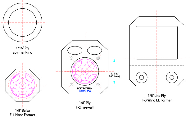

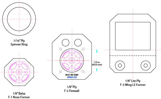

Phil,
try the following formers for the T10. Scale up for the T20.
They are already adjusted for the additional size required. Parts are on a piece of letter sized paper. Print PDF at 1:1 evidently.
By the way, I found the system for F3 to be a real pain when building the fuse. I'd just cut it out of a single piece of 1/8" lite ply. For the FW, I'd use 1/8" regular ply. I also sized the inner hole in the firewall and spinner ring so that a 28 mm can motor can be slid in from either side. A cooling inlet will be needed on the underside or two little NACA inlets could be made on the side - perhaps cooler looking.
The dashed line in F-3 can be used for a former doubler (say in the T20 or T40) or one can simply use 1/2" lite-ply rings around the dowel holes as shown for the T10. Oval holes in the FW as shown in the second pic might allow a little more airflow over the battery and ESC.
Hope this helps.
David.

Old 04-03-2011 | 09:13 AM
  #278
Joined: Jul 2010
Posts: 191
From: caledonia, MI
Default RE: Tsunami Build Thread
sweet thanks david. I just put an order in to rc timer for a couple 2836 motors. 1120 kv 320 watts. Should fit the bill nicely. Will run on 3 or 4 s so when they get here hopefully construction will comence.also I'm planning on maidening my 40 tsunami at the end of the month. Hope to have a better flying season than i did last year. Thanks again. Phil

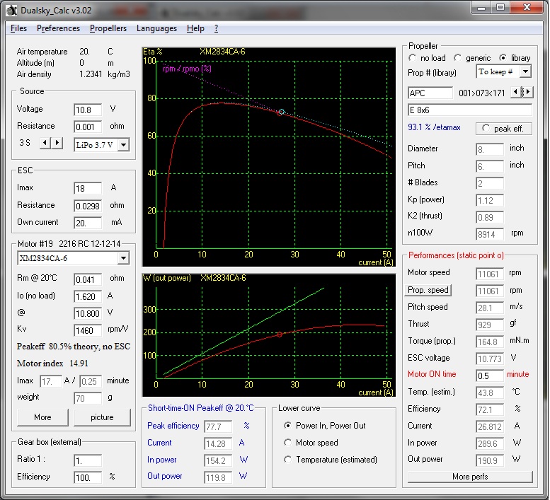

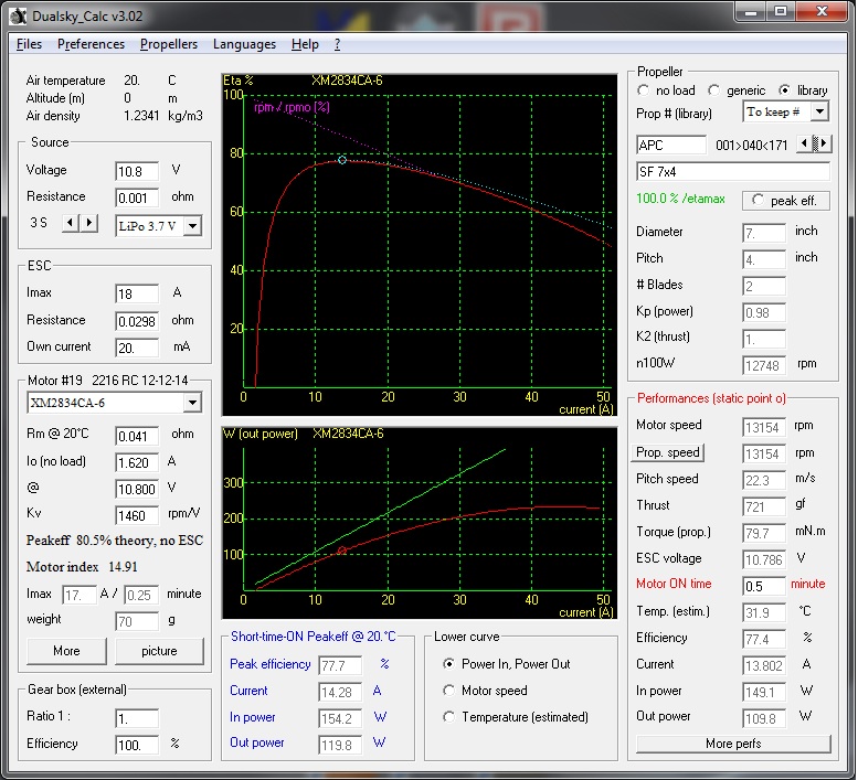

Phil,
what brand and kV is that 2212-06 motor? A 7x4 is going to require a fairly high kV motor (~2000+).
I'm turning an APC E8x6 on a 1460 kV motor (Dualsky XM2834CA-6) for close to 300W (spec) - I've actually not put it on a Watt meter yet. I didn't have one back then. On this same motor an APC SF7x4 would only deliver ~150W input on 3s. I have some APC SF8x3.8 which I want to try as they pull in a different way than the E-props.

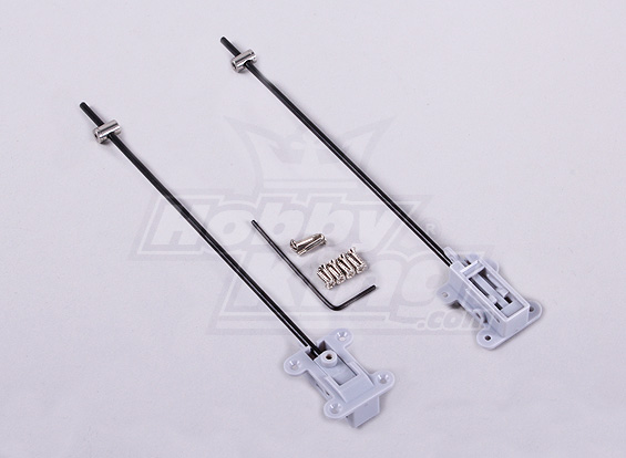

yes definitly going the retract route. That is the one thing i wish i had on my 40 size. I need to find them light enough and small enough first though. I think this should work if i can keep it light enough.I worse comes to worse i'll retract the gear all the time till i can upgrade the power. Phil
Old 04-28-2011 | 08:16 AM
  #299
doxilia's Avatar
Joined: Apr 2008
Posts: 5,200
Received 9 Likes on 9 Posts
From: Montreal, QC, CANADA

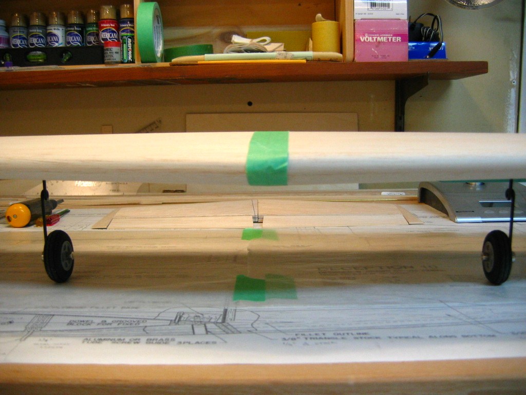

Phil,
At the moment, I'd just go with the GP 10 size retracts - they are small and light - great for this model. Fit perfectly on my Deception 15. The only thing is they have metric struts (2 mm) so you either use a metric wheel on a bent strut (for the axle) or you'll need a coupler at the axle junction (2 mm internal to 1/8" external) to attach 1/8" axles.
I used the GP axles (GPMQ4279) like the ones in the first photo but I'd probably use the DB ones (#613) in the second pic - just a little cleaner and I think lighter.
David.

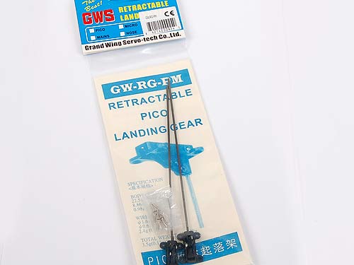

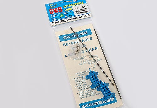

You could also take a look at the GWS mechanicals. They have two small ones: Micro and Pico. They are pretty low cost at HK. Might consider a servo in each wing panel into a ply shear web for ease of setup.
David.
