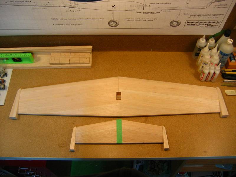

#55

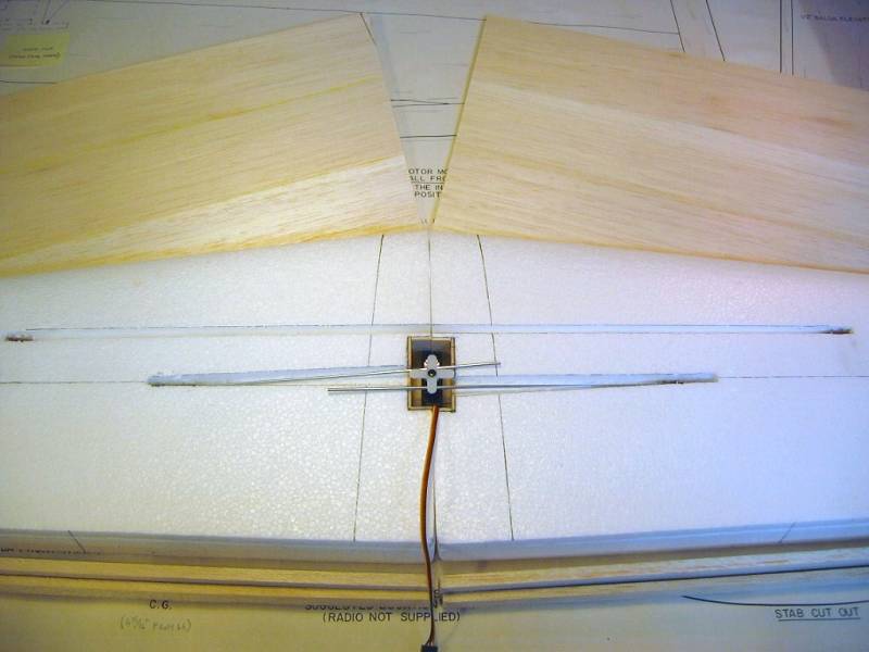

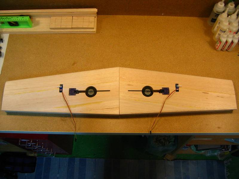

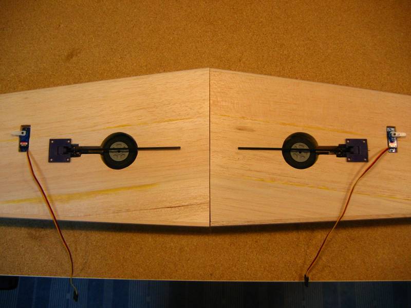

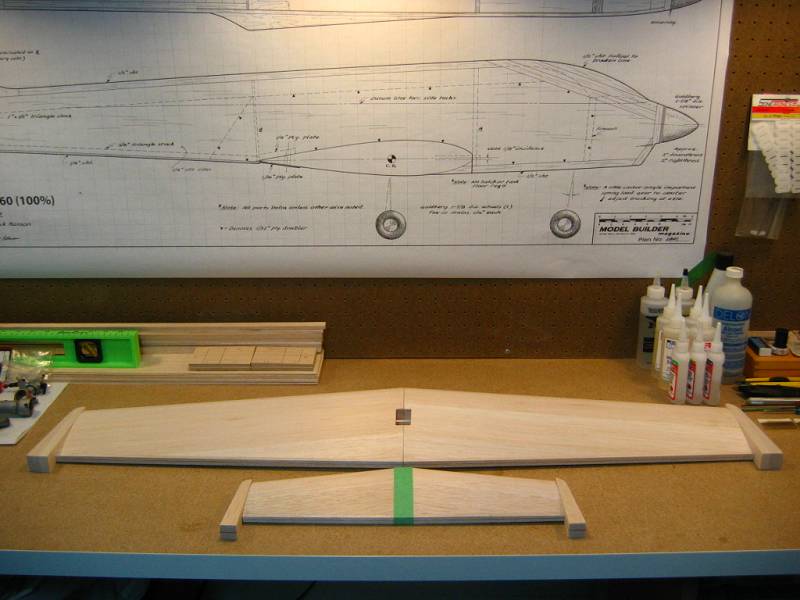

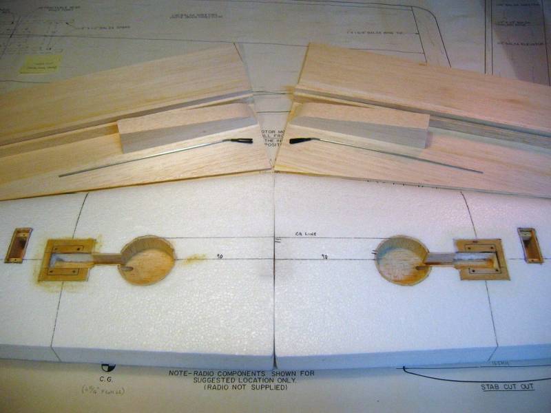

A little more progress today...
Stab is ready for elevators (need some 3/8" sheet balsa) to be cut and sanded followed by stab tips which are ready to be glued and sanded.

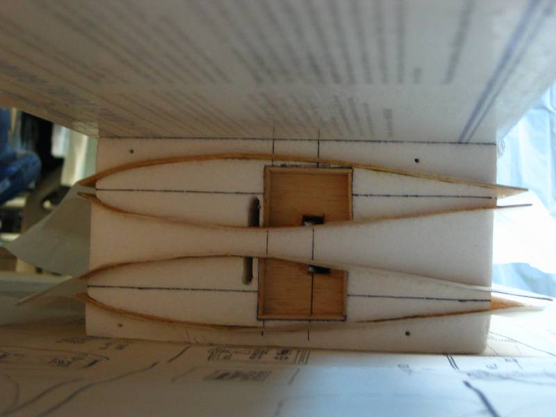

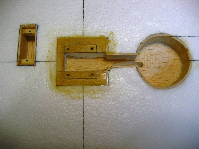

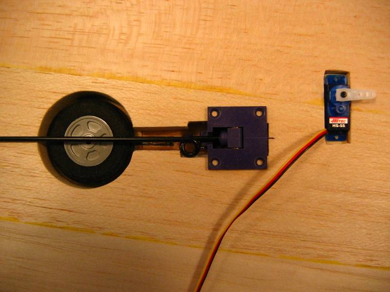

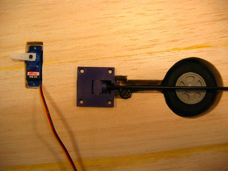

Wing prep is finally complete. Servo wells, lead tunnels and retract linkage tunnels done. Given the small dimension of the wing, routing the pushrods in the wheel bays was impractical. There was also not enough of an angle to allow the rods to route away from the center of the wheel in order to clear the axle and collar. After staring and thinking of how to do this 100 different ways, I finally concluded to route the rods through the wing and over the top of the bays toward the center mounted servo. In manual tests it appears to work well.
Because the wing has had foam removed in the wheel area on the top and bottom, I've decided to reinforce it prior to sheeting using carbon tape. I'll run one strand along the bottom CG line between the aileron servo bays (ie below the servo lead tunnels) and another along the top between the servo lead tunnels and the gear pushrod tunnels. These strips will effectively act as spars.

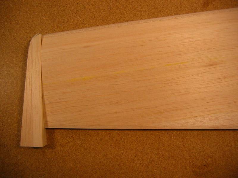

Wing sheeting, LE, TE, and tips are ready for final assembly. In order to save a few $ on the wing/stab tips, rather than buying thick blocks, I bought two thinner balsa sticks - 1" x 1/2" (soft) and 1" x 3/4" (medium). The latter was used as is for the stab tips. For the wing tips I cut laminated the 1/2" and 3/4" sticks to form a 1" x 1-1/4" block and then cut the tips from this. The soft inner balsa will allow me to hollow the tip insides more easily while the harder outer block provides some resistance to knocks.
I'm looking forward to finished wing panels!
David.

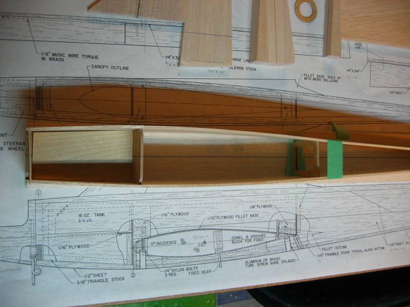

#56

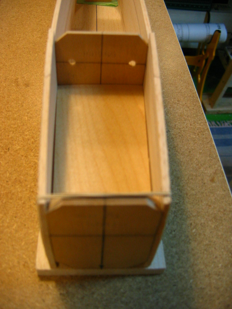

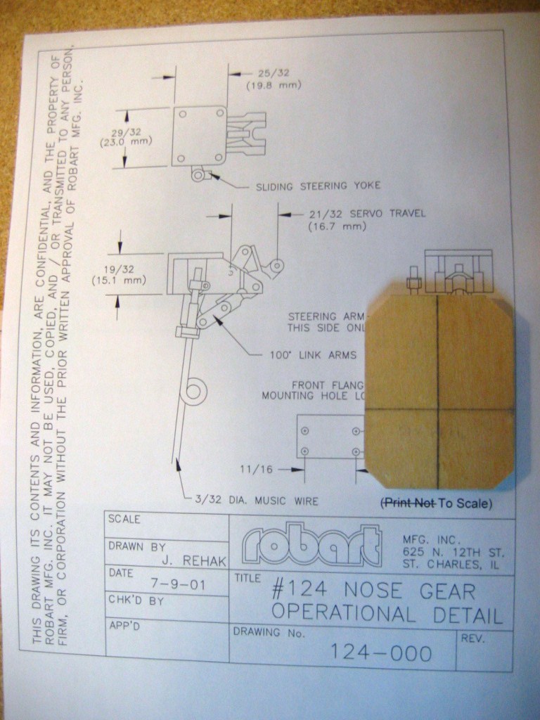

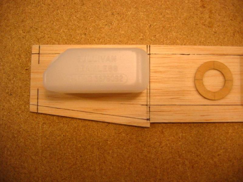

On the fuse side,
final cutting and shaping of formers has been finished. 4 oz tank fits nicely with about 1/8" on either side of it for some foam padding. Space below tank floor provides room for a 1-3/4" nose wheel if desired but I'll use a 1-1/2" Lectra Lite to provide more space for the nose gear servo. I hope to be able to Y-connect the retract servos to channel 5 (will depend on required travel for each) leaving me with two channels for aileron servos. Still waiting for the engine mounts and the nose gear in order to install onto FW.
Quick trial assembly of fuse to check parts fit and alignment. I discovered that one of my two fuse upper 1/2" triangle stock was actually 9/16"
. Back to the LHS for elevators and triangle stock.

#73
Bottom work...

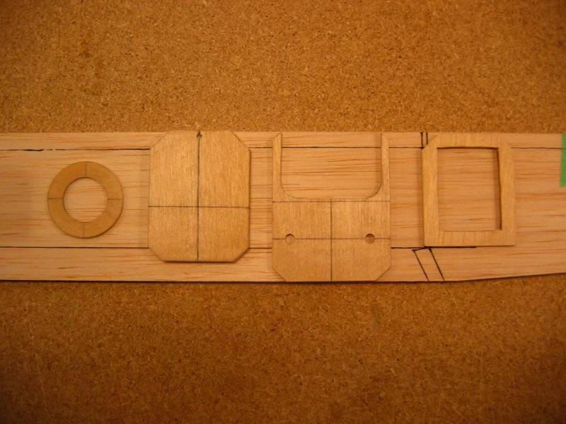

Wells begin 90 mm in and run for 112 mm. First cut... very slooowwwwly...
Servo wells centered at 235mm along CG line just forward of front gear plate. Make littlest hole possible - hollow - good, we're in.

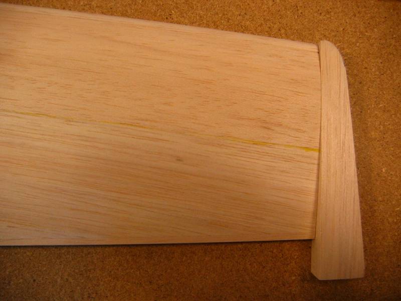

Ailerons & elevators, here we come!
Tack glue, sand to contour, mark aileron line. Next, tack glue tips, sand to contour and pop off. Hollow tips, glue permanently.
Pop off TE, cut ailerons, glue center TE portions, hinge ailerons. Bevel ailerons. Wing done! Follow suit with stab.
We're almost there.
David.
We're almost there.
David.

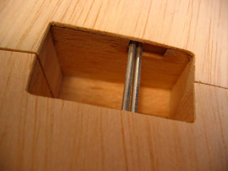

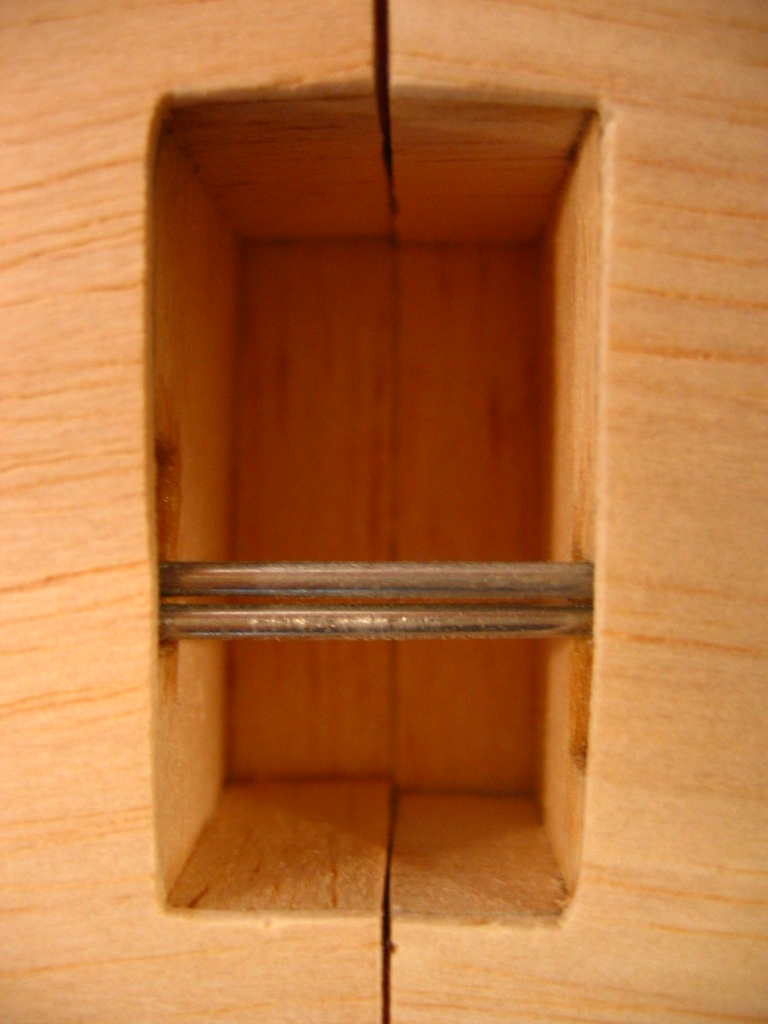

#75

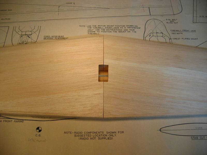

Before I tuck in and forget, I should mention:
I cut the retract rod wells in the wing as two opposing triangles with a common side along the LG axis. When retracted, the pushrods on either side line up along the LG axis with the rod connectors at 90 deg to the servo axis and in line with each other. When the LG is extended, the pushrods rotate and the connectors line up with the servo axis causing the rods to move diagonally along the wing chord - forward for one panel, rearward for the other. The rod openings in the gear servo bay show this assymetry (see photos above).
Now, we just have to hope it works as crudely tested... we'll need a joined wing first.
David.
David.
