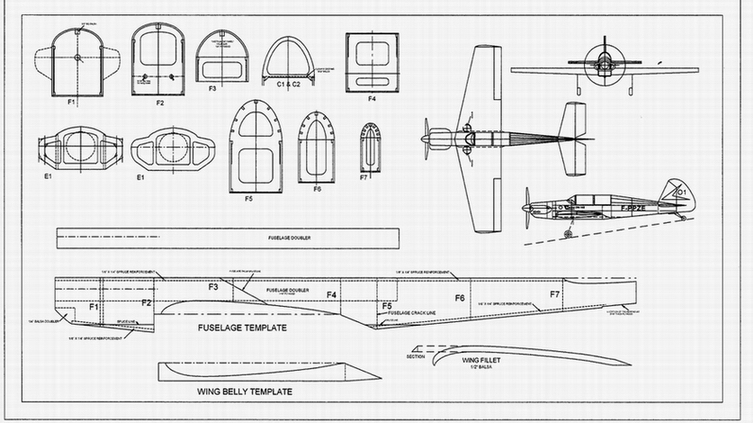

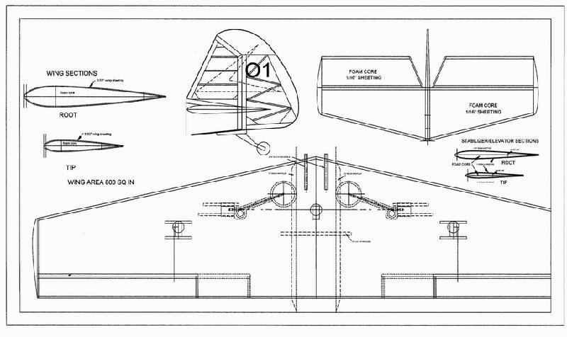

Doxilla,
As you can see, the plane is a little different than the one you showed plans for in an earlier post, but it's kind of funny, the trim scheme on the rudder on my plane is the same as (or very similar to) your last picture...
