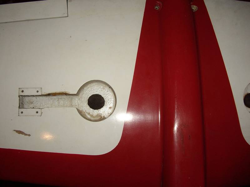

I have a Starting point I bought a nice finished foam wing with minor cosmetic dammage, for $5.00, at a swap meet :- It matches the
Man plan exactly .
The wing has a nice fiberglass pan attached so I suspect it came from a glass kit that crashed.
I have the plan and a copy of the Man Issue but the construction article is confusing
I am going to start by cutting out all the bits out that I can see on the plan and go from there.
The tail plane is a bit of a issue, the origional was a removable setup what is the best way to go here ?

Ok this is what I have worked out
My OS61 V will fit fine but If I use the pump it will be a tight fit &gt;&gt; not alot of room !!! , I may have to use just presure feed from the pipe,
I have a Tuned pipe that is a exact fit even though the back is no the Squared off type used on the origional model
AMACheadder will also fit ( I will need to cut it down)
My Rohm retracts will also fit, this front one looks just the job.
I also have a Fuel tank that will fit as per the plan.
Now all I have to do is run the OS61 On the pipe and make sure the fuel pump works without the return as I only have a 7M or a 7D carb
Then its time to start cutting wood.
Thanks for the support
Johnkpap

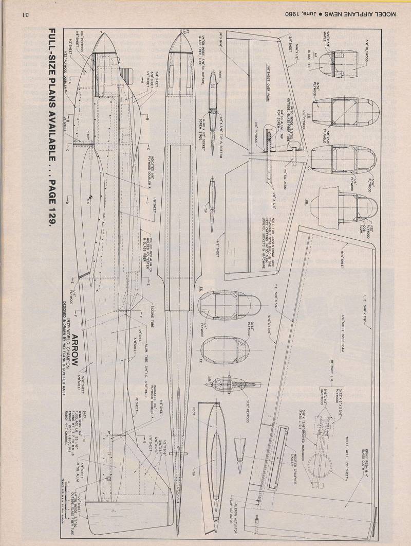

The link to the plan of the arrow is :-
http://www.trentonrcflyers.com/patte...structions.htm
Thanks CAsniffer
I have Scanned the Arrow Build from my copy MAN
I have cut out a basic set of paper templates, and have some Idea of how to build the plane now.
I have found one or two small errors on the plan the lower part of former position BB shows a aera of ply ??? Ithis is in the middle of the wheel area !!!
I suspect Former CC should have the Ply area.
I will start cutting out a Kit of parts on my band saw soon
Johnkpap

ORIGINAL: rainedave
Good research David! Wikipedia is no doubt a great source of info. Individual entries are usually edited by multiple parties, and are kept more reliable than a lot of of other web info. But, even though there is a ton of interlinking between related entries, you don't see enough editing of bodies of related entries as a whole. So, depending on how one enters Wikipedia, conflicting info can be found
From a historical point of view it would also be interesting to know how much Prettner and Matt knew about South American hunting practices and where they got their info. Maybe their interests derived from popular art and literature (sort of like trying to learn about American Indians from watching Hollywood westerns).[X(] []
Anyway, looking at the RCM&amp;E article I spied a familiar engine. The Webra 1030 with a Dynamix, just like the one I was testing last week. I'm getting more interested in building an Arrow. I would consider renaming it the Dart, but Lanier already grabbed that name.
David
David,
Ihave come to learn about that issue with Wikipedia too. I was curious about the Dart aspect of the use of Curare and never imagined that some of it was animal derived - always assuming that plants were the exclusive source. Iwas also told as a boy that it was in the "jungles of Brazil" that it was used but I've yet to find any reference to Brazil. Mind you, borders such as the one between Colombia and Brazil were probably of little interest (or discernible difference) to the people who used Curare and Darts.
Having an awareness of how education proceeded in Europe during my father's generation (that of Prettner and Matt) with all the Greek and Latin that was taught on a regular basis, Isuspect that the two were not in the dark as to the history, origin and use of poisons such as Curare. Perhaps one day, I'll get my neighbor to translate into German (out of politeness) a simple letter to Prettner asking him about this story. While Prettner's Curare had "rotationally symmetric" tail surfaces (anhedral) that are reminiscent of the feathers on the back of arrows to insure tracking stability, Isuspect that Hanno named his pattern ship Curare, among other reasons, due to the shape of it's nose. Hanno rarely used spinners prior to the Magic and the prop nut and shape of the fuse nose does convey the image of a Dart. On the other hand, Matt's Arrow does look much more like one despite its flat stab.
The Arrow/Magic era (they competed at the same time although Hanno's Magic was down in Acapulco '79 due to over heating in the first Magic prototype which didn't have the inverted engine) must have been the height of classic pattern sophistication - variable pitch props, in flight mixture control, double tuned pipes, flaps, spoliers, dual flaperon servos, etc.
Unfortunately, the word "Dart"in English is not a great word for a pattern ship to my mind (Ihad the same idea). But you might consider renaming it the Richtungspfeil
Whatever the name, I do think that your 1030 should go into one!
Now... I wouldn't be surprised if you fellas down under have a variation of Arrow's and Curare! That pumped 61 VF is going to spool up the Arrow into the lower troposphere! If only the cutoff date for SPAwas Jan 1st, 1981...
David.

For whatever reason, sometimes when I download JPG's from RCU Iend up with a squashed photo which results from the portrait photo being squeezed into a landscape aspect ratio. This happened with John's MAN article photo upload. This might be due to RCUattempting to fit A4 sizing into a Letter AR - dunno.
Isorted things out in Illustrator and created a PDF of each article. For those interested, you can download the two attachements as "Arrow Article MAN.pdf" (7 pages) &amp; "Arrow Article RCME.pdf" (3 pages), respectively (right click and save as).
David.
