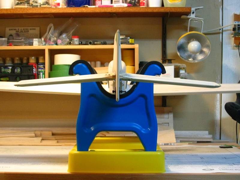

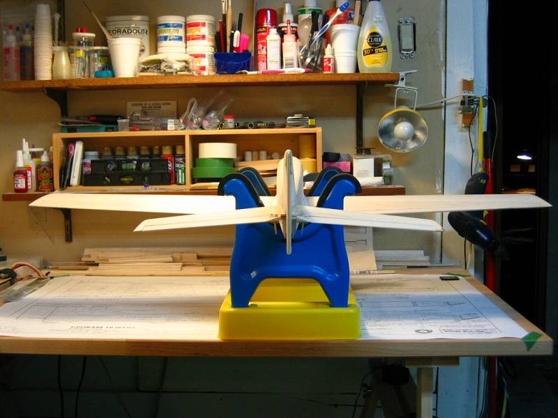

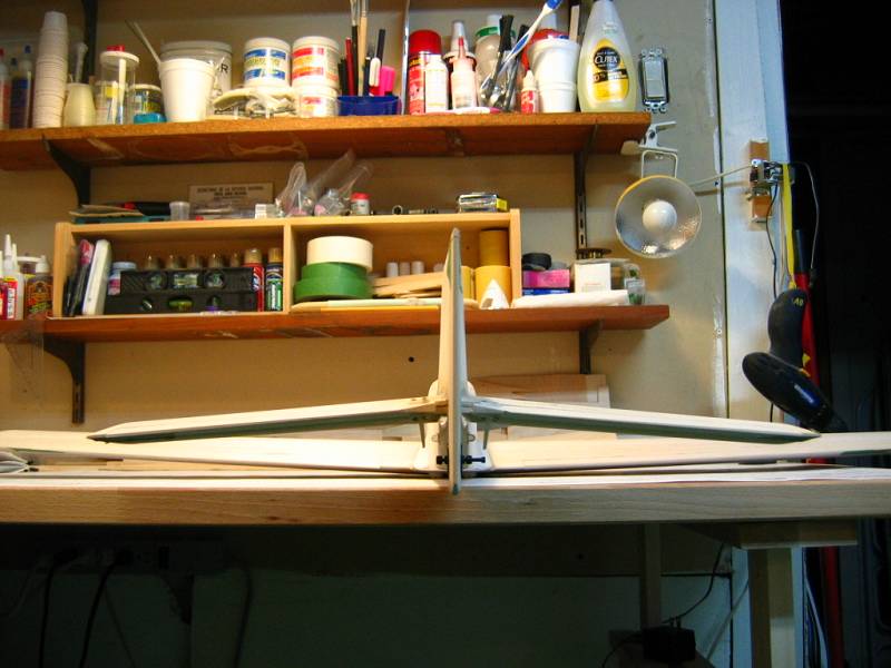

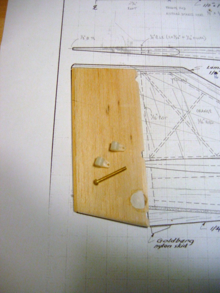

Tending to put off the stab mounting as much as I can, I went ahead and got it mounted this evening. I'm feeling pretty good about its 3D positioning with respect to the fuse and levelness with respect to the wing. I find anhedral stabs are tricky to get right as you can't rely on a level to compare it to the wing - it has to be done by triangulation so to speak. I hope it'll still look good to me tormorrow because I've also made the fillets between the stab and the fin.
Other than that, I sorted out the wing bolts and replaced the 6-32 for 10-32's as I didn't have any 8-32's. The stab mount and fillets brought the airframe weight up to 12.5 oz. Hopefully another 1/2 oz for the FW and some tri stock and we'll be done!
Motor should be here Tuesday so I should be able to get the build wrapped up either Tuesday or Wednesday. The only remaining details left involve the tuck lines and the canopy/fuse front shape which require the FW to be installed.

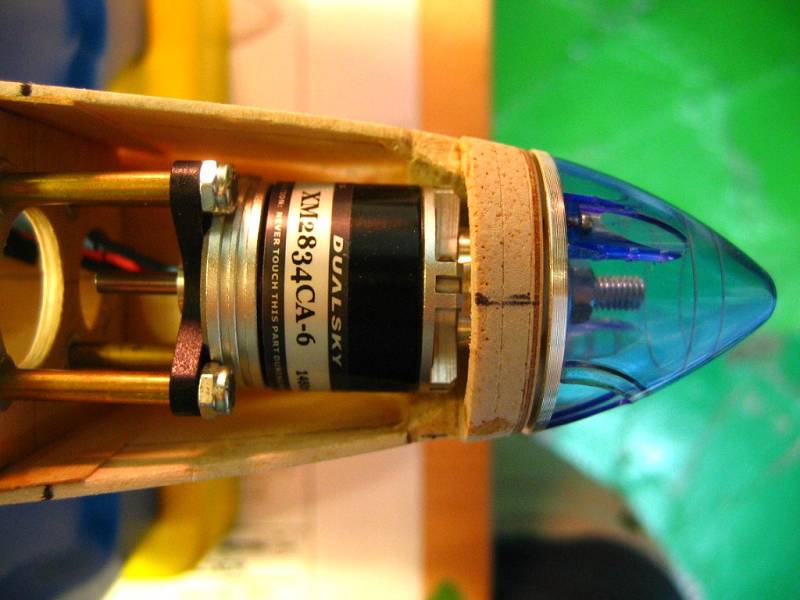

#27

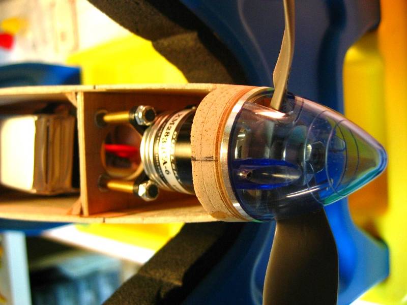

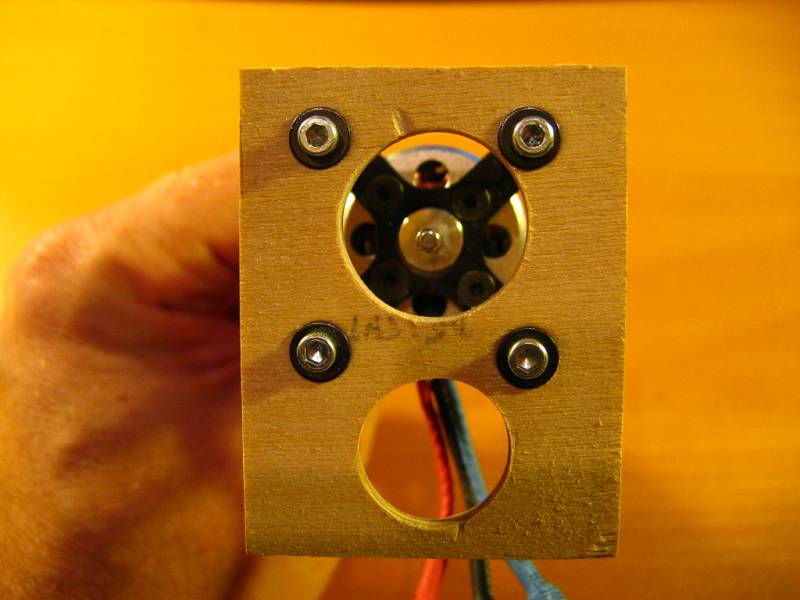

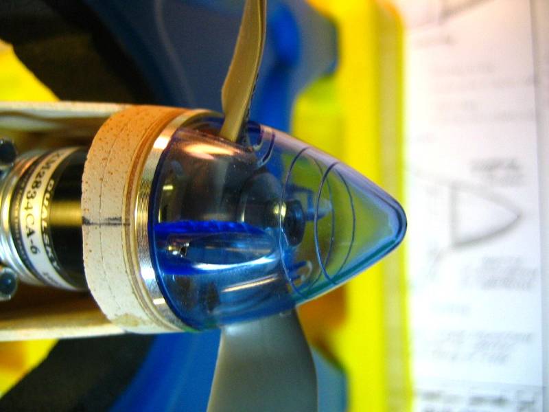

Good news! The motors arrived and they seem quite nice. I spun one up the other day and a gut feeling tells me they should pull the Pico along nicely. What remains to decide is what to do with the second one!
I was a little over ambitious with my 8-32 standoffs. The motor X-mount just passes 4-40 bolts so I had to devise another system. It also becomes quite tricky to get an allen key to the lower two mounting bolts so what I did is mount the motor by reversing the bolts and using lock nuts at the X-mount. Basically, I passed 4 x 1-1/4" bolts from behind the FW and put washers on either side of it. I then slid some copper standoffs 7/8" long and tightened the X-mount onto the protruding bolt ends with the lock nuts. I added some blue thread lock to the lock nuts and to the various motor bolts including those that mount the motor to the X-mount and those of the prop adapter.
In order to clear the balsa nose rings, the motor sits back from these about 1/4" and a spacer on the prop shaft locates the spinner backplate at the correct position. The shaft itself actually has the core threaded to allow a small Allen bolt to secure the cone of a small spinner. I'm not sure what the thread size is nor what spinner would work with this but I plan to use a light electric GP spinner either with a plastic cone or an aluminium one. For the latter, the shaft threads might actually be useful.
In short, I feel the dimensions of this motor were the right way to go from a built standpoint. I also prefer the standoff FW mount to a nose ring front mount (i.e. inrunner) particularly because there isn't great strength built into the nose ring section of the model even though I doubled on the nose ring balsa backers. We'll see how it fares from a power plant standpoint.
Attached are some pics of the motor mounted on the FW which has been drilled out to allow air back over the battery and ESC. Next I'll install the assembly into the nose.

#28
An hour or so later...
I got the motor mounted and backed with some tri stock. Perhaps a little more in the front and some along the bottom behind the FW to strengthen the nose section and with a little final sanding to the fuse and canopy we'll be ready for some finishing!
Here's the motor mounted. As can be seen, the front of the can actually ends before the balsa nose ring backers. The prop shaft just allows a beefy nylon washer to be threaded on to it and provide enough length for the spinner backplate, prop hub (APC 8x6E), prop washer and prop nut. Bigger props with thicker hubs might be a problem as there might not be enough thread.
However, I don't intend to use a prop any longer than 8". If anything, I might use a 7x6.5SF or similar.

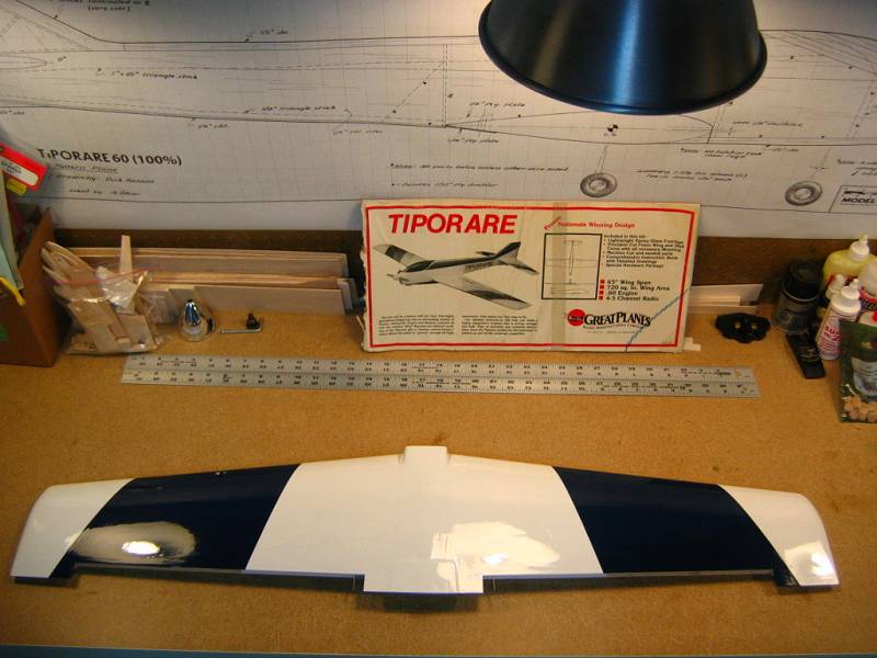

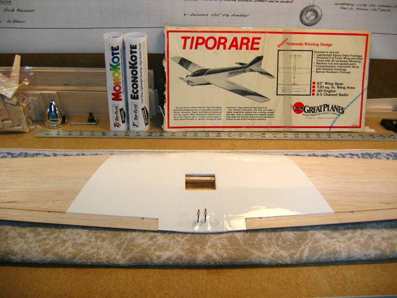

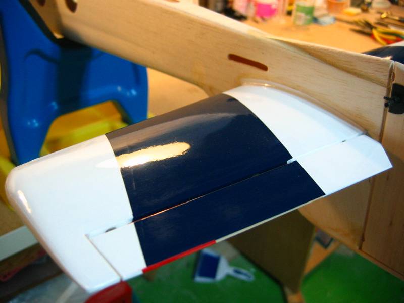

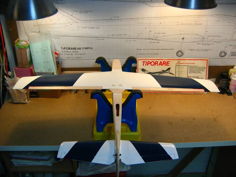

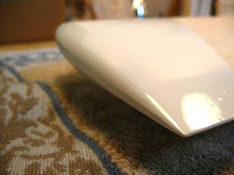

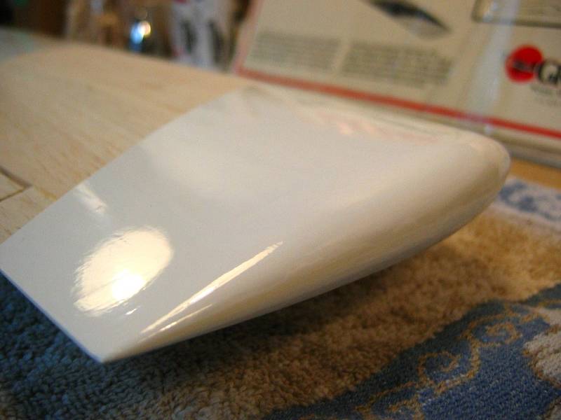

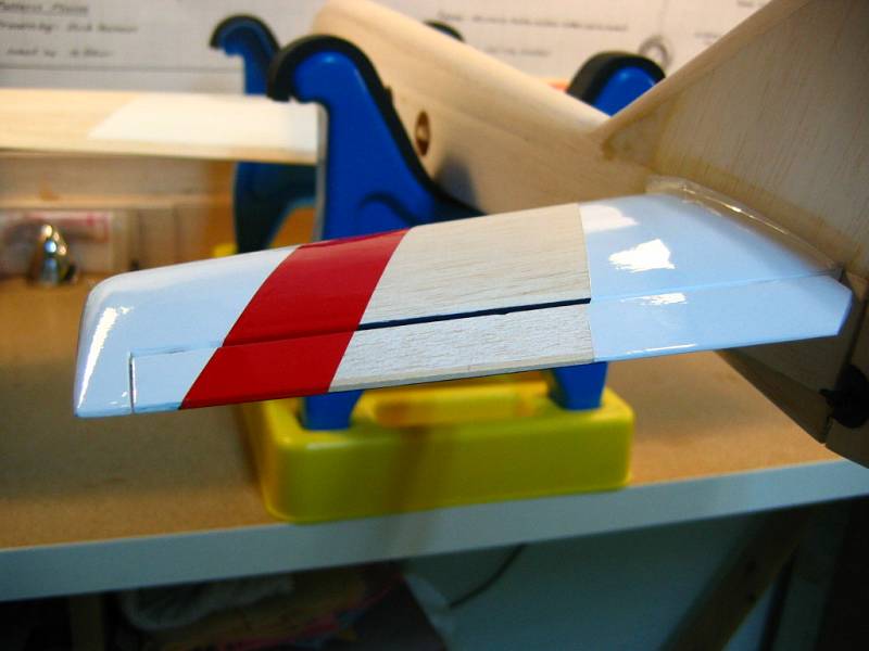

In other news, I quit sweating the tuck lines (it's a bit like sculpting clay...) and got down to some covering!
The wing bottom is done. White MK base with Insignia Blue EK trim - it worked. Some details to tidy up around the front fuse section on the wing.
Wing top will be different... somewhat.
Weight gain from the covering on the bottom half was around 0.6 oz which is great. This should yield a finished wing at around 7.5 oz and an airframe in the 15 oz range - not bad for a 40" model with fully sheeted airfoiled surfaces. But I know David will do better with his UFO...

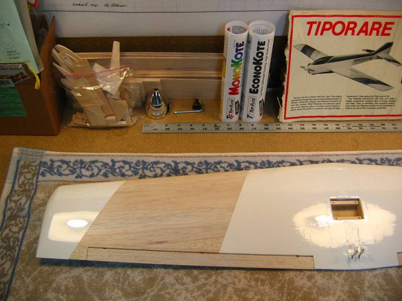

#41

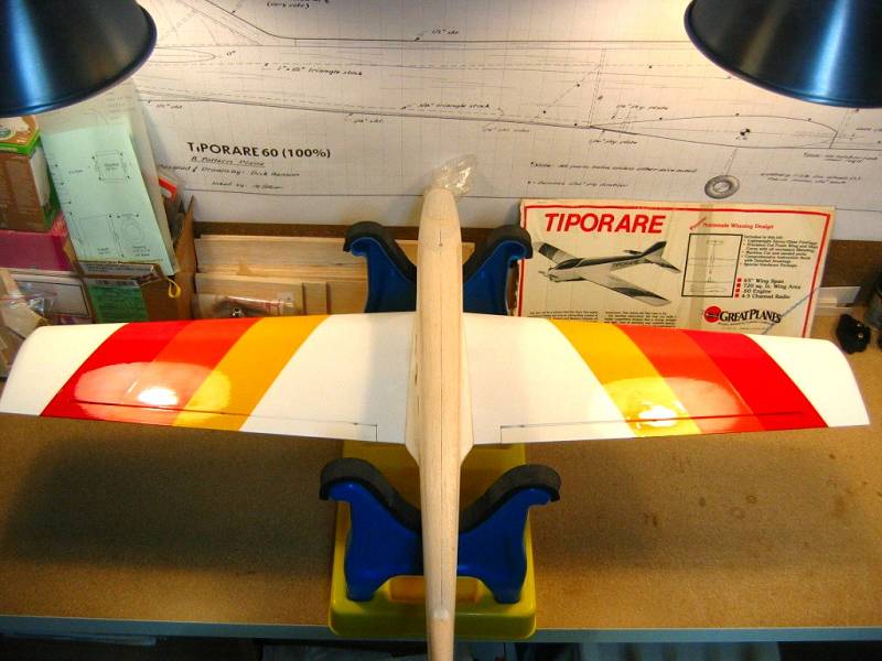

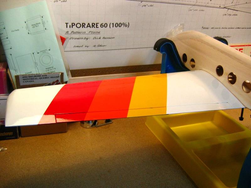

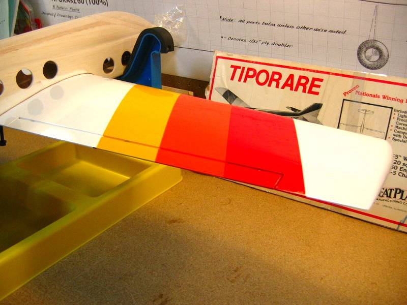

I got a little further this evening. Considering it was a national holiday south of the border (and mum's birthday
), not too bad.
I'm either getting a little better at the compound curve thing with MK or TF's new formulation is making the material easier to stretch and fold over. I can never quite get a perfectly horizontal material cut on the tips even with single edge blades (I need to improve on that technique), but all in all I'm quite happy with how the wing covering is coming along. The wing tips are actually wrinkle free (1/2 hour each of iron time). The rest also worked out fine although I always dislike the appearance of covering over glass cloth. I wasn't about to paint the center section on this one though and the glassed area is not visible except for a small section underneath.
Now I just need to get my hands on the trim colours to finish the wing. I'll probably move on to the empennage next.
The wing stands at 6.9 oz. The top trim and aileron cover will probably bring her up to ~7.2 oz.

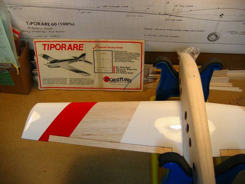

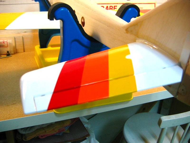

Nothing too exciting to report tonight but got the first shade of colour on - gotta keep the momentum up. Picked up some flicks to watch with "my dearly beloved" so it'll be a night of non-cover.
Those a little more familiar with Tipo trivia might start to recognize an emerging pattern. Anyone care to guess what colour(s) is/are missing on the wing?

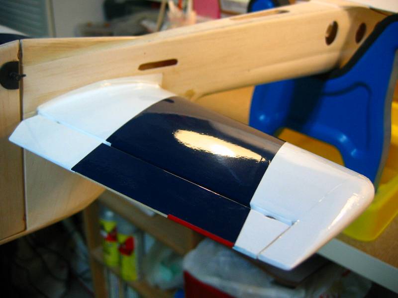

#43

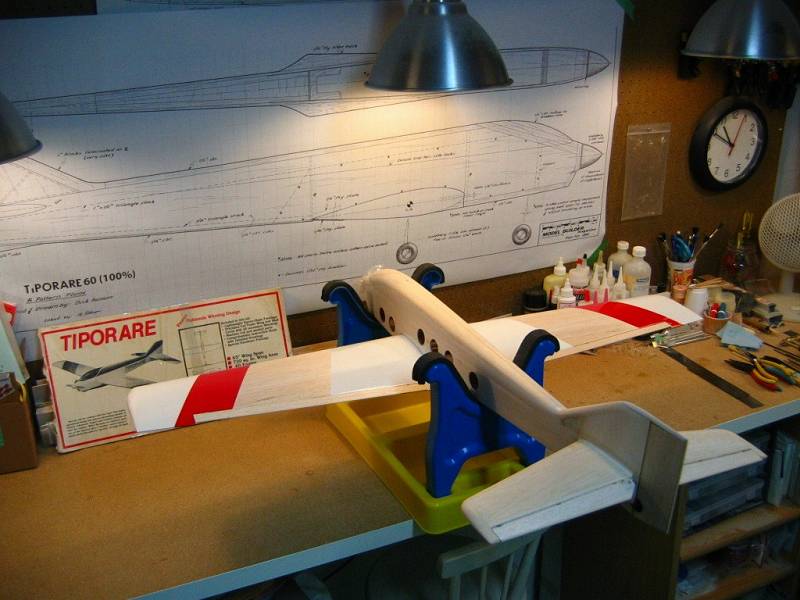

So, after a night off for a soiree with the "wee kitchen" (old fashioned Irish term of endearment for one's wife), I got back to the job at hand.
Although I started a little late (and am also working a little too late into the night), I managed to get the stab & elevators a little further than the state of the wing - the latter has ailerons that remain to be covered.
It actually took me 4 hours to measure, re-measure, cut, and apply all 24 pieces of covering to the stab & elevators. And there are 8 pieces still left to do (I wish I had those colours but, alas, I don't yet)! That brings the simple trim scheme on the horizontal empennage to a total of 32 pieces of covering [:-]. The wing, since it doesn't need separate pieces on each side of the rudder as the stab does has a piece count of 2 less - 30 pieces.
Hopefully I'll manage to keep the fuse piece cut down a tad! Here are some update pics.
David.
P.S. Weird, the photos "bubbled" on upload. The covering doesn't look all bubbly as seen in these pictures. I've seen this happen before on other threads though - it's probably jpg compression which is worse on rich saturated colours (e.g., red).
David.

I sorted out the rudder linkage which I was unhappy with. I ended up going with a "standard pattern" approach using a 1/2" dowel insert in the rudder drilled out for a 4-40 bolt which will have a pair of eyelets on each side for the P-P linkage. I just have to decide how long a screw to use.
I also managed to get some covering on the fin post and the fuse bottom rear and spent some time figuring out the fuselage trim scheme on the plans. I'll have to make a template for the colour trim as this will be the trickiest to apply.
After covering the fuse bottom and nose, I'm also hoping to cover the sides, fin and top in three pieces total. The fuse side and fin piece (one per side) will be cut according to plan trim sketches and a stab cutout will be made in each piece as if one were cutting balsa fuse sides.
The top piece is a little trickier as it will have a gull-like shape which I'll have to measure and cut with some care.
I'm hoping some of you might have already guessed what she's going to look like!
David.
David.

Flying surfaces are done!
Now that her colours are on, some of you Tipo fans will probably recognize the scheme - De Facto Tiporare.
The camera doesn't render the colour properly but it's the red/orange/yellow rainbow scheme that is actually used by the 1982 Great Planes box model! Although the GP box and instructions are not in colour (hence no way to really tell), there is one source - the GP 1982 catalog.
I've wanted to build a Tipo with this scheme for 25 years... now, she's finally here - almost.
Applying the scheme to the fuse will be more akin to tensor calculus compared to the flying surfaces - they were a walk in the park!
Current airframe weight is 13.9 oz - she should come in at 15-16 oz finished. So the AUW will be in the 26-28 oz range.
David.
David.
#50
David,
What is that yellow?
It's neat to see it come alive. Nice concept. And you're weight is right on the money. Good job!
I wish you lived closer, I'd love to see it fly in person!
Andy
