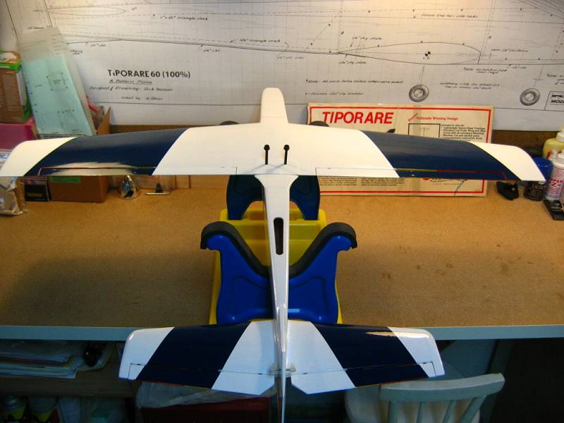

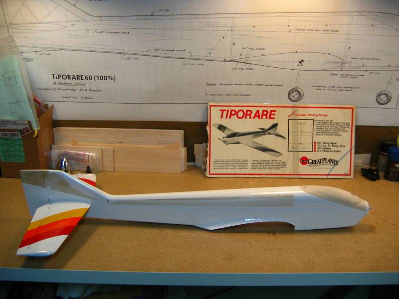

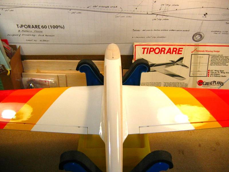

well the trim covering is a bit of a cocktail - basically what I had or what I could find locally.
The bottom is EK insignia blue. The top is MK missile red and cub yellow with the orange being UC (actually Oracover since it's imported from Germany). The orange is actually re-branded once more and called "Skycoat" - my LHS's distribution brand since they're more of a distributor here (more or less). I've never used UC until now and liked and disliked some things about it. It seems thin and light, has a nice backing (easy to remove and doesn't leave static), lies flat and can be repositioned. The glue is rather temperature sensitive and doesn't like too much heat or else it doesn't hold, it has an interesting "bead" pattern which diffuses light so the reflections off it are more dull. It has less sheen than MK - for flying, I can see how this might be good, for static not so much.
The scheme is actually, I believe, supposed to be MK missile red, orange and yellow (not cub) but I decided to use cub as I had some and it has a little more punch colour wise. It looks like mustard in the pictures - it's not. In any case, it's a slight variation and I'm happy to finally have done the trim scheme I've thought of, on and off, for years. As far as I know, and unlike many standard classic trims schemes (e.g., Aurora, Blue Angel, Curare, etc.), there hasn't ever been another Tipo finished in this particular scheme other than the prototype - at least to my knowledge. I find it interesting that no one (perhaps a few stray cats including myself) ever considered doing the "box scheme" when hundreds (if not thousands) of GP kits must have been sold.
I was hoping to finish the covering tomorrow but I've been commissioned for an extended family matter.
I'm anxious to get her airborne. The lipo's should be here the week of the 20th I hope.

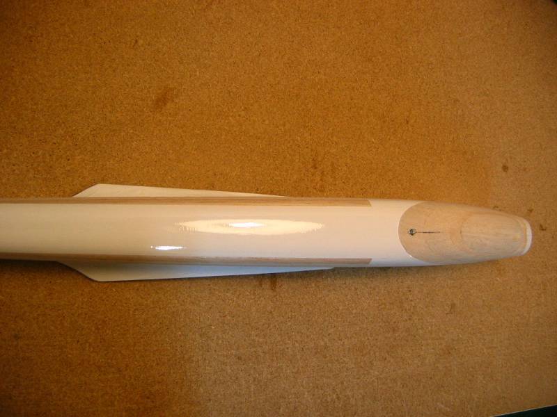

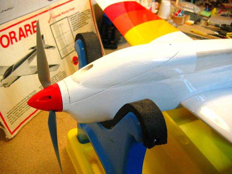

A little further progress this evening. I finished the white base layer on the fuse. A little tidy up work remains to be done on the fin LE strip but otherwise the fuse is ready for the colour trim.
I also drilled out and sanded the cooling hole in the canopy for the motor, battery and ESC. The hole exits the bottom of the canopy into the motor and battery bay via two ducts. I'm hoping that the ducted channel will blow air directly on to the lipo and on to the rear of the motor. A second hole is of course still present in the chin of the fuse to allow air into the bottom of the motor bay and back across the FW across the ESC.
I should be able to get the fuse trim done tomorrow and complete the covering of the model with the canopy. This last will be a fun exercise in MK stretching!

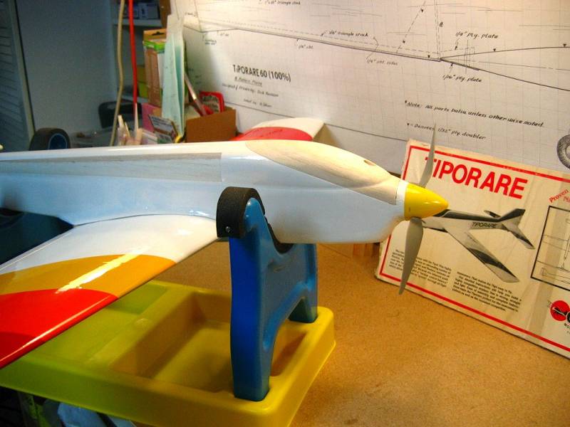

I can't decide what type of spinner to use - the electric I have has a bent backplate and spins untrue. I might splurge for an electric aluminum spinner and keep the bearings running smoothly.

David I doubt such a small hole in front of canopy will be enough to cool down Batt & ESC they get really hot inside such a small area, i see a big hole underneath the fuse ( is that correct ? ) and assume pourpose is to let hot air come out.
IMHO there will not be enough fresh air coming into batt's and esc trough those ducts you mention, unless there are some more vent holes I dont see.
Talking about spinner , yellow one looks much better.
Anyway, congrats PICO is looking great and one step closer to maiden flight report.
