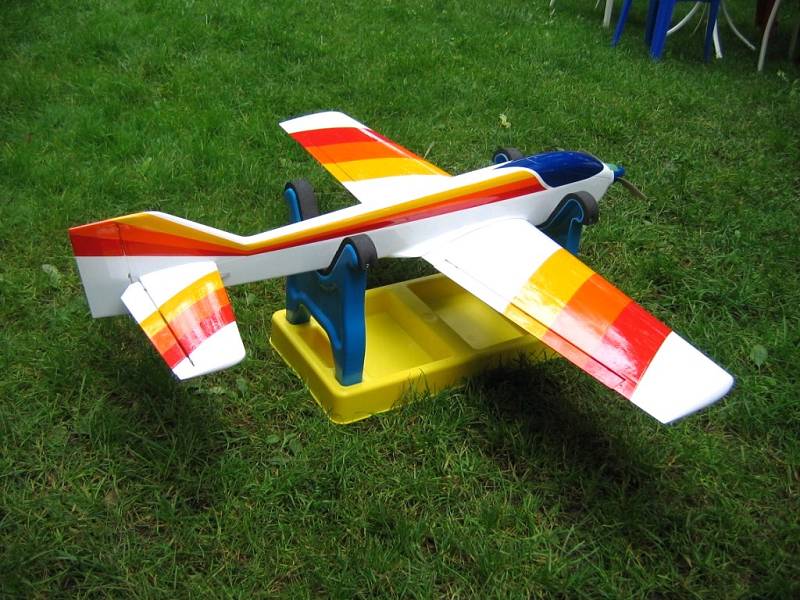

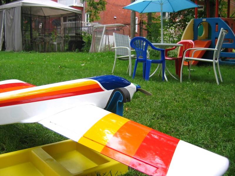

In other news, on the occasion of my daughters 4th birthday, I managed to complete the finish!
Well, aaaaalmost - some minor details. Although the paint job turned out to my satisfaction, a little striping tape will help to seal the edges and take care of other minor cosmetics. I also feel that I need to seal the colour with a clear coat. The only problem is that metallic paint tends to loose it's sparkle when covered with clear. Any suggestions?
I guess it's time to take care of the cosmetics and move on to the radio re-install. The two aileron servos are on their way - should be here some time next week along with the batteries. I also am on the bridge about whether to use classic pattern control horns on elevators (4-40 bolt with an eyelet not visible from above) or use standard 1/2A nylon control horns. The rudder uses a 4-40 bolt with eyelets and the aileron linkage is concealed (torque rods). Decisions... I think I'm going to have to install those elevator bolts and eyelets...
Enjoy the pics!
David.
P.S. Don't understand why the mustard yellow colour persists in outdoor shots. Must be an issue with the white balance in the auto mode of the camera. It is also overcast.

She looks awesome! I bet she flies as good as she looks. I'm currently building the little Brushfire. I'll post some pics in the appropriate thread when I get alittle further along.
Nice job!

Thanks Chuck! I saw that canopy blue out of the corner of my eye at the LHS and said - that's it!

I'm also glad to see that the finishing scheme evokes the same sort of reaction I had when I first got a peek at GP's 1982 catalog. I had my kit, I had a 1x2 tiny picture of what she was supposed to look like in colour and then I thought: one day I'll build a Tipo to look like that!
That was 27 years ago. I was 15 and had no idea how to build a pattern plane. Before first frost, I hope to have one of two Big Daddy Tipo's finished in an albeit different scheme. The second one will be done all in paint in this scheme.
I'm heading to put a pushrod together.
David.
P.S. Somehow, I now wish there was a retracted landing gear underneath her... good excuse to eventually build another... right Andy? [8D]
P.S.2. The mustard yellow must be an optical illusion (beside the orange and red). Even in this snap it appears darker than it is!

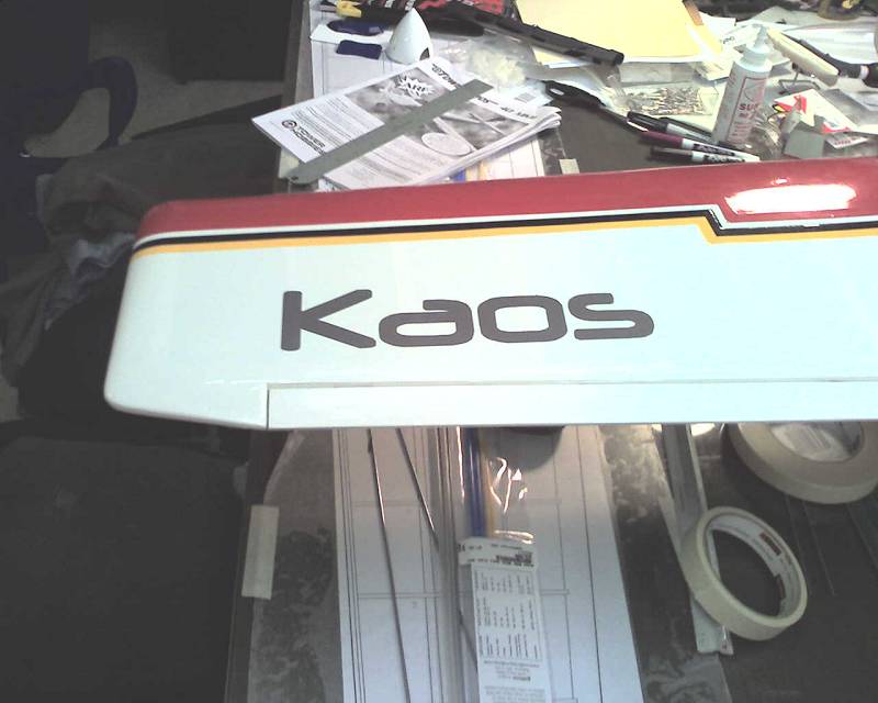

Not sure if you have done the lettering yet for the model. I really enjoyed making the stencils for my Kaos and cutting each letter by hand. Be it a mask stencil or actual letters out of ultracoat, the final product is always a great reward for the work involved.
Good luck!

thanks for your post. Haven't gotten around to the lettering yet. Actually your Kaos thread brought me a little closer to the idea of cutting them out from black trim sheet. I think I'll do just that as I'd rather not have paint in the rear part of the fuse where it's held. It will also, as you've shown, look nicer than printing on to clear vinyl which leaves an unsightly edge.
Any suggestions for making the stencil? I was just going to cut out the printed lettering, spray glue it on to the back of the trim sheet and cut. The tricky part will be kerning the letters on to the fuse. I guess a little care should take care of it.

You are are the right track for the lettering. I picked the font, sized and printed them out, and then taped the whole paper to the front side of a section of ultracoat, and then the whole assembly was taped to my glass topped work bench. I like cutting on glass for this type of work. When cutting, change the no 11 blade after each letter. Use a straight edge as often as possible and I like a full set of ships curves for the portions with curves. Take your time, and you will be amazed what nice looking letters you can pump out with a bit of patience.
With your painted scheme, you might want to consider cutting out a stencil from shelf paper. I prefer the solid tan color shelf paper made by rubbermaid. Shelf paper makes a great mask that will not bleed any of the color once applied. Cut your letters on a square of shelf paper just the same as I described above. Then carefully peal the backing and apply to the fuse like a large sheet of masking tape. The nice thing about paint is you can spray multiple colors or even patterns when applying the paint. I remember one guy in stunt used a small peice of lace to dust on a gold over the top of the black for a really neat effect in the sun!
Good luck with her, David. You have done a really fantastic job on the model! I love the authentic paint scheme tied to the original. Can't wait to hear how she flies!
