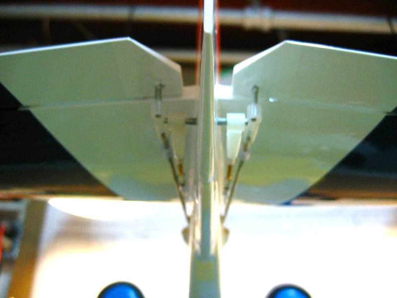

After pottering around for a couple of evenings, I finally got the tail linkages sorted out.

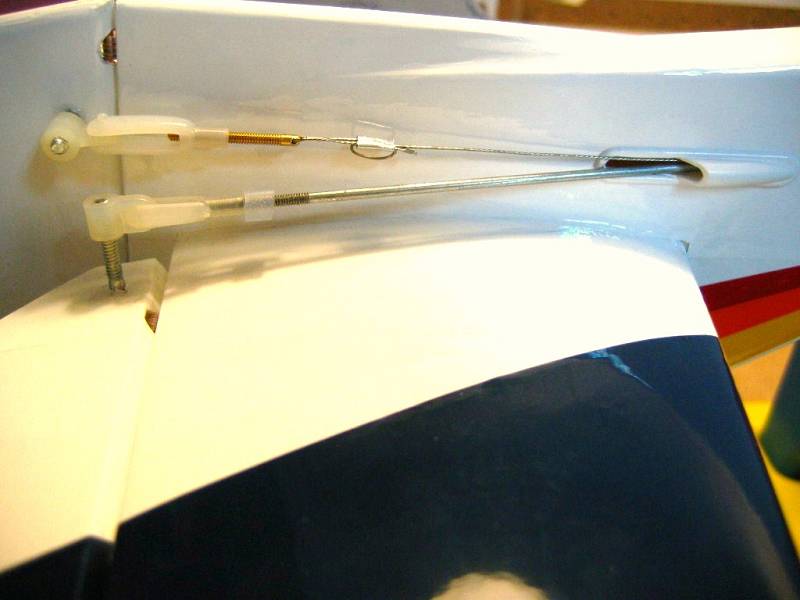

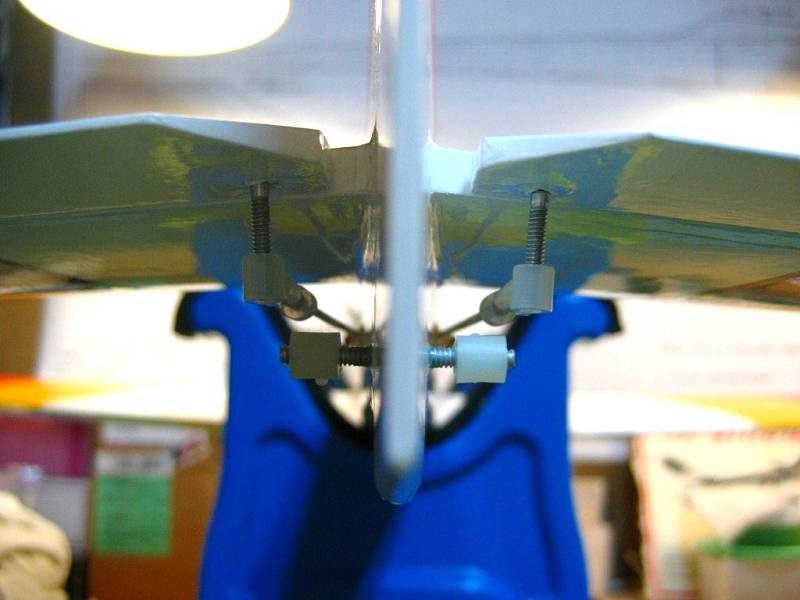

I went ahead and worked in some 4-40 bolts into the elevators that I installed into small hardwood cylinders. I then epoxied these into the elevators flush with the top and re-covered. I found it helpful to drill the cylinders for the bolt diameter and then open up the hole to the depth of the bolt head to recess the head into the block. The rudder was done in a similar fashion by threading a 1-1/4" bolt through the block in the rudder and then cutting off the bolt head once it was even on both sides. These control horns, although a tad heavier, are very effective and make for a clean surface.
I made my forked elevator pushrod from the standard arrow shaft and 2-56 threaded rods. Unfortunately, the 9" shaft lengthened to 17-1/2" by the 2 rods on the elevator end and the single rod at the servo end came in weighing 20g or 0.7 oz. This is rather heavy (the equivalent of 2 servos) for a model of this size and I'd like to find a 10g alternative to also remove weight from the tail which is now needed. The rudder was setup with light P-P wires, 2-56 rigging couplers and nylon clevises at both ends. I also ended up using nylon clevises on the elevators as ball links were not needed. The linearity of the pushrod is good and it is sufficient to put a ball link at the servo end to prevent adverse torque on the servo. Both the elevator and rudder linkages exit the fuse from the same opening covered by pushrod exit guides (painted to match the white MK).
I received the new 25C lipo's which come with nice 3.5mm EC3 bullet connectors. Unfortunately, my other electric stuff is all rigged with Deans so I'll have to change them. This wouldn't normally be an issue however, it appears that my three soldering devices have all packed it in! Time to pick up something robust that can also weld soldering clevises and threaded couplers. The aileron linkages are basically done except for two soldering clevises which need to be attached to the control rods. These will be used at the torque rod end with ball links on the servos.
Few things left to do! Some soldering work, glue in the hinges and a little tidy up work on the canopy. I obtained some magnets and will probably use one for the canopy as the screw tends to lift up the paint. I'll also need add some clear to the paint to protect it. Final cosmetics can probably wait until after the maiden.
I'll take some pictures of the radio compartment and interior next time.

With the heavy elevator pushrod and the new 7 oz 25C lipos the finished AUW of the model is 30 oz. With the 15C TP Prolites I can drop this by 1.5 oz to 28.5 oz. The wing loadings are in the range of 16 and 15 oz/sq ft, respectively. This is perhaps an ounce or two heavier than I had hoped for but still well within my goal of under 2 lbs max.
I will probably use the heavier 25C cells as the model balances nicely with the rear of the battery flush with the FW - that is, all the way forward. I suppose this was to be expected considering the heavy linkages and fully airfoiled tail surfaces and solid stab.
It would be nice to find a forked 10g elevator pushrod alternative to my heavy FG/steel assembly.
David.

Rafa,
I'm sure the CF pushrods would cut the weight down to 10g or less, the only issue is that building a forked CF rod is tricky; at least no easy way comes to mind. I suppose I could set things up with the more common DEPS approach. I'll have to loook into that.
The lipo's are indeed 25C 2350's and yes, I do have some 1350's which shave off 3 oz from the 2350's. That would make for a 27 oz flying model assuming I can get the model to balance with them after replacing the heavier pushrod - most of that weight, 0.6 oz, is in the rear of the model where the steel rods exit the fuse. 1350 size packs would make for pretty short flights though I expect.
I'll have to look into all options.

Yeap flying time would be around 7 to 8 minutes maximum.
Even using a main CF push rod and rest of fork made convencional you could save some weight, sure you'll come up with some ideas.

Rafa,
Not crazy about the 1350 packs on 300W (28A) but we'll see.
The main section is 9". Switching to CF wouldn't help that much as the FG is not much heavier. It's the steel rods that need to be replaced. Question is, how to get them to rotate out of the fuse and join into a single rod for connection to the servo.
Any ideas? I'm starting to have a few.

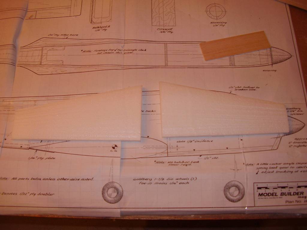

Brian Courtice will be building public Pico #3! Cores and possibly a short kit is being arranged for him probably by Don of Eureka Aircraft (or myself if necessary).
Congratulations on choosing a fine aircraft and concept
. The only requirement when building a Pico is to do a build thread, preferably in the CP forum!
Happy building!
David.

hey david i started my own picorare. Got two 350 watt motors coming so i figures why not. Got the stab cores cut and that was a steep learning curve. Burned up alot of foam getting them right but now that i know what i'm doing got them cut and started to sheet them. Just thought you might like to know. Phil

nope no wings yet burned up alot of foam learning how to cut and get my speed down but finnally got it and while not perfect they will work. Anyways i have a few pics of the stab so far. It is sheeted assembled and all that is left is to joined. Have fuse sides cut and plan on maybe cutting the wings this weekend. I have to maiden the vortex but if that goes well i hope to get the wing cut this weekend. I plan on doing retracts in this one to. Any suggestions for the nose gear. I will be using the same mains i used in the vortex the gp .10's any ways rambled on long enough. Here are the pic's more later. Phil

hi david. I will keep you posted on progress. Everything that you suggested is what i was thinkin anyways. So i'm gonna proceed with taht. Thanks for the lead's on the retracts thee-filtes look a little pricey and the hobby king ones i don't know about but for 12 bucks i just might have to try them. I actually made the plane a little bigger overall and scaled the .60 down to 67% so that is the size i'm building at. Everything measures out to conventiaal dimensions 13/4 whels 1 1/2 spinner etc. So i think that may help the wing loading just a shade. We'll see but with the way the vortex turned out i'm pretty sure i can this one light enough too. Anyways more tommorrow just got the stab halves joined and waitin for them to dry. Phil
