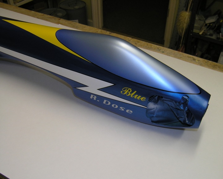

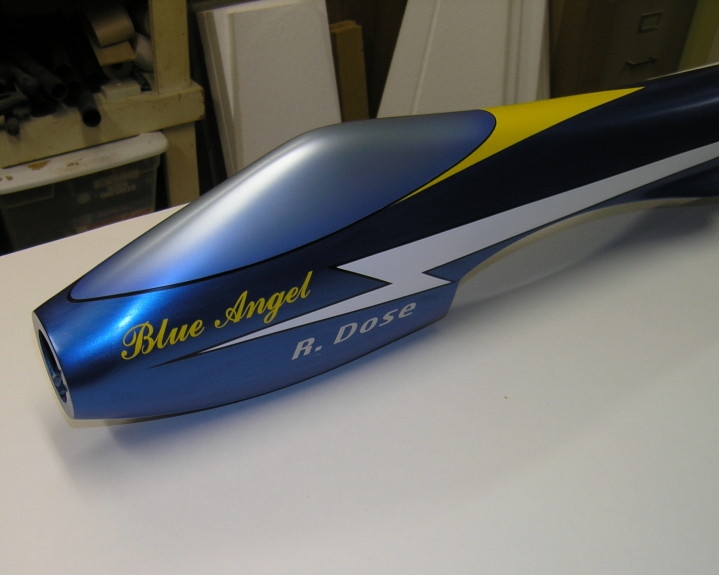

Classic Fundamentals...Dave Guerin building Blue Angel!
Thank you for all of the nice comments!
The Wega/Sunshine Blue Angel is getting closer based on the work of Dave Guerin.
Ready for the clear- Mr. Guerin is a very fine painter, minimal material, excellent coverage, symmetry, schemes "fit" the airplanes well and have been very durable which verifies his preparation. It is important to remember that these things are supposed to fly and are not "hangar queens". I will ask Dave the order the colors were layed down...my favorite detail are his shaded canopies and the 3/32" pin stripe is just awesome.
Graphics- BadBrad has come through again with the our request for changes. The partial "7" has been saved and be added to the Monokoted. As a long time Chip Hyde fan, I have added my name...BIG...like he first did on his Dr. Jeckyll.

Are wings, stabs and rudder going to be covered?
If so, what MK colours is the paint matched to?
David.

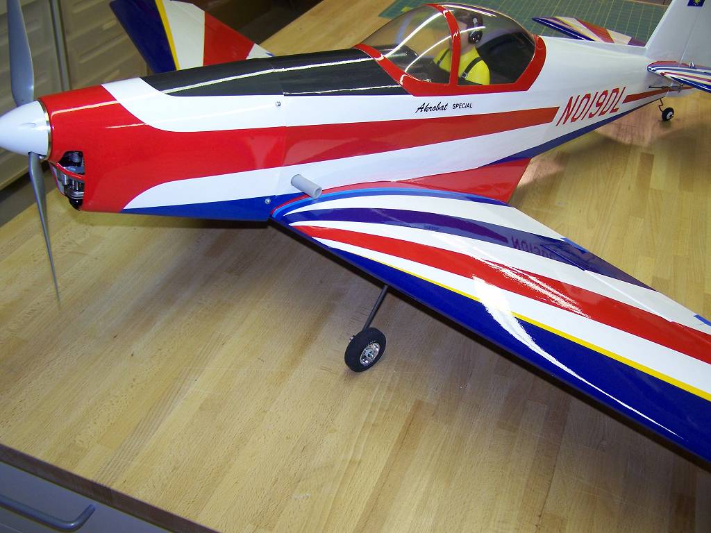

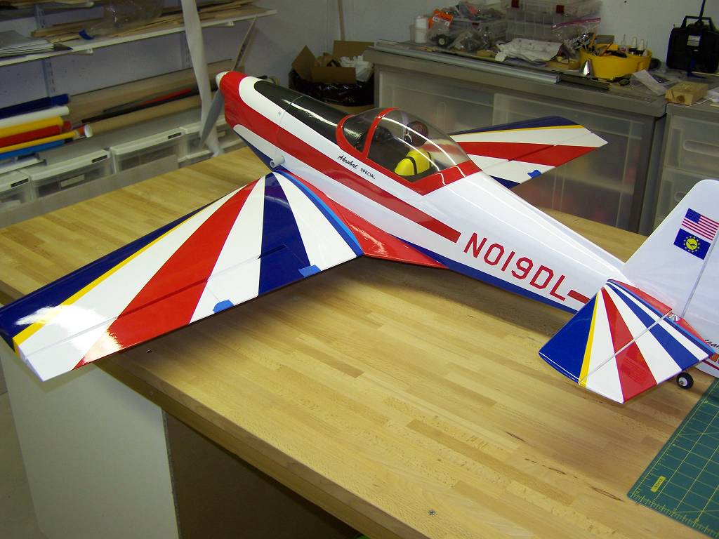

Classic Fundamentals...Blue Angel Monokoting!
The Wega/Sunshine Blue Angel project by Dave Guerin.
The photos show the various stages of Monokoting. The design is drawn on the surface to be covered. Colors are applied using (2) Monokote irons, one with a sock one without. The material is pressed directly to the wood, Dave's stuff has proven to not bubble, look great for years and years. A heat gun is used for tips by heating and stretching over surface.
The colors (metallic blue, creme and red) for this model do not overlap. The black pin striping is cut with a long straight edge and a #11 blade in xacto handle. The clear has been applied.

Classic Fundamentals...Monokoting the Dan DeLuca way!
Using lots of little pieces to cover in Monokote? Dan DeLuca, the original "Mr. Monokote" (Fay Stilley, bad spelling, is the current Mr. Monokote) used lots of teeny, tiny pieces, strips, slivers of Monokote to cover a model.
The Blue Angel center section? Dave will cut a metallic blue piece with about a 1/8" overlap. I expect the final photos for the Blue Angel sometime today...

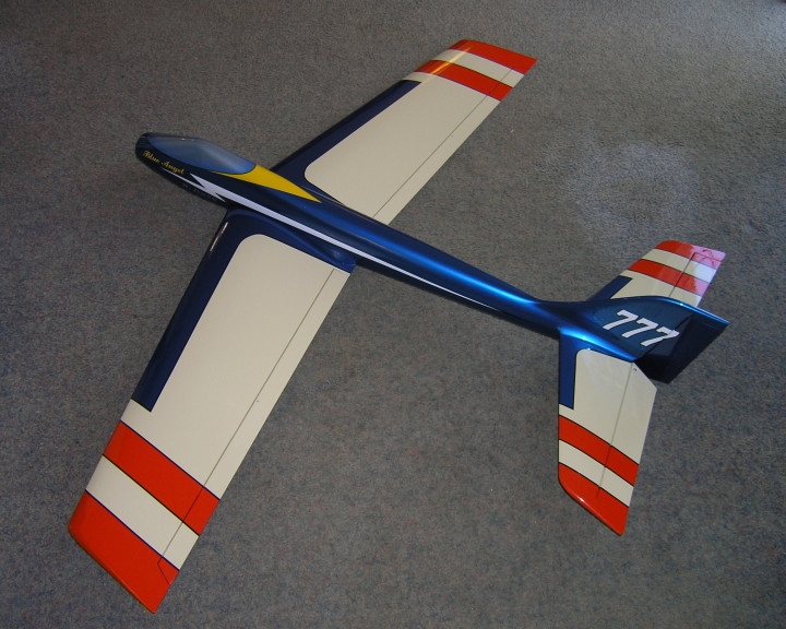

Classic Fundamentals...a tutorial...Blue Angel...completed!
The Wega/Sunshine Blue Angel, built by Dave Guerin is now complete...I am absolutely thrilled!
Finish:
Fuselage- PPG base coat with a catalized urethane clear.
Wing/stab/rudder- Metallic blue, true red, cub yellow, black, cream and Monokote.
Graphics- BadBrad custom graphics.
I will add my AMA number to the left wing and "Yoshioka" per the original on the right wing.
Rusty Dose
Team Futaba
