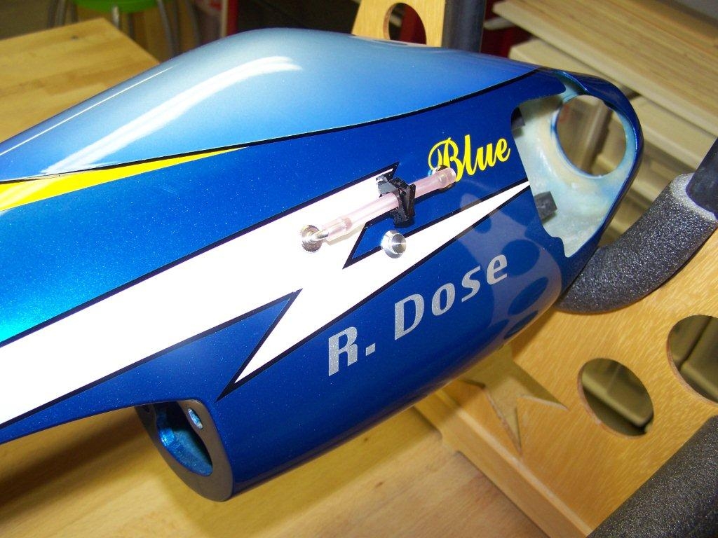

Cowl- The Model Master plastic model paint dryed over night. The cowl was mounted to the fuse to layout the lines. A cardboard circle was used for the top front radius using a soft lead pencil. 3m green 1/8" trim tape was used for the edge followed by 1/4" and the rest was blue painters tape. 3m brown scotch brite pad was gently used to remove the shine of the tan and white base coats.
Insignia Blue Monokote paint was warmed and shaken for about (5) minutes. I walked out the back door and sprayed (3) coats in the 34 degree temperature going in the house for about (6) minutes in between coats. The paint really flows in the lower temperatures.
After about 30 minutes the tape mask and outline were removed and the part set aside to dry for a few days before I drop it off at my painters for the PPG clear urethane. The graphics will be added before the clear.

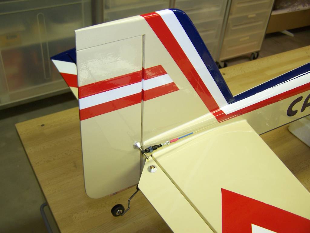

Rudder cables- The Futaba 9151 digital servo has about 180 inch/oz of torque. Keeping the cables tight...
1. Measure the distance between the center-line of the rudder and the control horn. Calypso was about 1/8" BEHIND CENTERLINE.
2. Using a large wheel, mark a line 1/8" towards the REAR of the wheel. Drill holes for (2) 2.5mm dual axis rod ends (Central Hobbies) and install by adding (1) extra 2-56 washer to raise the ball off of the servo wheel.
3. Add a 2-56 nut to a 2-56 threaded eyelet to the dual axis rod end.
4. Thread the braided cable from the rear of the model, crossing and attach with stainless steel crimp (Proctor Enterprises) loop the cable through (2x) for security...crimp with diagonal cutters (3x).
5. Install fin, hinge rudder and add rudder horn. Tetra rudder horn from Central Hobbies shown.
6. Add small heat shrink (blue), larger heat shrink (red), crimp and Hayes clevis with 2-56 eyelet with 2-56 nut. Do not forget to add the large fuel tubing.
7. The rudder horn is attachment points are the same distance apart as the servo wheel...completeing the symmetrical geometry for tight rudder cables through out movement.
Tail wheel- 4-40 bolt was cut-off and medium silicone fuel tubing was forced onto bolt and secured to rudder with servo screw (Central Hobbies). The steering is positive yet is forgiving if the tail wheel is hit hard.

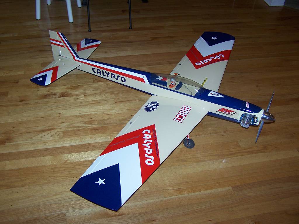

Classic Fundamentals...Calypso COMPLETE!!!
1983 WC Calypso Replica-
Modeltech Kit from RCU Classic Pattern participant $250 plus shipping
Super Tigre S-61 from Buy-Bay about $150 plus shipping
Mac's header and 10cc pipe about $100
Miscellaneous parts $150
Covering and Paint $60
BadBrad custom Graphics $140
Futaba receiver, battery, switch, servos about $400
Total $1,250 ready to fly
Specifications
Wingspan- 64"
Wing area- 730 sq inc
Weight- 6 pounds 13 ounces w/o fuel ready to fly
Fly this model at the Chicago Classic Pattern Championships May 29, 2010 at the Fox Valley Aero Club.

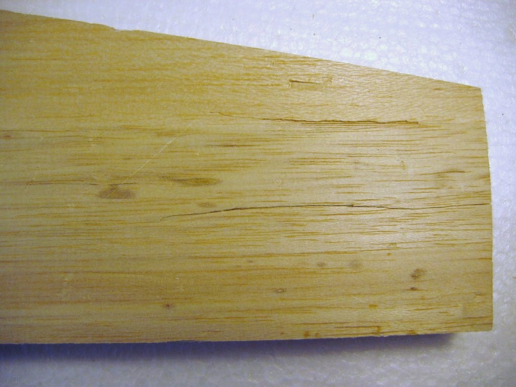

I received my World Engines Calypso kit. While I wouldn't describe the kit as stellar in original quality or current state, it should be salvageable with some restorative work. Sheeting on the wings is 3 mm so somewhat thick by today's standards. Fortunately the foam is 3/4 lb. I've yet to weigh them but a good sanding should bring them into shape. The stabs look like they were chewed on by a big dog [:-] - plenty of "tooth marks" and the sheeting is cracked in a few spots (see photos). Again, some TLC should make them usable.
The fuse fortunately remains to be built and although some of the wood has seen better days (more dog chomping), the dents should disappear in the build. At least the kit makes for a good set of templates for a fresh kit which I'll make for posterity. On to a few questions:
[ul][*] The cowl is rather thin and cracked in several places. How would you go about restoring it? Should I lay more glass atop in thin layers and then resin the inside again? Maybe some CF on the inside? How best to lay it in? I'm not sure but I think this is a PU/glass cowl judging from the colour (haven't done the scratch test).

carbon fiber veil or mat will fix the cowl with minimum weight, i have both the .5 qnd the .2 oz per square yard material makes a huge improvement in strength and rigidity and its easy to use.

would you suggest using the veil on the inside? just lay it in 3 or 4 pieces on each surface? I have to get me some of this composite stuff.
I think I'll have to do a couple of layers of 3/4 oz glass cloth on the outside too in order to seal and fix the cracks. Hopefully it will give it some shape too. I'd say the cowl is made of a single layer of 2 oz cloth! The pipe tunnel glass sheet simply curled up into a straw
. Granted, the kit must be 20-25 years old.
I tell you, every time I open a kit, I'm a little taken aback by the quality of materials. The QC is so much better when one scratches. On the plus side, the canopy looks rock solid and is nicely tinted.

David- The Calypso variations are quite interesting. I am waiting for Dave G. to send me photos of his completed Calypso from the World Engines "Sport" version. "Master Foamy" has created a 30" Dalotel indoor model completely out of foam! I am going to pick it up in Toledo. Based on your plans with the 10% puffed-up fuselage should come in around 10 - 12 ounces RTF. How are the laser parts coming for the Dalotel "E" 30? I have the wings/stabs ready to ship.
Learning to use dope and tissue...Nothing is more beautiful than a well done control line stunt model executed in silk and dope. I will be completing a few late 60's antique pattern models in the Fall and want to acquire the skills to use tissue, silk and dope as a finish. My little boys also love to fly free-flight models and are helping Dad build and fly our ever growing collection.
Practice makes for more perfect- The photos show a much needed distraction to the many projects...a Guillow's Arrow. The model was completed over a few evenings last week on the kitchen table. Covering is tissue from the original kit and new japanese tissue from Sig Manufacturing. This was a proof of concept to use the new radio system that comes with the Great Planes Playmate, a 1 ounce RTF indoor/outdoor model. I will be creating some minature 60's pattern classics for indoor use.

Tipo 750 (Tiporare 750)...originally built by Dick Hanson/finish by Dave Guerin
The Tipo 750 shown here was recently acquired on "Buy-Bay" for about $800. What makes it particularly special is the fact that it was built by Dick Hanson the designer in the early 80s for an Ohio pattern flier. All aspects of the model were perfectly retained and original from Dick's notes written on each of the parts, the hand written directions and the custom shipping boxes.
The model was 90% complete just requiring stab/fin/rudder installation, final retract and engine cut-outs and radio installation. The quality of craftsmanship is some of the best I have seen and I have models built by all of the top US builders. The balsa selection is truly amazing with feather light components.
Dave Guerin was given the responsibility of assembling the parts and the paint/film finish. Dave tells me that it was a real "treat" to work on this project. Dave will use his PPG base coat/clear urethane paint for the fuselage and Monokote for the flying surfaces. I chose the Dave Brown classic color scheme using orange, mist blue and dark blue pin striping.
Equipment:
YS .60 side exhaust short stroke with Hatori header/pipe
Dave Brown (3) gear mechanical retracts
Futaba electronics
The photos show the fuselage just out of the paint shop. It will be on display at the Chicago Classic Pattern Championships.

Blue Angel rigging- Dave Guerin built/painted/film appliation and I do the equipment installation.
Challenges- The Blue Angel has very little room for placing all of the goodies, a CG mounted fuel tank, YS pressurized fuel system fittings, mechanical tri-gear retracts with (2) servos...
CG mounted tank- The Sullivan 12 ounce round tank is captured in the front with a custom bulkhead made of 1/8" lite-ply and the rear "saddle" is made of 1/8" light ply with 1/4" plywwod ears added to capture the small brass eyelets for the #64 rubber bands. The saddle has large silicon fuel tubing with a slit for the tank to ride. The formers were made using the blue flexible ruler shown on page #1 of this thread, transferred to poster board and then transferred after fiddling to the plywood. The pieces are CAd in place then BVM Aeropoxy is added for final bonding.
Battery mount- The 600 mah Futaba 4 cell ni-cad pack is mounted to a 1/8" lite-ply floor with 1/2" natural foam rubber and a red velcro strap.
Receiver mount- The Futaba 6117 2.4 receiver is mounted to a 1/" lite-ply plate with a small triangle reinforcement and atached with velcro. The antennae tubes are plastic throttle tube CAd in place creating the 90 degree/perpendicular array per the directions.
Servo tray- The servo tray holds the Futaba rudder, elevator servos with a little cantilevered support added to the throttle servo and receiver mount. Note that a 1/4" natural foam ruber pad is placed under the receiver/servos to avoid wire chaffing on the very coarse glass fuselage.
Switch mount- A 1/2" lite-ply donut supports the DuBro switch mount and the Ernst charge jack is simply mounted directly to the fuse side.
Fuel connections- A 1/8" lite-ply support was made for the Tettra 90 degree fuel fitting s and fuel dot. A helicopter part from an unknown Japanese supplier is the fuel shut off. A "T" will be added to the vent line. Note the photo of the YS engine with the nylon wire holder and the YS one way pressure valve. I simply use the rear engine bolt to hold the nylon bracket which keeps the valve from bouncing around.
Elevator pushrod- The pushrod is a Central Hobbies carbon shaft with 3 mm dual axis end/ 3 mm titanium threaded rod end and is captured in the rear with a brass tube in the tail post. Central Hobbies control horns shortend about 12 mm and cupped aluminum washers (Horizon R/C car accessory aluminum) replace the washers supplied with the horns.
