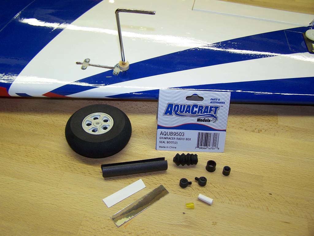

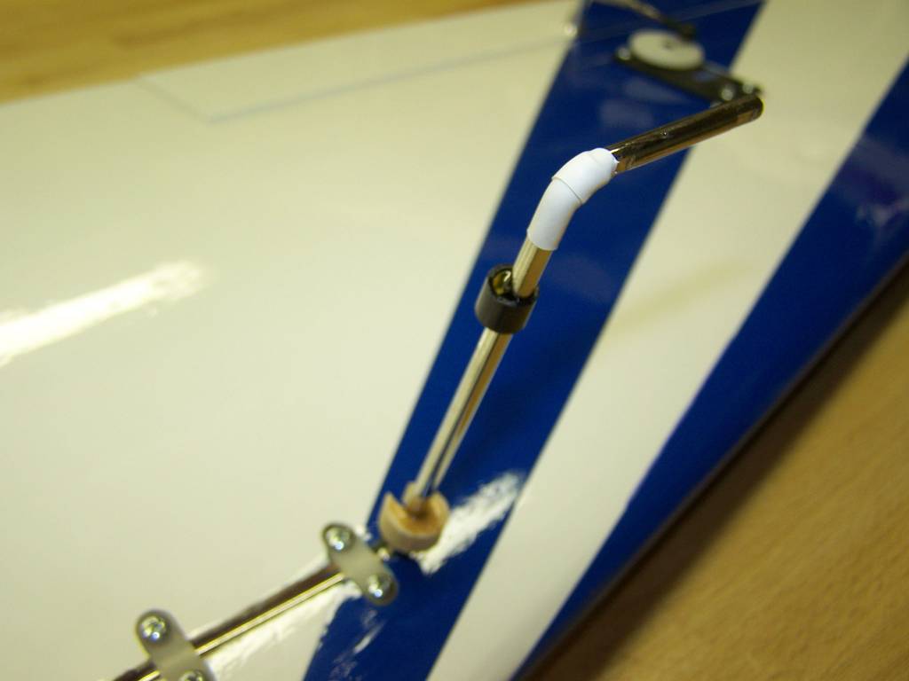

Wing re-trofit- The aileron servos in many ARFs are designed to be laid on there side, mounted to a plate and secrewed to a plate. This method works fine, I can't use my favorite aileron servos and linkage so I do this:
Photo 1- Shows the Futaba 9154 low profile digital aileron servo, Central Hobbies dual axis rod end, Central Hobbies control horn set (new) and the SWB titanium pushrods with alternating threads for easy adjustment.
Photo 2-4 The plywood plate is removed, hardwood stock removed from corners of box and servo hole cutout for new servo. Note that the plate was glued to the wing with thick CA and the Monokote was removed from the bottom and edges for a better bond.
Photo 5,6 The control horns are carefully measured for center (the same for both ailerons) and drill press is used with the wing top face down. The drill press table has a 12" x 24" x 1" board clamped for greater accuracy.
Photo 7,8 Control horn, ball bearing end, pushrod, dual axis rod end and servo installed and adjusted. Very smooth, very precise and reliable for hundreds and hundreds of flights. Note that I shortend the aluminum portion of the control horn to increase the "throw".

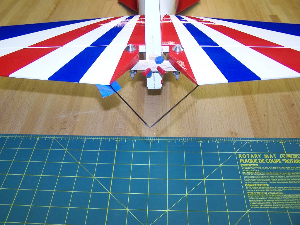

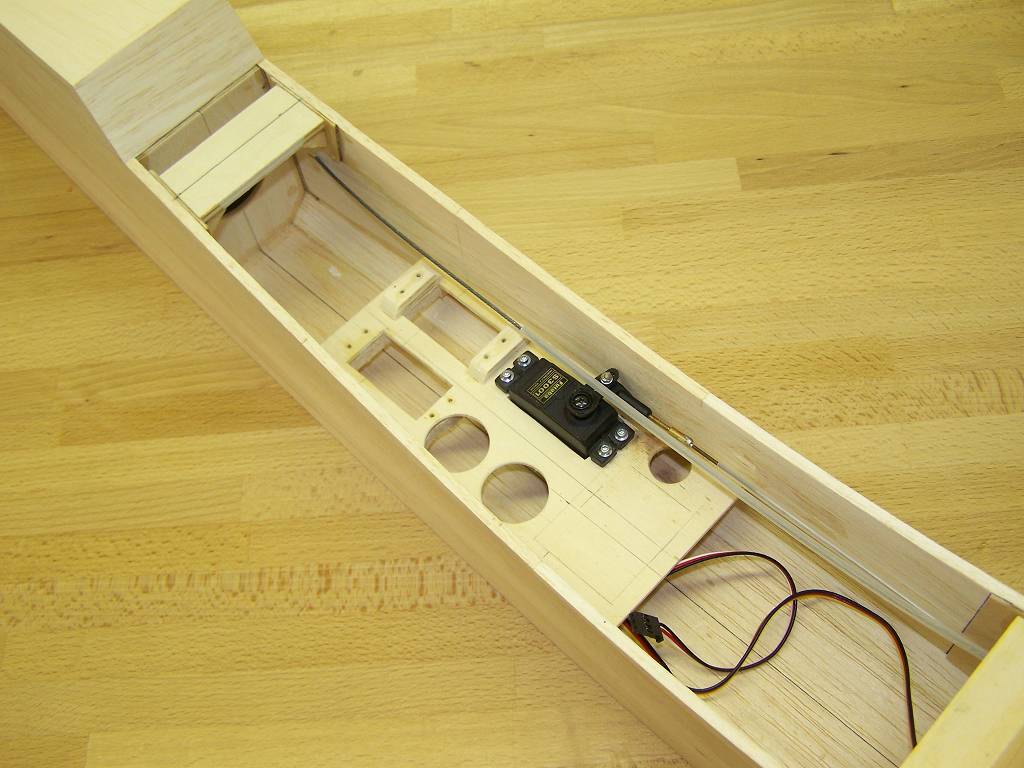

Split Elevator set-up- Classic pattern airplanes typically had one elevator pushrod connected to one elevator half and a "u" shaped wire connecting the (2) elevator halves.

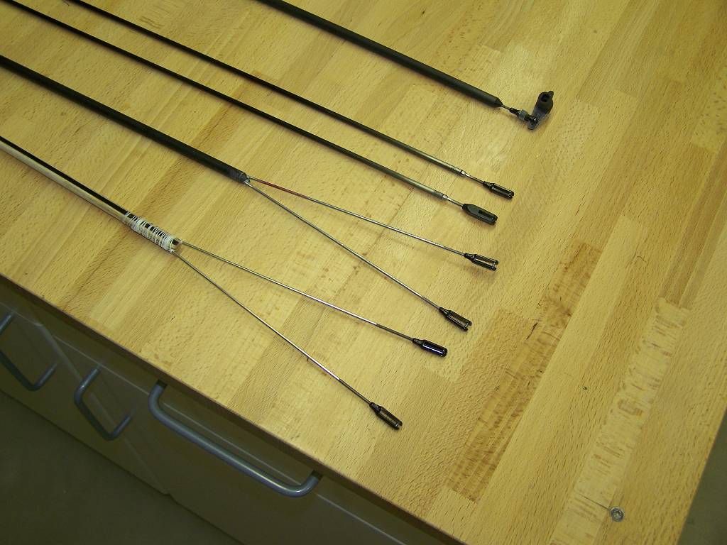

Most current ARFs use (2) wire pushrods guided by independent plastic tubes pre-installed in the fuselage. The wire works fine, is reasonably simple to install and align. My method saves at least (2) ounces (!!!), allows the use of titanium ends which save more precious grams and allows for VERY simple and accurate installation.

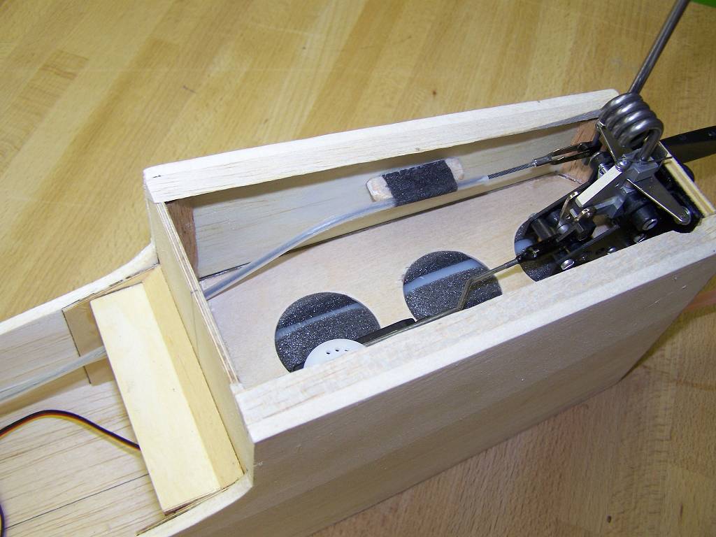

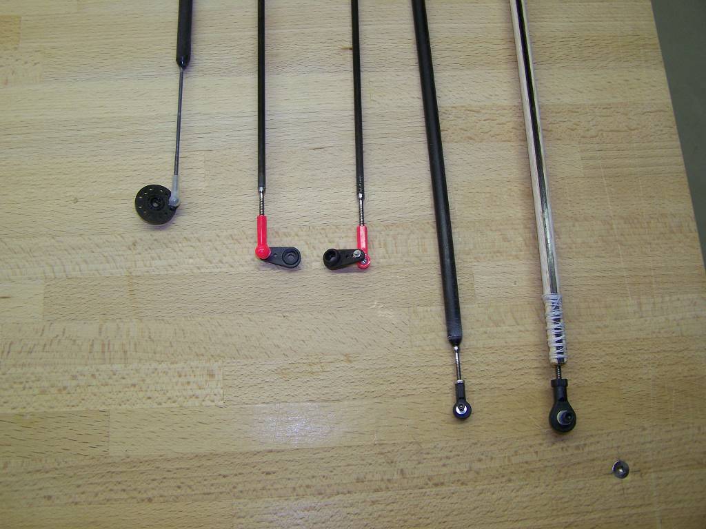

Dual Elevator retrofit- I use .060 or .070 carbon fiber rod from Midwest (#5800 for the .060 or 1.5mm carbon rod, weighs .081 grams per inch) and Central Hobbies pushrod ends, 3mm dual axis rod end for servo, Kraft-Hayes 4-40 nylon clevis with steel pin for rudder and the Central Hobbies new control horn.
Photo 3,4- The radio compartment shows the Futaba 9151 digital servo for the rudder (left side of model) and Futaba 3151 digital servo for the elevator. The rudder uses the Central Hobbies 3mm dual axis rod end threaded to a 3mm titanium fitting with a .070 hole for the carbon rod. The fitting is glued with JB Weld. The elevator .060 carbon rods are first glued (JB Weld) into a larger carbon tube (slotted to accept the angle of rods) with titanium fitting/3mm threaded end for 3mm dual axis rod end. Once this is dry (over night) I remove the assembly and wrap with 1/2a control line thread and coat the hole thing with a film of JB Weld to absolutely make the hole thing solid.
Photo 1,2- Alignment is absolutely critical!!! I attach sharpened carbon rods to the elevator halves (make sure the elevators are hinged and glued in the CENTER) with painters tape, aligning them as shown in the photos. Note I do not install the rudder until this is completed.
Photo 5,6- The titanium rod ends have been prepared by measuring and test fitting. The control horns were installed exactly like the ailerons (see previous post) BEFORE the elevators were glued in place. JB Weld is applied to the carbon rod, inside the titanium rod end with a pin and pushed in and out. Use a couple pieces of wood pinned to the rudder post to keep the stuff aligned and let cure overnight.
Photo 7+ The rudder end is handled the same except the carbon rod is exposed a little more...I add a telescoping tube for strength and speed alignment of the 4-40 titanium fitting/steel pin clevis.
The other photos show the completed model with wing #1 (stock version), YS 63 with Hatori header/muffler enclosed in cowl with exhause exiting out of the fuselage!
Wing #2 has independent aileron/flap (scale dimensions-larger than kit) modified landing gear with aluminum wheel, no wing tube and lots of lightening holes. The full scale airplane had interesting deflection angles of the aileron/flap...I am going to have 2-5 conditions for outside ailerons only and variable flap angle, aileron/flap coupled, outside ailerons with coupled elevator flaps and "crow" which will raise the ailerons and lower the flaps for super slow down-lines? I am just about done with this and will post as completed and discuss results of flight testing. The testing is a to sample the Hanno/Matt airbrake set-ups.
Finally, the "faux" landing gear detail was made with silver craft pen (hub) from Michael's for the wheels, holes were drilled in the hub, wheel collars covered with black heat shrink, white heat shrink for bottom of wire, a waterproof pushrod exit for a R/C boat for the shock absorber, bits of gasoline fuel tubing/carbon tube/dowel are the hard-points, white cover is paper tube for servo wires covered in white/silver trim monoKote...it made the ugly wires look better!

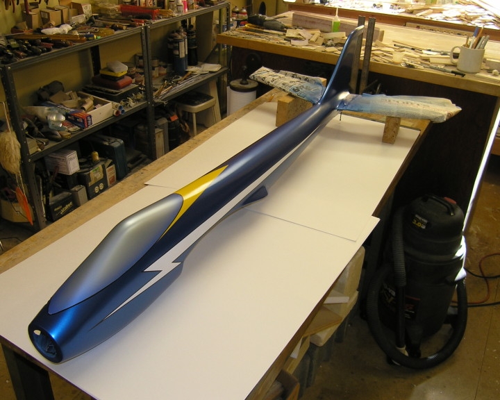

Classic Fundamentals...Professional builder Dave Guerin builds Blue Angel!
Blue Angel by Wega/Sunshine of Germany build by Dave Guerin
Ready to paint!
Overview- The photos show the airplane just about ready to paint. The last construction detail is to add material to the wing tips to match the MAN 3-view drawing from the Yoshioka 1973 World Champion story. One of the realities/challenges of the "reproduction" kits is their accuracy. The Wega/Sunshine had the following "inaccuracies" :
- Type of ailerons...barn door in kit, strip ailerons on original.
- Wing tip blocks...incorrect angle.
- Fin trailing edge...rounded not square
The painting/covering process will begin today. The exact color scheme, based on available photos is pretty tricky. The photo below shows a metalic blue, red, creme wing/stab with yellow swoosh and white lightening bolt. Monokote will be used for the wing/stab/rudder with PPG base coat/clear products. Dave is amazingly speedy and will probably have the project completed the middle of next week.
Hanno/Yoshioka conicidence? Hanno Prettner was very deliberate with his color schemes and combinations, typically integrating the colors of the FAI world Championship host countries flag into his models. Yoshioka's 1973 model used metalic blue, red, white and creme with yellow and white swooshes. Hanno's 1983 world championship "Calypso" used metalic blue, red, creme with white highlights for the event hosted in the USA. I belive that the 10-year time span, the similar colors and placement may be more than a coincidence?

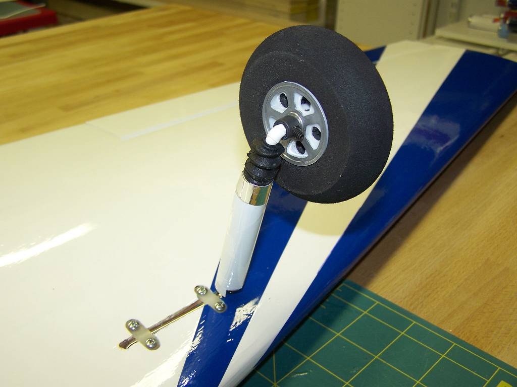

Post 37...what model?
The photos are of the Ace High Glider, Modeltech Calypso (the pipe tunnel), Dirty Birdy 60 and SIg Komet.
The wing construction for the Calypso has a 1/4" wing joiner at about the CG extending 6-7" on each side. You really HAVE to add something if one is going to take away this much material...trust me!

Landing Gear leg installation. Bolt on landing gear try to tear/twist apart during a rough landing...this method connects the (2) gear legs with a plate. I am going to use a 1/16" aircraft plywood plate covered with a heavey carbon fiber cloth using epoxy. The plate will be made, holes drilled and then cover the plate with the cloth. See first the first post of this build for the themes I am trying to execute.
You will notice a funky drill bit and some little plywood donuts, aluminum washers and some very heavy 6-32 socket screws. The aluminum washers are "extas" from the MK control horns used for the rudder and elevator horns which are drilled out with a #27 drill for the 6-32 socket screws. Micro fasteners no longer stocks the 6-32 x 1" aluminum...
The funky drill bit is a "plug" cutting drill bit. ($14.95 at any fully stocked hardware store, not Home Depot.) The donuts will hold the 6-32 blind nuts to provide additional support for the nuts.
I made the plate from 1/16 aircraft plywood, cut to size and the holes drilled for the bolts. Carbon fiber cloth is then bonded to one side using 30 minute ZAP epoxy then turned face down on a piece of wax paper. The other side is coated with ZAP laminating epoxy and another sheet of wax paper is placed on the plate. A weight is added to the top of the plate until cured.
The completed plate has a very smooth finish and is now very strong. The plate is trimmed, the edges sanded and ZAP laminating epoxy is brushed on the edges for installation.

Symmetry- Try to make each surface left-right should be identical. I like to complete one half of the wing then transfer the measurements to the other side. When I was kid, I was a terrible measurer, never really learned "how" to use reference marks, sharp pencils and patience...nothing may be more important than a little patience.
I chose a 25 degree angle for the flap and ailerons. I expect to use 20 - 22 max, leaving a couple of degrees of deflection available. The dowels have been drilled to accept the 6-32 stainless steel screw.
The wing panels have been glued together using 30 minute epoxy applied to the 3/16" remaining edge of the plywood root ribs and the 1/8" light plywood/carbon reinforced spar brace. The spar brace fits snugly in the epoxy wing tube and may be strong enough without the 3" glass cloth to be added.
The 3" nylon cloth (Sonic Tronics) is applied after drawing lines on the top and bottom of the wings. The joint has been carefully sanded, the halves have been test fit PRIOR to gluing them together. Adhesive is applied to each wing half, spar brace and the whole assembly after it is squished together. The excess glue was wiped away with a paper towel then 2" wide painters tape is added to the leading edge and trailing edge, checking for the halves pushed tightly together and the alignment of the halves.
After the wing was dry, a series of (3) 2" holes were bored 1" apart on the bottom trailing edge of the wing with a 2" forstner bit and drill press. The drill press "stop" was adjusted to not drill too deeply and the wing was held by hand. Other then the huge mess, the holes turned out very smooth with no additional sanding required. The weight savings was (20) grams for all of the holes...less than I had hoped...it took less than ten minutes to complete.
Zap finishing resin was mixed (about 10cc at a time) to apply to the 3" nylon cloth. The cloth is easier to cut if masking tape is applied to the cut line. The rear 1/4" of the tape is attached to the wing with thin CA and kicker and the epoxy is brushed on with a disposable nylon brush inside the lines. The cloth is then replaced over the wing and another coat of the unthinned epoxy is applied to the cloth from rear to front. A squeegee then removes all of the excess epoxy with a few passes and set aside for curing. The blue painters tape protects the wing hold down hole and will be removed with an xacto knife.
Final picture shows a flap placed on top of wing #1 to show the larger size and shape.

Deception nose gear- The Dave Brown nose gear is operated by seperate servo, in this case a Hobbico retract servo. The servo is mounted to R/C City (long gone...) plastic 90 degree servo mounts, on a 1/64 plywood "pad" with medium Zap CA (green label). The wire has been rough bent to shape with a "z" bend made with "z" bend pliers (Great Planes) and my favorite Hayes 2-56 nylon clevis with steel pins.
The steering is a plastic tube with a sullivan cable attached to a shaped wooden block with carbon fiber matt over the rod and block (black stuff). The tube was then heated with a MonoKote heat gun, with the tube installed, while holding a tighter "s" shape. When it cooled the shape mostly remained. The assembly was connected to the steering arm in the "retracted" position, the floaty deal was centered and the block was glued with ZAP medium CA...keeping it straight here is very, very, very important for trouble free operation.
The steering tube will be supported by a shaped balsa block during the final adjustment. Note that the plastic tube runs just above the throttle servo arm and the throttle wire/arm is inverted for clearance.
The elevator/rudder/throttle/RX tray- is made of 1/8" lite-ply with 1/8" x 1/4" spruce cross braces. The location of the servos and tray were determined on the full size plan. The rudder servo is mounted on the 3/8" stand-offs and will attach to the rudder ABOVE the stabilizer. Okay, your asking what about the elevator pushrod? The cables will "cross" above the pushrod and not interfere.
Various pushrods for Calypso, Komet (small 3/16" rods), Dirty Birdy MK elevator bellcrank and Deception.
Steering mechanism thoughts? Good luck!

Classic Fundamentals...a tutorial...add rigid and tortional strength with little weight and few parts!
Many of the old designs are typically over-built...they can survive a crash or two. Sig Manufacturing produced a Komet, designed by Maxey Hester, in the early 70's. The model featured a basic box fuselage with a formed plastic turtle deck. I built one when I was about (13) and remember that the fuselage was kind of "twisty"...even with the wing mounted.
In my quest to recreate or build every classic pattern model from the 70's and 80's (not really...just my favorite 20!)...I have built a Sig Komet from a kit I found still in the plastic wrapper based on a "lead" from an RCU poster on Buy-Bay for...$125.00!!!
Adding a functional servo tray- a well designed servo tray will also add stregth. I generally create a card stock template (keep them for future use) to determine placement and problems. The Komet has a funky rear fuselage, it is about 2" wide, so the elevator and rudder pushrods are enclosed and accessible from the rear. Lightening holes remove a little bit of weight, are easily cut with a forstner bit and are kinda cool looking.
The most strength comes from the simple 1/4" x 3/8" square balsa sticks added. Note a 1/2" wide black strip on the fuselage side is a thin piece of carbon fiber ribbon CA's as a stiffener.
The Komet will have an old school Webra 10cc motor, and (3) Kraft wheels (Crank tells me that a pair of 2 1/2" Kraft wheels just went for $62.50 on Buy-Bay!)...very light and a color scheme similar to the original with a Mark Radcliff bias. The model is in line on the covering bench.

Classic Fundamentals...Alin wing #2 is covered!
The Zlin project continues to the last legg.
Photos show various views of the wing and aileron/flaps. I have heard grumblings about the new MonoKote...I thought I would buy a NEW MonoKote iron and heat gun to see if it may be a heat issue? Well, I am very pleased with the results using just the MonoKote iron- NO HEAT GUN, using the highest setting.
Surface prep- I finish shand with 80 grit...yep I said 80 grit! I stick the MonoKote directly to the wood, starting in one corner and moving across diagonally. The 80 grit leaves scratches in the wood that are not visible, but allow the air to travel around and out, avoiding bubbles.
The design- The design is drawn directly on the wood with straight edges and a fine line roller ball pen. Mistakes are cleaned up with Clorox and a Q-Tip.
Application- The bottom is first, dark blue for the Zlin, followed by the white trim on top. The red and blue are added last. The aileron/flaps are attached to the wing with Painters tape and the covering is applied over the entire top surface, then the parts are cut-away and little pieces of MonoKote complete the hinge lines and end caps. I did the covering in (4) 1 1/2 hour sessions from Christmas morning to this morning...about (6) hours.
The pushrod/control horn stuff- The carbon pushrod tubes are cut with a Dremel cutting wheel using painters tape with a mark. When the cut is complete, the part doesn't fly across the room 9very dangerous). Most of the parts are from Central Hobbies...MK ball bearing control horn ends, dual ball adjusters for the servo end, titanium threaded inserts, the carbon tube and the adhesive.

Classic Fundamentals...the Dirty Birdy is painted!
This is a continuation from post #41 discussing finishing resin and the BVM pre-primer pin hole filler.
The Dirty Birdy is one step closer to flying today. I picked up the fuselage from my new Naperville painter, Tim Olson. I met Tim at my Fox Valley R/C Fall Pattern Classic in September. He is a professional automobile restorer, specializing in Camaro and Trans Am vehicles from the early to late 70's-...a classic car restorer! Anyway, he is returning to pattern after some years away (we always get'em back) and I asked if he had ever considered doing some paint work...
The Dirty Birdy uses the PPG base coat clear coat system (the numbers will be posted later). I am very pleased with the results and look forward to dropping off a few other projects...Deception and Super Lucky Fly Supreme. The color scheme is a copy of the RCM, Ben Strasser construction article model.
The rudder, which had one application of the BVM pin hole filler, one coat of rattle can gray primer and a coat of sealer- turned out very good and will definitely use this fine product again.
