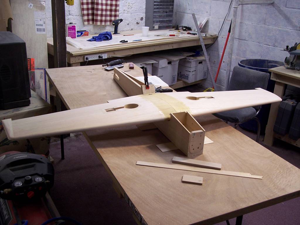

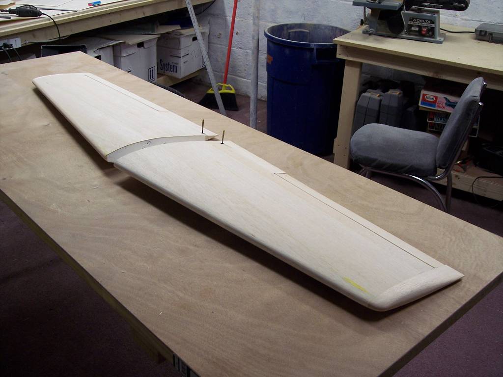

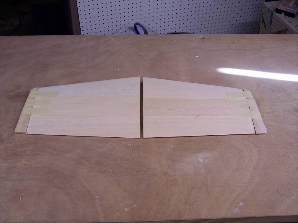

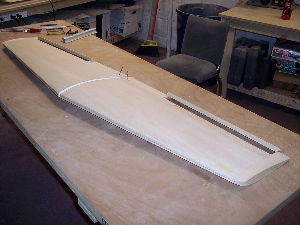

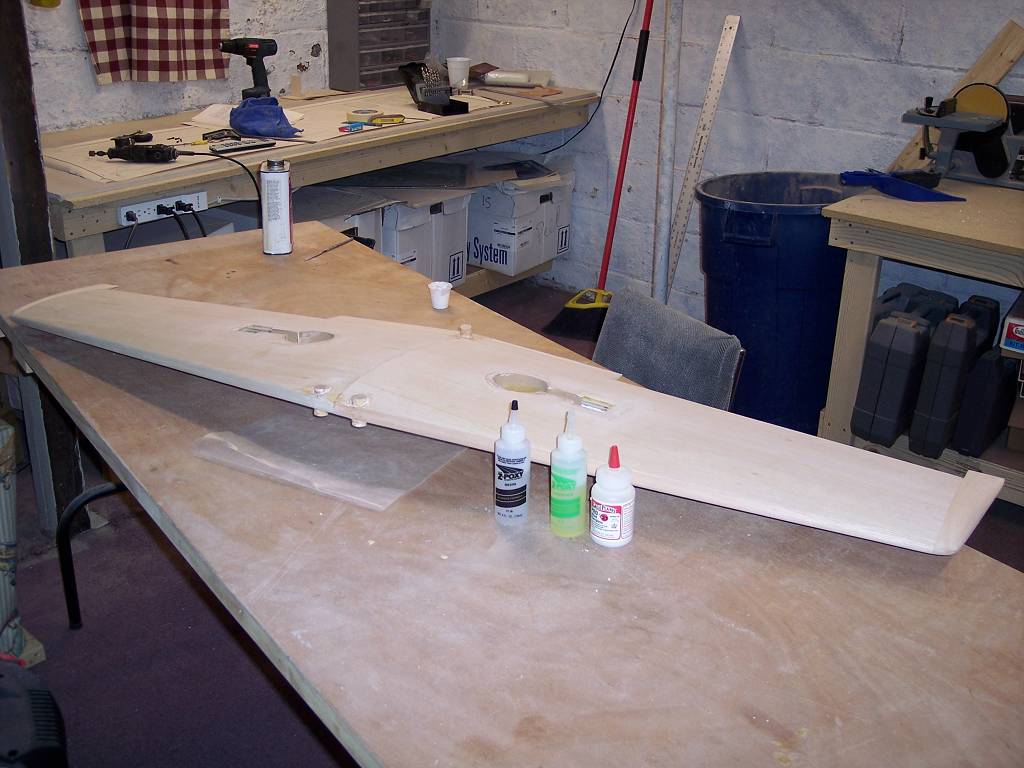

Here is the wing joined, ailerons fitted, sanded and hinged. The leading edge, tips and whole wing sanded. The bolt hold down dowels installed. The center section glassed w/ 8 oz. cloth. I made it by my deadline. Yesterday we celebrated my Dad's ( Bill P. in the post) 70th birthday. He taught me everything I know.

Thanks Rusty, a plus about doing a thread is that my shop stays a lot cleaner. I vacuum up before I shoot pics.

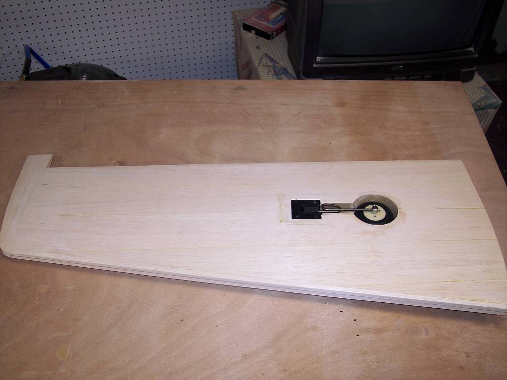

I have the firewall creatively laid out for the nose gear mount. I had to recess the blind nuts. I have F3 cut out and the fuse sides are marked and ready to go.

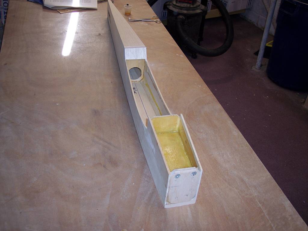

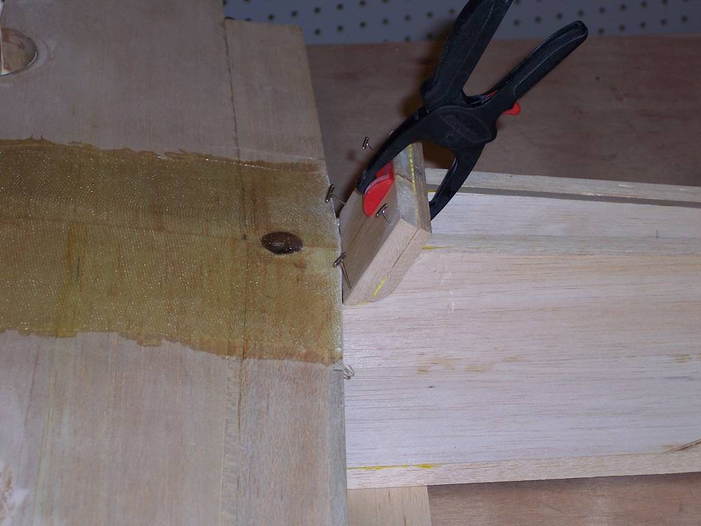

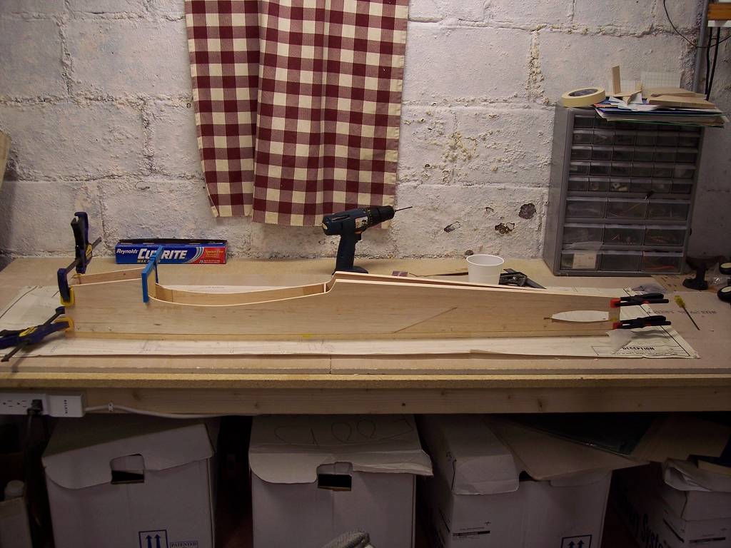

I have the four piece fuse. sides made up. I laid out for the stab. cutouts. The 1/2" and 3/8" triangle stock and 1/16" plywood wing hold down doublers are in place. I finished drilling all the holes needed in F1 and had to cut the angles in F2 to fit the triangle stock on the top. Top blocks are glued together and will be ready for the next step.

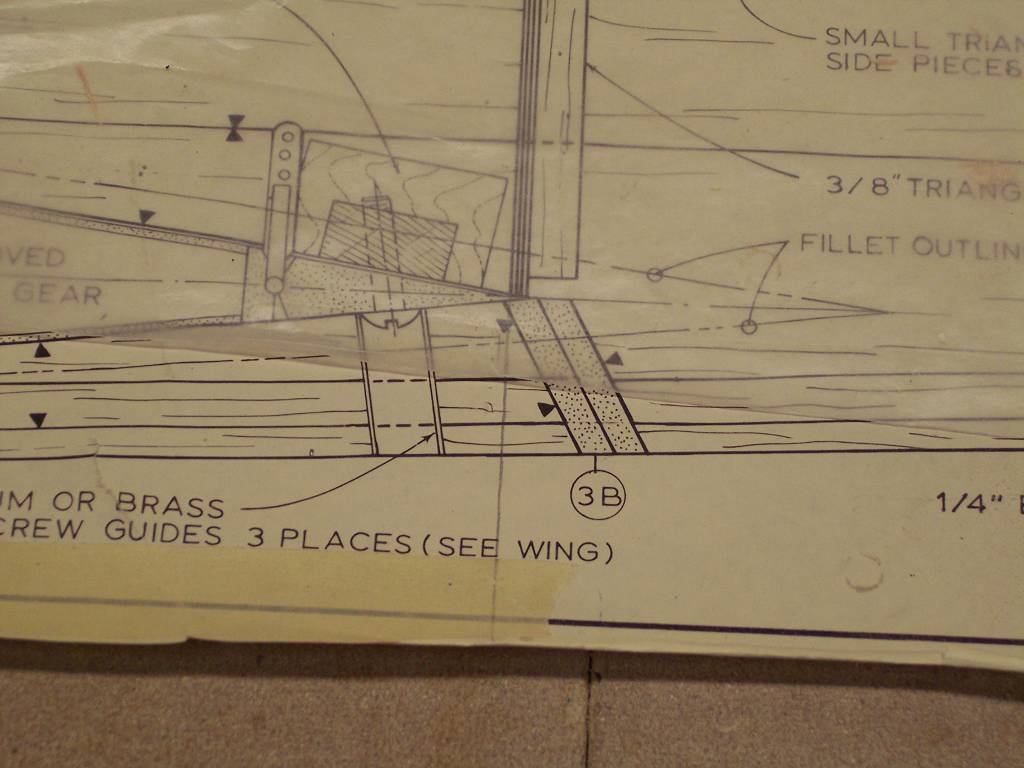

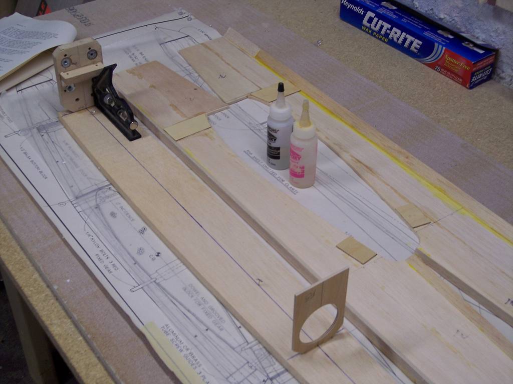

Bulkheads are in and set. There were some minor fit problems but are easily fixed. You are better off to fit the fuse. sides then add the bulkheads. The sides and top blocks are two diffrent lengths. I popped the bulkheads loose to reposition. I used the aft portion as my zero starting point and worked forward as per the instructions. Not a big deal just 1/8" at F3 and 1/4" at F1. F2 just slides right in dead on square to the 1/16" ply plates.

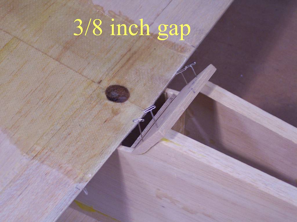

This is why they call it building instead of assembly. Easy fix.

Ed,
Jim's first published MAN plan is correct and shows the belly pan/fuse junction formers as they should be. However, the Bridi plan contains an error and evidently the fuse sides are cut accordingly (too long in the wing saddle). I scratched from the MAN plan so I didn't run into this but I know that Mitch did. Basically the Bridi fuse sides are incorrect.
Which is a good reminder because when I build from my kit, I'll be sure to make new fuse sides and probably drop the stock from 3/16" to 1/8". I guess that will require wider formers too but a 1/4" ply FW should be fine especially if reinforced.

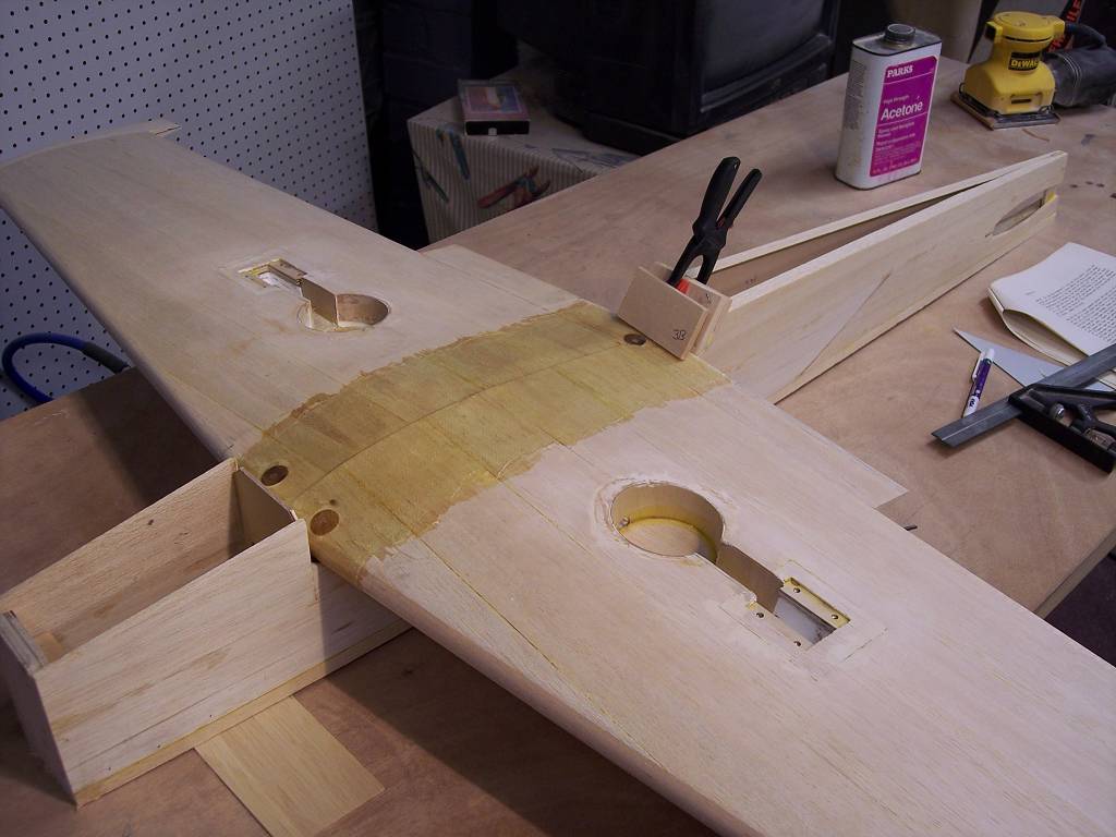

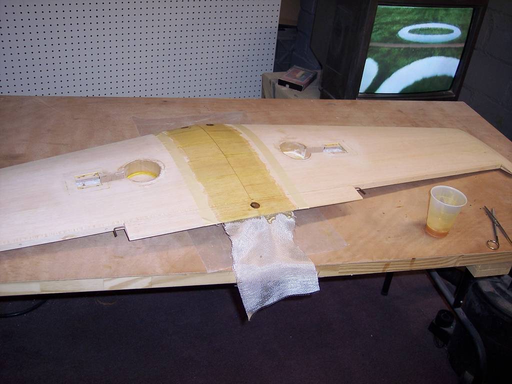

I have the fuselage/ wing F3B fixed. The tank floor/ nose wheel well glassed in. I had to open up F2 to get my SS-16 fuel tank to fit. The elevators are trimed, thinned and sanded and are awaiting the tips to dry. I will have to mount my air tank in the fiberglass canopy. I will be making a large hole in the top block for access. The stab cutouts are done. Why you have to do it twice? It would be easier to have the stab capped and sanded and do it once.

Yup!
just what I was alluding to in post #14 - never understood Jim's/Joe's logic. The cutout needs to be the size of the finished root otherwise it can't be passed - that simple.
David.
