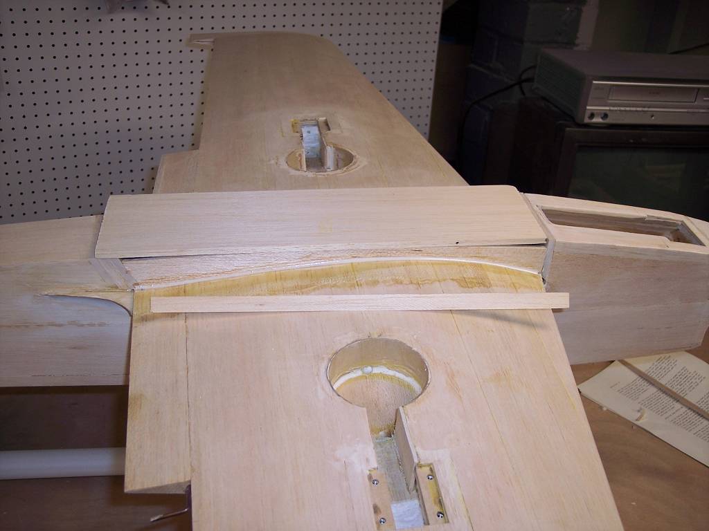

I have the pan sides in place. I had to cut down the side to length to fit. Had the fuse. been right, everything would have fit. I put the bottom on to show the length difference. See how it lines up w/ the filler I put in? All that is left is to put in the tri stock, brass tubes for the screws and I am out of parts. I am now thinking on how I am going to do the elevator control horns. I may go w/ the dowel and 4-40 rod combo or use some Robart swivel control horns. I don't like the kit ones.

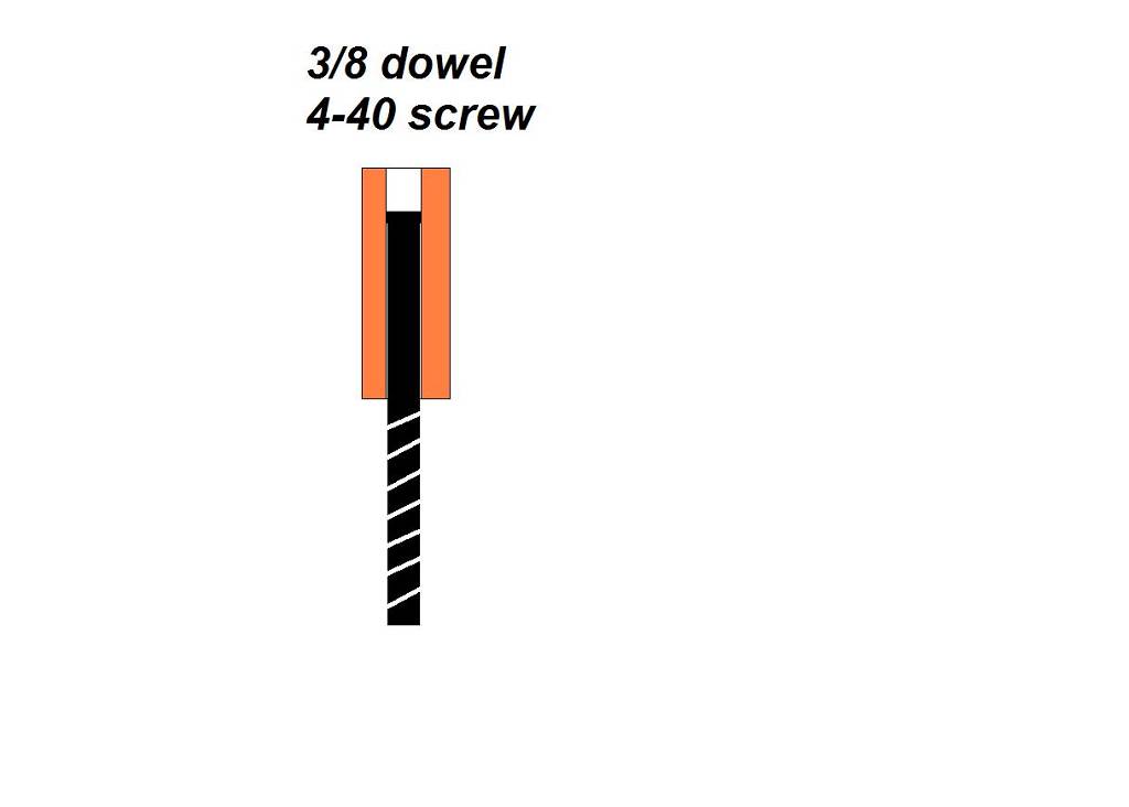

Ed,
if you go with the classic screw in dowel approach, one trick I learned is to drill out the dowel for the 4-40 screw and then drill out the top of the dowel to pass the head of a cap screw. You can then epoxy the screw and head into the dowel. When you bore out the control surface for the dowel and bond it to the surface, you then also glue both the dowel and cap screw.
Somewhat overkill but I found this easier and nicer to fabricate than screwing in the bolt in the reverse direction and clipping off the head and non threaded portion.
Just another idea.
David.
P.S. Considering the number of Deception kits sold, I'm surprised that those plans never were corrected by bringing the F3 former back to where it should be.

Dave,
I used the long 4-40 bolt and dowel trick for my T2A. I put it in before I shaped the elevators. I'll go w/ a 1/4" oak dowel and a sharp Forsner bit to put these in as the elevators are already shaped. I didn't think far enough ahead when I sanded the stab-tips-elevators.

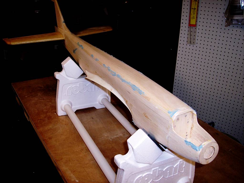

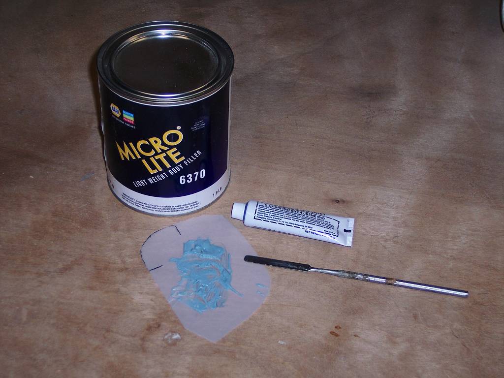

I have been planning, carving and sanding to get the fuselage round. I started to fill in the voids and dings w/ the micro filler. I wanted to see how it was to work with. I WILL be using this for my fillet work. It sets in 4-5 miutes and is sandable in 20. I knock it down with 150 grit and finish with 220. It sands and feathers very well and has a lot of body to it. I will finish the bottom pan work and then fillets, fillets and more fillets.

I'll look for that MicroLite stuff. I'm anxious to see how it works for your fillets where a thicker application is needed. Please keep the updates coming.

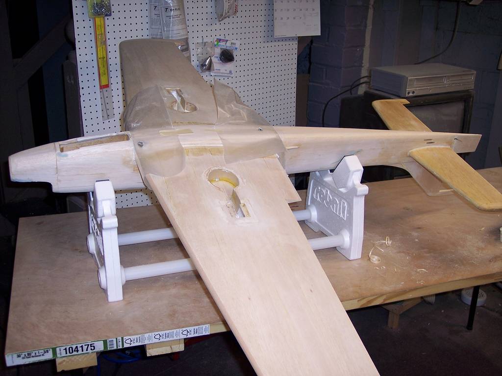

The bottom pan is done. I would not set in the brass tubes until AFTER you profile and contour the pan. Both of mine ripped out and had to be reset. Just cut holes so you can access the screws. I have filled in the gap of the curled fillets from post #84 w/ 30 min epoxy and micro ballons. I plan on doing the fillets this weekend. Getting close to glassing time.
