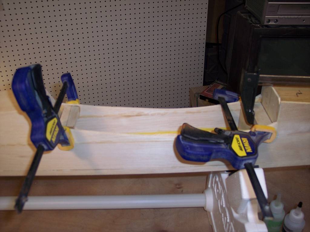

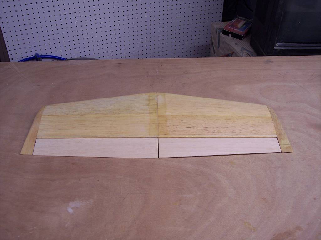

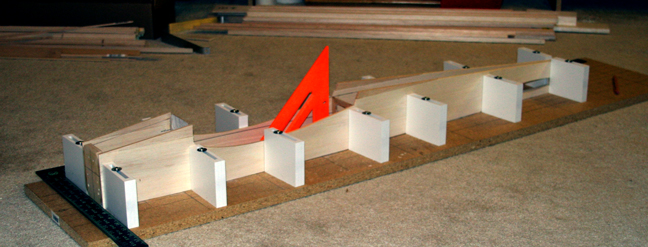

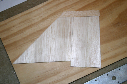

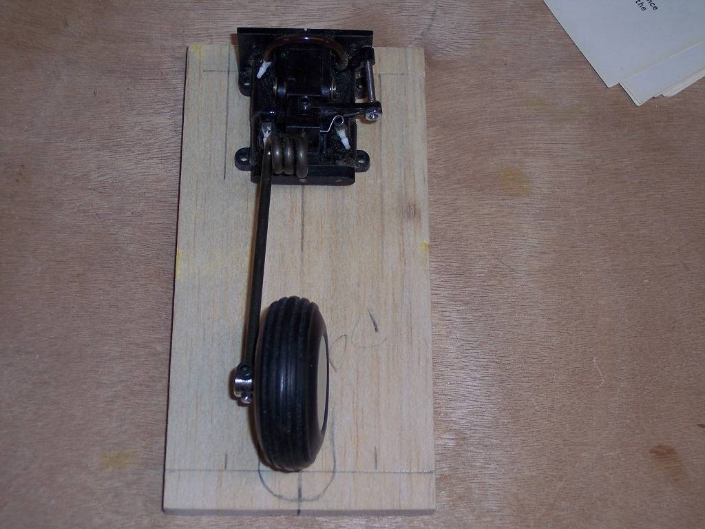

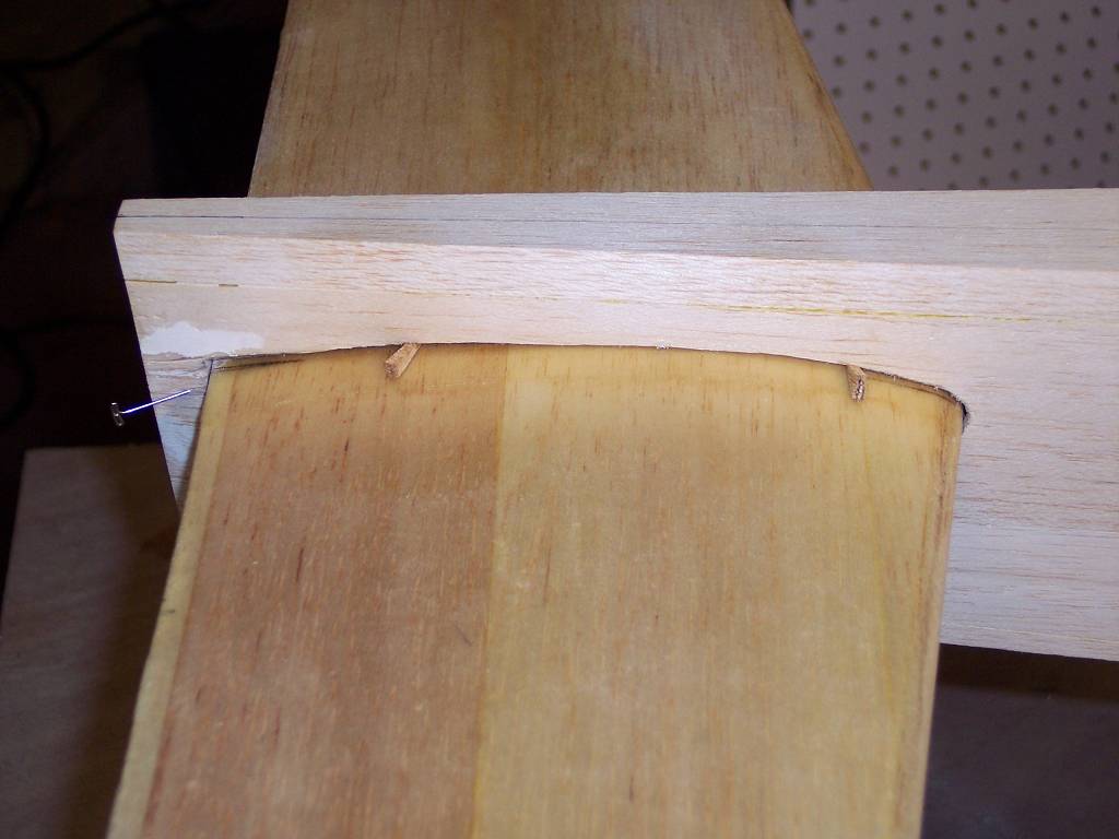

Default RE: Deception Build

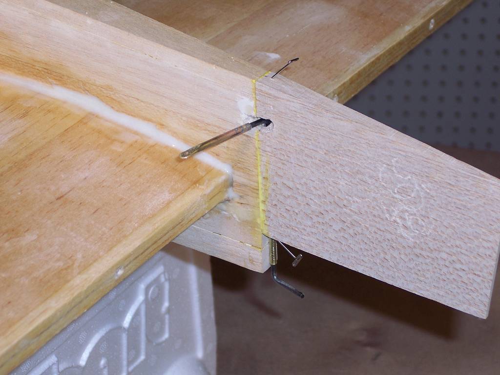

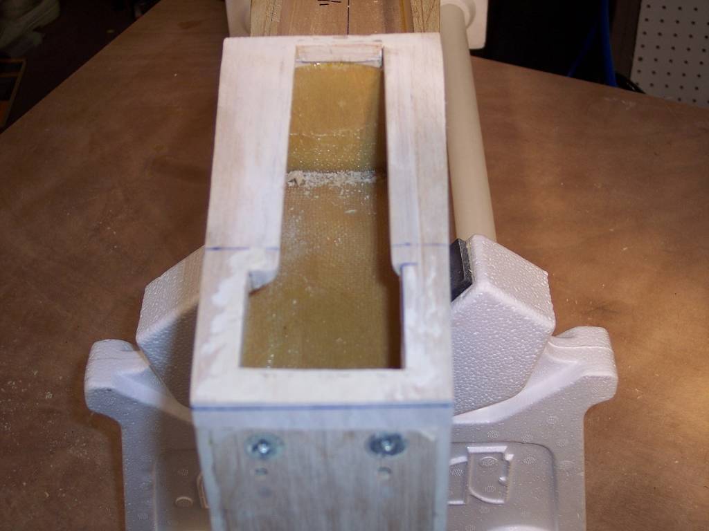

I have the stab complete and glassed w/ the elevators shaped and hinged but not yet cut to size until after the stab is mounted. I had to make some new wing hold down blocks as the kit's were to short. I didn't have any 1/2" x 1" maple so I just laminated two pieces of 1/4" 5 ply together and cut to size. Since this is plywood, I will be using threaded inserts. I have the stab shimed in place square, level and at 0 degree incedence. I will make up a slurry of 30 min. epoxy and milled fibers to set it in place tonight.

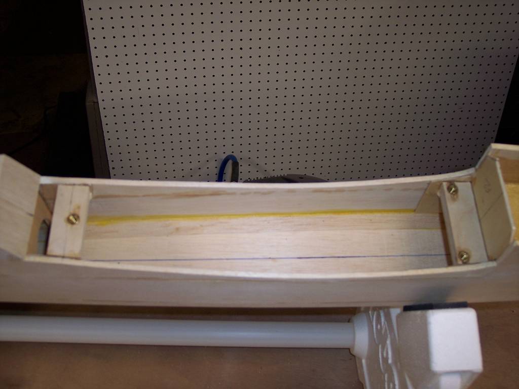

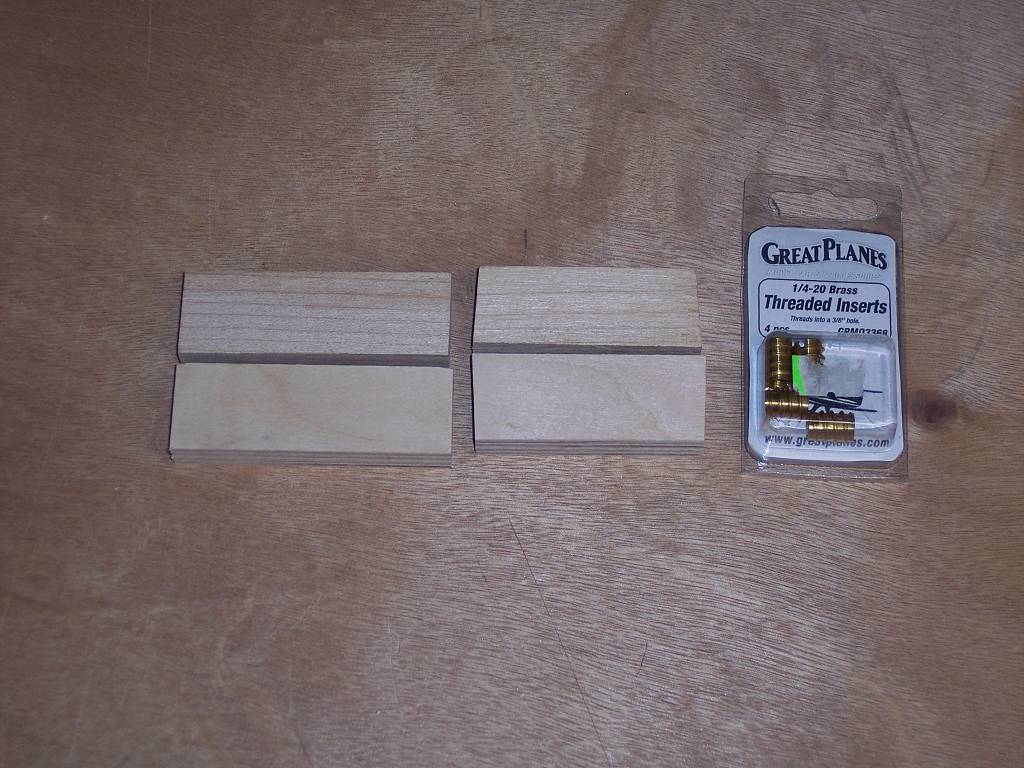

I've used plywood for wing hold down blocks many times without a failure. Have you had a problem with them in the past which brought you to the threaded inserts? I'm still running a little behind you with my Deception build, so I haven't tackled the wing hold downs yet. The epoxy "slurry", do you just shred some FG strands through it or is it something more complicated? Do you thin the epoxy at all?
Did you put any doublers inside the fuselage? If so, please describe.

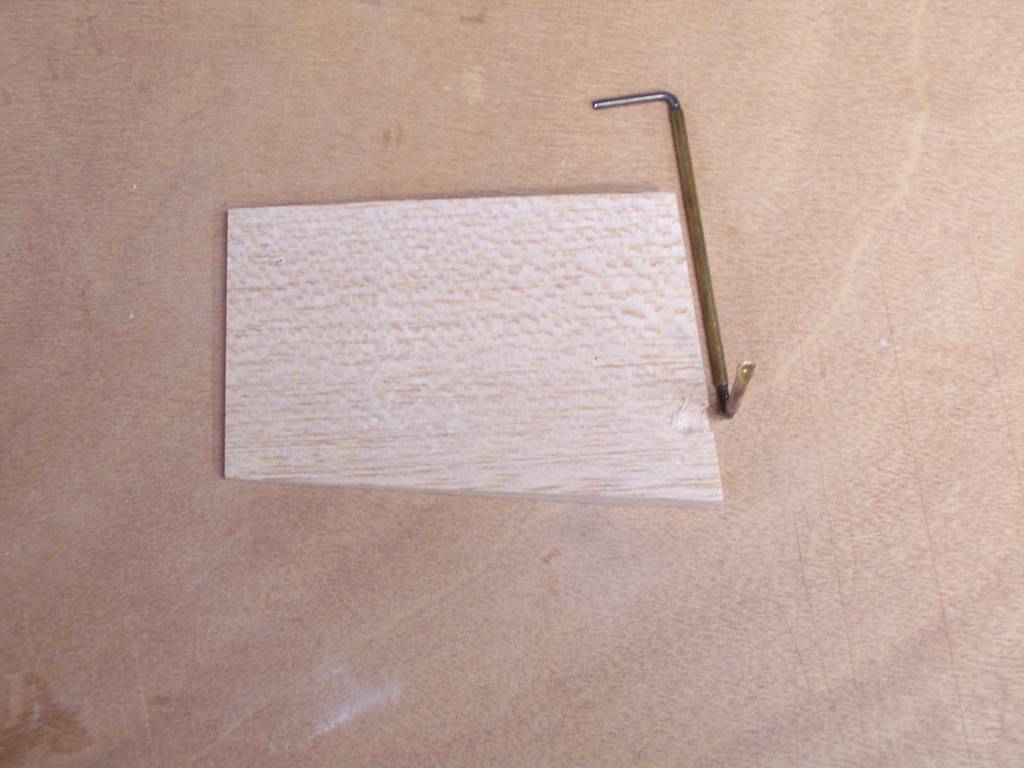

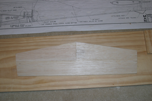

It is just one of things my Dad taught me before that you don't tap and thread plywood. It doesn't hold the threads as well as solid maple or oak. The only doublers are the ones for the hold down blocks. I don't thin my epoxy as I will want a stiff mix to pack inside stab/fuse joint. I use finishing resin w/ micro bollons for fillets and again I won't thin it. I may try some micro filler from NAPA that a scale modeler uses in a scale build thread "Ramone Torres's 1/5 scale T-34 by VBDRIVER" for the fillets. It is supposed to be easy to sand. I know I show a lot of GP products in my pics. I hope the moderator don't mind. I'm lucky to have a VERY WELL stocked LHS a few miles from my house.

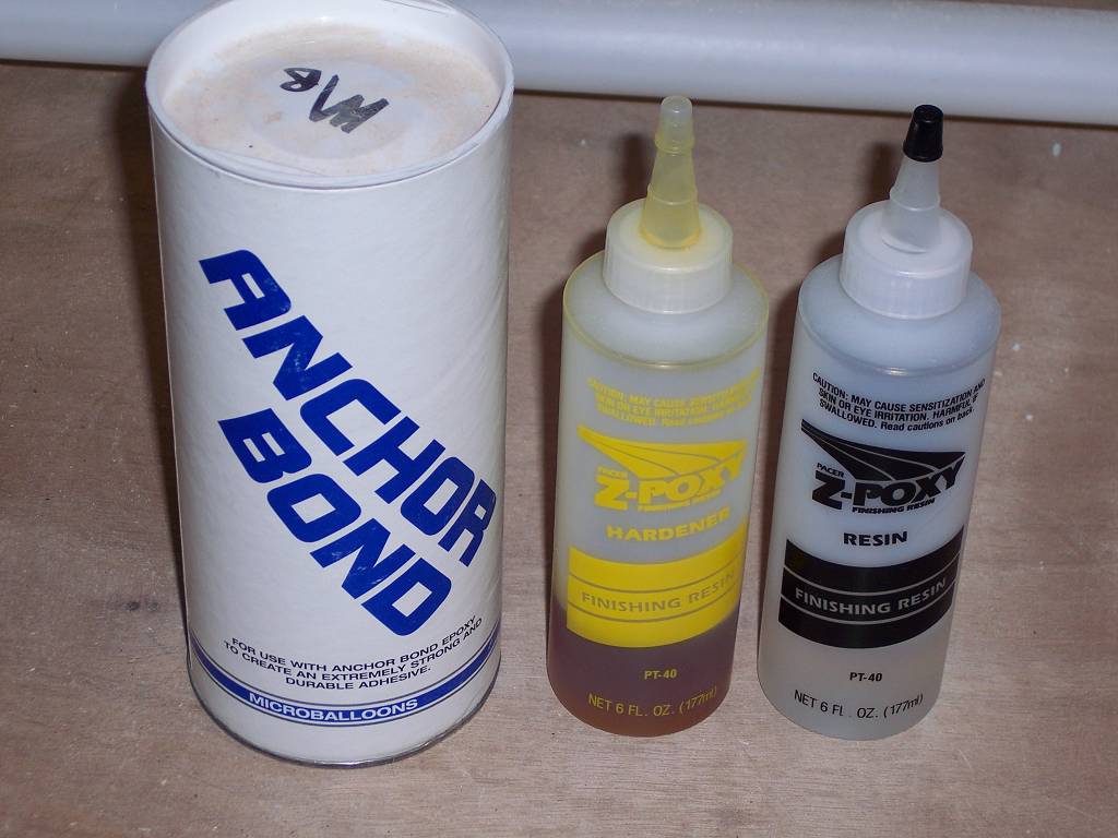

those are two great products that Ed is using.
The finishing resin is pretty thin - it flows quite a bit so you can thicken it up to consistency and hardness with the milled fibers. Once you get it in the stab joint (for example), you can smooth it out at the stab/fuse junction with a finger dipped in alcohol. This just helps to glide the finger along the material and produces a nice U shaped fillet. Same goes with say a wing fairing fillet that you apply atop a ply guide and tristock.
You might want to use a disposable glove when you do this (I've started to out of consciousness although for years I never did).
Very nice work Ed!
David.
P.S. I see that is actually 30 min epoxy not finishing resin (~60 min epoxy) but either one will do.

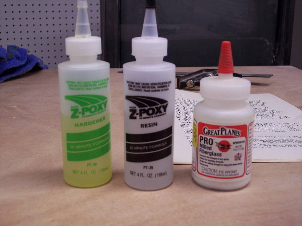

I had never seen or even heard about "milled" fiberglass before. Thanks for mentioning it. What does the stuff look like? How finely "milled" is it? Does it add strength or just substance? I do use the same epoxy you've pictured and agree that it's as good as it gets, but did purchase some "Aeropoxy" (as recommended by many, but haven't tried it yet) for the actual glassing to come. Did an Internet search for hard maple 1/2" stock and didn't find a good source. I did find some heavier stock, but I don't have access to a planer. I'll keep looking, but I may have to go with your approach.

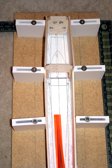

Unfortunately, my LHS is about 50 miles from my home. I keep trying to convince them to open a "branch" in our area. There's probably 100 people flying RC in my local area (that I know of), and no LHS closer than a 1 1/2 hour drive (each way). Ed, I'd like to make a one-time picture post (unless you'd like to see more of what I'm doing). Hope you don't mind.... I want to respect that this is your thread, and I'm not planning to start one.

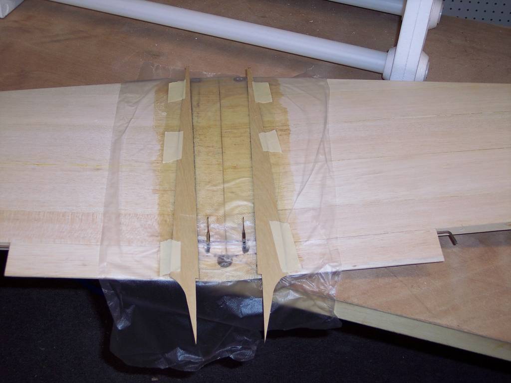

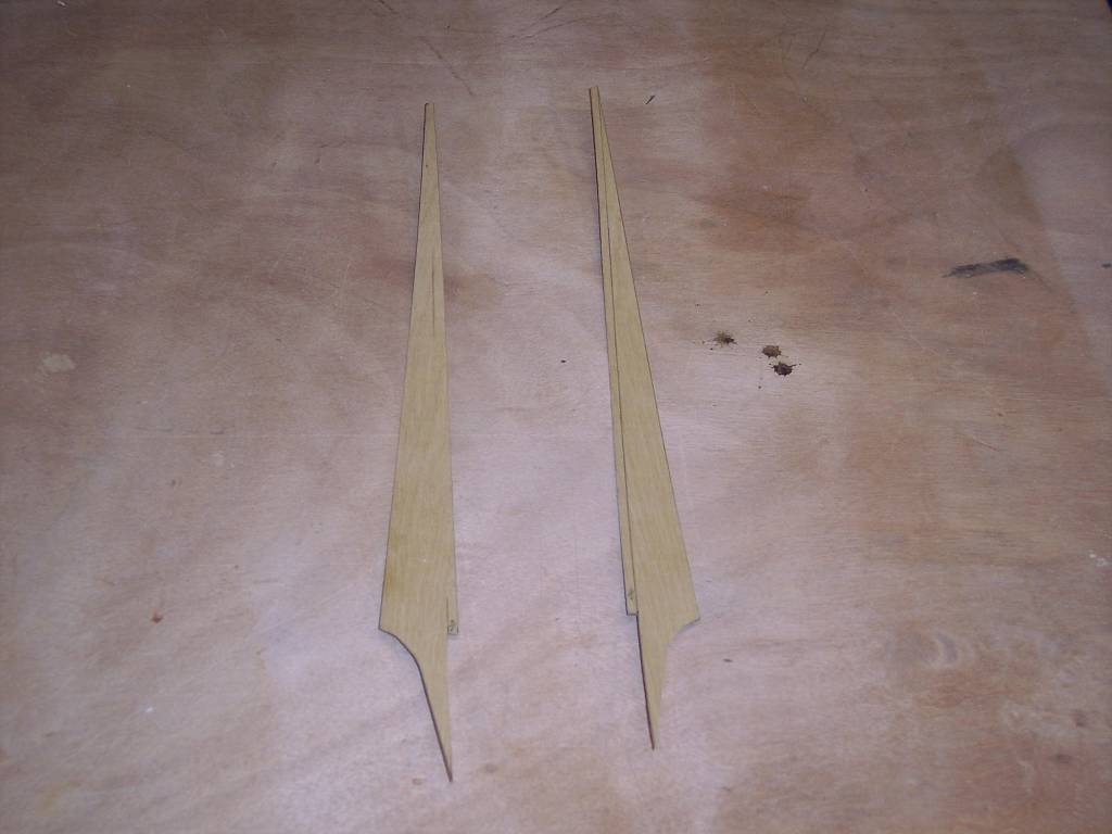

David, these are for you..... As you can see, just started framing up the fuselage (just a trial fit... no glue as of these pictures - glued now, and currently adding triangular stock).
Greg

Milled fibers are ground to 2 mills. long. They add a lot of strenth to a joint. I know, I had to cut my stab back out as it was off center by 3/16 in the TE. All I can figure is that I move it while centering it up with the nose center line. I was watching the forest but missed the tree type of thing. It is NOW dead on and triple-triple checked. It is embarrassing but I caught it before I moved onto the wing setup.

Wow, I don't envy you having to cut out and reset that stab. I committed a similar boo boo yesterday. I forgot to create a solid base for the dural gear just in front of my wing. I'm going to have to cut out a section of the triangular strips and the tank floor to put in some ply to support the heavier gear mount. Fortunately, I haven't attached the bottom nose block as yet..... but I'll be real careful about centering the stab. Thanks.
By the way, how are you going to fabricate the rudder linkage, over the stab or under? Will you snap a photo of that detail?
Greg

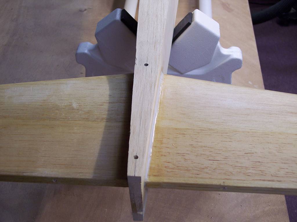

The stab went back in O.K.. The scary thing is when I laid the wing in the saddle. It fit. The incedence was right on at 0 degrees. The measurements between stab and wing were within 1/16" of being square and the saddle needed sanded just a touch on one side to be level. Today the "Balsa Gods" smiled on me LOL. You can never have enough clamps when you build. I'm going stock on the rudder hook up for a cleaner look.

I just noticed that neither the plans or the magazine construction notes discuss the control linkages. By "cleaner look", I assume you mean under the stab. That would be my preference too. A split elevator pushrod, and using a nose gear steering arm on the 1/8" wire rudder torque rod/tail wheel mount/axle with the rudder pushrod.
I'm surprised to find that I've got a significant gap to fill with my wing saddle, even though I used a plywood template for my root rib to shape the fuselage wing saddle cutout. Oh well, that's what "building from scratch" is all about I guess.
I'm gonna order some of that "milled fiberglass".
Greg

Finish resin and micro balloons for the base. I will finish off the fillets w/ some NAPA micro filler. It is a two part product. I will post pics after I pick some up. Laying out for the nose wheel well. Tomorrow I will glue four blocks together and form an airplane. I must be getting close to being done, there are not that many pieces left in the box.

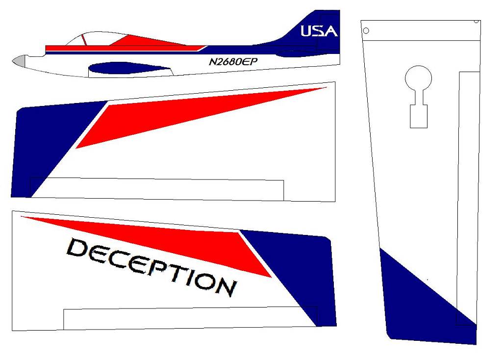

My color scheme. Got to love a paint program to lay things out.
