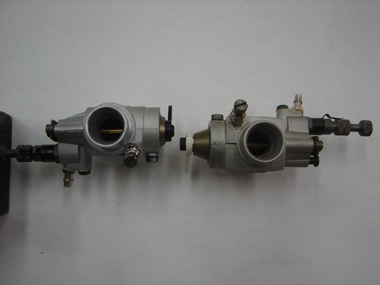

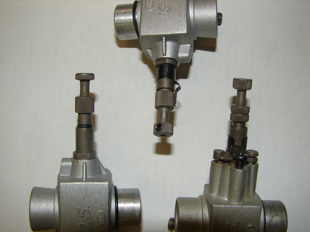

Here's some photos of the 7L and 7M carbs side by side. Also a photo of the variations of the 7D needle. The 7D and 7H carbs NIP. 2 of the 7 four-legged residents at my house.
These carbs all have homes (engines), but it is much harder to see the carb when it is attached to the engine.
[img][/img][img][/img][img][/img]
The last photo is a slightly better version of the first photo.

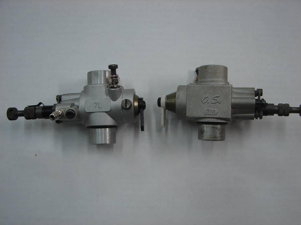

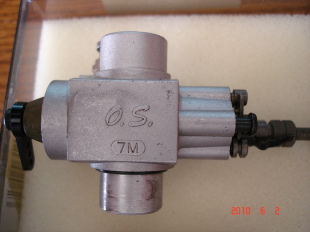

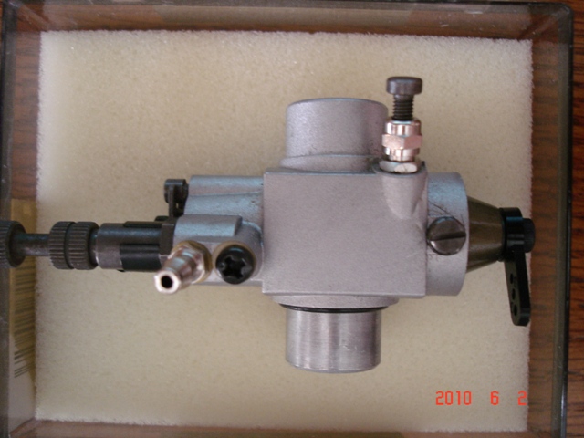

I have have many NIB OS61SF's, all ringed. All have the 7L. I think one of the used SF's mounted in a plane, has a 7D. That engine was NIB also. Would that 7D have came with the engine, or could it have been switched? It run's fine. I also have a VGC 7M, and forget where I got it. Can anyone give me the low-down on this "M" model?
David, thanks for starting this thread.
Vince

the m version has three needles, the 3rd is a midrange adjustment, or at least that's what i learned when i posted the same question. there should be a thread on it in this forum.

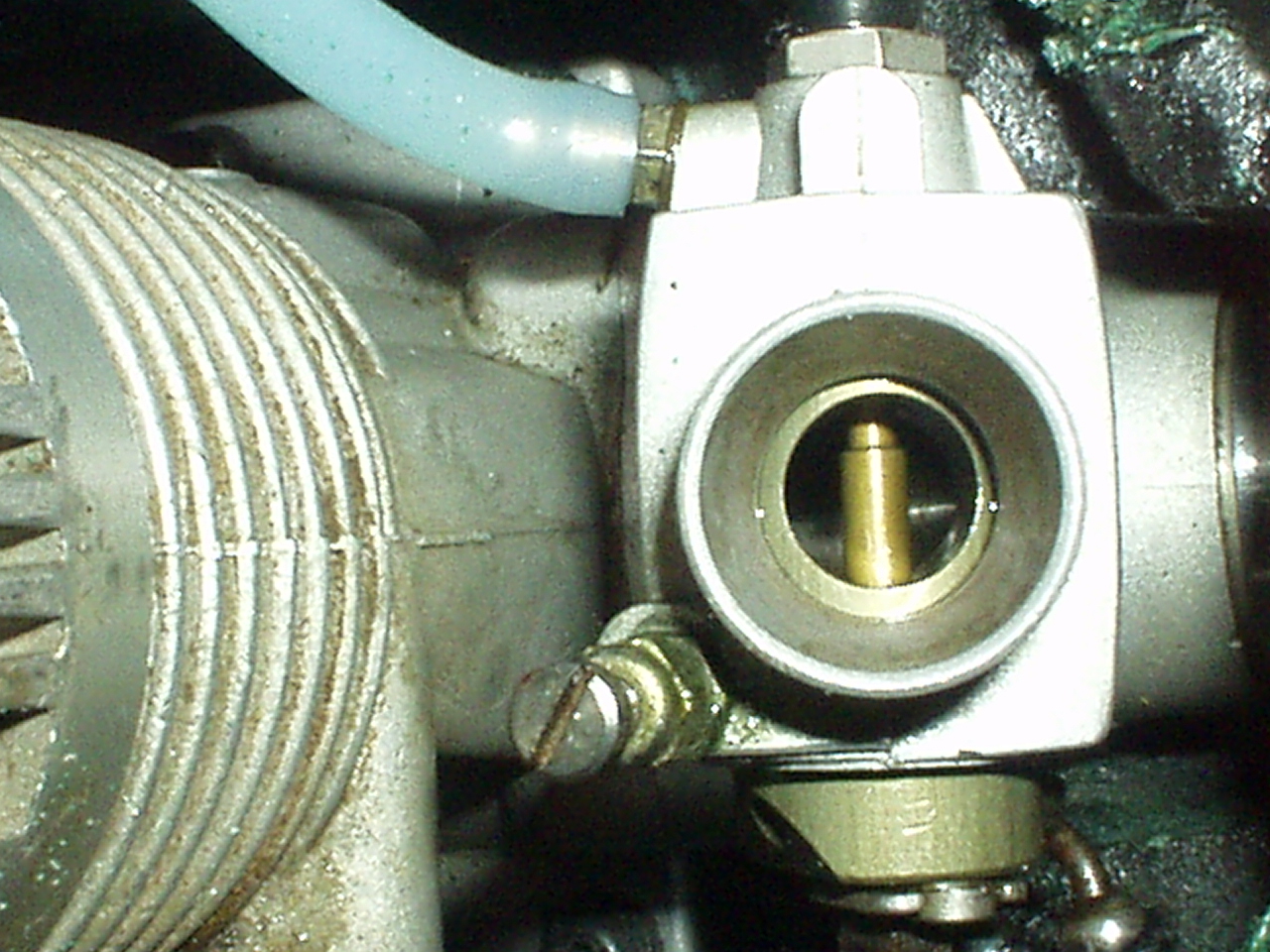

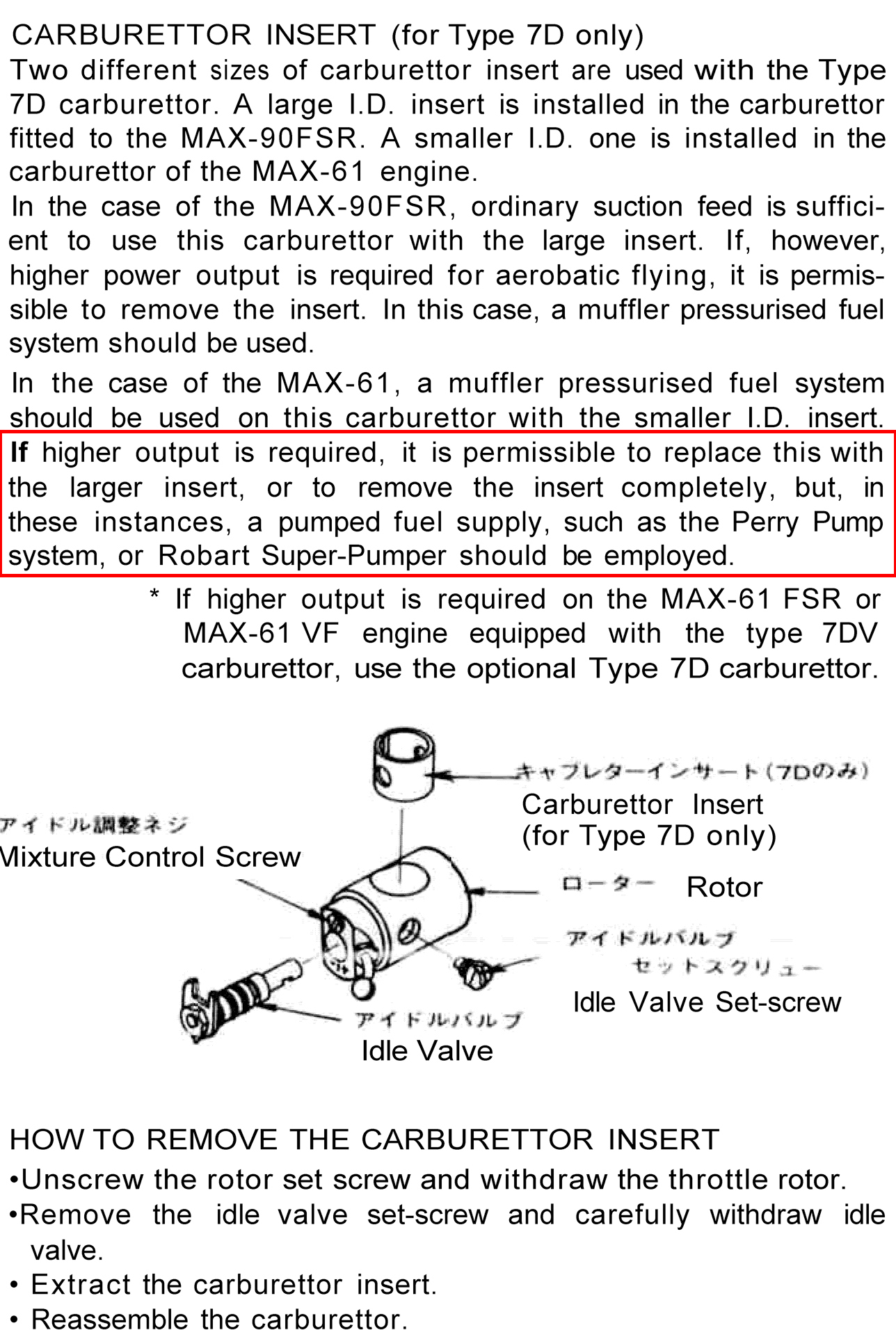

I would imagine that if your running the engine without the insert that you would have to increase the amount of fuel delivered to the engine due to the increase in airflow to keep it from running lean. According to the 7D - 7DV manual OS suggests that you use some type of pump with the small diameter insert removed.
I suspect that the engine is not running efficiently as it should, soI concur with flywilly thatit's possible that your just wasting fuel, Measure the diameter of the carb rotor. It might have the 7DV carb rotor installed in a 7D carb body. If it's the DV rotor it's diameter is aready 8.5mm and you won't need he inserts anyway. Another issue is the type of fuel you're using. If your using 20% nitro you'll useway more fuel than say 5 or 10%. Post a pic of the carb.</p>
ORIGINAL: Pa-18cub150
What is needed to make the 9b carb insert work?
</p>
You would need to grind down the gap where the insert comes together inside the rotor andyou would need to make sure that the two holes allow the mixture control valve to passthrough.</p>
I have not tried this but you could possibly use one of the carb inserts OS has for the carengines. In this case it inserts into the top of the carb. Would be way simpler if they fit.
Bryan</p>

crankpin,
This is really interesting, according tothe 7M manual this carb was developed for FAI F3A contest flying.

Muffled not piped. I was thinking the same thing about wasted fuel as this is a dripping mess even when leaned out with good transition and idle. Oil pours out of the muffler after every flight!
This is the largest 2 stoke I have so my thought was more power more mess. I have mostly 4 strokes.
I am using Omega 15%
my battery is DOA in my calipers, but the boar is smaller than a 9mm Luger bullet and larger than a 8mm Mauser bullet.
