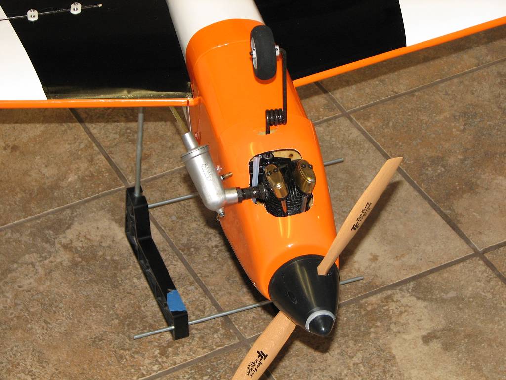

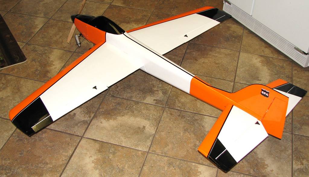

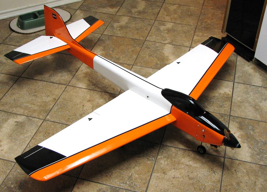

Here she is, all dressed up and ready to fly. Ibalanced her this evening and changed out the rudder/steer servo for one with a lot more torque and a bit faster in reaction time ...and it centers better.
Hope to fly her soon and tomorrow afternoon is looking good.
That's a Top Flite 13x8 prop but, I usually run a Xoar or Zinger Pro. Ineed to stop by the LHS and get some spare props.
RJ

Alright JOE!
It looks pretty good!
That is the exact same setup I had...you will have plenty of clearance for a 14" prop.
Balance it so that it teeters on the main wheels ready to fly without fuel.
When you add fuel the c/g will move forward a bit and keep the nose wheel on the ground....they fly best when balanced this way.
Oh...you might need a foam clunk for the tank. This is a YS part and available from Central Hobby.
I was having trouble with the fuel slinging away from the clunk so I changed to the foam clunk that kills air bubbles.
