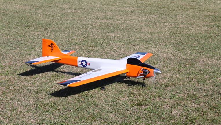

It's finally done.... maiden flight and one more were completed without incident. The airplane trim was pretty close, but the airplane was way too sensitive to the controls. After completing minor trim changes,, brought it in to reduce movement of the ailerons and elevator. The next flight was impressive. Nice four-point rolls and three consecutive rolls. Nice big loops that tracked well. Spin entry and exit easy. Stall turn - no problem. Smooth gentle climb-out on takeoff and solid control of landing sequence. Only negative... the clear covering AM put over the wing leading edge is already coming loose.
Nothing to do now but practice and start working on a backup airplane. Photos show taxi out and landing approach of the maiden flight.

Good advice Crank. I'm doing just as you suggest. Battery pack is underneath the fuel tank. CG is right-on without any additional balance weight needed. This really feels good... I was starting to get gun shy.

I'm going to leave the CG as is, at least for the time being. The CG is right at the main gear.... it'll drop onto the rudder without a prop and spinner on the engine. What would be the benefit of moving it back any further?

I understand, and thanks for the heads-up. What I do need to do is to put a little lead out in the left wingtip to offset the sideways engine mounting. I'll do that before my next outing.
This airplane does look really nice in the air.

Being a USAF veteran, the Navy paint scheme rubs me the wrong way - but what the hey. I'll locate one of mine (Intruder 90's) and get it set up for either an OS .61 SF side exhaust engine or a four-stroke. I have a Saito .91, a Thunder Tiger .91 (with black fins - that's good for another 1k rpm, I suppose) and a Magnum .91 for choices in four-strokes. Oh, and if I want to burn enough nitro to make up the difference, I have a pair of Saito .82a engines that would move that CG back a bit, I'll bet. I'd probably have to add nose weight if I chose an .82.

As a fellow Air Force veteran, you might have noticed that I didn't put any of the Navy decals on the airplane. I have several Webra Speed .61s left over from the "old-days", but I wanted to use the Intruder as a platform for my first 4-stroke... a Saito .91. It's a little too quiet, but it pulls the airplane very well.
