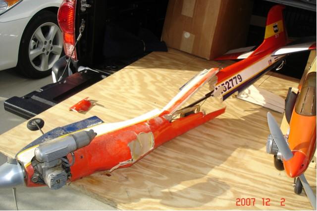

Hey Chief - No fear. Take a look at my Intruder # 1, then the re-building process. This should make you feel good, not to have this much damage. High speed stall at low altitude, downwind turn on final, straight down. I have since retired this one. If you are using 2.4 radio, make sure you have a 6V rx battery pack on board.
Crank

Hey Chief,
Bummer.
If it's any consolation; You haven't lost as many models with one radio as my father. He uses an extreme 2.4 conversion on a Futaba 9C. He has lost about 6 models in FL because of radio problems.
I finally got him to buy a new radio, so far, so good.
I wouldn't recommend staying with a radio too long based on repairs to it, especially since there are so many new radios available for a reasonable price.
Hope you're back in the air soon, with a good working radio.
Chris...

That Intruder looks like my Deception did after the radio failed. The Spektrum DX7 is a 2.4 design as I'm sure you know. the flight Intruder receivers and battery were not the same ones that went down with my Deception and Ultimate. The battery was a brand new 6v NiMH pack from HoBS Batteries. Everything fully charged for this first flight. At the field, after the crash, I switched the aileron cables to the receiver and the opposite aileron then went into full UP deflection. While talking to a tech at Horizon, a few hours later, he asked me to plug in the wing again, and the ailerons were both perfectly centered. It will probably look just fine to the Horizon tech who gets the repair job.
Greg

Chief - I am using NOBS batteries also, great set up. Important question: Did you re-bind, after all change's, set-up's, etc. ?? That is important, after all adjustment's, etc. From what you are saying, sound's like that could be the problem.
Vince

Chief - I don't want to sound like an ahole, did you re-bind before flying ? If you didn't, that could be the problem. I am not an expert here, but only speaking from experience.
Vince
