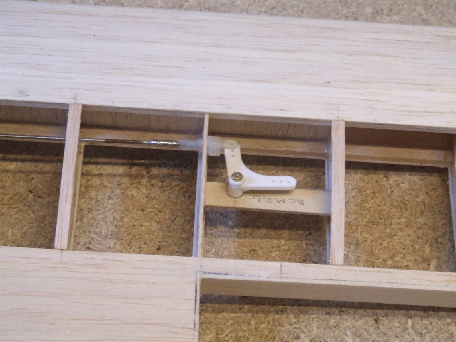

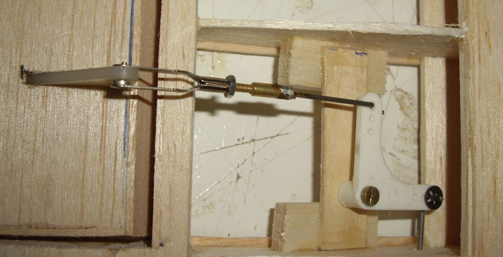

Johnkpap,
You did nswer my post but the question wasn't for me I read.

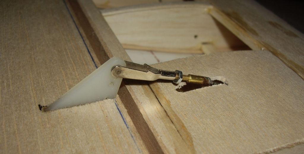

It is a situation in which I can help you so I give you my opinion.
When the movement of the connection rod between the bell cranks is less, as I can see on the picture and you write it, there is only one important solution to use, try to find a bigger servo lever.
Very important to reduce the play.
Next step, bellcranks no gain and no reduction, 1:1
Levers on the ailerons to adjust the throw but never to short.
It has also to do with vibrations later during flights.
The more movement of the connection rods the less forces!
If any reduction is needed you can reduce the throw on the bellcranks for example 1 : 0,8
Easiest way to have the best result.

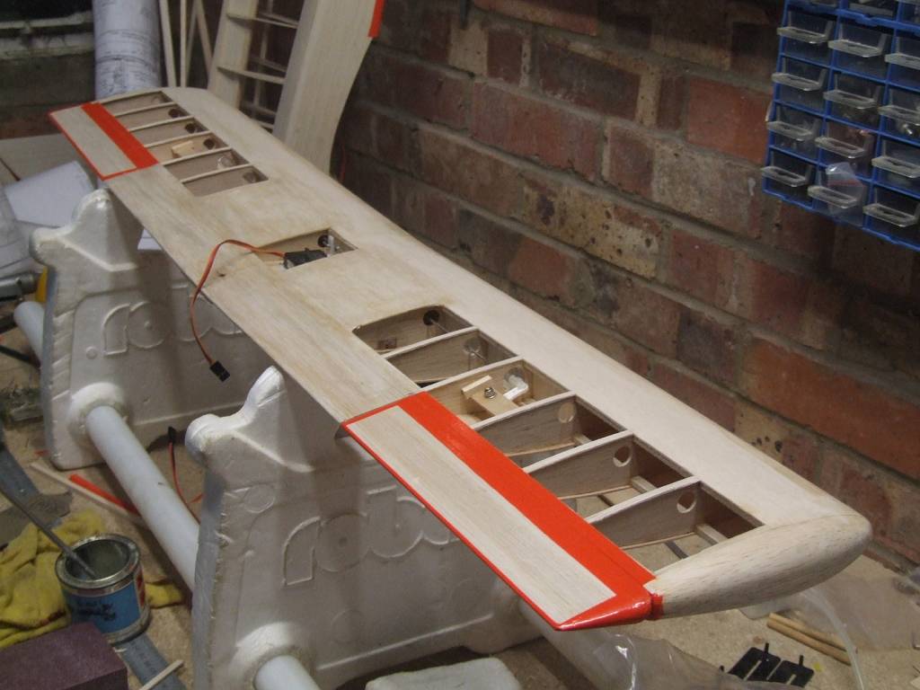

That was a big hurdle and I just have the ailerons to face up and attach using solarfim. Every thing is down hill from here. I used the Kavan 4oz flexi tank in the end as it was the only one that let me get the battery linkage and fuel tank in to that small bay. I am doing a final sanding down in preparation for starting covering. I probably will cover the elevators then the stab then the rudder then the vertical stab under rear fuz front fuz and the wing some where along the line.

Are you going to use a 1:2 or 1:1 ratio on your bell cranks?

Just finishing these ailerons at present then a little bit of sheeting I guess where the pushrod will exit the wing and that is about it. C o v e r i n g time.
As shown (I think) in one of my pics there is some step down on the bellcranks. I dont know (not thought about it much) but if the throw is stepped then presumably any slop is reduced down by a similar amount- normal throw = 2 in 1 out then error movemnet = 2 in 1 out. Well thats my logic

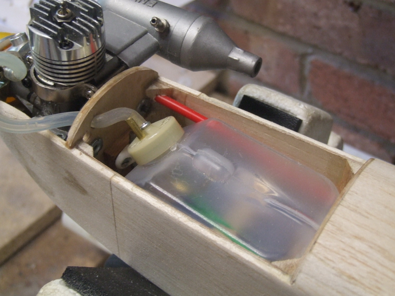

Here are some pictures of that very filled fuel tank bay. The control horn on ehach elevator can be removed for covering purposes. Thought I'd throw a picture of that in too.

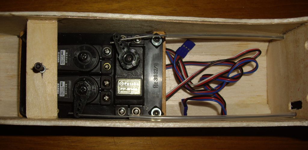

#38

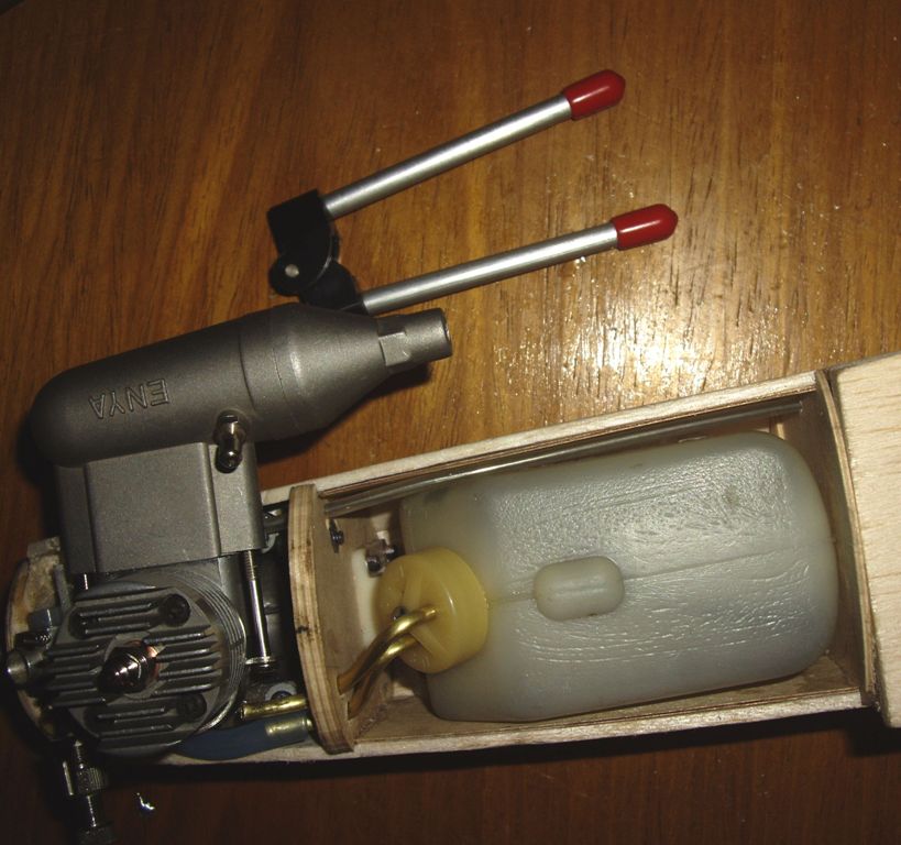

Ok I have installed my Throttle linkage and Steering linkage,
I have tried to keep it a simple as possible and take up the least amount of space as I am using
Full size servos. I Used a IM clamp style Engine mount so I can get the ENYA out Easy with a Dubro Ball link on the Throttle,
there is not alot of room in the Engine bay or the tank area so I just used thin piano wire through a plastic tube, with a Z bend at each servo.
The fuel tank looks like a Problem, I am still thinking on this one.
I have started sanding and shaping my wing and will be doing the Ailerons next .....This is going to be a Pain in the A@#E [
Johnkpap
]Johnkpap

Nice solder work - worth noting.
Can ya rotate that cap and grommet 180 degrees so the lines are on the upper side or maybe on the left side?
ORIGINAL: AllTheGoodNamesAreTaken
Looking great!
You might want to bend that brass tubing toward the hole in the firewall so that fuel line doesn't split from the sharp edge of the tubing.
Looking great!

The fuel tank was just shoved in for the size check. I did note in reading the Fle Fly article that the CG is at 40 percent and "you may have to add weight to the tail". Now that sounds good as it may mean the battery can come out of that rather cluttered compartment. I am not too happy at a 40 percent starting point though so I may start with 35 percent and move it back if its OK.

I made up the fuel tubes with my Dubro bender, and decided on the PYLON tank.

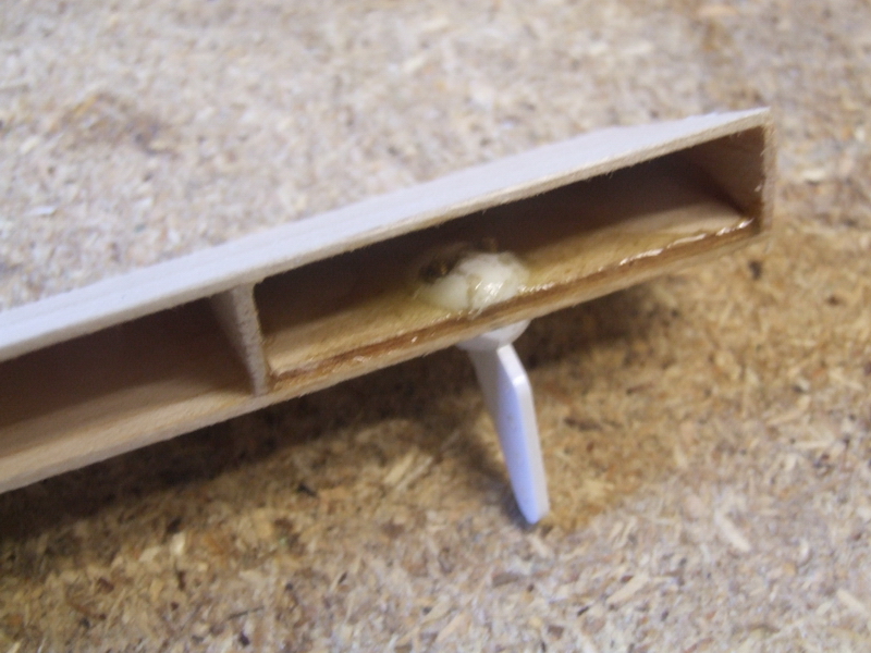

I covered all the control surfaces first except the top surface of the ailerons as they will have about an inch wide strip to attach them, top and underneath and the top wing covering will go right over that and the ailerons - thats the theory. A few akward jobs like the control rod exits on the fuz will have a small amount around them added before the main covering is added as it makes that job alot easier. Have you added any side thrust? I hope to have about 2 or 3 degrees as advised in his article. Beware theniple on the enya silencers. They get loose. Make sure you add some locktight to it.

I use a clean Pointy soldering Iron to make Control rod Exits in plastic film.

Cutting the tube shorter will help. Good point you picked up on there. The pic doesnt show too well but I agree with you that the tubing holes in the firewall should be a pich fit which is what they are. I have given the engine bay a coat of epoxy and painted it grey. I thought about orange but A/ I havn't any and B/ you see hardly any of it. However the firewall former (the one in front onf the tank) will have to be solarfilmed and how good that will want to remain I dont know. I may have to get some orange paint yet.
The ailerons have their solarfilm top attachment but there will be another piece covering the lower side. Should be very light and flexible when finished.

I have finished sanding the wing and cutting out the Ailerons, It worked out to be easyer than I
thought it would be, I made up my Conrtol horns buy cutting down some SIG horns (SH-694)
these are a close match to the ones used on the plan.
I decided to go 1:1 on the bellcrank this gives full movement of the ailerons, I can reduce the servo's
movement in my Futaba radio if the Ailerons have too much movement when trimming the plane.

The bellcranks are standard "Great Planes"
Tower Stocks them
