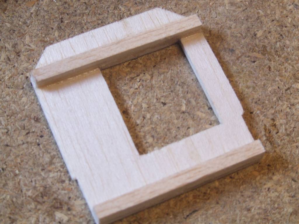

Having started building this lil bute I thought I would share some of the triumphs and heartaches of the build. There are a couple of threads on this plane, undoubtedly known by many to have been first designed and build by the famous Phil Kraft of Kraft Radio Control fame, but I cannot find on any forums notes on its building.
I have the basic wing complete and am just starting the fuselage.
Note on the wing build: The wing ribs were actually individualy cut but then to make sure the spars were in the same location I placed them altogether and cut the slots. This allowed me to sand them all to an equal shape.
The LE was meant to have been 1/2 X 1/4 but Inever had any so I cut it from hard 1/4 sheet, but not very well. It ended up about 1/8 too narrow so I will fit the leading edge sheeting over the top. I prefer it that way so nothing lost there.
The U/C mounts had to be cut out for the leg to fit in. You could once get these ready made with the slot but alas not so now. I could get the bigger type that will fit the slik Fly (On my list of building projects and ordering parts for same as I write this) The cutting of the rebate for the 10g leg went much better than I expected though so I am happy with that.
I have about five 4oz fuel tanks on order and hopefully one will fit

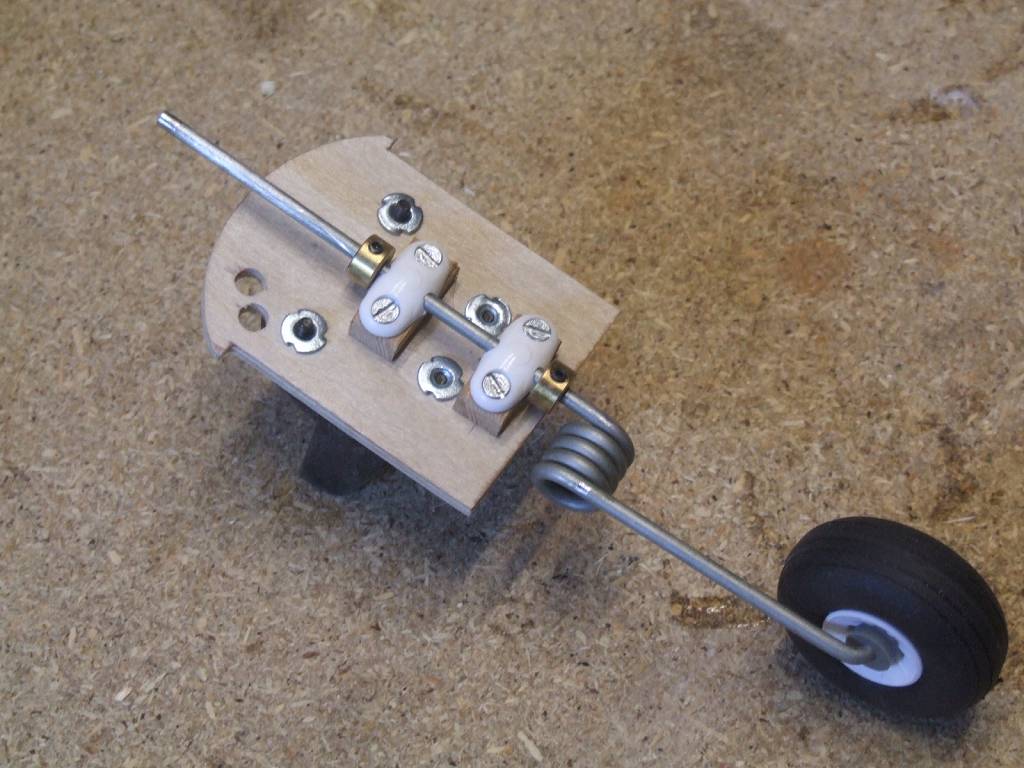

I am now progressing with that fuselage. I managed a boo boo there. I cut the fus sides too short at the front. Rather than replace them I just spliced a further bit on the front.
The fuel tank bay seems a very busy area. It has to house the nosewheel tiller, the battery (Using a flat one) as well as the fuel tank. . . Anyone got a shoe horn

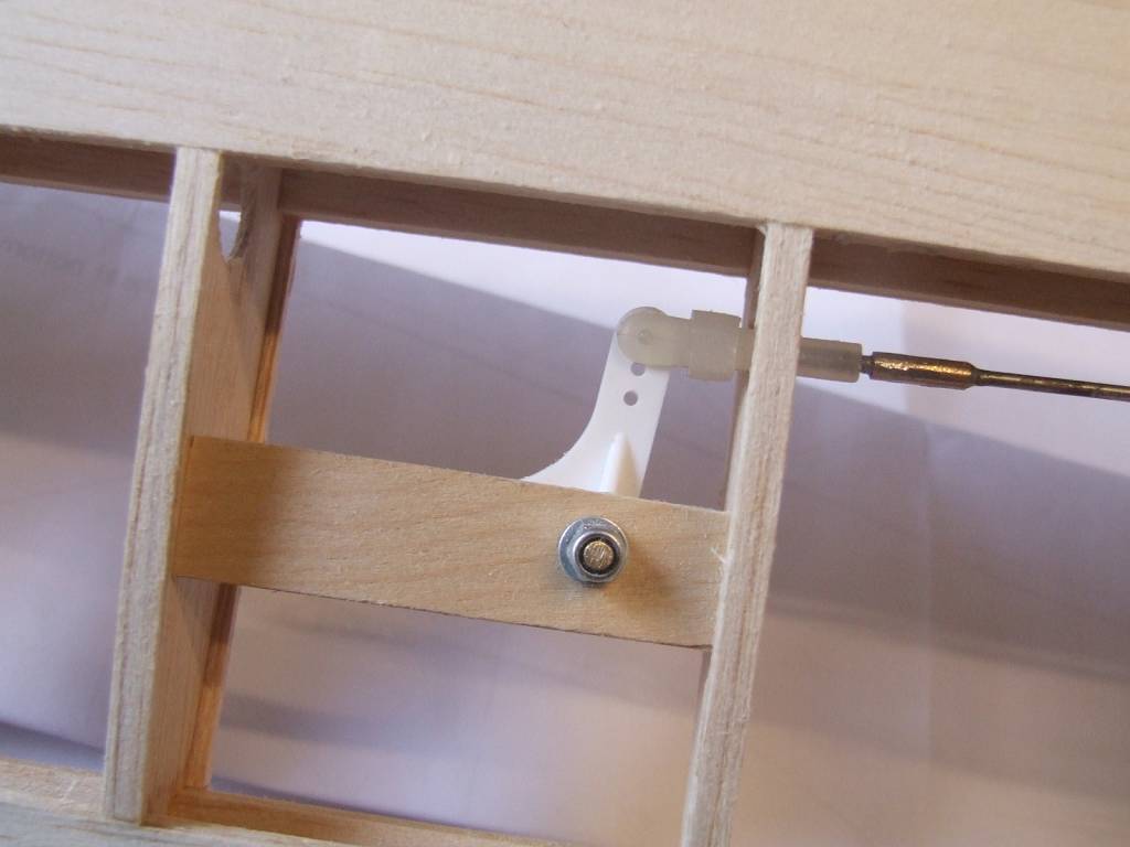

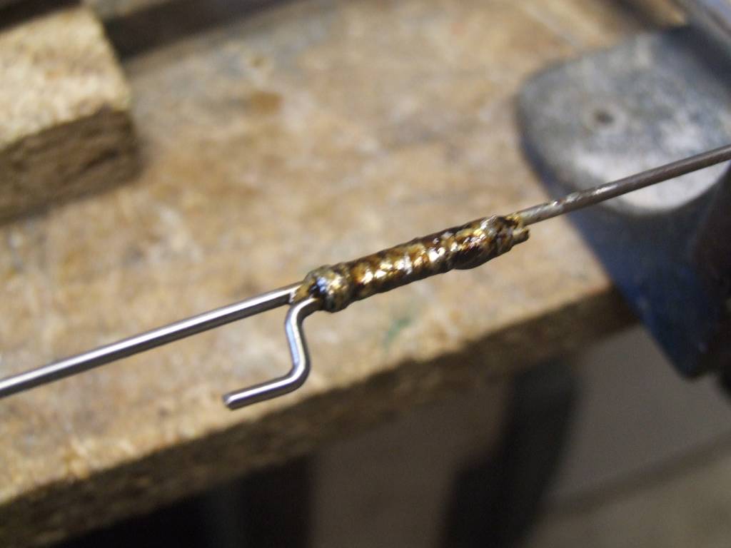

Had a long hard think about this aileron connection. I wanted, idealy, to be able to adjust either end so I could pull both ends in to increase differential or do the opposite. Plan A/ I made up two links but found that room precluded the otehrwise good idea. Plan B/ I next went the route of the plan. Simple and effective. It has just a 90 degree wire piece soldered on which just literaly sits in the servo. If the servo was to move then it could come out. Plan C/ was an adaptation of plan B which involved having the same simple wire piece soldered on but also had another 90 degree bend so it cannot escape from the servo arm. This simple answer has two draw backs that I have to live with. 1/ If I want to remove the arm I have to remove the servo and I cannot shorten or lengthen either individualy or together the lengths. The connection to the aileron 90 degree horn at the outer end will have an extender and a nylon clevise to allow adjustment. There will be incorporated a little differential for peace of mind as well.

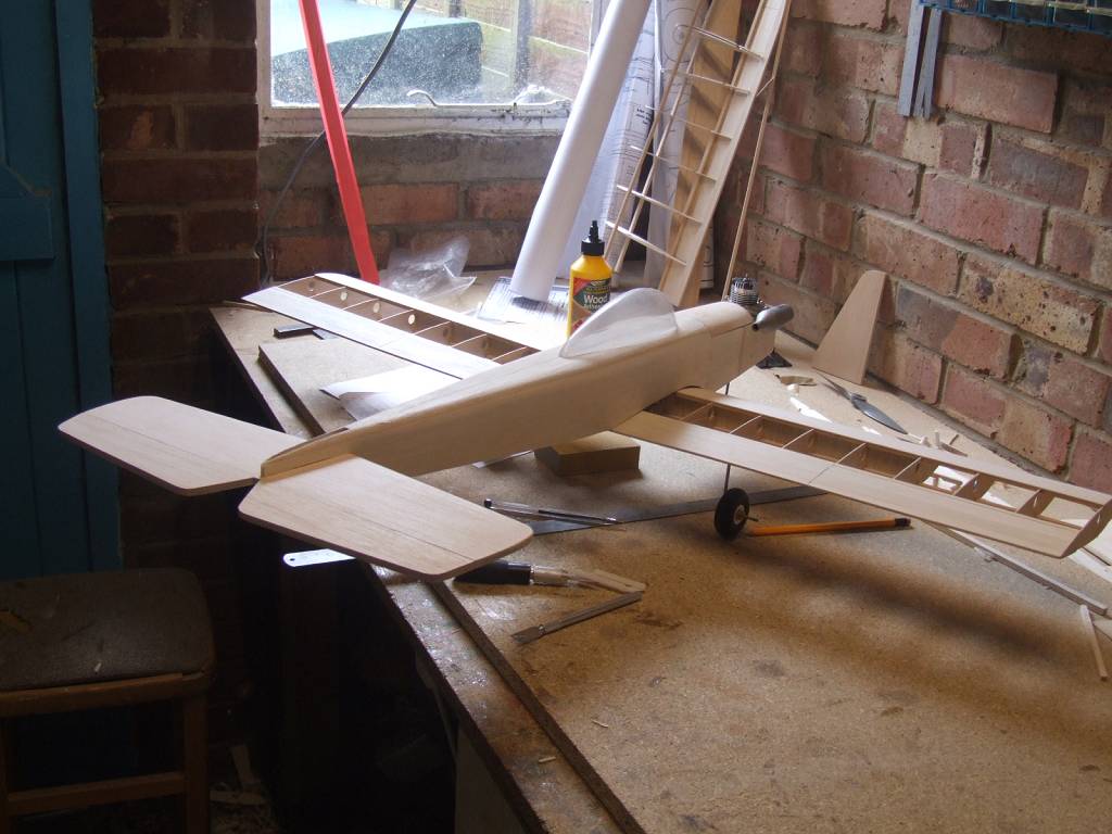

I have been constructing a Fly-Baby (51" wingspan) designed by Gordon whitehead simultaeneously so that is slowing me down a little. I wanted to have the wings doen on both then the fuselages etc. It didn't work out that way though. I have the fly-baby tail surfaces done (a little more to build than on the flea-fly) and am now getting the basic wing started. I have some parts cut out for the Fly-Baby's fus as well.
The Flea-fly is progressing well and I am lookin ar about 2 weeks to finish it. I have some nice Light Orange Solarfilm (Phil Krafts favourite color apparently). I am now try to finish the wings. The Tips have been added and I just have to sort out the ailerons. I have build in a little differential.
The picture shows it before the latest work on the wings was done. I also have the snakes now so they can be fitted. Not much room in that there fuel tank bay !

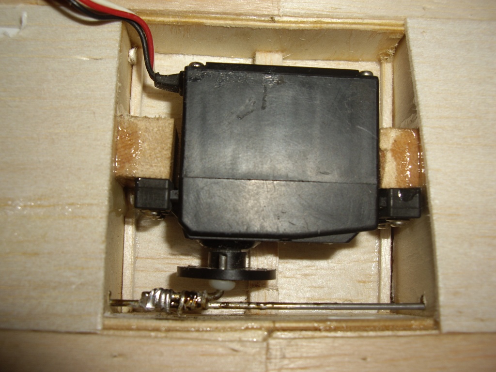

Here is a picture of my wing servo installion. It may help. Done virtually as original except for the bend and smaller servo.
The bellcrank had a few degrees of differential added.

ORIGINAL: ntsmith
nt,
The art of building (you did write it), scratch.
I did read your post see quoted and did have to think about my Orion.
As in the past I always use one servo for the ailerons and the frise ailerons of the Orions don't need differential.
I think this can be interesting for you. Next plane or time?
I also do use one rod between the two bellcranks it is much better to prevent play, but to remove the servo I have a small detail to show.
First I can adjust the total length,second I can remove the servo much easy. (Picture 1)
Important because there is not much room in the compartment in the wing. (See blue oval picture 2)
As you did show it is very important to make fail safe solder connections.
The construction is safe, even after I did hit an object I still could control the remaining aileron.
Good luck with building and flying

I did think of going the two aileron route. This has drawbacks. Twice the servo current which gives shorter flight sessions and increases the roll inertia so I stayed with what I found to be the most solid dependable method I could adopt and that was not far from the original. I did add some clevises for assembly adjustment at the bellcrank end and I did add a 90degree kink to the servo for security. It turns out I can get the hole to be altered quite easily if I want to adjust the throw at the servo end although I think it will not be needed. There is only one rod from end to end to eliminate any slop which is the last think I want. There is a geared down drive to the servo by the use of different lengths of the bellcrank.
I am not sure what the amount of throw should be but I am certain that no differential was used on the original. Mine had just enough so that if there was any chance of the lower aileron being more than the upper one this should eliminate it.
I have today been trying to fit the steering linkage. Good fun (it isnt). However I am getting there slowly. A smaller battery pack may help. I ordered one today (800maH) and the fuel tank looks like the Kavan Flexi tank will be the one to use. We will see.

My wing is nearly at the ...Cut out the Aileron stage
The plan shows a 2:1 Reduction at the bellcrank [] I am not sure that this is going to be enough movement.
On my servo is a small wheel it also does not give much movement.
The plan shows the linkage going to the top hole in the horn on the aileron ....Even less movement []
